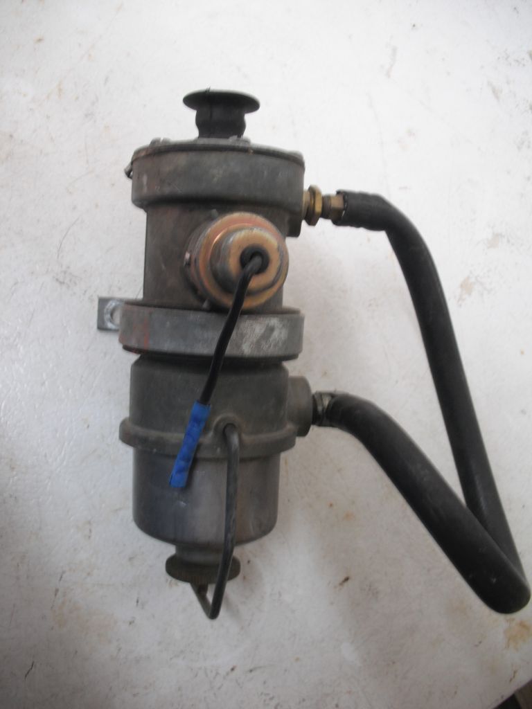

    And I have one of these too, haven't used it yet. it's going on my '39 ford convert.

    I don't think they push a lot of gas, I am using one on the '39 because its period-correct (ohhh, theres a dirty word...) for the build. Went to a fair bit of hassle to get this. Thanks Hank! Needless to say, the crimp-on connector must go.
