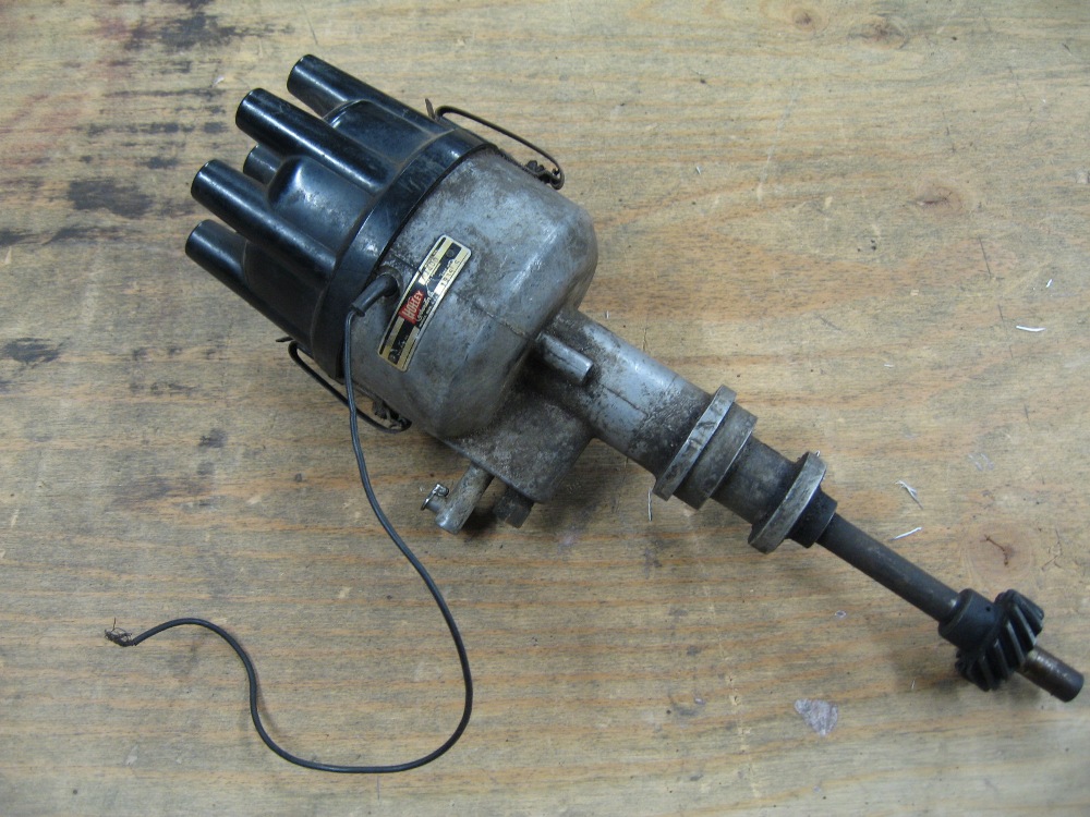

    Along with my 312 Y block came an old non vacuum Holley Dual point distributor.
    I didn't even know Holley had distributors :confused:
    Anyone know anything about these ? Are they any good, and is it possible to fit an electronic system into them ?
    Any other info ?

    I'm a big Y block fan, and have sen a few aftermarket dist's, but never seen or heard of a holley. Can you post a pic?

    Went out to the garage and got one.

    It was called a Holley "rotovance", and was a good alternative to the factory all vacuum piece of scrap. One of my friends put one in his '56 292, and loves it.

    So what would be involved in rebuilding it ?? And could it be fitted with a Petronix electronic system, or possibly a Mallory Unilite conversion ??

  11. You should be able to convert it to either. I would lean towards the Mallory Uni-Lite.
    If the bushings aren't bad then all this is involved in rebuilding it is taking the advance mechanism apart and deburing and polishing. Make sure the springs aren't shot.
    Then points and condensor, rotor etc. If the bushings are bad it may involve making some bushings I doubt that you can buy them, you might find something that will work.
    Or you could just ship it off to GMC Bubba and let him convert it to Petronix and take care of the rest of the freshening.

    As a point of interest, my 1967 Honest Charley catalog lists Holley Rotovance dual point distributors for both Y blocks and FE engines. If it were mine, I'd just run it with the points--if you're worried about being stranded somewhere someday, keep extra points in the glovebox. I've been running the vintage Mallory distributor in my '53 Chevy for years with the same point sets in it with no problem whatsoever. Petronix? I guess it's fine as long as it works, but the day it doesn't, you sure won't be filing it clean and getting home with it, like you could with points. If it were something like an H.E.I., you could figure on most any parts store having pieces for it.
  14. They aren't interchangeable, no. I think the Holley tech might have gotten confused. :) Holley did make some OE distributors, for International and others, but they weren't performance oriented. The IH units are the infamous "gold box" electronic units that are prone to dying when the key is left in the wrong position too long. I believe HEATHEN's info about it being a Rotovance is correct.
    So far as converting it to electronics, anything is possible...with a bit of effort, you could use one of the conversion kits, probably. A common conversion from the late '80s/'90s is to use Duraspark components, or a Duraspark wheel with a Mopar module.
    Or, send it to Bubba and let him figure out how to do it. :D

    rebuild it, set the points and hook an msd box to it. points see no load and will live forever, and msd failures are vary rare.

    your sort of correct about points, but I dont think I've seen the slider melt, they do wear out but it takes a long time.
    I am not a fan of pertronix, soem have had real good luck with them and I'm happy for them, but some of the horror stories about them scare me off.
    Being a professional drag race builder for a long time I have installed many msd boxes and have seen very few failures, and most of those were due to owner screw ups.
    When using a msd style box triggered by the points the only thing the points see is reference voltage. They wont burn, arc, or carbon up.
    Adjusting becomes a never do thing, as long as the points open and close it will work.
    You can also do away with ballast resistor, and it lightens the load on your ignition switch.
    There is also a trick you can use if the box fails that will get you home.
    All you need to do is put a wire from the neg side of the coil to the points, and run a 12 volt (ignition hot) wire to the positive side of the coil. Now you points work like they are supposed too.
    Try that with any other electronic conversion. :D
