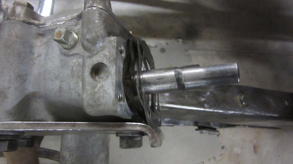

    I got it done awhile back, I located a grease seal for the collar (the steering column used to clamp on the collar ) and re-assembled the NOS Ross box. Studebake rbuild 010.JPG

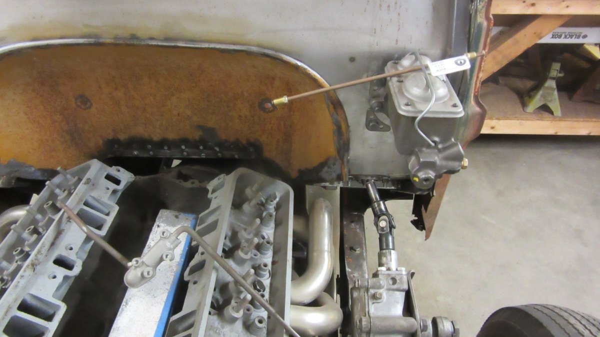

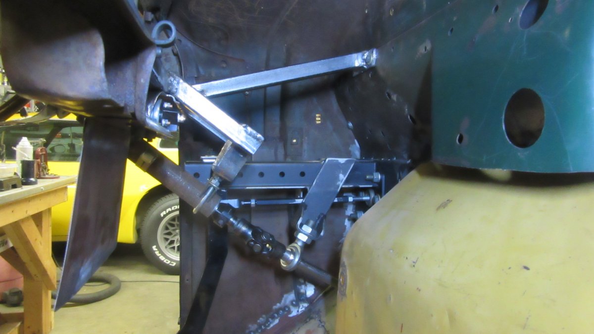

    So I have my steering box ( N.O.S Stude piece ) and column completed. It has taken some time to get everything lined up and there are no tight spots anywhere in the rotation of the steering wheel. I also have relocated the MC to the firewall using a Speedway bracket. I added a couple pieces to mount a Camaro stop light switch. I have it fixed so the only way to get the MC pushrod out is to remove the pedal. Thought I would post a couple pics. studebaker build 007.JPG studebaker build 013.JPG studebaker build 014.JPG
