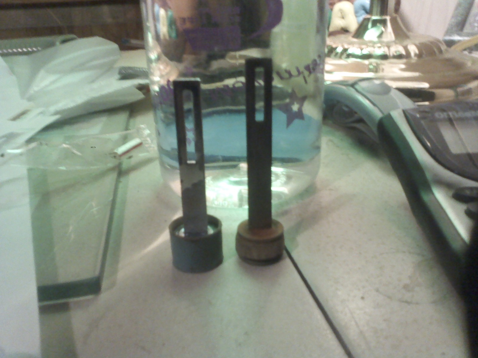

    I have a wad of 94's and have overhauled a bunch of them. I didn't keep track of the specifics, as in the universal kits in relation to models applied to. One of the glitches was two different length access pump assemblies. I remember the linkage was overextended and bound up, did a mix and match thing, maybe ended up with a used one. Found problems with foreign made kits as with correct amoun of parts, waybe they got the wrong piece in also? If you have the original plunger assembly & compare?
  4. barry wny
    Joined: Dec 31, 2009
    Posts: 451
    barry wny
    pics of a couple. Kenc.t. is the cheif engineer and will know the whole story, maybe here but for sure on fordbarn.

  13. Bbook
    Joined: Jan 23, 2011
    Posts: 23
    Bbook
    I replaced the accelerator pump actuator rod with the one from the old carburetor (glad I didn't send it in for the core refund) and it doesn't stick. The rod on the rebuild must have been bent. Lesson learned about buying a rebuilt carb.
