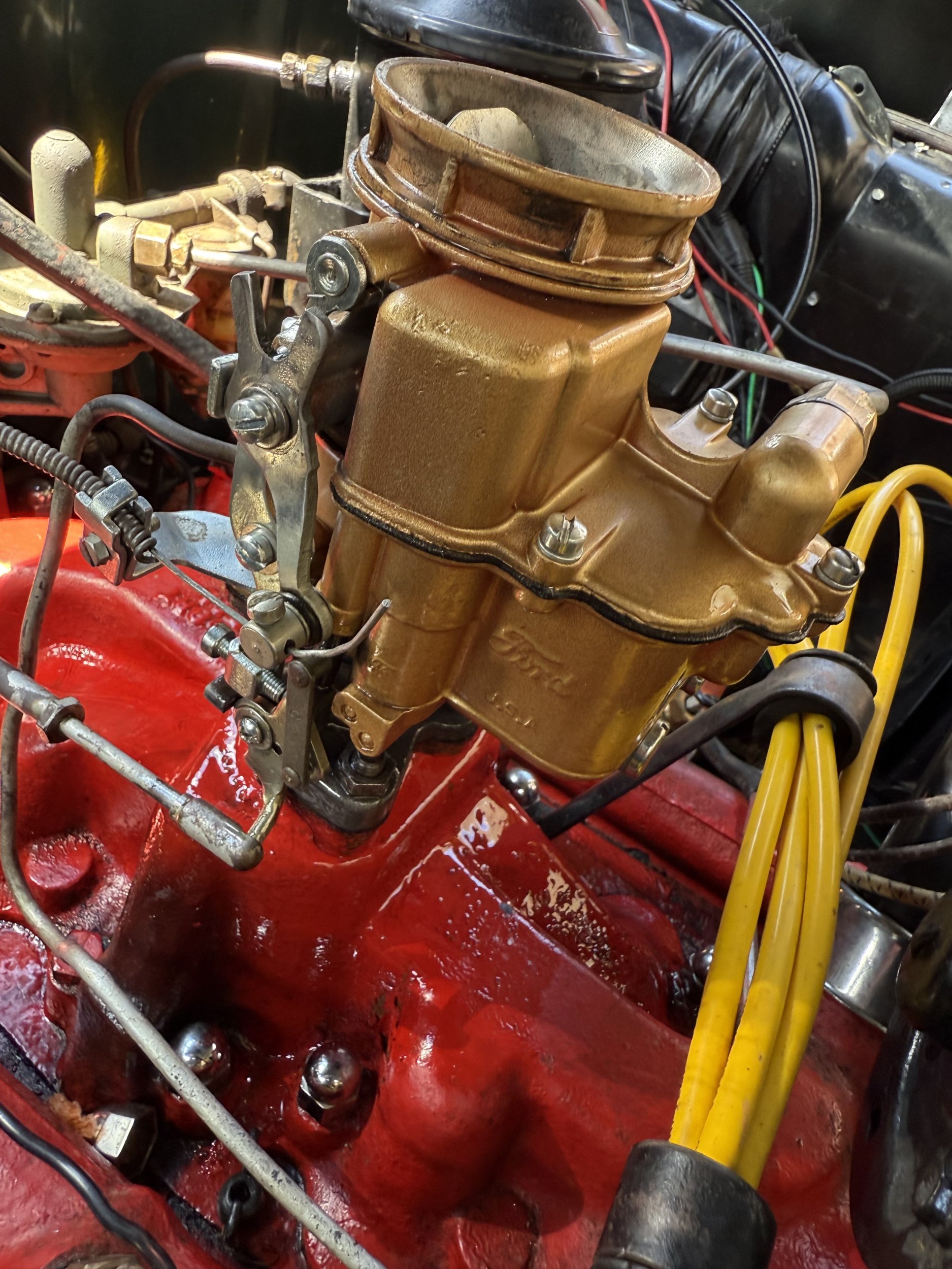

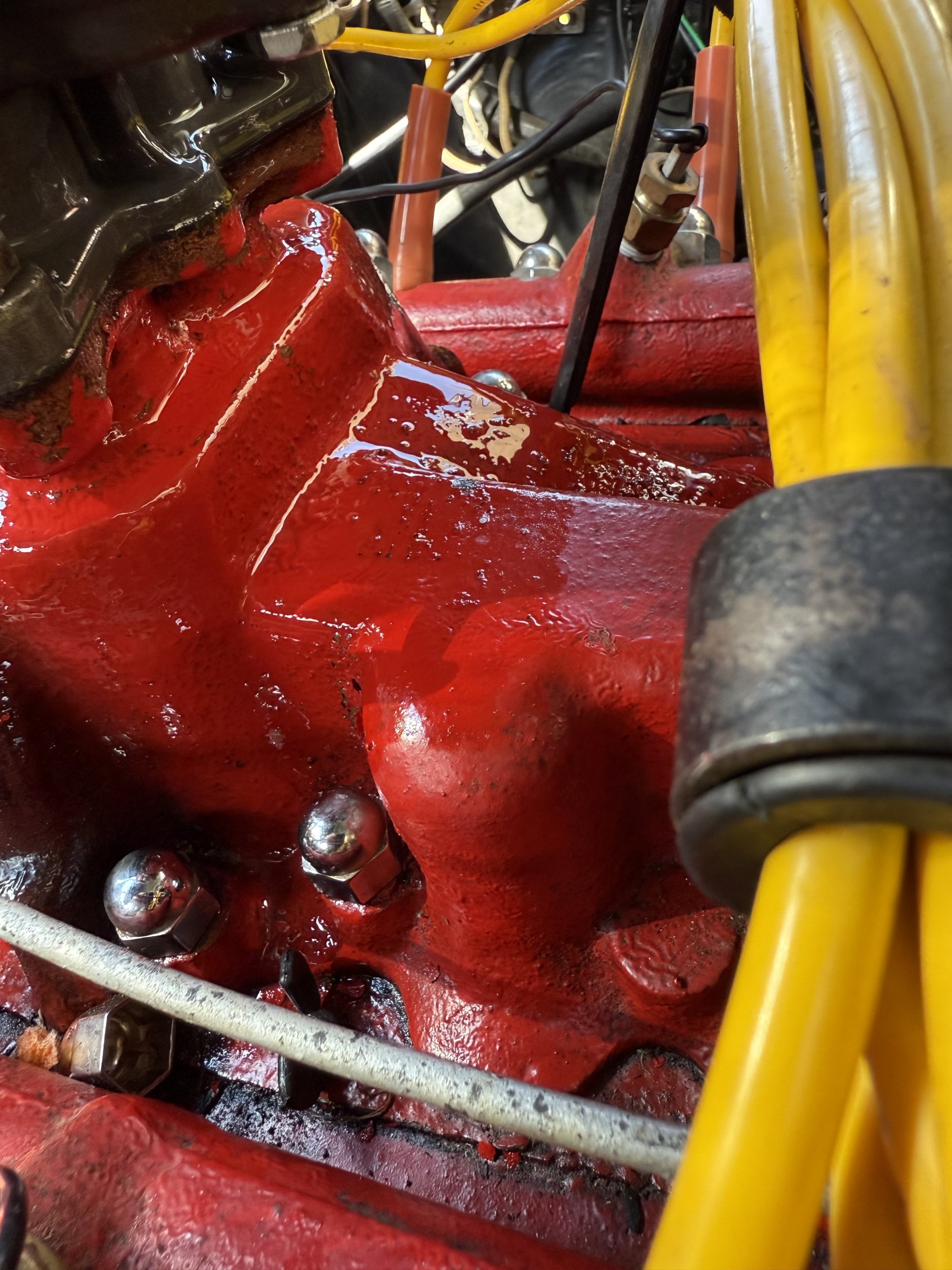

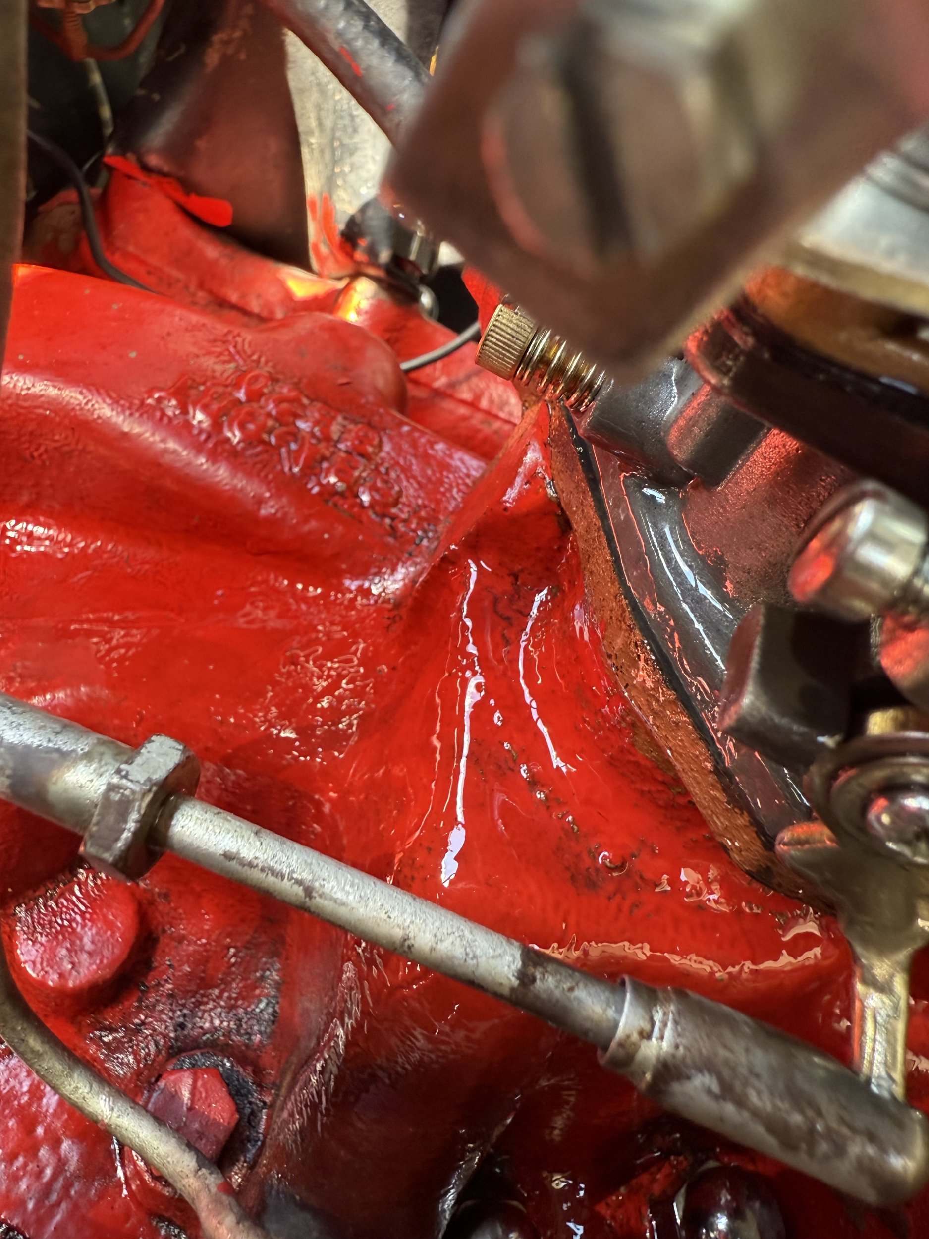

    I am running into this same issue. Fresh Ford 94 carb everything new built professionally. It ran sweet as soon as I put it on except for the accelerator pump was binding. When giving it gas it would go down so far and bind and you would have to push thru that point never a smooth shift or take off I checked some my other carbs and the accelerator pump moved smoothly nothing holding it. I pulled an accelerator pump out of one of the other 94s and now it glides like butter. One thing that worried me is the one I took out had a small spring on the bottom while the one I put in didn’t but a YouTube video, I believe Mikes carbs, said not to worry about it some have them and some don’t. Now the issue I am running ing into is it is either hard to start or starts instantly and dies after a couple of seconds. When it hard starts it runs for couple of seconds and dies as well. I get out and looked under the hood and my carb is leaking all over the place and gurglin Wipe it down and try again without giving it gas and the battery dies trying to get it to start.
    I’m taking a crash course in flatheads and 94 carbs. I’m fine with it that is why I have two of them, the whole reason I got them actually. Trial by fire. Easiest way to learn. Lol maybe I am a glutton for punishment. But I wish I could get cut just a bit of a break. Can anybody show me where I am going wrong at?
