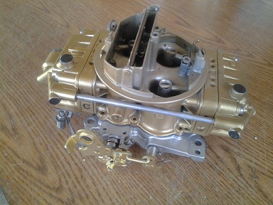

    How all u guy's and gals been. Been quite some time since I have been on here since my computer crashed a few years ago. Up and going again and looking forward touching base with many of you again. As it is I currently have a question on a Holley carb. Trying to identify it. Not a hole lot of experience working on cars quite yet but am mainly a Chevy - Gm fan. What I need to know is the CFM And anything else that would be handy to know about it. It has a double pump on it I believe and on the front side List # say's 6498 and under that has a I think either A letter D Or a O and 473 after it. I also see a 6R-4237 B on the side of it . also see a number on the base of it that reads 12R-5395 B. Any info on it as well as possibly a year as well as what it would fit which am fairly certain Gm would certainly be appreciated. Thanks

    650 cfm Spread bore carb. I ran one for years on my 48 with a 350 in it, then on my son's 70 C10 with a 307 in it and later on my 71 GMC with the 350 in it. It's hanging on a nail in the shed now but is beyond worn out.

    I am pretty sure that is a high performance carb Holley sold as a replacement for the Q-jet. They were never factory installed on anything. 650 CFM Double pumper with mechanical secondaries. They were good for performance,but not so fuel friendly.
    "letter D Or a O and 473 after it" - This is a date code. I believe yours is 0473. 047 is the day of year and the 3 is for 1973.

    I have always heard that the Holley spreadbores combine all of the worst features of Quadrajets with the worst features of Holleys.

    Its a 650 spread bore double pumper. just look up the list number

    a q-jet has no bad features its simple ( to me ) ,to me the spread bore holley took a good design and did there typical thing and really made it confusing .

    they are the black sheep of Holley , I have a box of them that people have pulled off and given too me , one was brand new ( 1 week old ) the guy couldn't get it to tune and was so pissed off that he bought a new manifold and put a square bore on it . IMo it was a big mistake on Holleys part .
