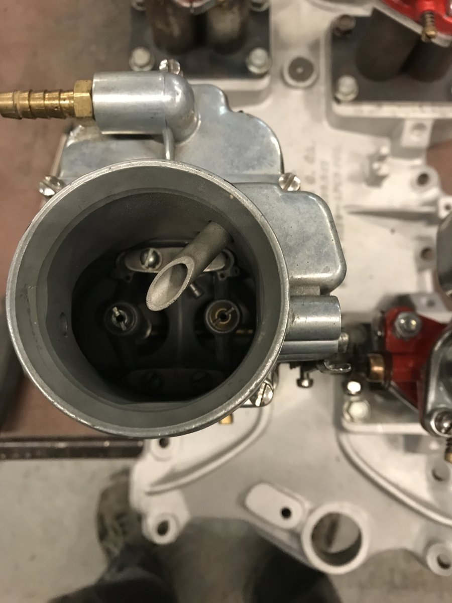

    1 is as per this throat and air jets 17C2ACDF-590C-42DC-8580-23901FED6FFF.jpeg
    3 are like this,.
    I have 4 -94’s, 3 are identical in the throat, 1 is different, see pics.
    Anyone know if this is OK, or should I change the one

    The top one is a good candidate for a secondary carb in a multi carb system because the idle circuits tend to be a little on the lean side.

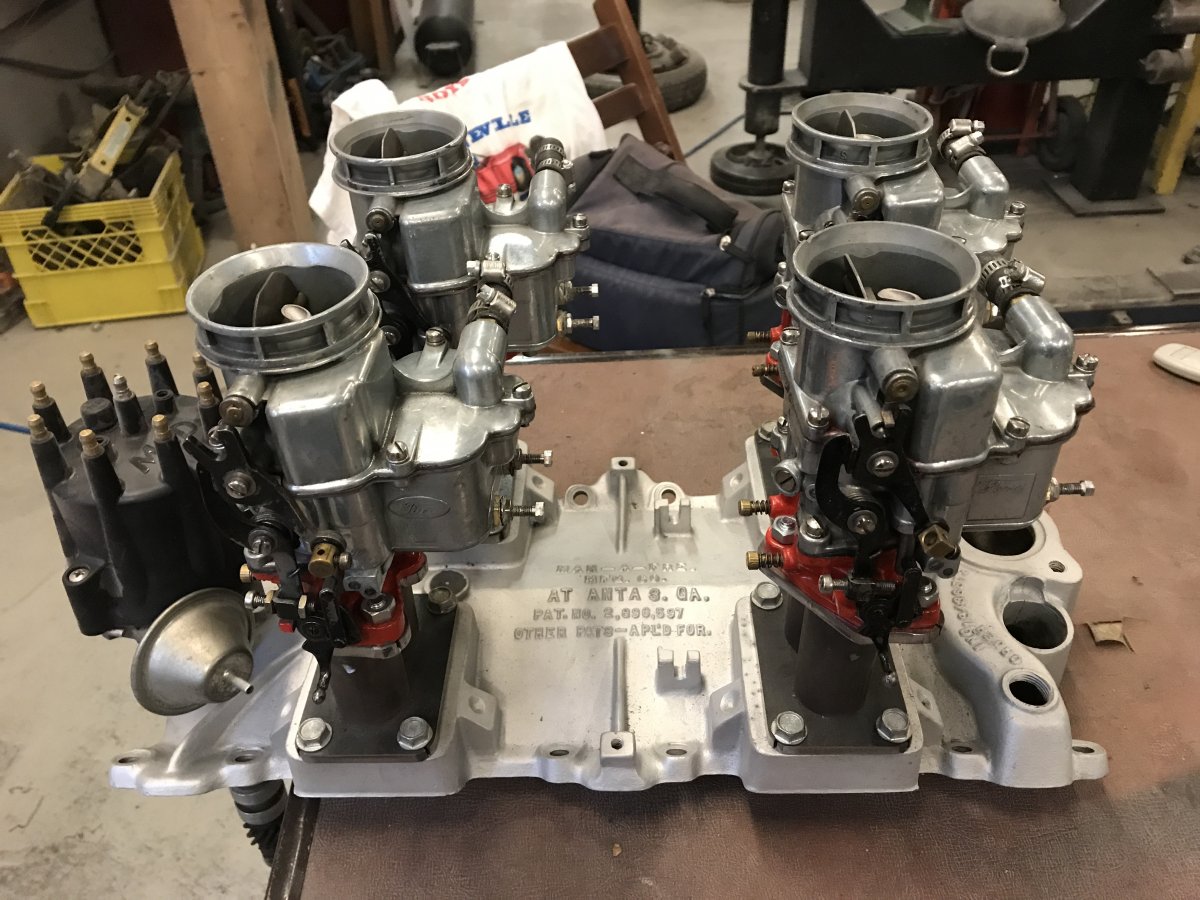

    The front LH carb is the different one
    These are going on a Man-A-Fre manifold, they are all primary carbs.

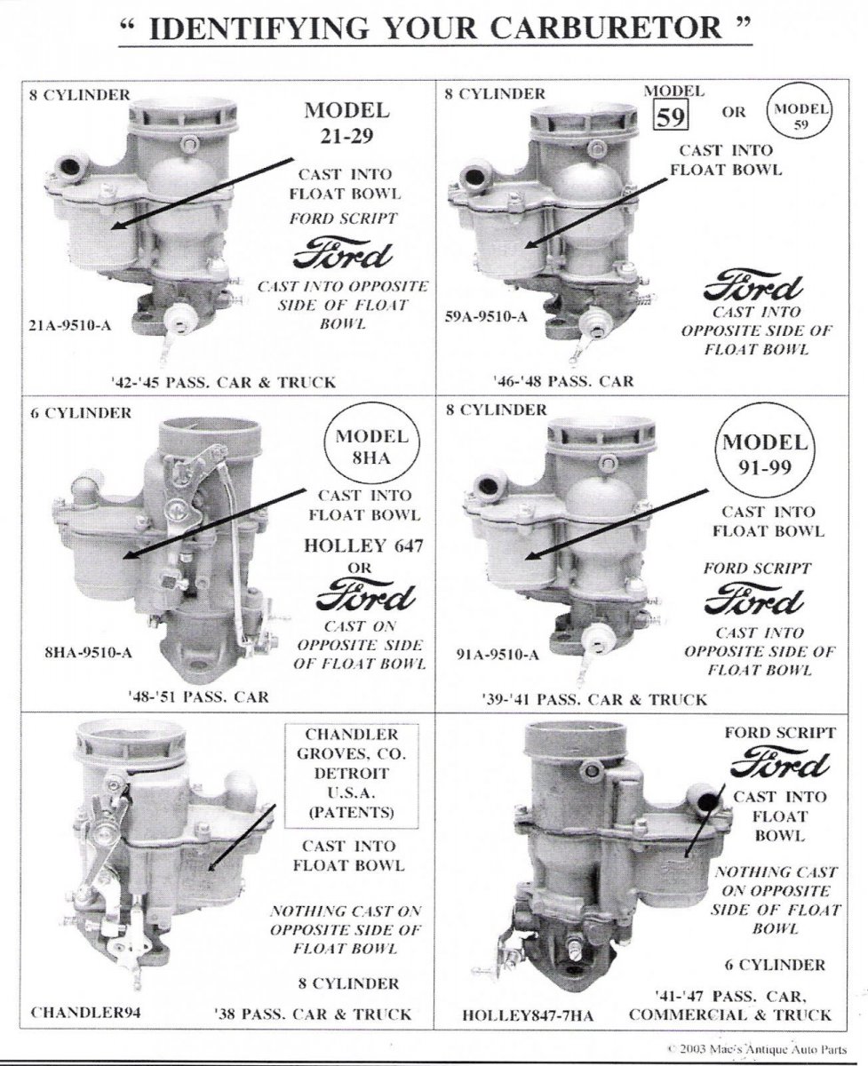

    Def not an expert, but recently adopted my fathers Model T which have 4 Holley 94/2100s so have been doing a ton of research as they needed a rebuild. The attached may help in identification. I understand from my reading that even withing the Holley 94 models there were a few variations.

    Interesting little screws coming out of the access plugs for the jets. I'd take the top of one carb and look-see what they do. The nozzles in the top pic are later design. Can't remember the reason for the change.

    They were for a leaner idle. Look at the 3 air bleed holes whereas the other picture shows only one bleed.

    Those look like adjustable main jets to me.

    That is what I thought, seems like they might be needles to adjust main jet flow.

    Yes, they have adjustable mains. Can the odd carb be retrofitted with the same nozzles as the other 3?

    Yes, need different hold down, bleed screws, idle jets and there is a left and right.
