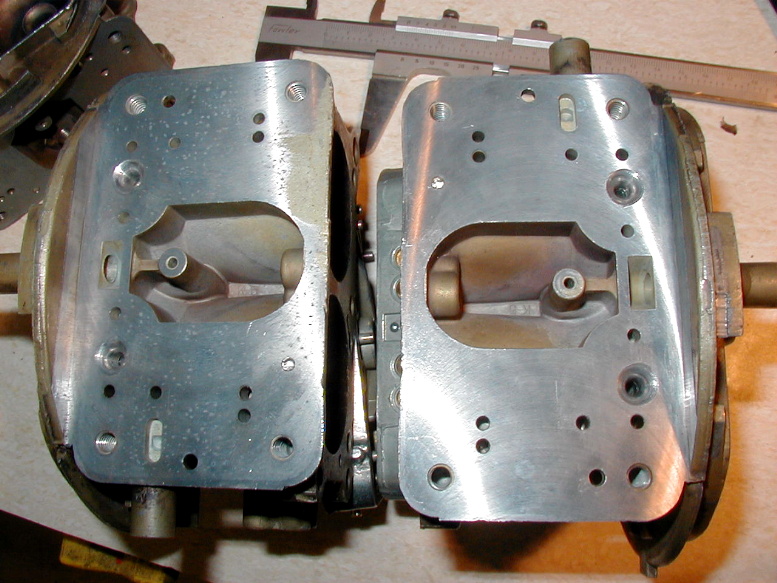

    Fuel dripping from the boosters at idle is an indication of main well fuel initiation. At idle it should not be dripping. This is a common problem with a big cam, but with 25 in hg vacuum it sounds like you have a mild cam. Try closing down the throttle plates. That may require you increase the size of the idle air bleed restriction. I like to convert from pressed in bleeds to screw-in.
    I have also found the Holley main bodies to have metering plate surface flatness issues. I fly cut mine to insure a flat mating surface for the metering plate. The carb on the left did not clean up after the first pass.
    In the photo below also note the "spongy-ness" of the main body. It may have an internal porosity leakage problem.
    osage orange, ClayMart and 2OLD2FAST like this.
