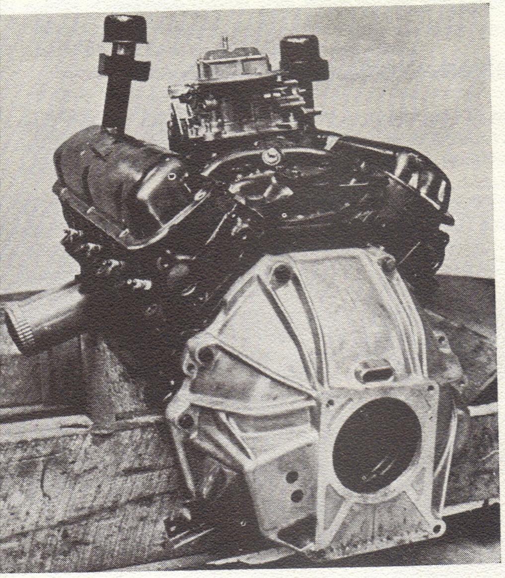

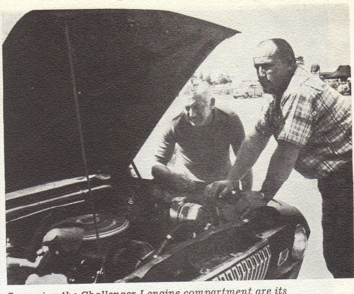

    Here is a couple more pics. That's John Holman on the right and Jocko. The picture of the engine was taken just before installation a few days before Sebring.

    Is that a two barrel on that engine or am I seeing it wrong? I can't imagine they'd have run a two barrel at Sebring.

    I can't determine if it is a two or four barrel from the picture. Keep in mind this small block Ford engine had just been introduced and it was REALLY a small block. Just 221 cubic inches. Even smaller than the smallest Y-Block it was replacing. It would be another 18 months before Ford offered the 289 Hi-Po engine. There were no performance items for it yet. This quite possibly could be the first performance engine built. I am certain if H&M didn't have the option of a four barrel they would have modified the largest 2 barrel available. Their 2nd place finish proves whatever they had available worked. You can bet H&M played a role in the development of the 289 Hi-Po engine.
  5. Looks like a 2 barrel,,,but in '62 there were big two's available on the FE motors,,,,,

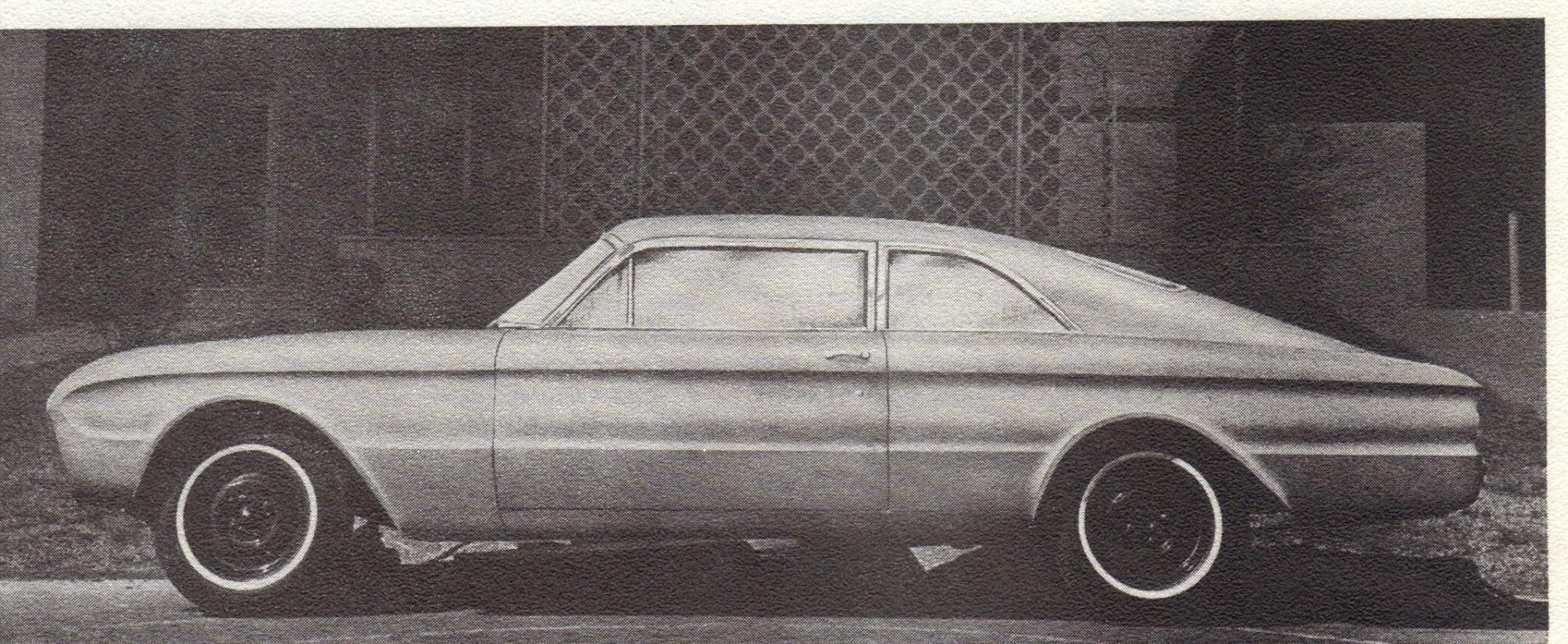

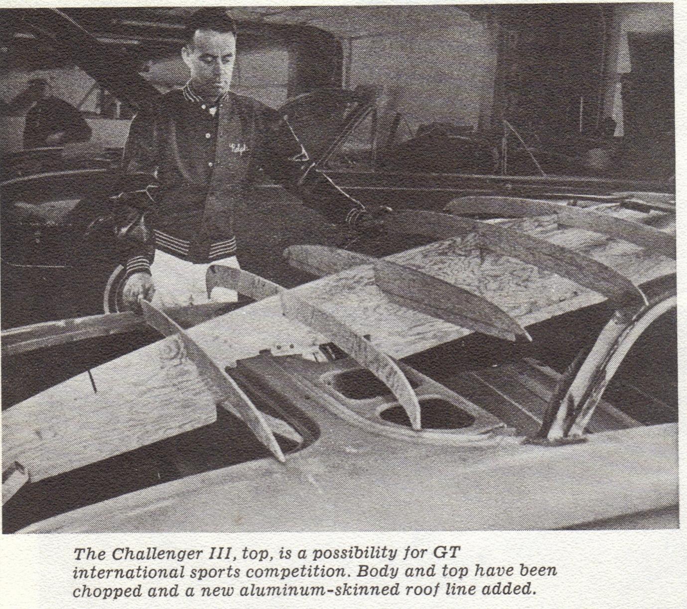

    I believe you are correct Stan. Here is Ralph Moody working on the roofline. As can be seen the wooden buck extends to the tail lights and eliminates a trunk lid. It looks like the original side glass was retained but chopped 3 inches. It was built to compete in Grand Touring sports car competition under FIA rules. The engine was bored out to 243.998 inches to fall within the 244 cubic inch limit. I can remember this car or one like it driving around Charlotte about 50 years ago.

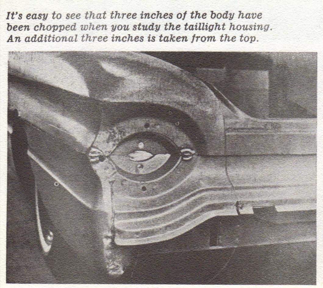

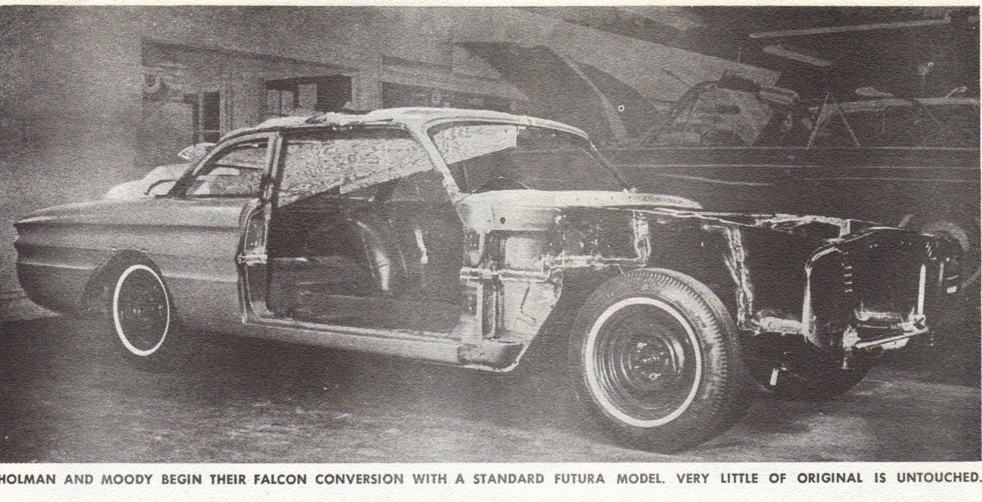

    That first pic of the CIII, if you look closely at the sheet metal in the front & on the door striker post ,its already been sectioned. It also looks like it may have been O/A welded.

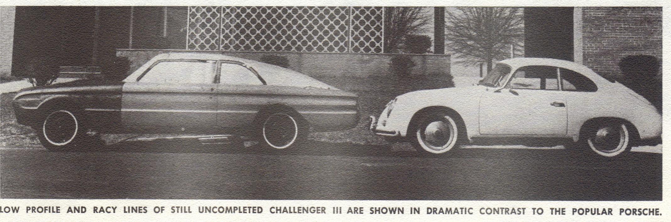

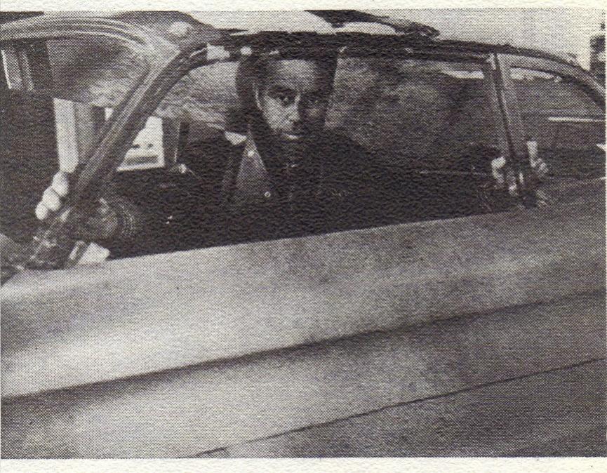

    Yes it was already sectioned. Here is a good shot of the tail light opening and and how the sectioning made the opening oval shaped. The finished Falcon was no taller than a Porsche.

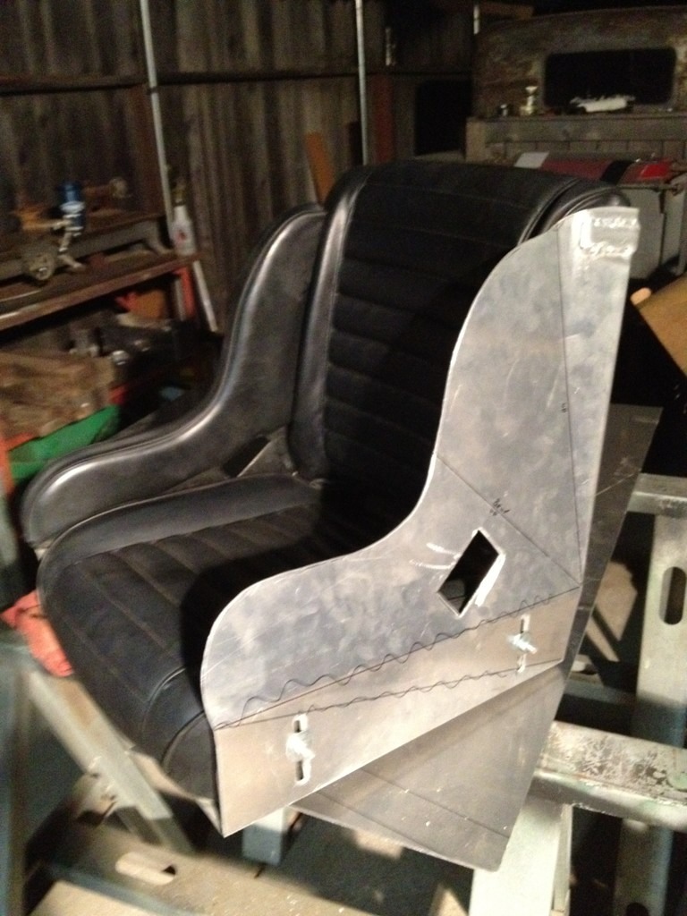

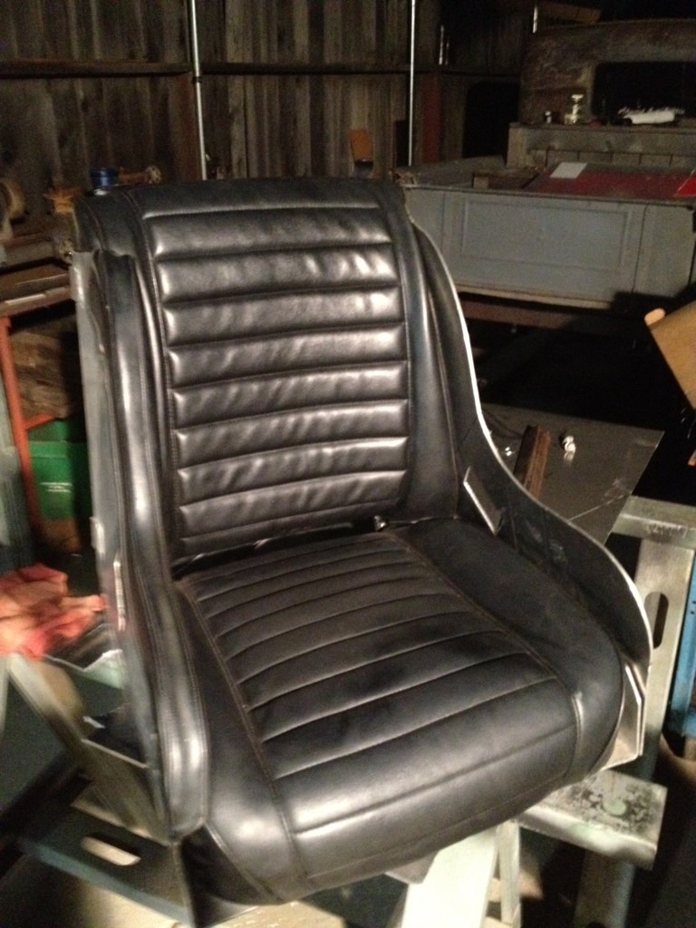

    The company partner of a friend of mine has a Holman Moody 69 Ford Talladega road race car. When he bought the car it was missing one side of the seat. So I had to make a copy of the side. Here are a couple pictures of the seat. ImageUploadedByTJJ1346989101.651161.jpg ImageUploadedByTJJ1346989118.543818.jpg ImageUploadedByTJJ1346989133.923639.jpg
