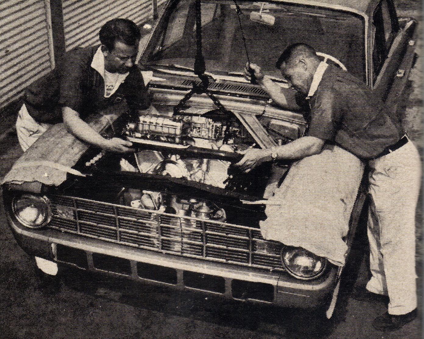

    The rest of the build.

    thanks for the update with the Y. I never knew of that one.
    So what ever happened to this one?

  6. Never heard of that conversion, pretty interesting. Surprised to see they left the battery under the hood with the extra weight of the "Y", do you know what might have been done to front suspension?

    Yes there was,
    Stronger coil springs, Monroe Shocks and and a custom made 7/8 front stabilizer bar was used. But the stock front brakes and 13 inch wheels were used.

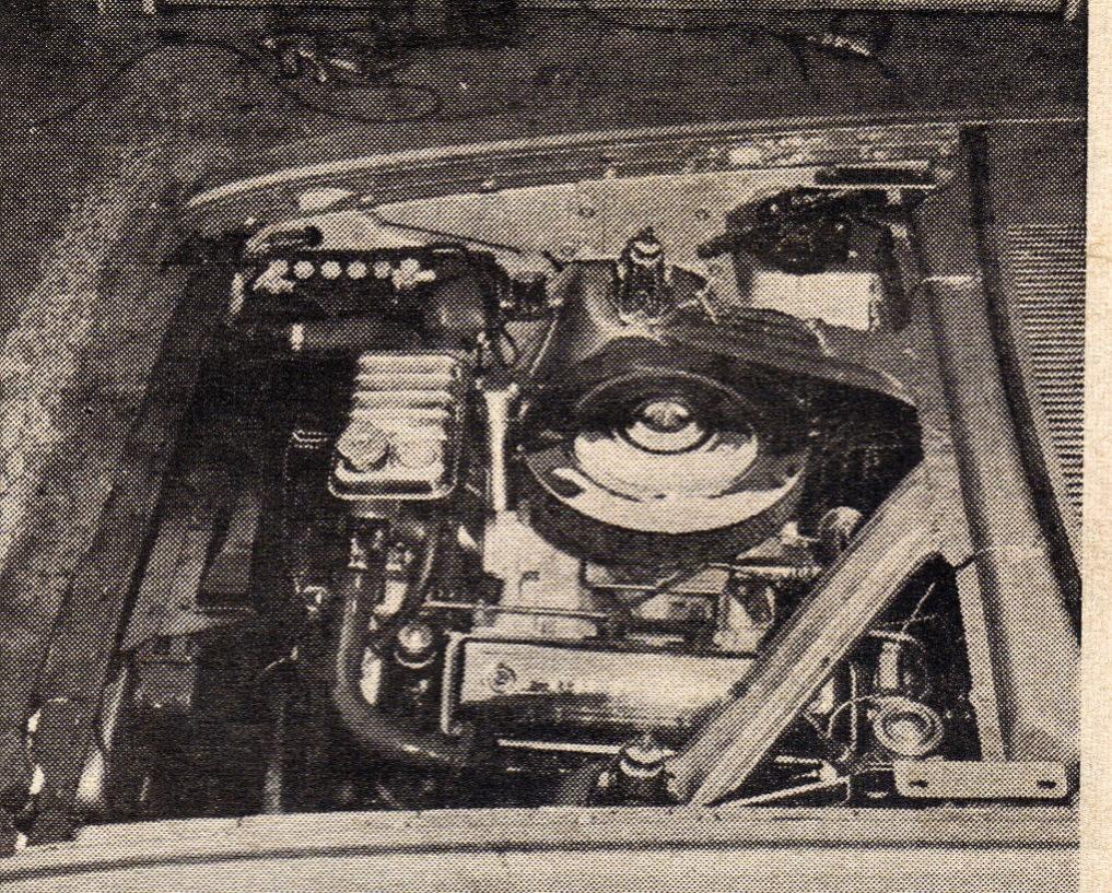

    Plug changes had to be a pain.

    A couple more interesting things about this build. As mentioned before a 9 inch Ford rear axle housing replaced the Falcon housing. 10 inch drum brakes were used on the rear but the axles and drums were reworked to the stock Falcon 4 bolt pattern so the spare tire could be used. A slightly wider stock 13 inch rim was used on the rear. The rear axle ratio was 3.10.
    One would ***ume the stock 312 Y-block would suffice in this build. Not so. Stroppe had his ace engine builder Vern Houle blueprint the engine after a .060 overbore, milled heads and a Racer Brown cam installation.
    After being presented to Mr. Ford, who was vice president of styling at Ford Motor Company, he was so pleased with it that it became his daily driver around Detroit.

    Yes they were. In fact, a special box end wrench was made to get to the problem plugs and was mounted permanantly under the hood with a wing nut.

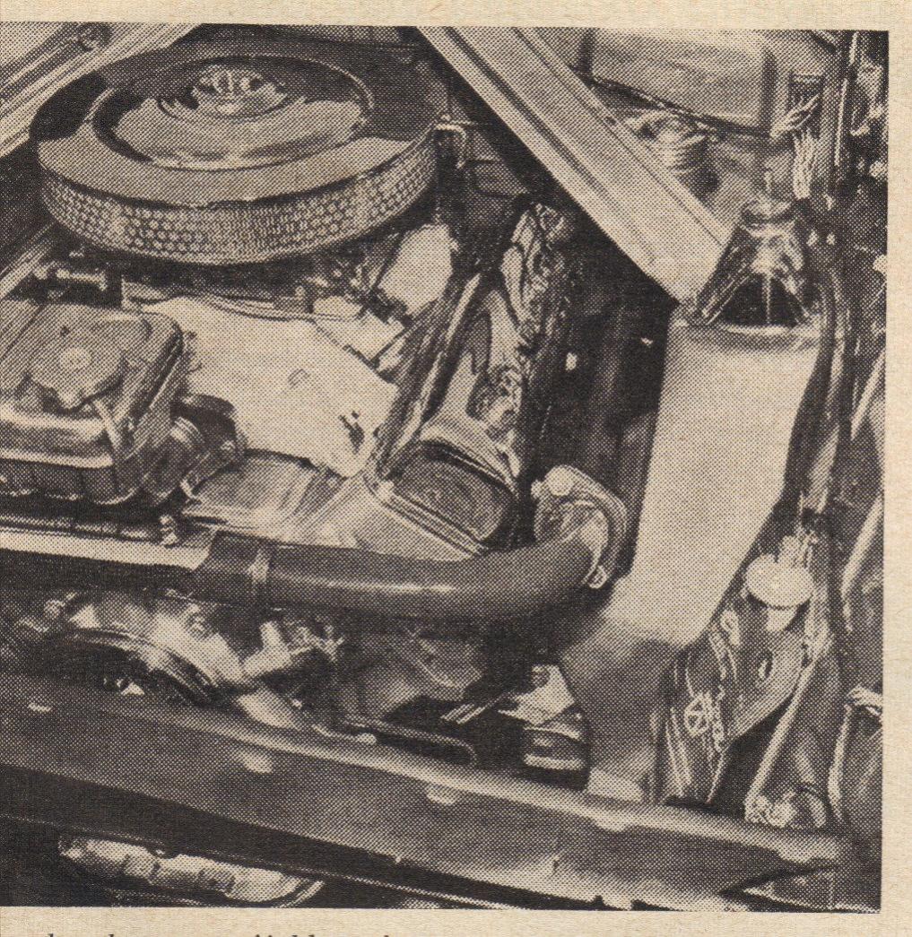

    I built this tribute to Fred Lorenzen....

    Bet that thing surprised a few people. The small brakes are scary though, those cars didn't stop too well with the little six. Add a couple hundred pounds to the front, Yikes!

  17. THAT looks Awesome Bleu !! Just Awesome...would love to see that running down the road!!
