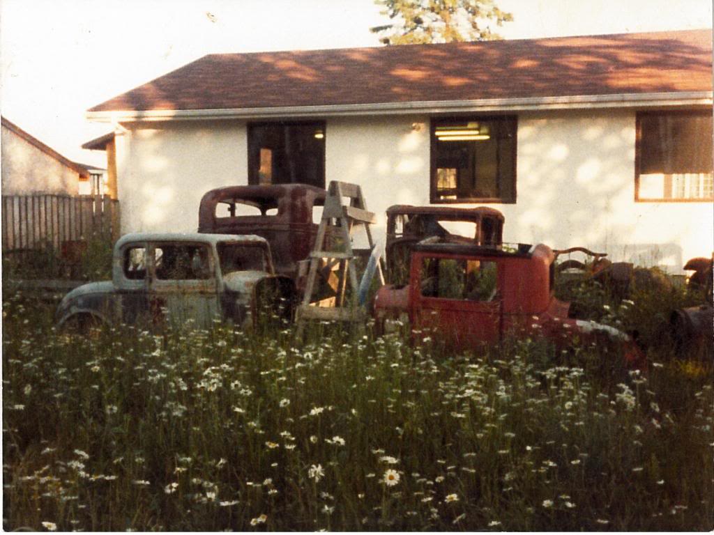

  13. As I mentioned, I went and had a good visit with Wally yesterday and found a little more about the history of the car. He lent me a few photos to scan........ here it is in 1974 when he bought it in Thunder Bay, Ontario.
    Back in Alberta.

  18. Cowtown Speed Shop
    Joined: Sep 26, 2010
    Posts: 1,196
    Cowtown Speed Shop
    from KC
    Man I love this pic....Brings back memorys of what our back yard looked like growing up. My dad always had some kind of old tin laying around. I would play in old bodies and with a young kids imagination I would win the indy 500 everyday. And Today I am the same way, My neighbors tell me that I should call those guys on "American Pickers" to come to my place. They don't even have a clue...My backyard looks like a junkyard, And I wouldn't have it any other way...LOL
