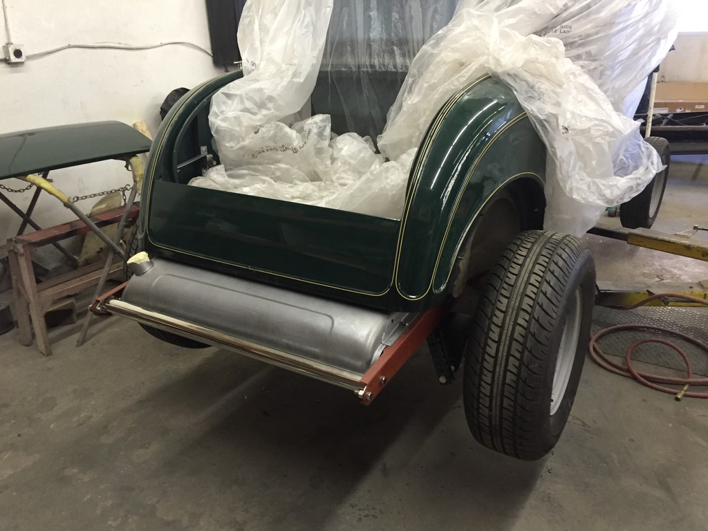

  2. Larry,
    I agree with you, it'll likely spend most of it's time full fendered, I'd just like to try to set it up so it could be run either way without a lot of issues. 3 holes in the frame for the front fenders probably wouldn't be a big deal, the bigger challenge will be the body holes for the rear fenders.

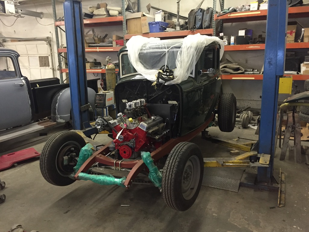

  3. Starting to look a heck of a lot better. I'm looking forward to driving this in the spring.

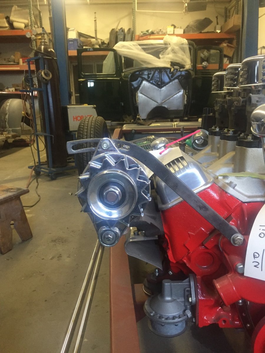

  7. Starting to get ready to plant the body back onto the new ch***is and the generator location won't work with the hood sides. The engine has 2-1/2" '63 rams horn exhaust manifolds. Is there a mounting bracket available to move it above the valve cover into the engine compartment?
    Thanks in advance.

  11. Allan, Paul Horton at Welder's Series sells an alternator bracket kits that mounts alternator more towards centreline of engine, and up. Take a look at their site. Or give them a call
  12. Thanks. I'll look into that.

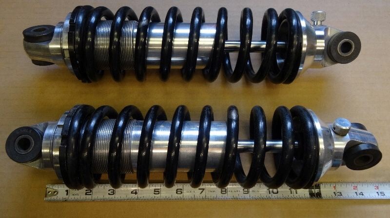

    I also picked up some Aldan 250# coil overs for a great price.

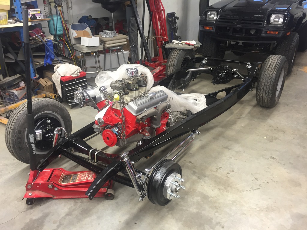

  17. Frame looks a lot different with a little paint.
    The frame came with rear 15x7 Vintique wheels with a little over a 4" back spacing. With the '57 9" and 235 75 15 tires on the rims it looks like the fenders will rub. Does anyone happen to know if this rim is available with a 5" back spacing, or have a suggestion for a tire size that will work with the 4" back spacing. The 235 75 has a lot of "bulge" on the sidewall but the height of the tire fits the wheel opening really nicely.
    Thanks in advance.

  18. Blue One
    Joined: Feb 6, 2010
    Posts: 11,511
    Blue One
    from Alberta
    I think that 225/75 -15 tires will be the fit you need. Take a look at some tire size charts and see the section widths and all that.
