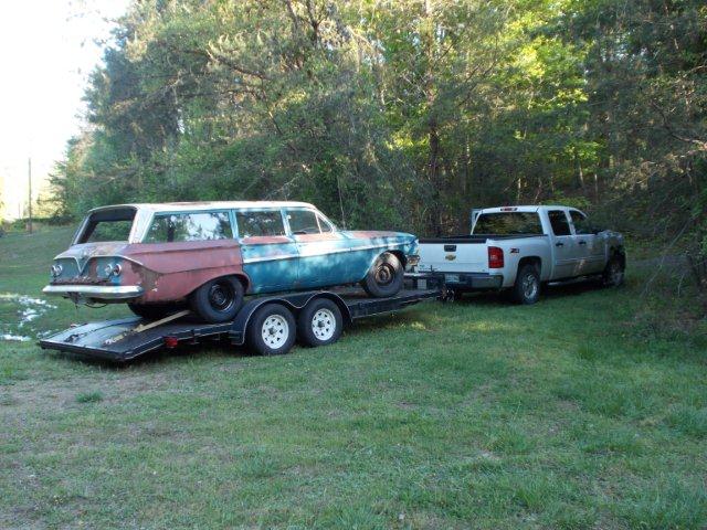

    Well I loaded the wagon up and took it to my friends shop today they are going to start cutting and fitting the floorpans tomorrow :)
  6. enloe
    Joined: May 10, 2006
    Posts: 10,071
    enloe
    from east , tn.
    Here is a pic on the trailer and a pic in my friends shop.

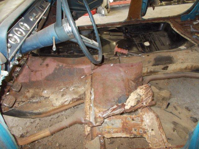

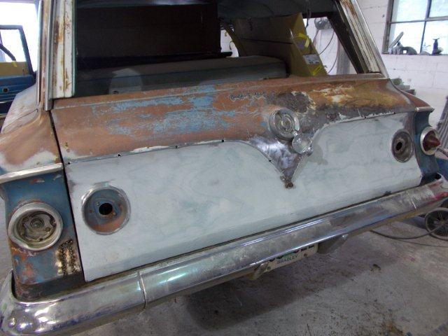

    update 4-30-2013 one floorpan fitted and tacked at the factory spot weld locations.
    New metal being put in tailgate

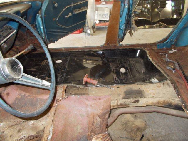

    5-1-2013 both floorpans tacked in. Time to start the finish welding. Toeboards need a couple of small patches. Bodywork started on tailgate.
    Slowly it is coming along.
    We still have to fix a spot under the backseat on the drivers side

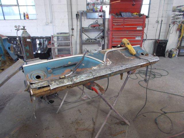

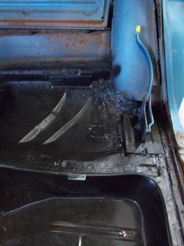

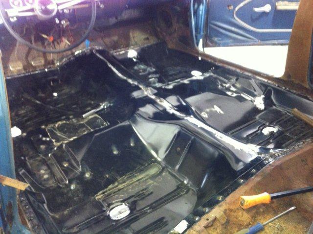

    Status Update:
    Here are some pics from Friday. The tailgate has new metal welded across the bottom. the main floorpans are done the spot under the backseat on the drivers side is done. the passengerside under the backseat was being worked on. All of the floorpanseams were sealed and the pans were coated.
    The toeboards right above where the floorpand meet the firewall had to have a place on each side patched and that is done.
    Today we will put a new clutch , pressure plate, and throwout bearing in and bleed the brakes.
    We are still going to try to get a new channel for the tailgate window to set in.
    we are getting closer.
    Please go to my links in the misc for sale section and buy something because this project needs some funds.
    I still need 2 more tires and some seat belts and water pump
