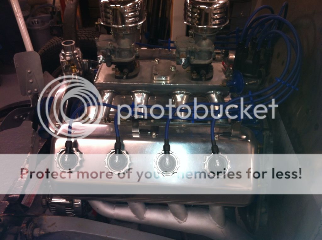

    There have been several questions in various threads concerning making one's own intake. Where possible, I like to use aluminum for weight reduction.
    My problem......I cannot weld, period. But there is a guy up the road aways that can weld the wings of a fly together in midair, so not a problem for me.
    Anyway, when making a manifold, one can easily acquire the following:
    (1) The slab that fits against the head(s). Acquire a piece of aluminum sheet. 1/2 inch is normally sufficiently thick.
    (2) The slab for the carburetor mounting. Acquire a junk carburetor with the same aluminum flange, and cut the flange from the throttle body.
    (3) Runners. Aluminum tubing in straights, 15's, 30's, 45's, and 90's is readily available from an electrical supply house. Its called conduit.
    By doing ones homework, one can really produce some fairly decent product that looks good as well as working.
    And this is not an ad for me to do one for you, I won't. This is simply a suggestion of one way to go about the process.
