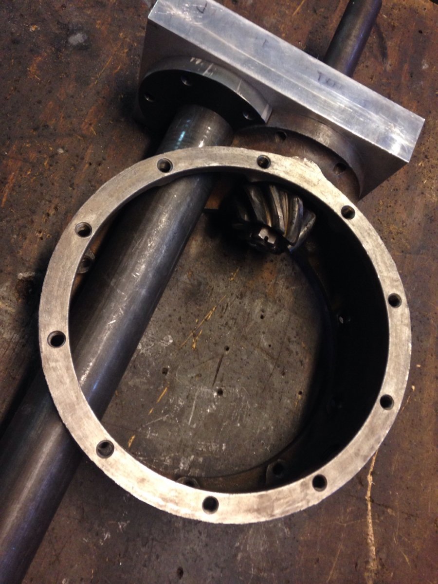

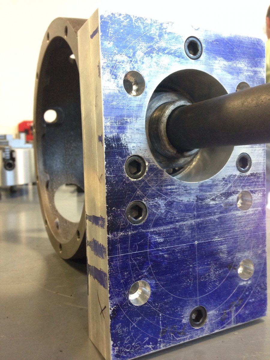

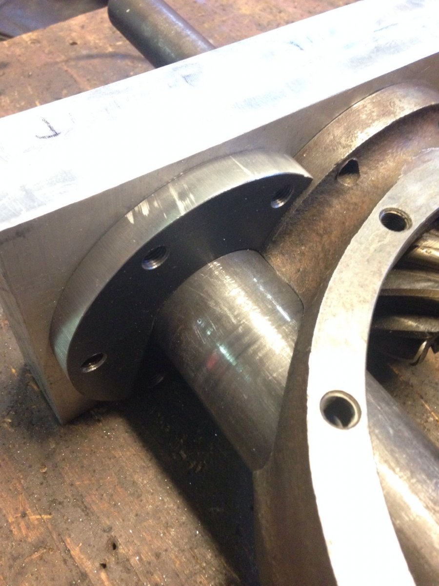

    image.jpg image.jpg image.jpg image.jpg image.jpg Fellas,
    I've been slogging through making a homemade version of the model A halibrand QC (101) for my roadster and am now on the home stretch. I have one quick question for anyone that may have a lower shaft (the one that p***es through the case). What is the
    diameter of the thin part of the shaft where it p***es through the the center of the case?
    I've got the two ends splined and the bearing surfaces turned but do not know what a good diameter would be for the middle nine or so inches. I hope I'm making sense.
    Attached are a few pics of the process. I haven't taken any pics of the lower shaft but will soon. Thanks in advance.

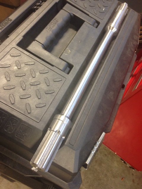

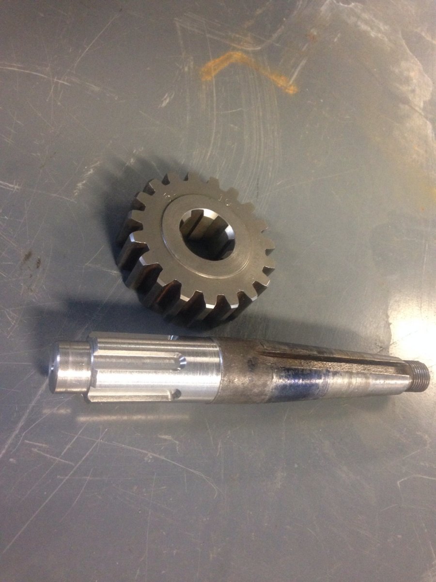

    image.jpg image.jpg Ok. Here is the finished lower shaft. This part took some time as I do not have any reference
    to go by. I am happy with the result. A few more steps and we will be ready for welding this thing together!

    Nice work! Where did you get the cutter for your splines?
  7. Deadelvis2000
    Joined: Feb 10, 2007
    Posts: 231
    Deadelvis2000
    from Austin, TX
    I put all of the dimensions of the Ford driveshaft in Solidworks which in turn gave me the angle/floor and overall width that the tool needed. I then had a local shop grind me a tool out of carbide. Popped it in the mill and took 10 thou off per revolution using the dividing head until correct depth was achieved. I first tried it out on some delrin first to get an idea of what we were looking at (see above pic)

    I didn't think it was an off the shelf thing. Sure made the job easier I bet. when I cut mine I had to use two different cutters and several different setups to finish....well done!
