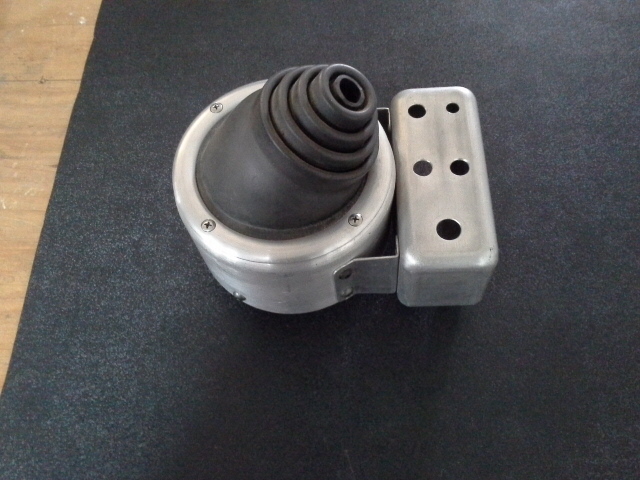

    Here is one I made using a old Hurst boot, the boot was pretty big 5 x 7 or so and fairly tall. I made a metal box with some nut certs to hold it in place.
    VANDENPLAS and egads like this.
