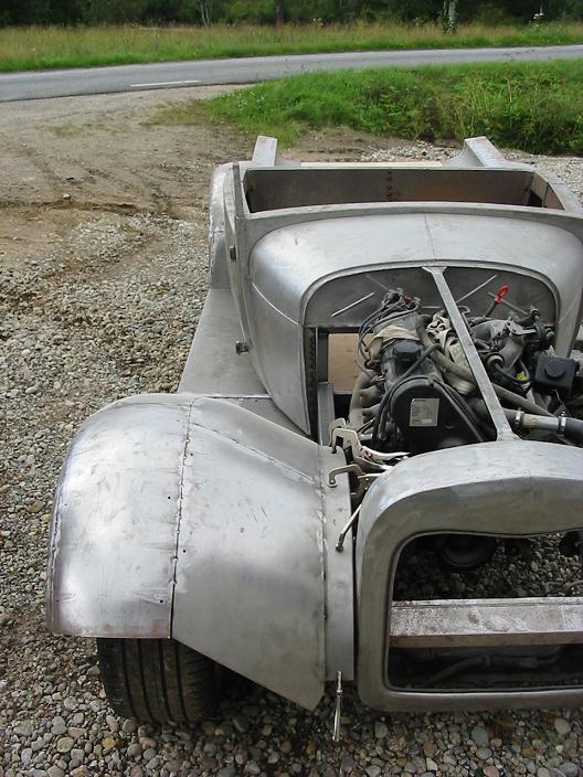

  11. Anders
    Joined: Jun 2, 2006
    Posts: 8
    Anders
    Hi gays and gals
    Ok, time to send some pictures on the projekt, I hope you like them.
    And yes, the wheels is still on:)

    Hey Anders,
    That is one hot lookin' truck you're building.............!
    What metalshaping equipment are you using to form those shrinks
    in the fenders/wings? Pullmax, Yoder powerhammer?
    Again, a great lookin' vehicle!

  21. Anders
    Joined: Jun 2, 2006
    Posts: 8
    Anders
    the shrinks are made whith a fork and hammer. twist the fork, left-right,on the edge of plate. this will give you an v-shape tuck. now hammer this tuck down, from in and out to edge. smoth with an e-wheel or hammer and dolly. one tuck shrinks about 2-3mm
  22. Anders
    Joined: Jun 2, 2006
    Posts: 8
    Anders
    al mekanik is from volvo 740. tack för berömmet:)
  23. Anders
    Joined: Jun 2, 2006
    Posts: 8
    Anders
    nop you are right on your 2 guesses, s-wheel is from volvo 240 and the new one, home made. Hej förresten
  24. pimpin paint
    Joined: May 31, 2005
    Posts: 4,937
    pimpin paint
    from so cal
    Ah, the old "wolf's tongue" (shrinking fork) bit! Your shrinks look
    very uniform in pattern. They almost look Pullmax- like in execution.
    Will the welds be metalfinished or light fill and surfacer?

    BigDanF4i
    I dig it, the hamb police might not, but i really like the look it's taking on. the only thing I think personaly looks off is the seem in the front fenders, looks like the outer shell has a nice contour but the inner doesn't quite fit up to it. just my 2 cents.
    much better than I could ever dream of doing though, nice job

  30. Anders
    Joined: Jun 2, 2006
    Posts: 8
    Anders
    sorry my english is to bad to follow what you mean, is it posible to show it in picture??
