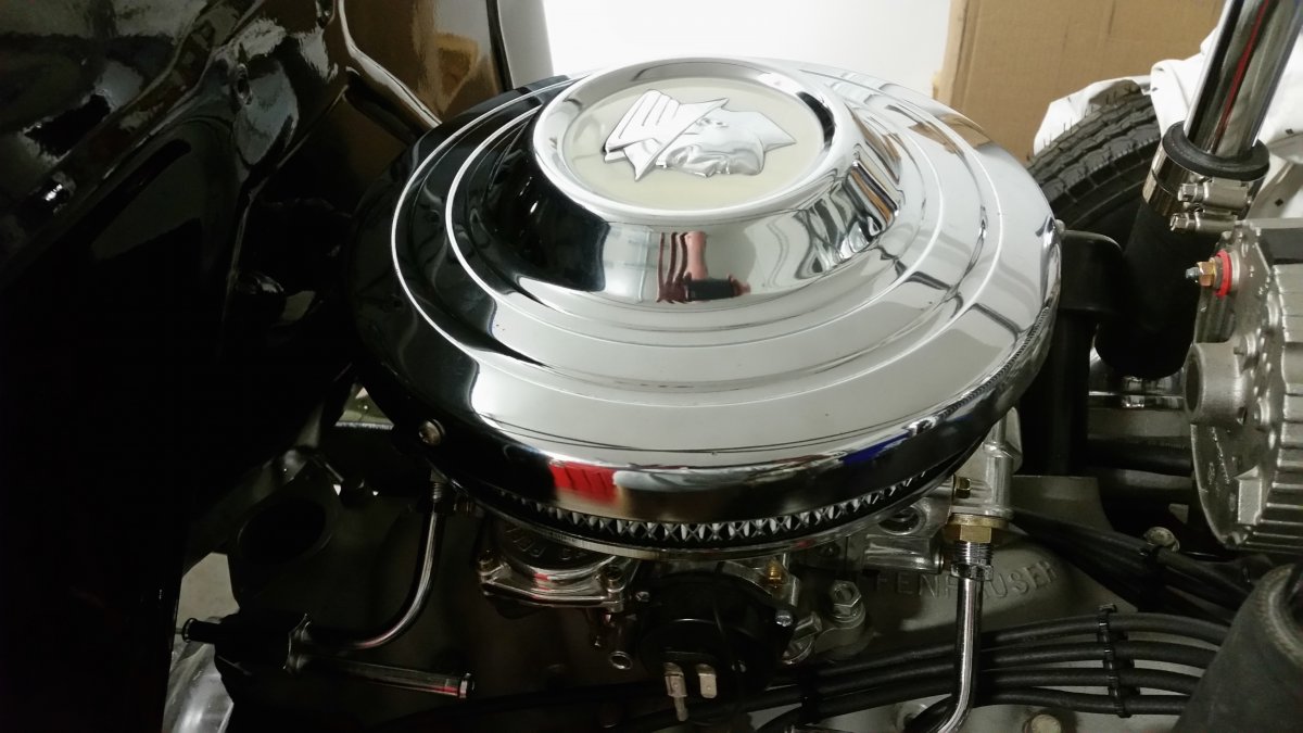

    I happened to be in a buddy's shop last weekend and he had a Mercury hubcap hanging on the wall. The thing just screamed air cleaner to me and he was nice enough to give me one of two NOS ones he had. So I bought a cheapie 10 inch round air cleaner from Speedway. I welded 3 tabs on the top cover of the air cleaner and tapped them for some screws. You put the air cleaner top on the carb the normal way with a wing nut and then set the hubcap in place over the air cleaner. Then you put 3 screws through the sides of the hub cap to lock it on. Fits perfectly, sits nice and tight. I didn't have to screw up the logo with a wing nut, and I think it looks good too. Now, lets hope the flattie doesn't backfire through the carb when this thing is mounted! Anyway here is a pic of the finished product.:D

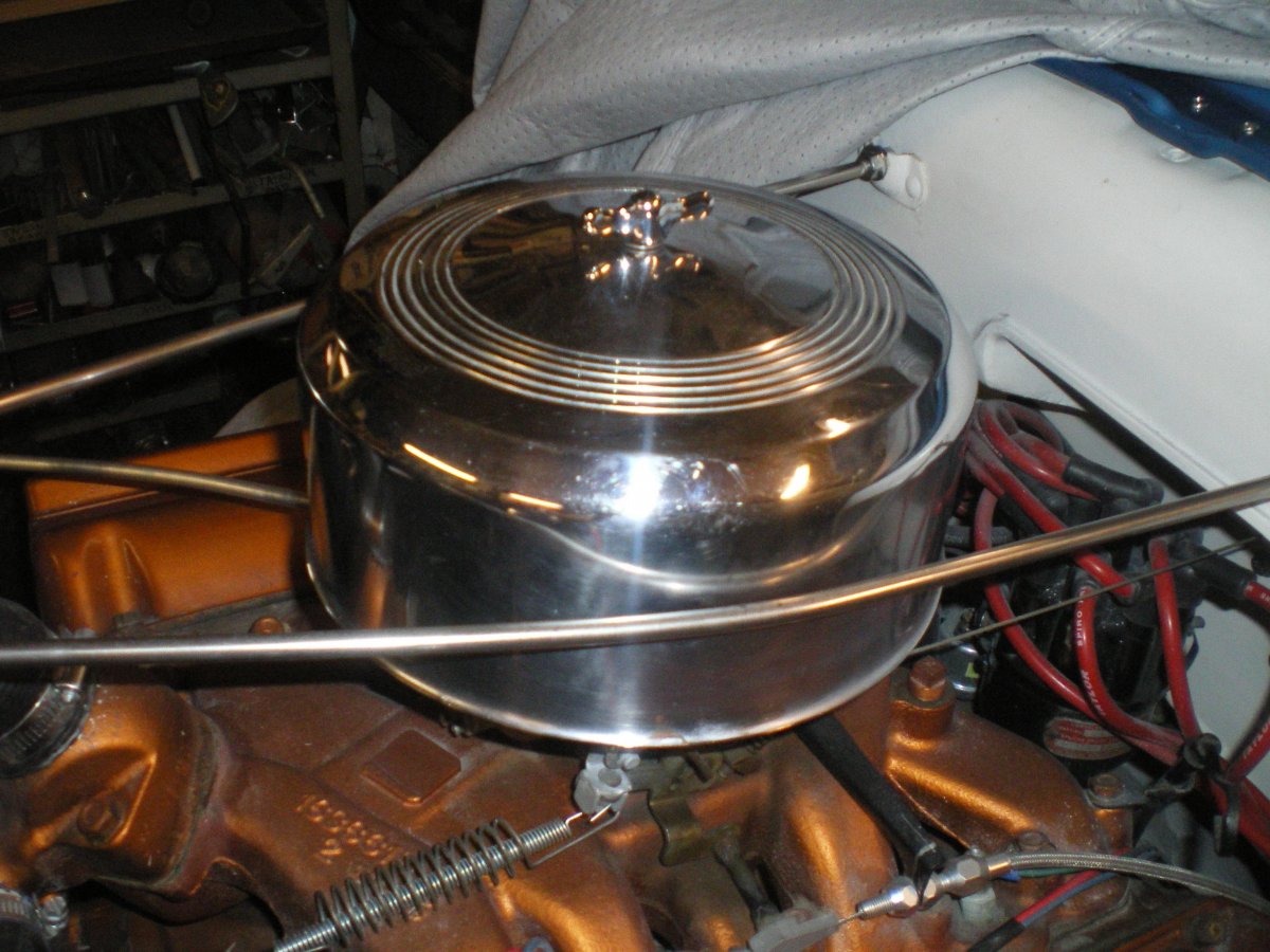

    IMG_0182.JPG IMG_0124.JPG Very nice conversation on that Merc hub cap,here's two I threw together with swap meet junk, both fit a 4 bbl.

    Here's one I made out of a Ford oil bath cleaner ( swap meet $5. ) Gutted it, welded on the bottom ring from a 12" air cleaner ( 4 bbl), stacked 2 12-29-11 032.jpg DSCN2692.JPG 6" filters, and done. Also added a bunch of 2" holes for air.
    2nd one is a V-8 cap I put on my coupe last year- some like it, some don't! It sits on a 12" base with stock filter element. ( think George Jetson)

    Guys had asked for a few more pictures of the air cleaner ***embly so here they are.
    First picture is the flathead motor the air cleaner went on. It is a 1950 8ba block bored out to 3 5/16" and the block has been relieved some. It has a 4 inch crank, a Schneider cam, adjustable lifters, aluminum timing gear, a Bubbas distributor, Offenhauser heads, and all the other standard replacement parts of a rebuild. I currently have the 4 barrel on it but also have a 3 deuce set up for it.
    Second picture is of the air cleaner dis***embled on the bench so you can see the individual parts of it. Nothing fancy just a Speedway 10" x 3 1/2" chrome 4 barrel air cleaner ***embly with 3 metal tabs welded to the top cover. Part number 2401194. Its $15. I drilled and tapped the holes for a 10-24 screw as that is what I had on hand.
    Third picture is of the air cleaner cover upside down so you can see how the tabs were installed.
    Fourth picture is of it being ***embled with one screw installed. I did 3 of them and just clocked them approximately at 6, 10 and 2. I made sure to mark/number them on the air cleaner cover and the hub cap so putting it together would be simpler. When installing that lets me put the hubcap on with a screw dead in front with the logo on the cap oriented properly and the other two screws still accessible without banging into the firewall.
    Now just need to splash a little paint on the tabs so they don't rust!:)

    Ooohhhh I get it now! A picture is worth 1000 words. You welded the tabs to the Speedway cover and mount the old cap to it! Great Idea.
