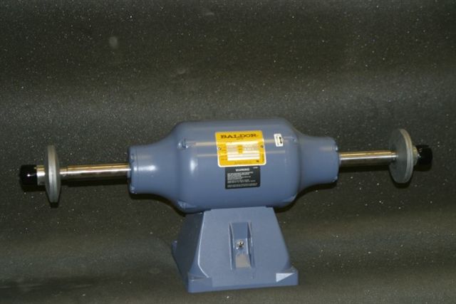

    Looks like you did a great job just cover up the pulleys and drve shaft. The best RPM for buffing that I have found is 1800 rpms.

    After reading all your comments about sshaft guarding, I'm surprised that none of the commercially available machines come with them.
  23. temper_mental
    Joined: Oct 22, 2006
    Posts: 2,717
    temper_mental
    from Texas
    I was just trying to help you out. The closed buffers you have found have shafts no more than 10 inches long. I hope you never have a issue with yours if you do please post pictures. Good luck

    I wasn't trying to discredit anyone, I really do appreciate your comments and will work on putting guards on the shafts. My only point in showing the commercial units was surprise that OSHA or some other regulator hadn't made them do something in the way of guards. My shafts stick out a little over 8" beyond the belt guard before the washer.
