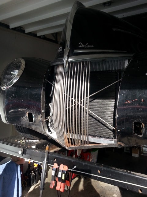

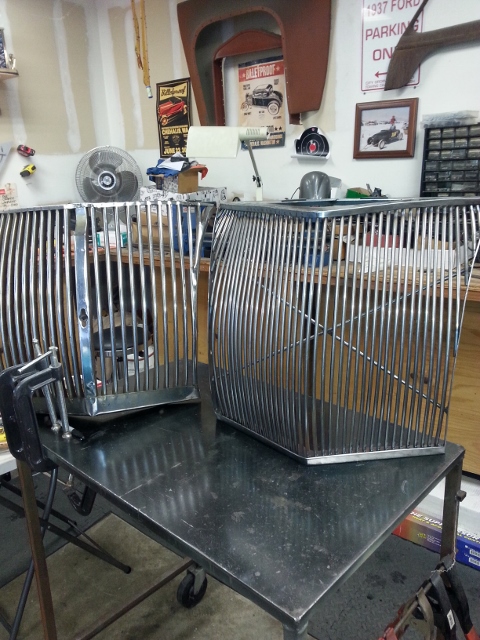

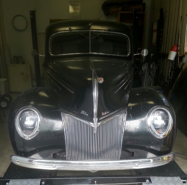

    20131104_155552 (480x640).jpg 20131214_113555 (480x640).jpg 20131224_140031 (480x640).jpg 20140116_145232-1 (640x634).jpg 20131104_155552 (480x640).jpg 20131214_113555 (480x640).jpg 20131224_140031 (480x640).jpg 20140116_145232-1 (640x634).jpg I'm almost done with my second 39 Ford Deluxe grille, this time in polished stainless. I built the first one due to not being able to find a good stock one at a reasonable price. This one is 41 rods of mild steel 5/16 inch rods that were silver powder coated. It replaced a cheap repro grille that didn't fit at all.

    Just finished the stainless grille today, starting one for a 37 Chrysler soon.

    The Speedway "special" that I took off the 39 weighed in at just over 3 pounds.... quality stuff huh?.... the home built one weighed in at 27 pounds and doubles as a bumper! Cured my ride height problem too.

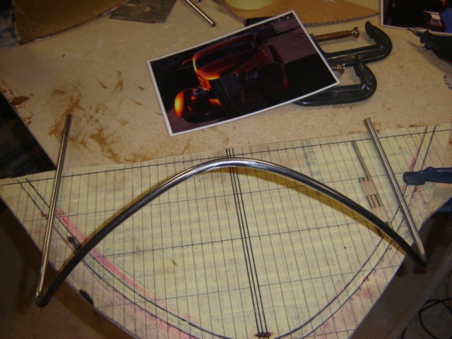

    Here is mine I used a department store clothing rack V cut the center to get the angle and contoured the ends to fit the opening Jim

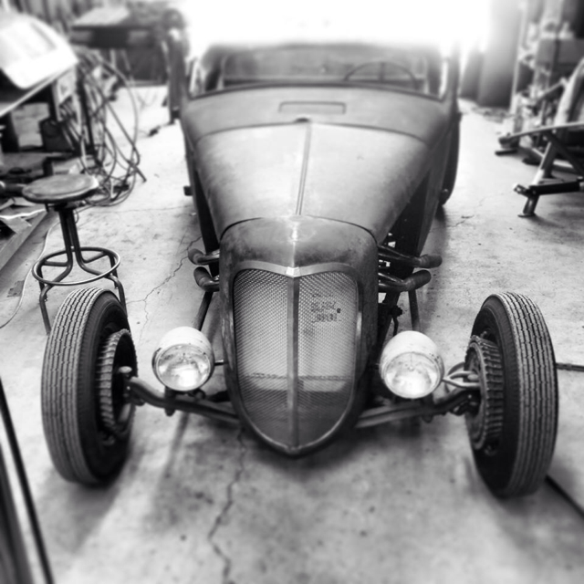

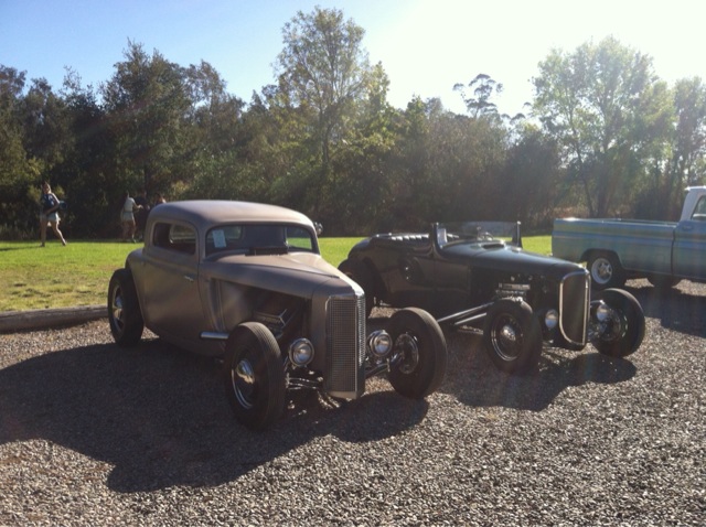

    ImageUploadedByH.A.M.B.1422161074.031875.jpg ImageUploadedByH.A.M.B.1422161116.636368.jpg ImageUploadedByH.A.M.B.1422161148.201675.jpg
    Silver car is a cut down '38 lasalle grill with a custom shell and the green car is a '38 dodge truck top half of the shell with a handmade bottom half and insert

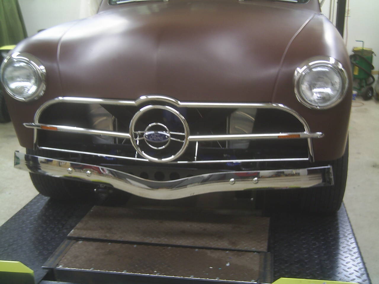

    Made this From a mg bumper

    I built this one for my '33 Willys coupe from 1/4" stainless tubing.
    And another for my '46 pickup.

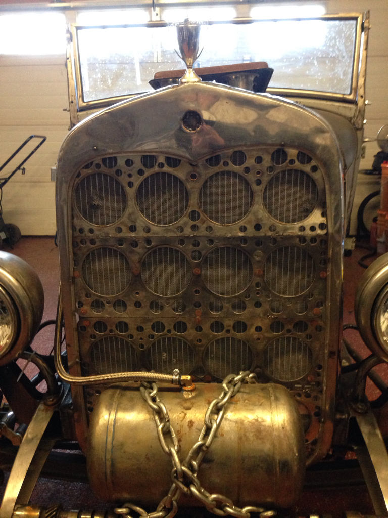

    ImageUploadedByH.A.M.B.1422210599.786039.jpg 241 hemi head gaskets I had kicking around

    First time I've seen that..... I like it!

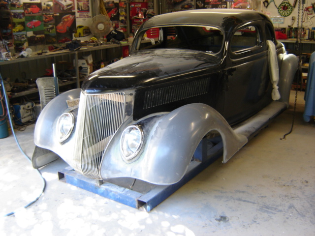

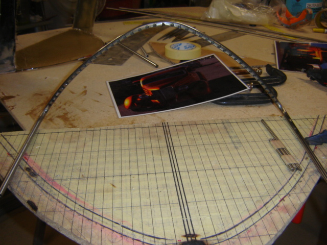

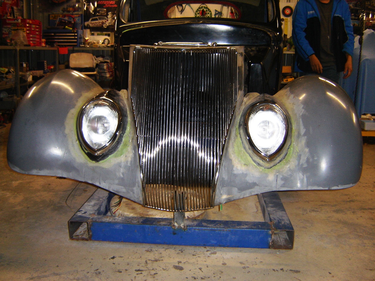

    Ok here's mine.

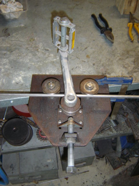

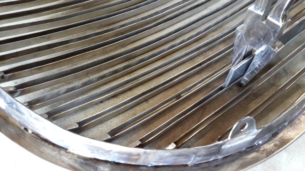

    Made using 3/8 and 1/4 SS instrument tubing.
    Each bar was hand polished then TIG welded from behind.
    I made up a roller to form each bar as they were all different.
    No, I would'nt do another one in a hurry
    The 37 headlights have long gone for good reason and replaced with dropped 36 headlights, the grille has been put aside to go in my steel 3W coupe once this fibregl*** piece of **** is finished.

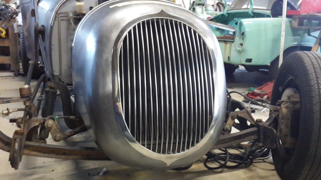

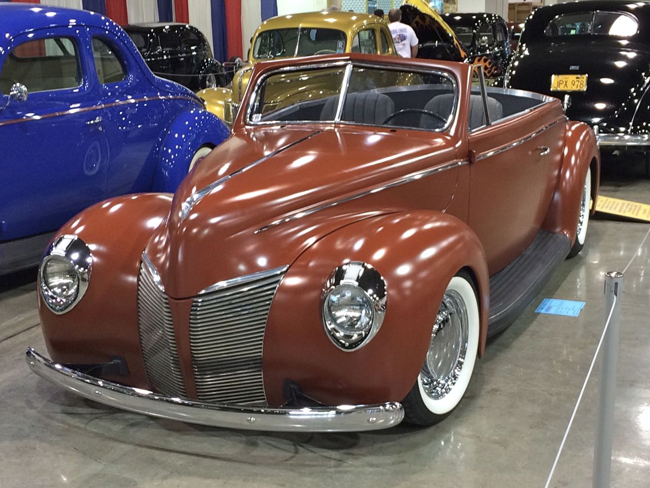

    Don Dillard built this from scratch for my '40 ford. Appearance is based on a '40 Merc, but reduced in size to fit the cut-down 40 Standard opening. Bars were water-jet cut from stainless; eyebrows above them were carved from aluminum:

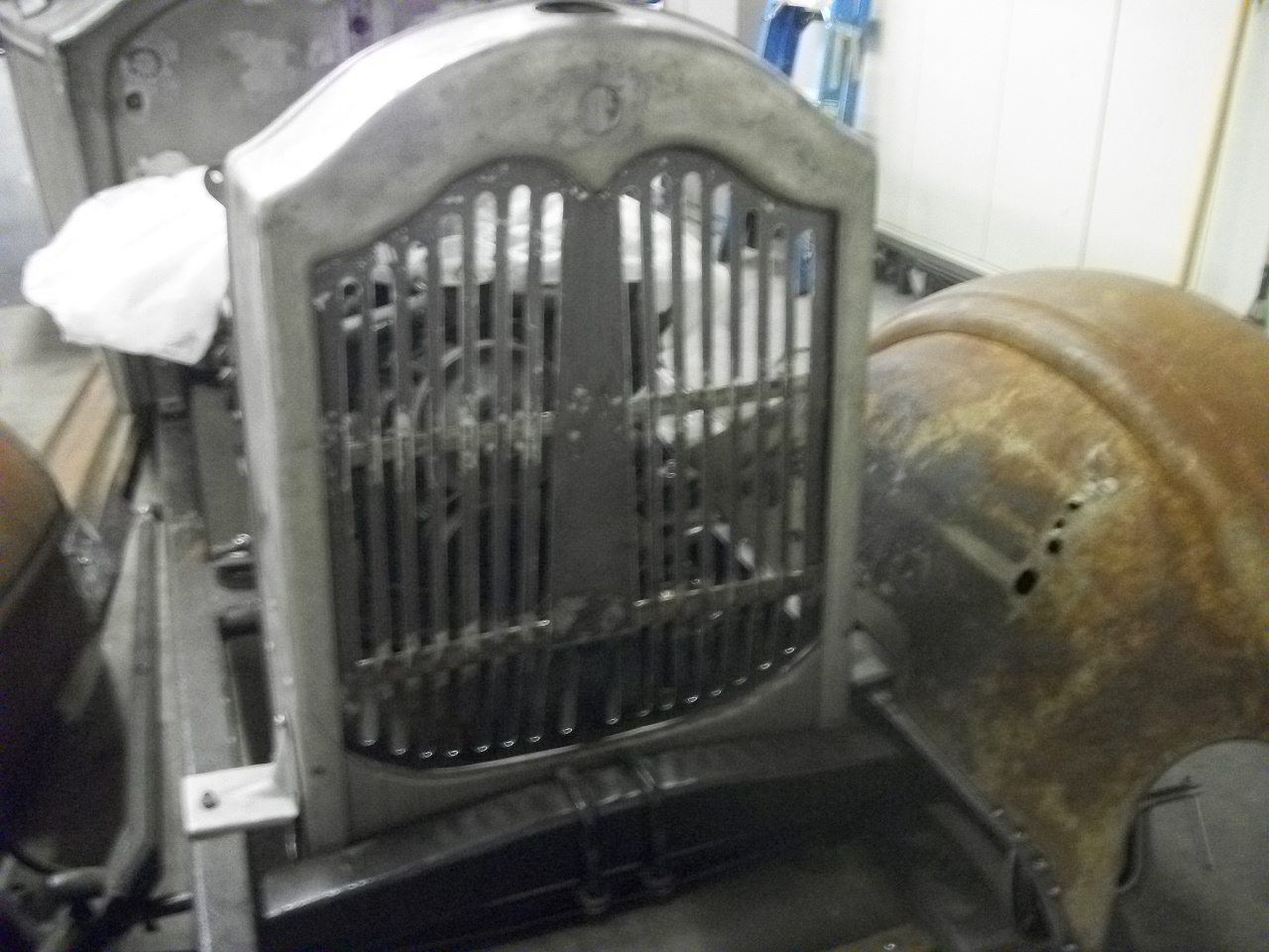

    This is the grille that got me started!!!!! It inspired me to do one of my own, then two and now three!. 50 Fraud's build thread is second to none. I've followed it from it's beginning.
    50Fraud likes this.

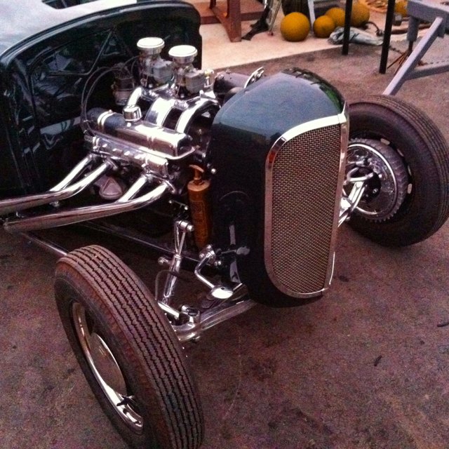

    Biscayne right after paint.jpg Here is my '63 Biscayne:
    Standard steel mesh background.
    Harley Davidson headlights
    '55 Chevy Grille Bar
    Porsche headlight surrounds.
