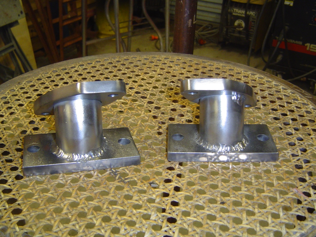

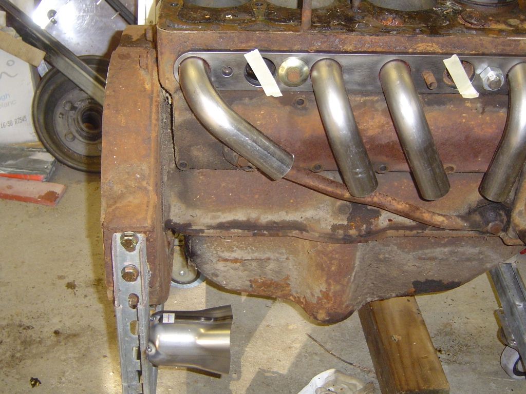

    I thought I might share some photos of my home made header for my right hand drive Model A.
    Brendan

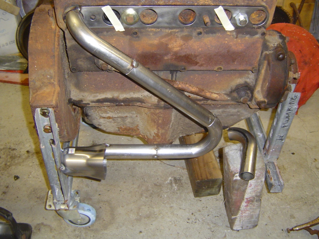

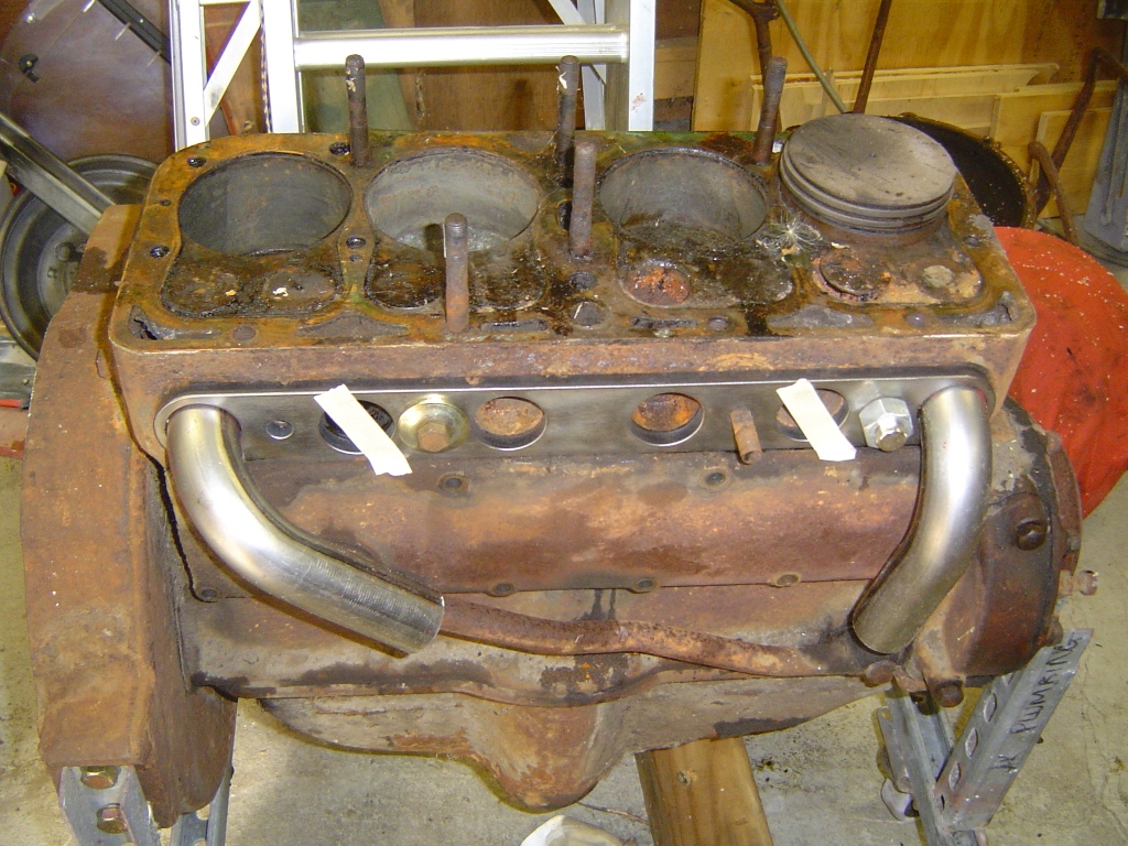

    Note the collector tacked to the engine stand.
    Just a matter of running the 1/12 tubes from the flange to the collector

    This is my first attempt at Tig welding, so my welds are not very pretty, it is very much like oxy welding.

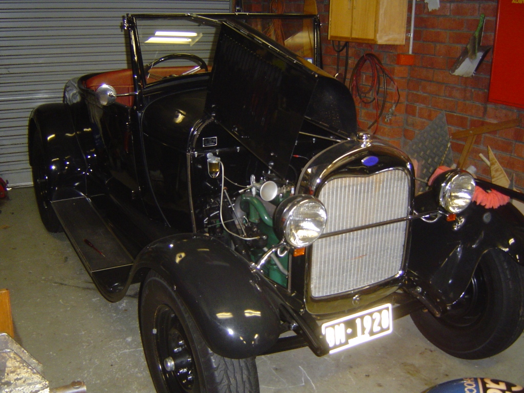

    Well here it is, started life for me as a rusty wreck.

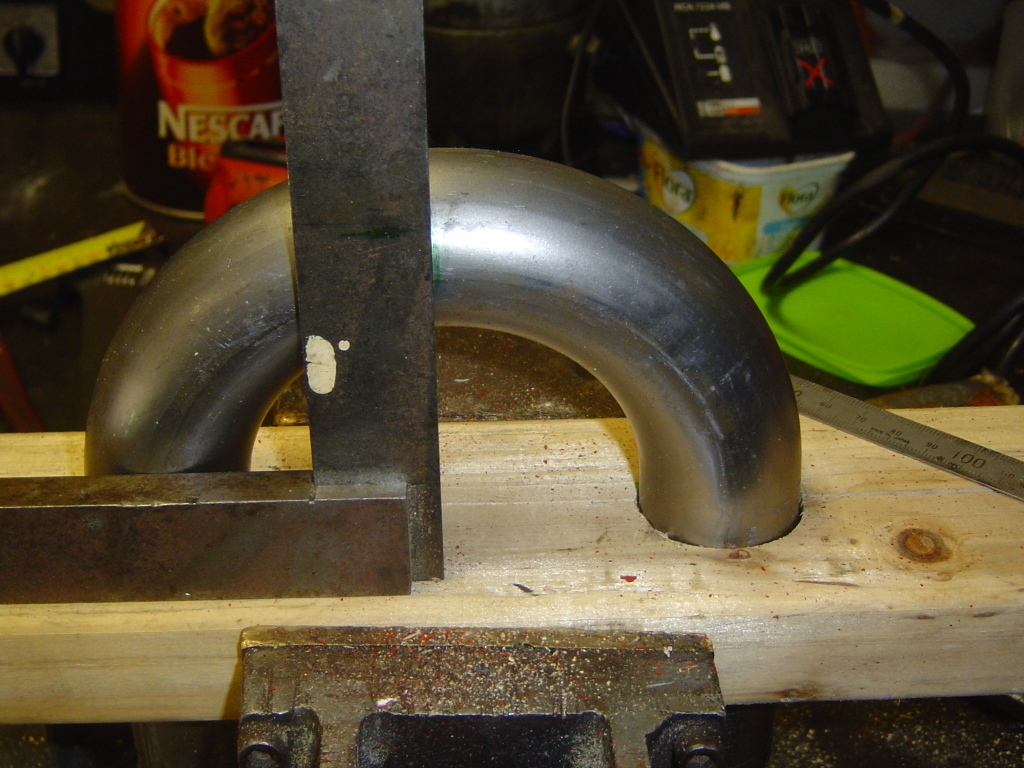

    Nice job, Brendan. My A needs a header. Never thought of
    Using wood for mockup tool. Thanks for the post.

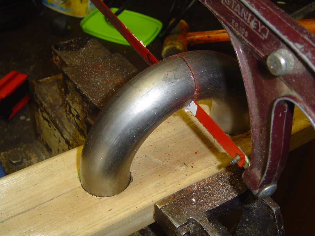

    The tubes are hard to hold for cutting so I drilled 2 inch and 1/2 holes in a piece of pine frame then cut it long ways so it clamps the tube for cutting.
    Brendan

    that's a REALLY neat roadster. can't wait to see it with the header on.

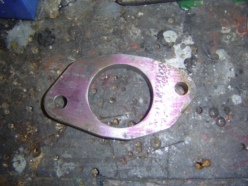

    For your next attempt , weld only the tube to the inside of the flange and then use a silicone/bronze tig rod on the outside of the flange as that will give strenth but not cause the tube to become brittle and crack.
