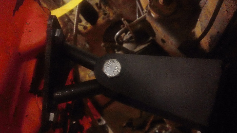

    Modified FatMan mounts.

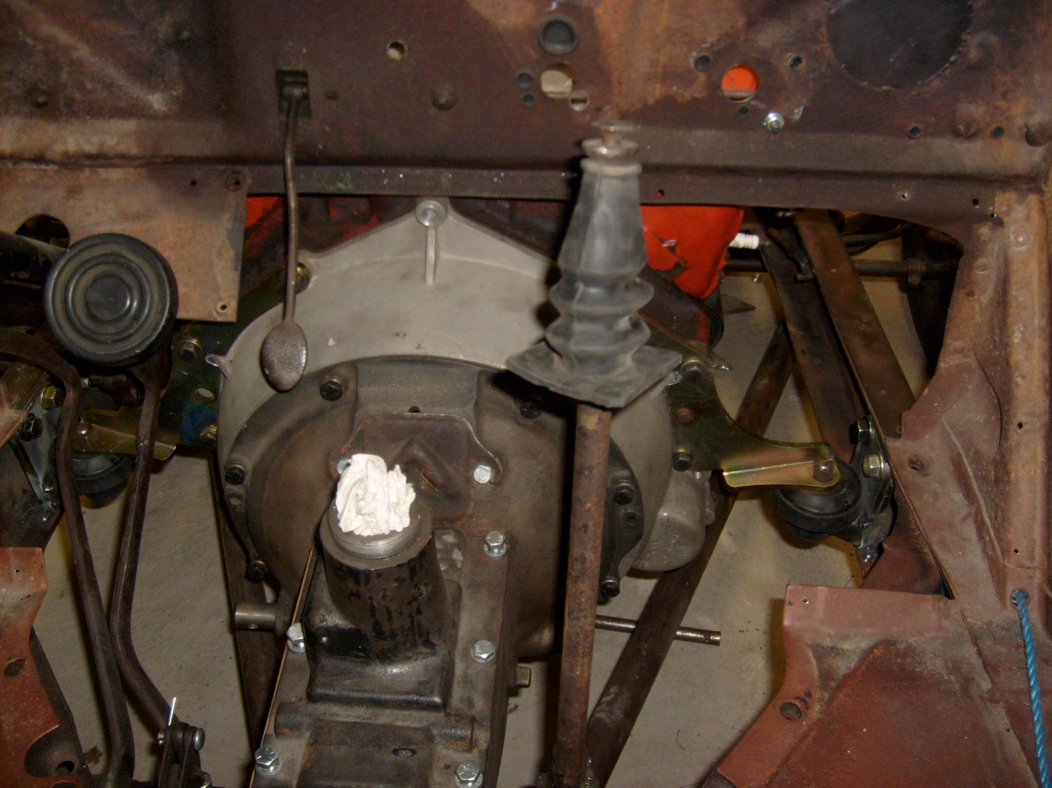

    33 ford, front mounts and rear mounts, it's a 57 283 engine so there is no mid engine mounting bosses.
    Hopefully won't break the bellhouse because there is no transmission mount. The transmission will be hangin loose :)

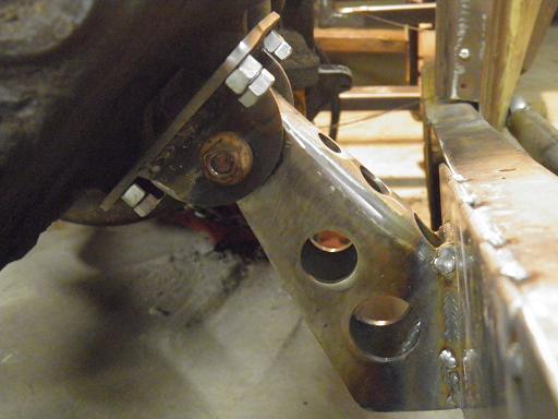

    We sell these , tigg welded

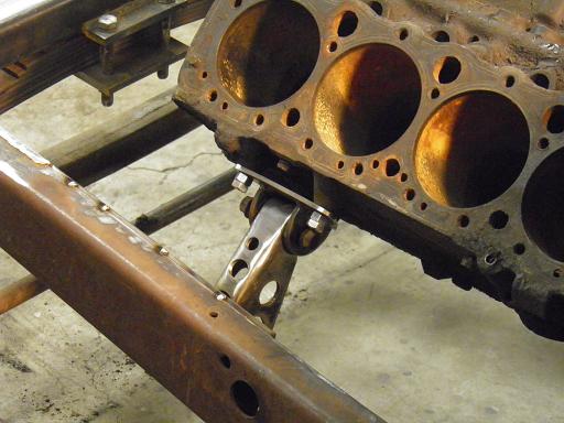

    LT1 in my MGB project
