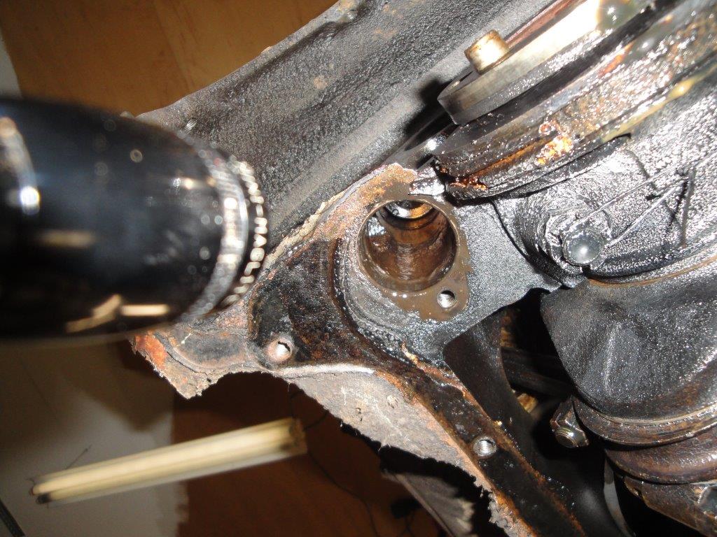

    I made up a doodad to use a slide hammer to remove a stuck Flathead oil pump.
    A plate bolts to the pump in place of the cover.
    5/8-18 threaded rod screws into the plate. And I reused the "hammer" from an axle puller.
    I was concerned about breaking the little tabs off the pump, so I used it carefully.

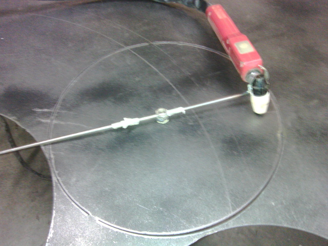

    Not much, but I needed to replace the dust shields on an Alfa Giullia front drums : 3 nuts, 1 screw, some rod and a hose clamp, now I can cut circles to 1 meter in diameter.
    pat59, lowcoe, '51 Norm and 3 others like this.

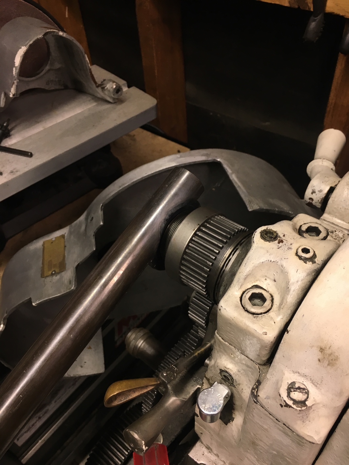

  24. cretin
    Joined: Oct 10, 2006
    Posts: 3,059
    cretin
    Here is a quick one I made at lunch today, and a bump for this thread so maybe we can see some more home made tools.
    I made this to get a stuck chuck off my South Bend lathe.
    On the rear of the spindle, there is a smooth round section which the tool clamps to.
    Then you put a piece of wood under a jaw and use the tool to break it loose.
    For those of you who may not like putting pressure on one jaw like that, it's not a ton of pressure, plus I'm replacing that chuck because it's got too much runout.
    I may make something that goes in the chuck and catches on the bed if the new one gets stuck on.

  25. GearheadsQCE
    Joined: Mar 23, 2011
    Posts: 3,670
    GearheadsQCE
    Alliance Vendor
    Perfect, I need to do that and didn't know how to old the shaft. Now I see, hold the chuck and turn the shaft!
    Thanx:)
  26. wrljet
    Joined: Feb 25, 2015
    Posts: 32
    wrljet
    Dunno how stuck your chuck was, but you can usually just engage backgear and put a Crescent wrench on a jaw.
  27. GearheadsQCE
    Posts: 3,670
    GearheadsQCE
    Alliance Vendor
    Well, I'll try that first.
  28. wrljet
    Posts: 32
    wrljet
    Don't force it. Protect the bed ways with a board, in case you lose control of the wrench when it breaks loose.
    -Bill
  29. cretin
    Posts: 3,059
    cretin
    I do it this way because it eliminates the possibility of breaking a tooth on the backgear.
    JOYFLEA likes this.
  30. wrljet
    Posts: 32
    wrljet
    Yes, you need to be careful. But I've done it for 30 years w/o a problem.
