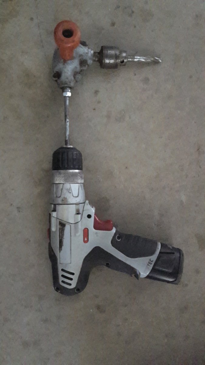

    Sometimes you got to get into a tight spot and make a hole.
    In addition to the right angle Drive I had to extend the input shaft considerably and cut a drill bit in half and sharpen it, in order to drill around a corner.
    It was damn hot out there too...
    On the other side of the house the thermometer said 108 and the official Airport temperature was only 105 that day.
    I was lying on the concrete underneath the trailer drilling holes around corners.

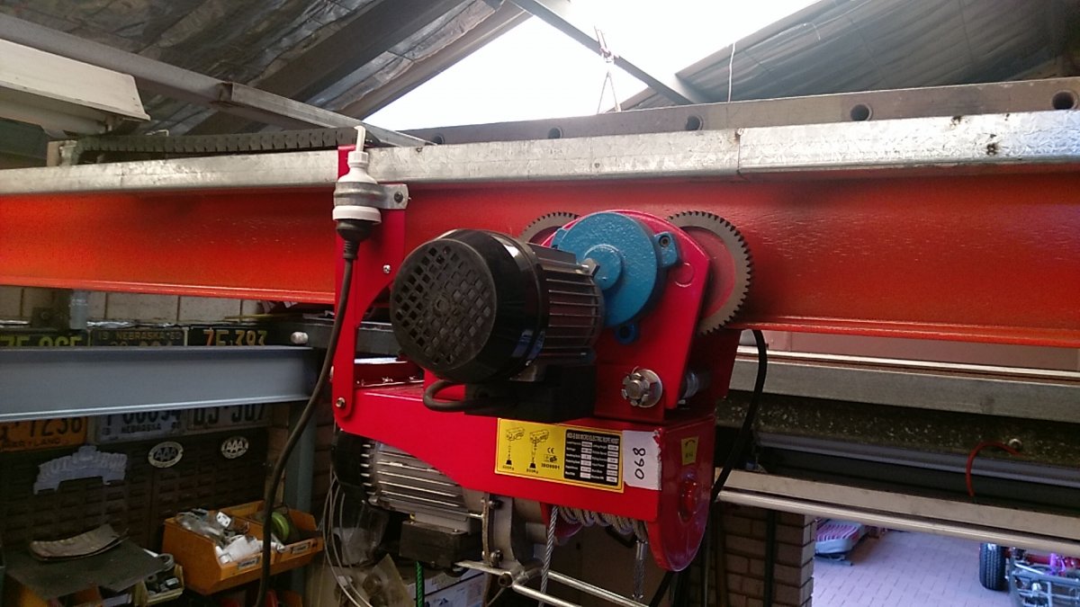

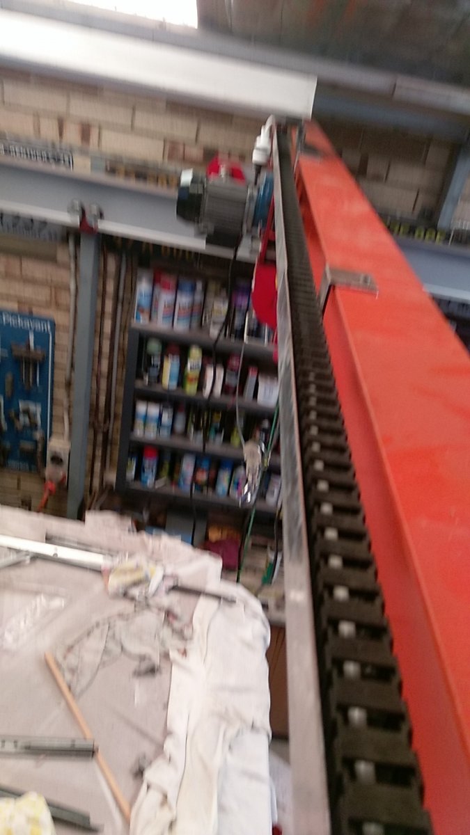

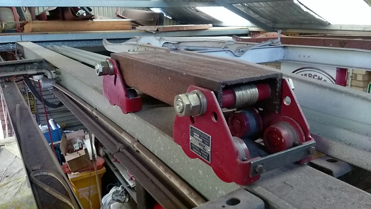

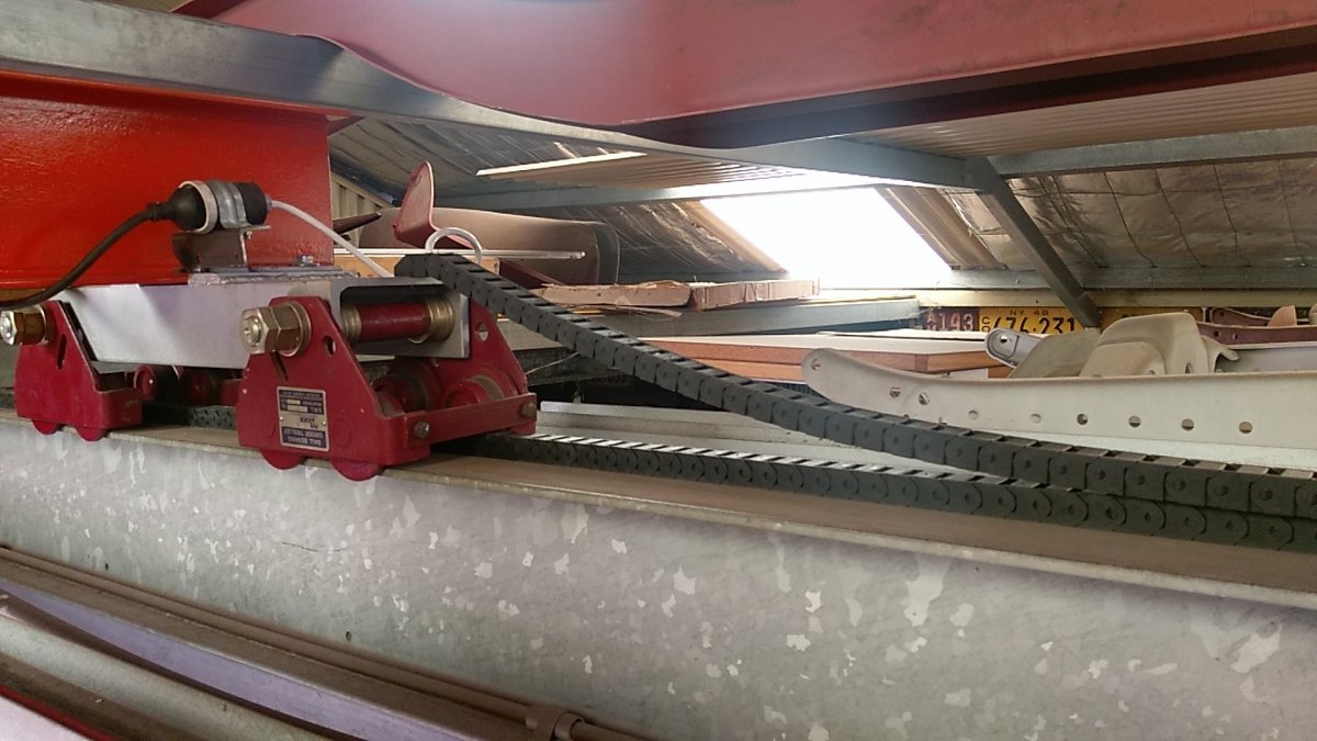

    I decided that I was tired of not having enough space when my project was in my shop as I would always have trouble finding space to manoeuvre my shop crane around, so I decided to build a gantry crane over my main work area.
    I now have a crane that will traverse about 16 feet in two directions and winch up 1750lbs of load.
    My winch is electric and will lift as well as traverse in one direction under power.
    Running the power cables took a little figuring out but once done it is great.
    I am saving heaps on beer as I don't need to bribe my buddies over every time I need to move my body or do some heavy lifting.
    I have enough lift height to be able to lift a stock model A or T body off and on the frame with ease.
    My sore back is loving it...

  28. Jethro
    Joined: Mar 5, 2001
    Posts: 1,954
    Jethro
    FiftyV8, that lift is a thing of beauty! Full on industrial ****! I would bring you beer just to watch it work.....Nice job!

    Joined: Feb 26, 2014
    Posts: 1,775
    Ulu
    from CenCal
    @fiftyv8
    That looks like one of those projects that started out as a simple idea and turned into a whole lot of work. It came out beautiful though.
    RMONTY and cretin like this.
  30. What size beams did you use?
