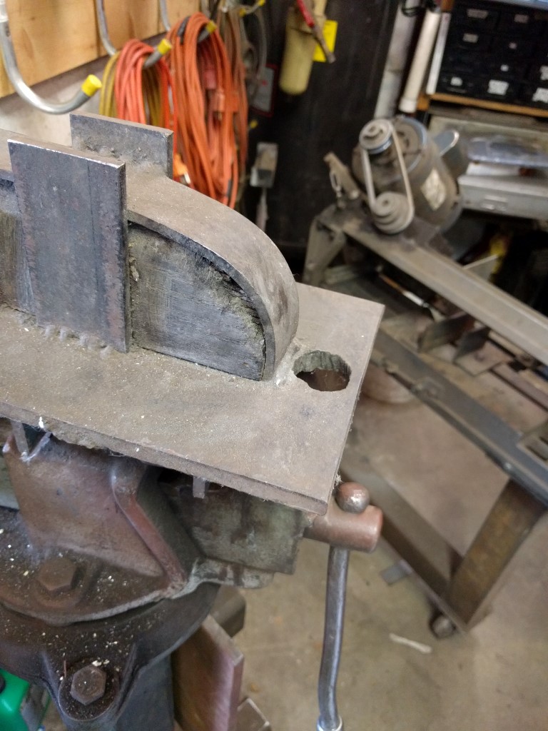

    Copied a U-bend cutting guide from an earlier post on the HAMB and had to dig out another old tool, if I can even call it that, from the '70's. My simple; but really handy band saw table "enlarger". Still comes in handy a couple times a year.

    Rich B, I did the same thing with my bandsaw. I tapped a couple of holes on the bandsaw plate and attach a piece of 1/8" plate with flathead screws. It does come in handy.

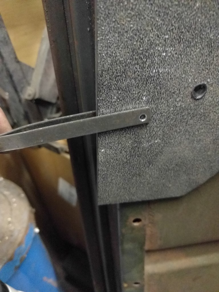

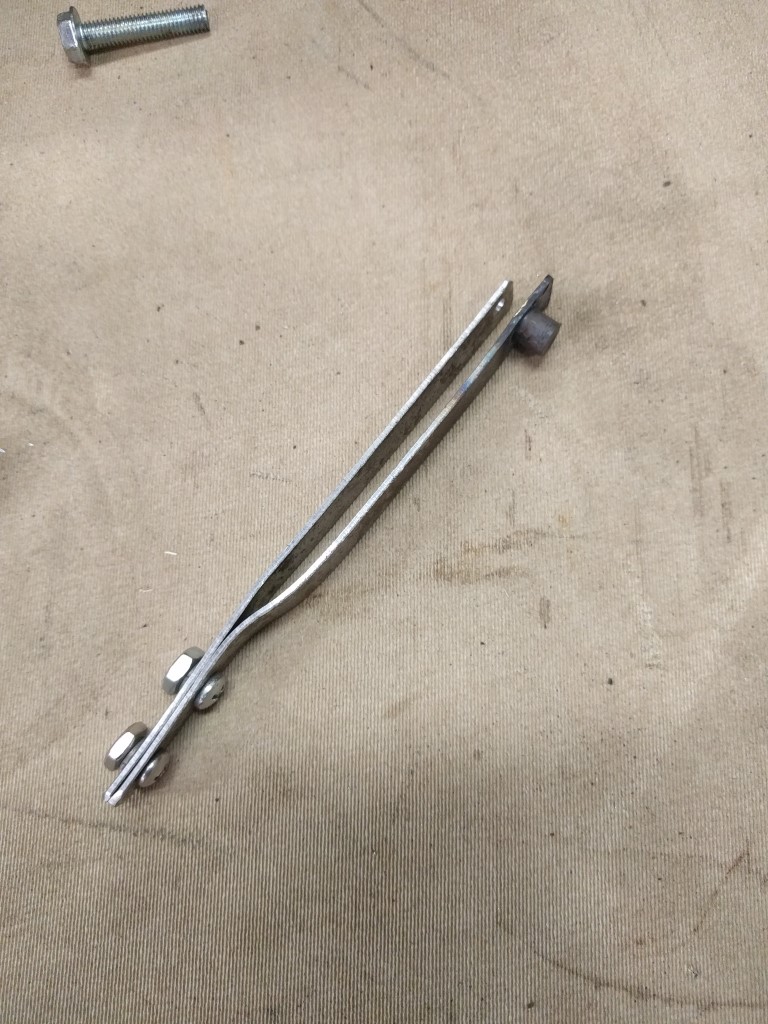

    After a disastrous lesson that a clear vinyl pattern is considerably bigger at 95 degrees than when it was made at 60 degrees; I made a little tool this morning to transfer the hole location to the actual ABS door card once hung in place over the handles. Of course it started raining, so I won't get to start on the panels this afternoon.

    There is a similar tool made for locating the hole centers for Dzus ****ons in body panels.

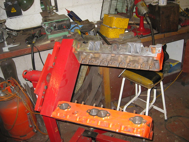

    Like Cliff in the post above, I have been using engine stands for other stuff in my workshop. They're easy to adapt for other work by adding a couple of bits of s**** steel and are really useful for doing cylinder head work.
    The rotate and lock feature of the stand makes access easy.
    It also brings the heads to a good height to work on them whilst sitting down.
    I have adapted my engine stands for rebuilding rear ends too; 12 bolt truck
    9" Ford
    Jag IRS
  29. How about details on that grey stand? Also, I like the red one with the grid pattern of holes.

    The grey stand is a British made "Churchill" engine stand.
    It is labelled as having the same weight capacity as my other Cheapanese engine stand which supposedly has a 410 Kilo/900 lb capacity also. There's been no noticeable deflection on the Churchill stand even with a complete Jag XK engine loaded on; I don't think I'd try that on the other stand:cool:
