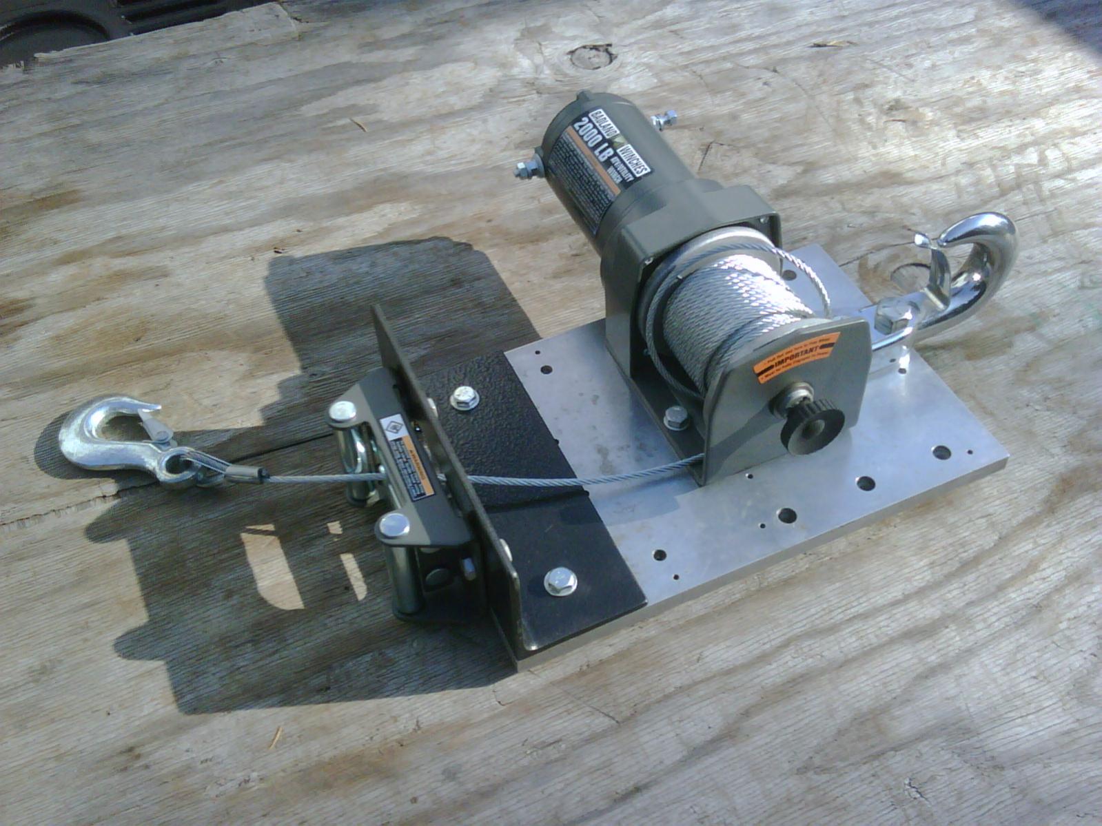

  1. I know this is an older posting, but it is gold. I am going to make an attachment so I can plug the winch into my trailer hitch for jobs around the yard.
    loudbang and biggeorge like this.
  2. bkap
    Joined: Dec 2, 2007
    Posts: 119
    bkap
    Timely idea on the bed winch. Any other ideas on attachment at the front of the bed? I'd rather not drill holes in the bed. Anyone use the stock tie downs on a late model Silverado, loops located low on the sides near the front?

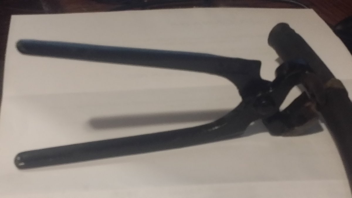

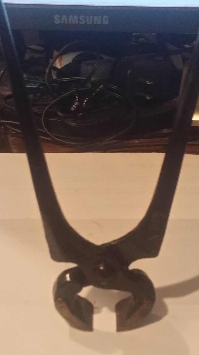

  3. Today I was removing a miserable hose clamp, and had an idea. I got my nippers out of the tool box, and voila, it worked so well I got su****ious.

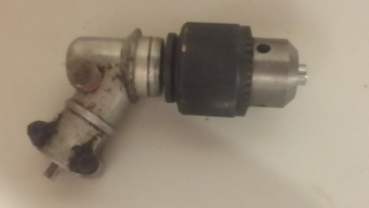

    The other tool, is a 1/2 inch angle adapter I made from a spare chuck and the head of a weed trimmer. I have a handle to stabilize it, and I can add extensions for doing things such as drilling between the rafters. I had to do some machining, but it was simple to do.

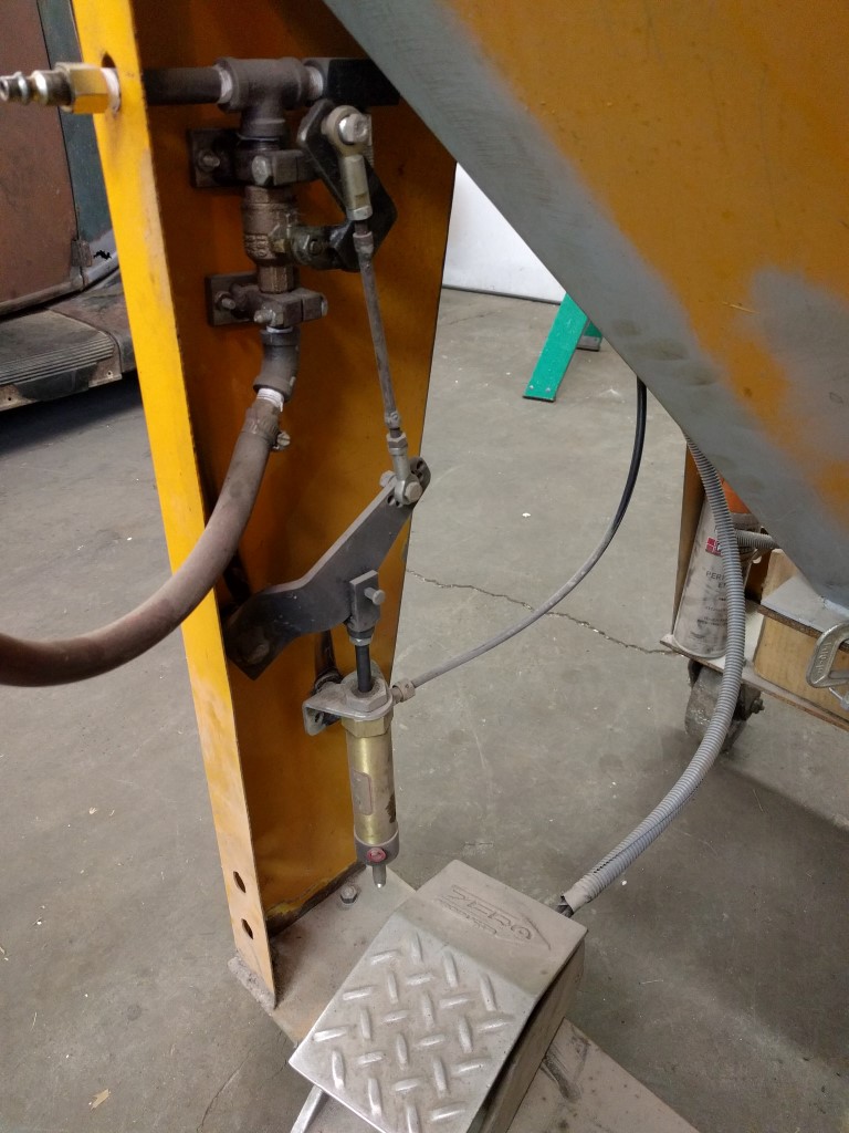

    Moving stuff around the other day, thought somebody might get a kick out of the Rube Goldberg air control on my homemade blast cabinet. Picked up, for cheap, a foot pedal; but it was made for a pilot operated air valve, converted the 1/8" pilot line to 1/4", hooked it up to a old boom truck throttle rev up cylinder, and connected that to a ball valve to get full air flow to the blast gun. Kinda hokey looking; but works great and was only $5 for the pedal at an auction, I had the rest of the stuff laying around.

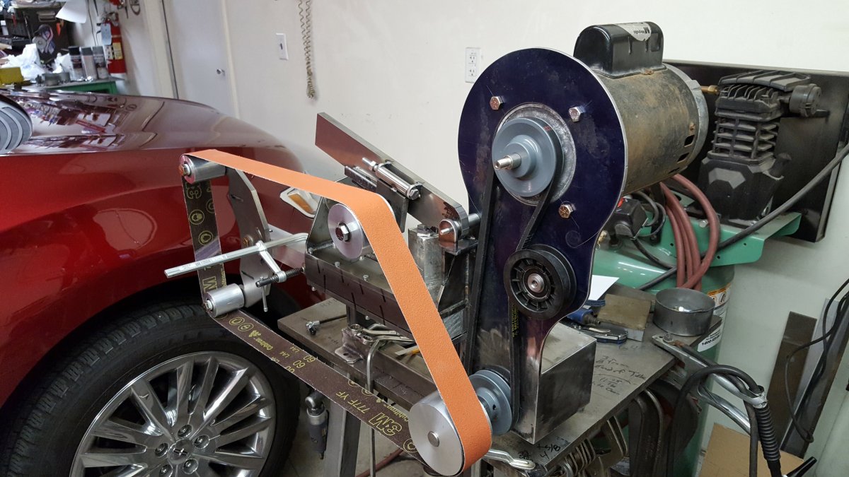

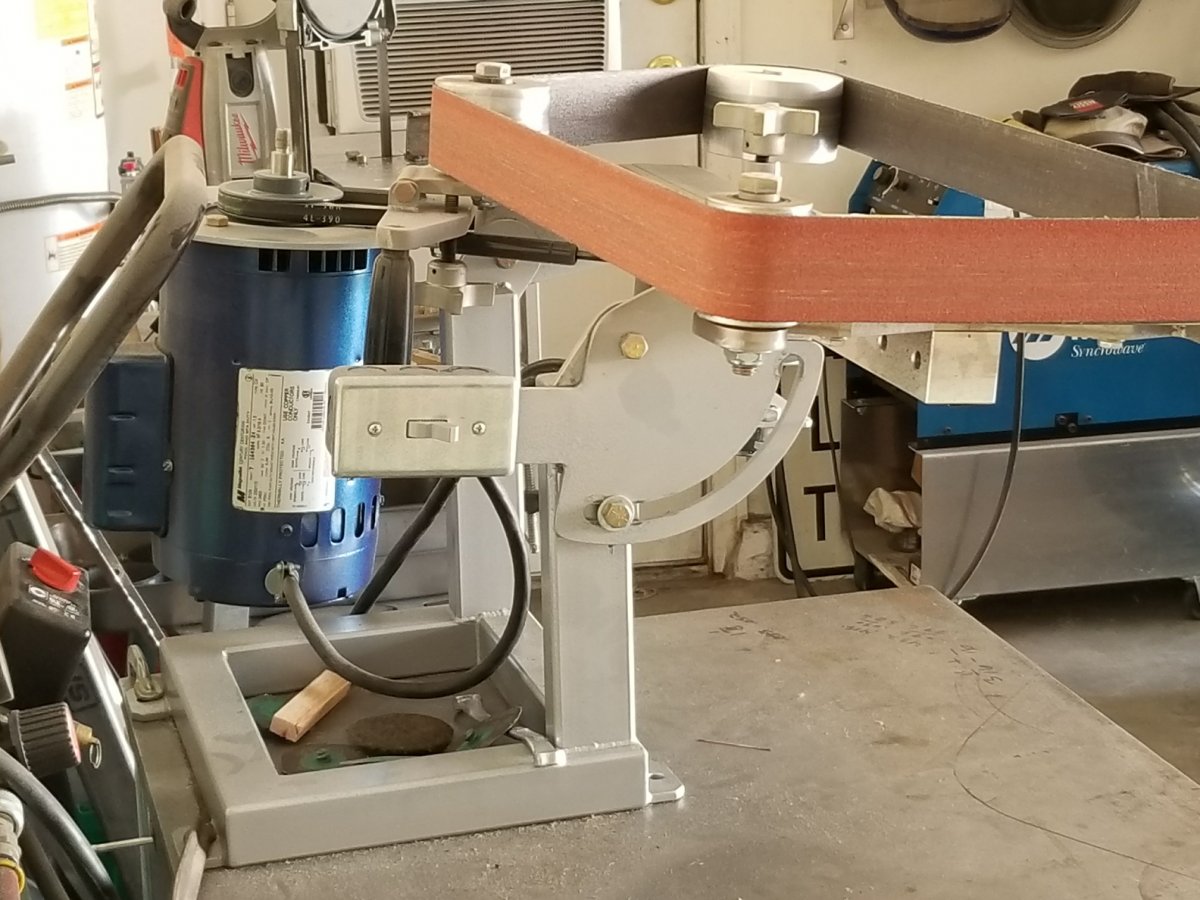

    I made this 2x72 belt grinder using a 1 1/2 hp pool pump motor
    Very handy when building hot rods

    HOW ABOUT A FEW PICS OF HOW THE PUMP RUNS IT PLEASE.
    THANKS
  7. Camsore
    Joined: Aug 28, 2011
    Posts: 47
    Camsore
    from Las Vegas
    Removed the pump and put on a v pulley
    RMR&C, duncan, j-jock and 2 others like this.
  8. That is really nice! Do you have pictures of it being built?
    loudbang and enloe like this.
  9. Camsore
    Posts: 47
    Camsore
    from Las Vegas
    Being able to rotate 90 degrees is a great feature.
    duncan, biggeorge, JOYFLEA and 2 others like this.
  10. Camsore, I agree with Richard D- can you share any pics of your sander during the build process... or could you take pics of the individual pieces?
    Thanks!
    Mac the Yankee
  11. That is a beautifully designed tool, and the ability to rotate it will increase its functionality.

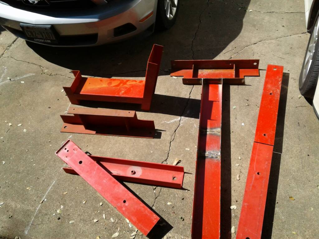

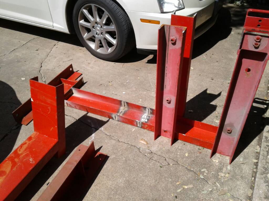

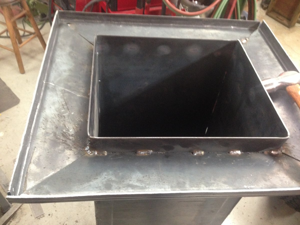

    Pulled the metal out of the dumpster at work. Anybody care to guess what it will become?
  13. treb11
    Joined: Jan 21, 2006
    Posts: 4,126
    treb11
    How about now?
  14. 56don
    Joined: Dec 11, 2005
    Posts: 10,329
    56don
  15. gatz
    Joined: Jun 2, 2011
    Posts: 2,264
    gatz
    Bench-top press?
  16. treb11
    Posts: 4,126
    treb11
    We have a winner ! I need to get a bottle jack and 2 large diameter bars so the anvil can be positioned. Yes, they are $99 at Horrible Freight, but I couldn't p*** this up.

  18. Don't you have a problem with belt windup with no platen to sand against? I can easily separate a 2x72 belt at the joint when sanding off the platen, unless the pressure is light.

    I ended up buying an inexpensive sander, which will suit my needs and not tie up my big grinder.
    But it's not one third as powerful as Camsore's.

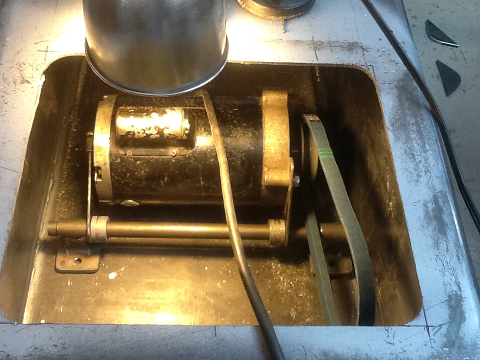

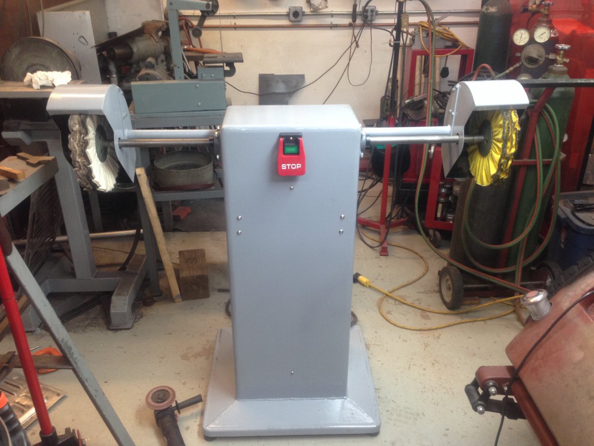

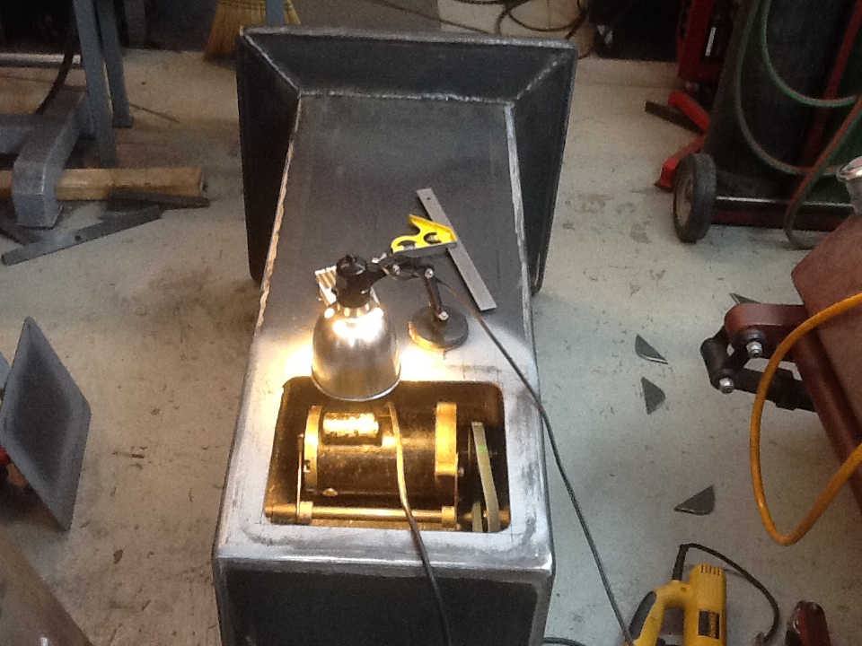

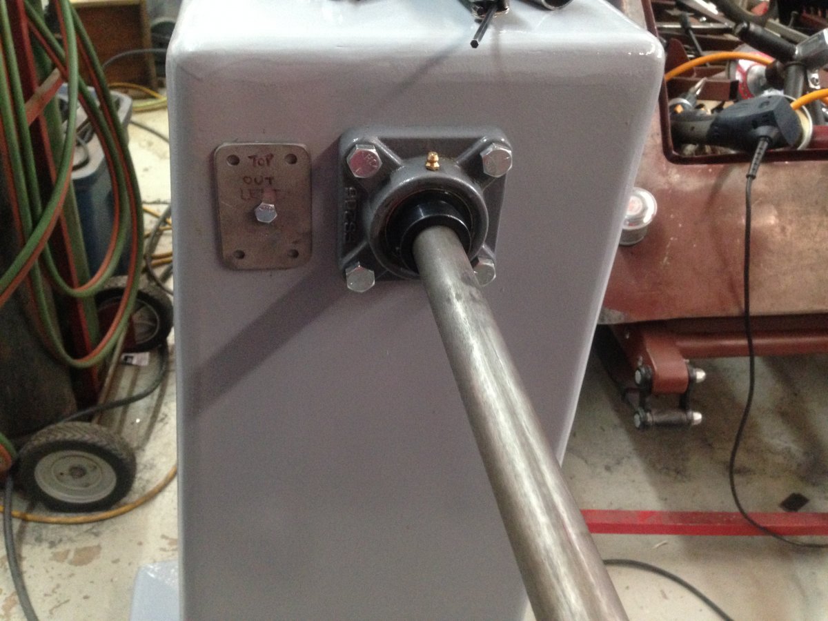

    Speaking of pool pump motors; I turned mine into a buffing machine. It is great for polishing hot rod parts.
  23. Gonna need details on this one...
    studeboy likes this.
  24. Mike Rouse
    Joined: Aug 12, 2004
    Posts: 374
    Mike Rouse

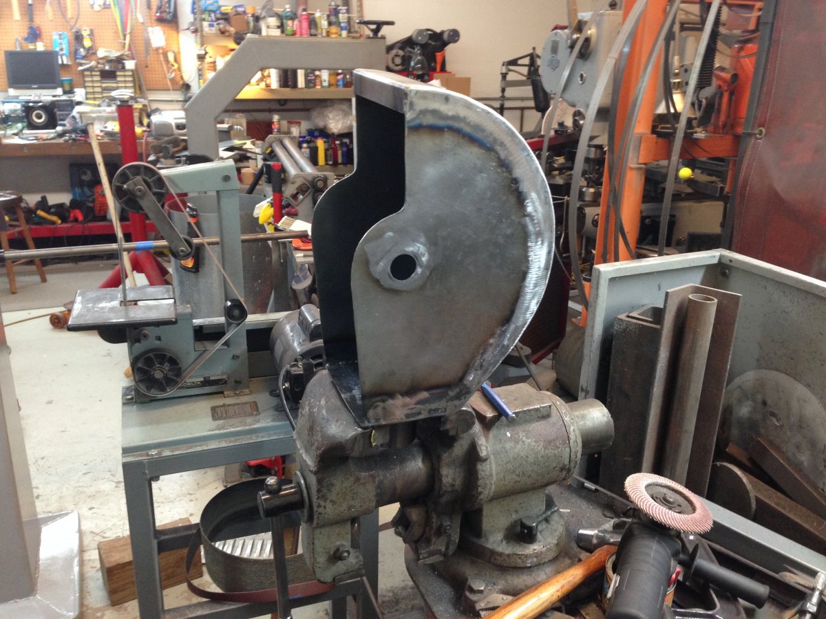

    A couple more pictures made body out of 10 gauge. Turned the edges over 45 degrees on my Pullmax Made the guards out of 16 gauge. MIG welded the whole thing up.
    Turned the 1" shaft on the lathe pressed the buff flanges in the press
    The 39 guy, saltflats, brEad and 5 others like this.
  25. bobbytnm
    Joined: Dec 16, 2008
    Posts: 1,805
    bobbytnm
    Nice work!!!
  26. J. A. Miller
    Joined: Dec 30, 2010
    Posts: 2,341
    J. A. Miller
    from Central NY
    At first I thought that was built from a pedestal box that communications outfits use when they bring underground cables to the surface.
    Very nicely made. Is the motor hinged on one side and the weight of the motor hanging is the tension for the belt?
  27. Mike Rouse
    Posts: 374
    Mike Rouse
    The motor is hinged in such a way as the reverse torque of the motor tightens the belt.
    Not just the weight of the motor but more the reverse torque that gets the job done.
    saltflats and enloe like this.

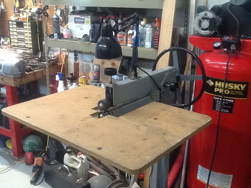

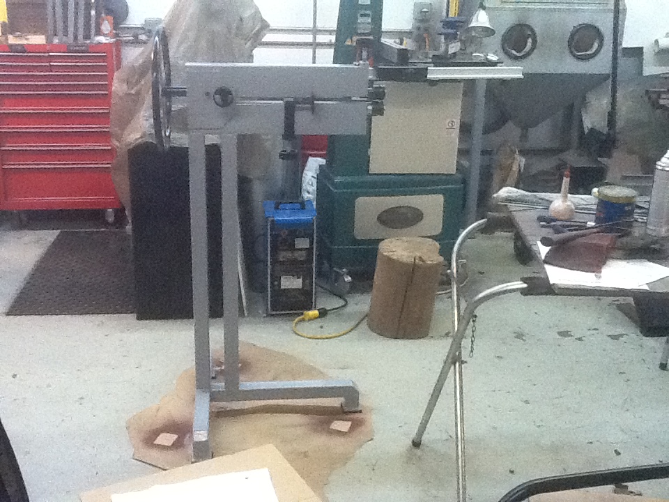

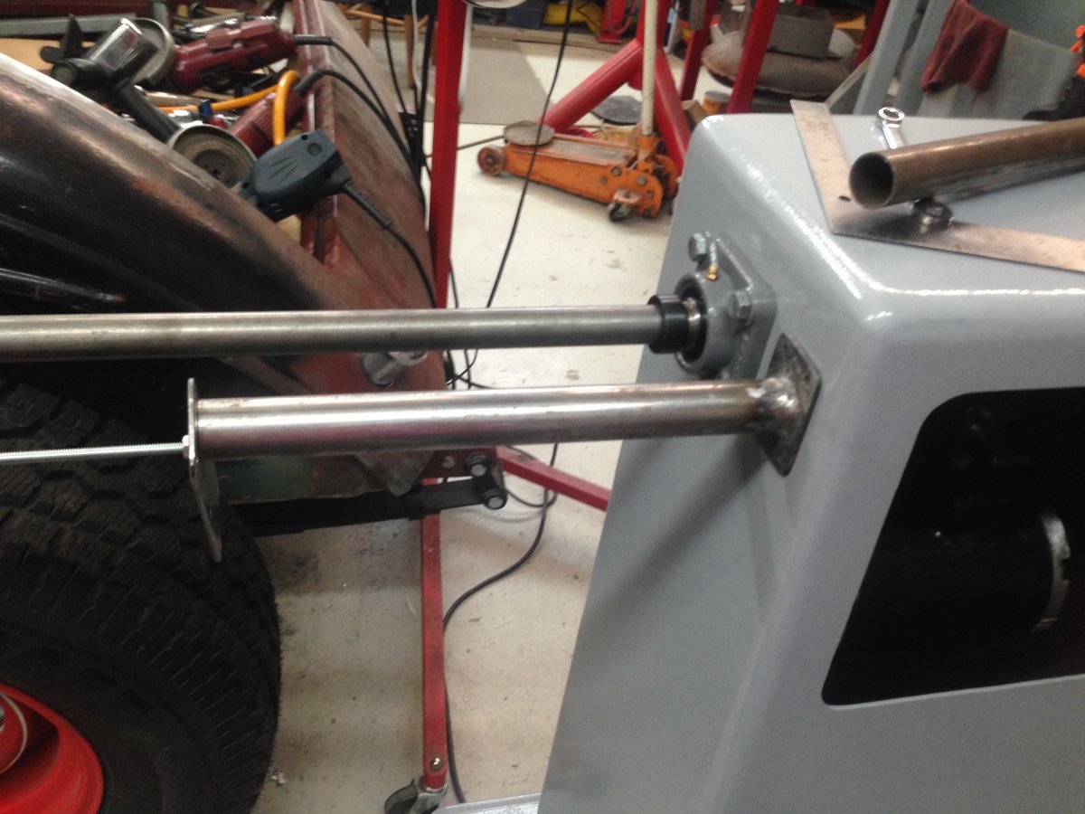

    image.jpeg Y image.jpeg image.jpeg I modified myHF bead roller to make it better.
    The table is great for working alone.
    whtbaron, Ulu, fauj and 6 others like this.
  29. bkap
    Joined: Dec 2, 2007
    Posts: 119
    bkap
    The table would come in handy around here. I can't tell how you hung it from the bead roller. Can you show how you did that? Thanks.
