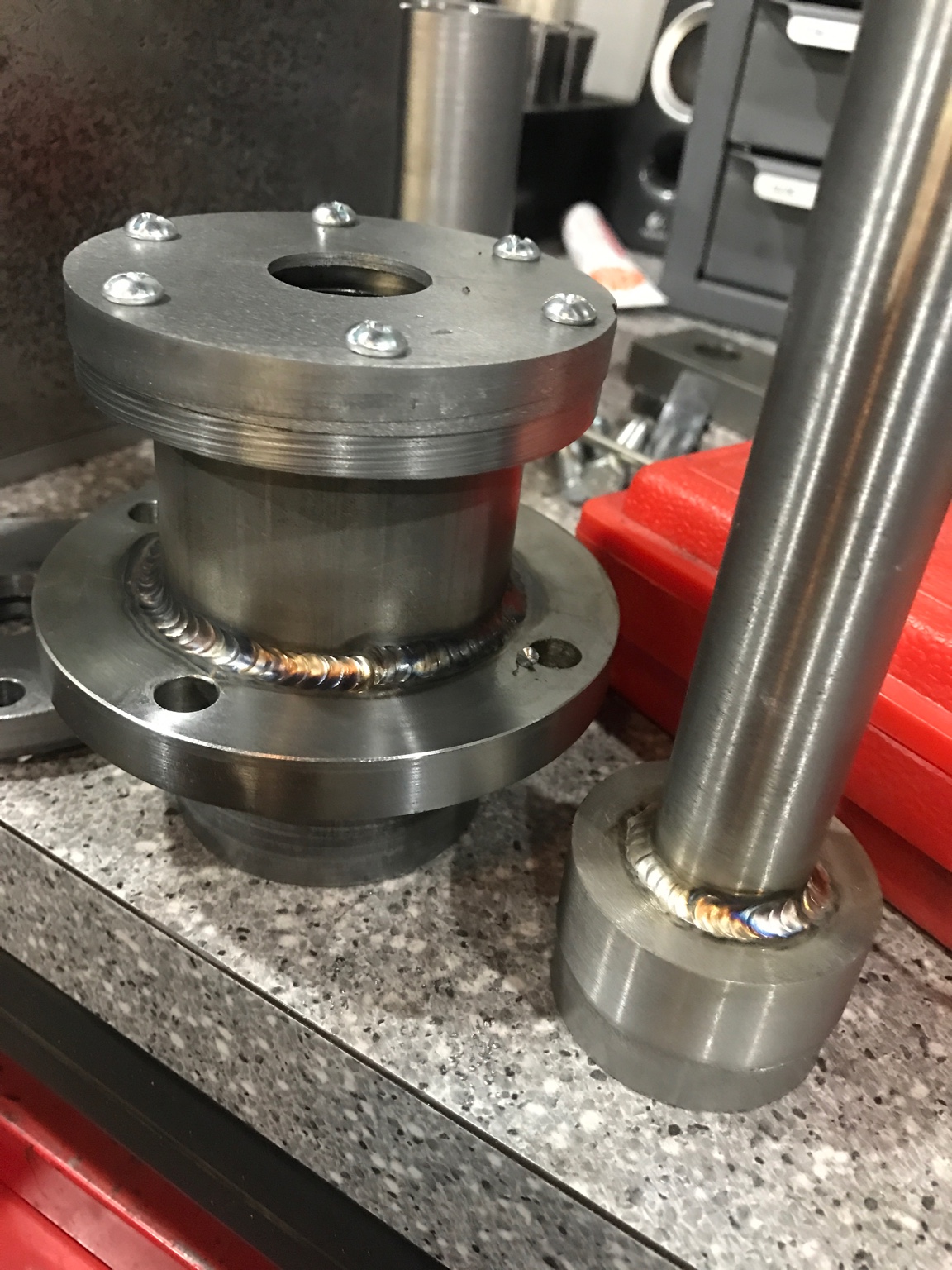

    Transmission/bellhousing alignment tool.
    I use a similar shaft with bushings in the bearing bores and center carrier bearings to keep perfect alignment when I narrow 9 inchers too.
    why be ordinary?

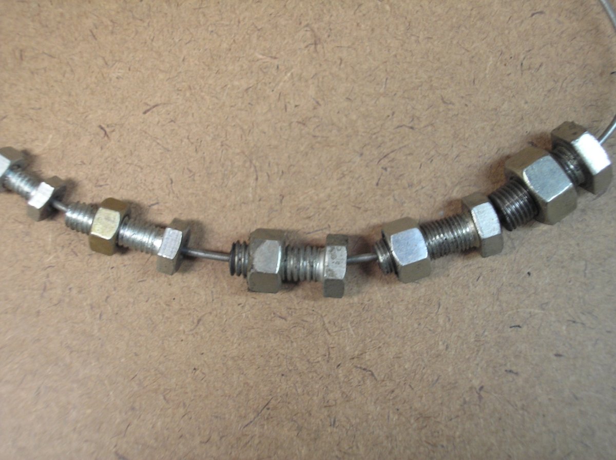

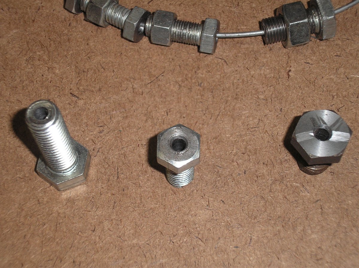

    Have you ever broken off a bolt or stud like in a manifold and you can't seem to find the center of the broken bolt so that you can drill it out? Or maybe just a couple of threads down in a casing and you need to drill it out but its hard to get to?
    Well, I am no machinist by any means and this isn't high tech, but I made a few of these in my mini lathe the other day so that I could drill a hole in the exact center of a broken bolt. I just chucked up some typical bolts and ran a drill through the center. The hole size doesn't really matter as long as its proportionate to the bolt. Now I can just screw these bolts with holes in them into the problem hole if there is a couple of threads showing in it and drill out a center to start with. Or if you broke off an exhaust manifold bolt, just put one of these in the said hole while the manifold is still attached and it gives you a starting point to drill out the leftovers.
    Easy stuff if you are sitting out bad weather or just bored.

  5. Great trick. I have had reasonable luck filing the bolt flush, centre punching it, and drilling the hole with successively larger drills, but your procedure will save me a lot of work.
    With me, it is almost always exhaust bolts, and my addition to your trick, is that I have a 90 degree extension for my drill that lets me drill exhaust bolts with the engine in place.

    Yeah, a broken exhaust bolt is what prompted me to do this so I just did all the standard size bolts while I was at it.
    I also used this when I needed a bolt hole through both rails of a boxed frame. I got the outside hole drilled but it was hard to get my drill straight enough to drill through the inside frame rail. So I drilled the outside frame rail, tapped the hole in a fine thread, screwed in a fine thread bolt with the hole in it and that gave me a straight shot with a small drill through to the other side rail.

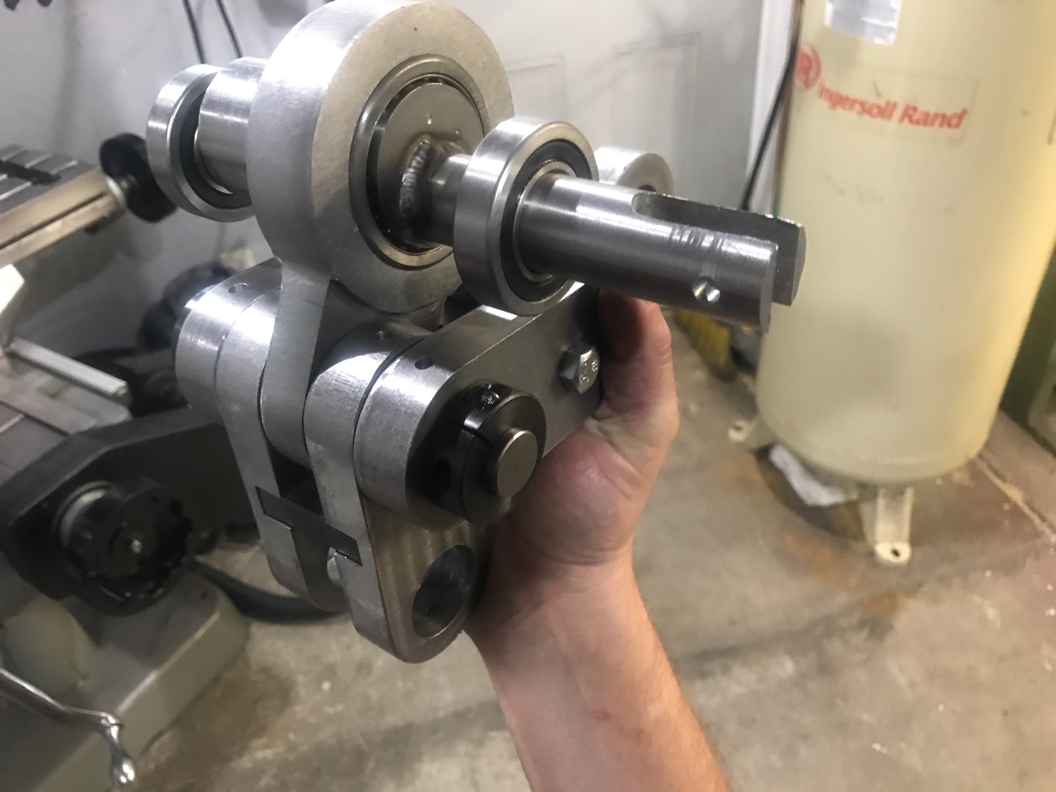

  17. toreadorxlt
    Joined: Feb 27, 2008
    Posts: 728
    toreadorxlt
    from Nashua, NH

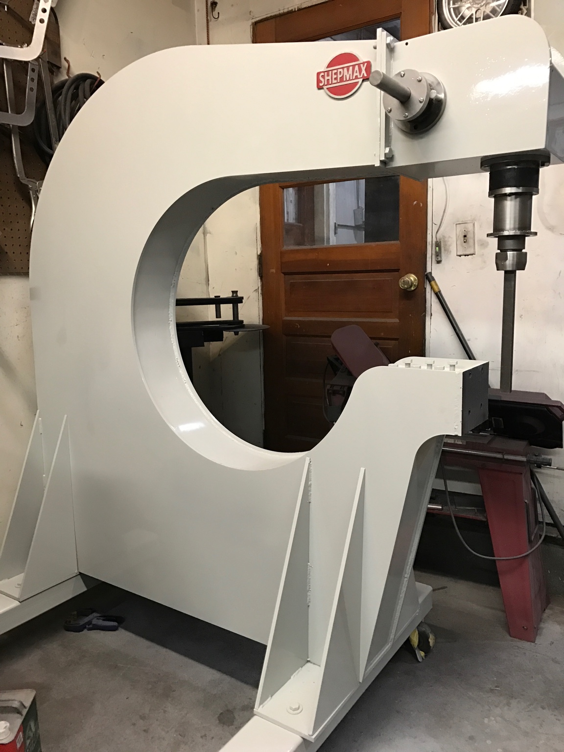

    Yes i did all he CAD/CAM and machining myself. People always mention wanting plans but I don't think I'd be interested in putting all my hard work out there for free. It's a simple toggle linkage. [​IMG]

    I had a similar situation and used the same fix, but in my case there was no room for the bolt head. What I did was drill down the center of the bolt, and cut it off at the end of the threads. After cleaning up the threads, I slotted the top so I could put it in place or remove it with a large flat screwdriver.

    Never had luck slotting one. Typically broken off for a reason.

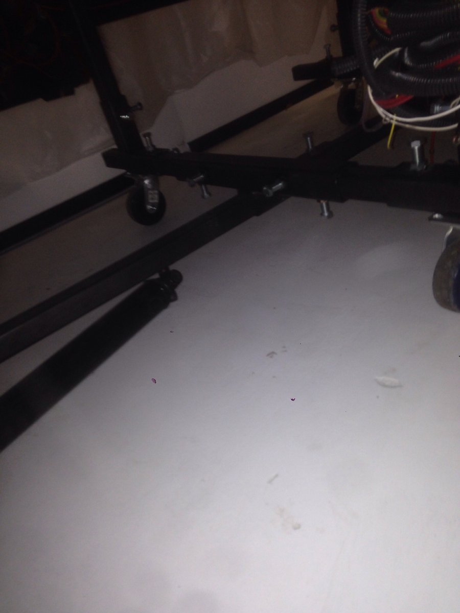

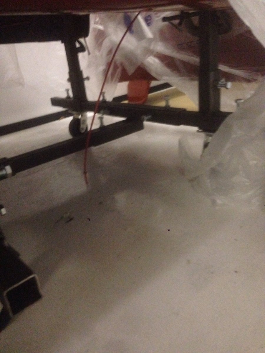

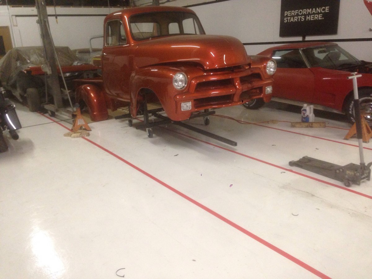

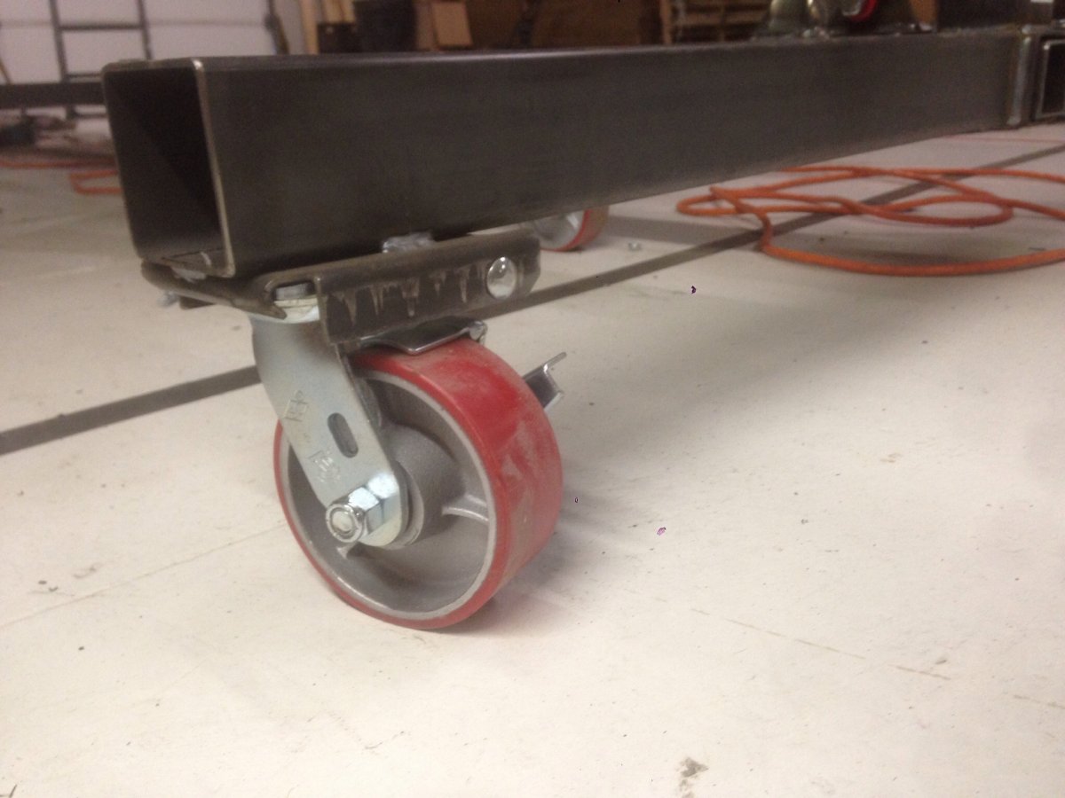

  21. I needed a body cart, a nice one and in a hurry.
    So I was cruising the available units online - which most were from China and all about $800 range and up.
    I needed it to be full adjustable and store compact and easily if I didn't need it.
    Then I cruised my stock pile of left overs for what's here already. I had some 2-1/2 X 2-1/2 X 3/16 square tube, enough 2x2x1/8 to get started, 2 hand fulls of 5/8 nuts and bolts. I was short the casters and some 2x2 tube. So I grabbed 1 24' piece of tube some HD casters from horrible freight. That was about $175 total and 1-1/2 hrs shopping trip. Then it took 3 guys about 1 hr to cut drill and weld it up.
    Here it is in action, I'll be adding a 5th and 6th wheel with support in the future.
    The only thing I didn't get was the quick release caster mountin plates so the wheels can come off in seconds.
    But it does everything I wanted. It can broken down, reconfigured in length and width on the fly with telescope tube and bolts. Triangles and wedges no problem & even a 3 point if needed. Can be ***embled under a car around Jack stands,and not only that the center bar can be offset to one side and not foul the Jack if jack needs to be in the center. If it needs specialty attachment or saddles that can also be done as needed and easily adapted. It can get taller by swapping in some parts.

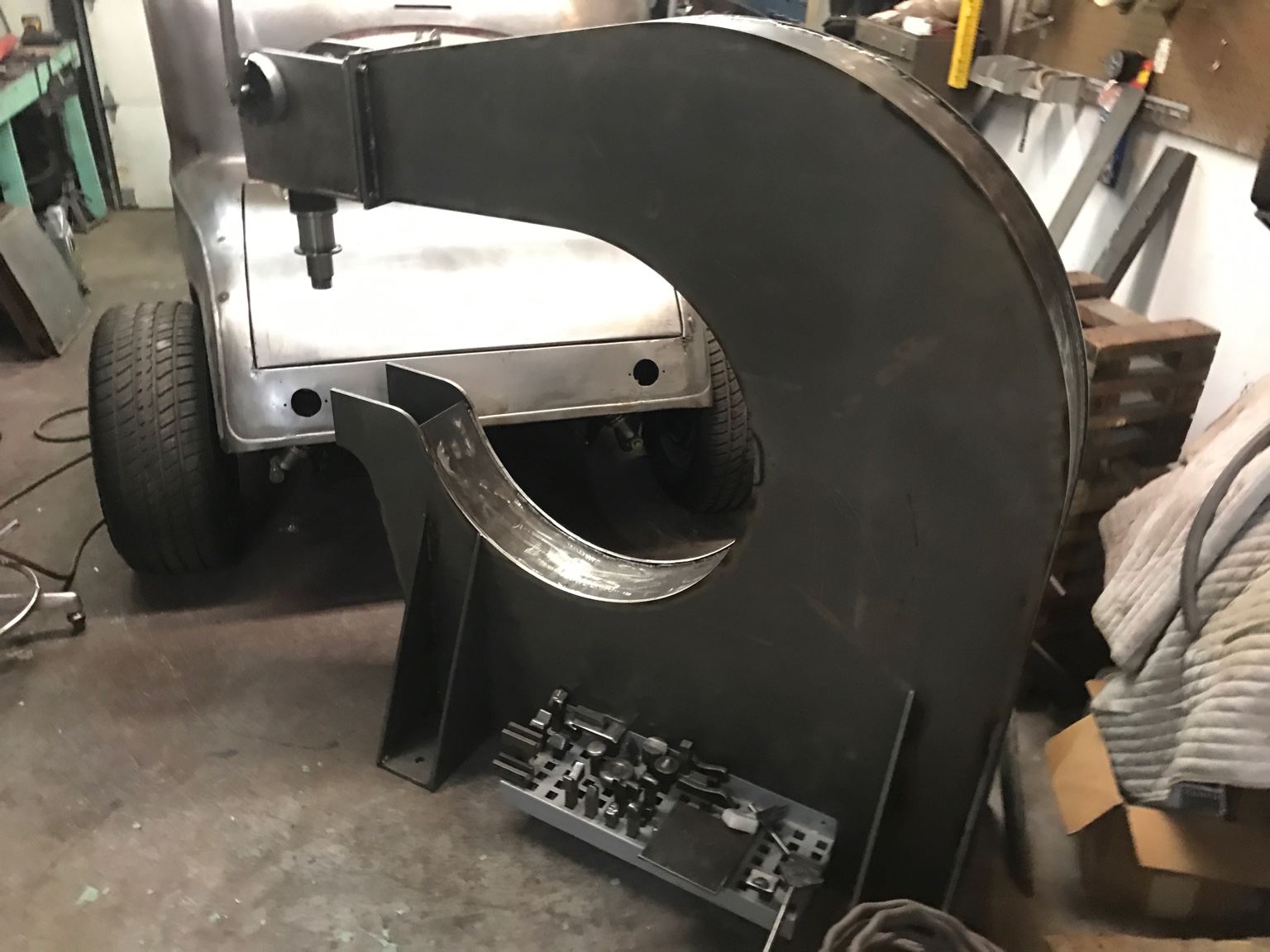

    Not trying to show off. Just showing what's possible. It's way simpler than building a car and many on here do that repeatedly. I got a Bridgeport and cad and like making my metalshaping equipment. This is my second revision of a pullmax style machine.
    No build thread, it's off topic for its own thread here, it's pretty well do***ented on my Instagram. @steveshepard. Closing in on the end. [​IMG]

    I think you've misunderstood... perhaps a picture would help explain it better. I'm not slotting the broken stud, I'm slotting the guide that I'm installing so I can drill the broken stud on center. As long as there are a couple threads exposed I can thread in something like this before I drill the hole for the EZ-outs. This allows me to install or remove the guide with a screwdriver. I start with a small hole to get on center, and then I can drill it out as required. IMG_1461.JPG

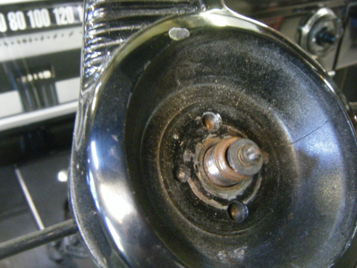

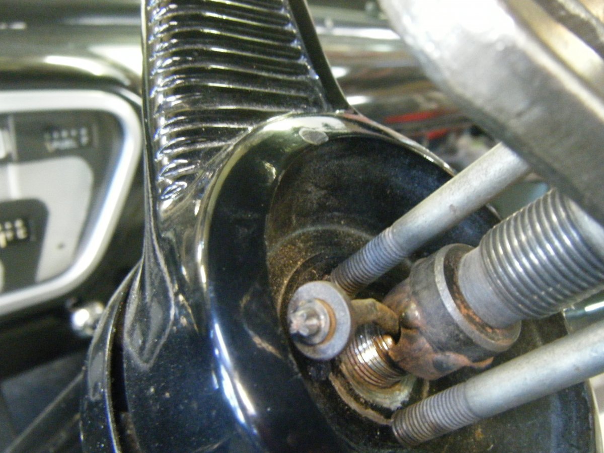

    tb33anda3rd

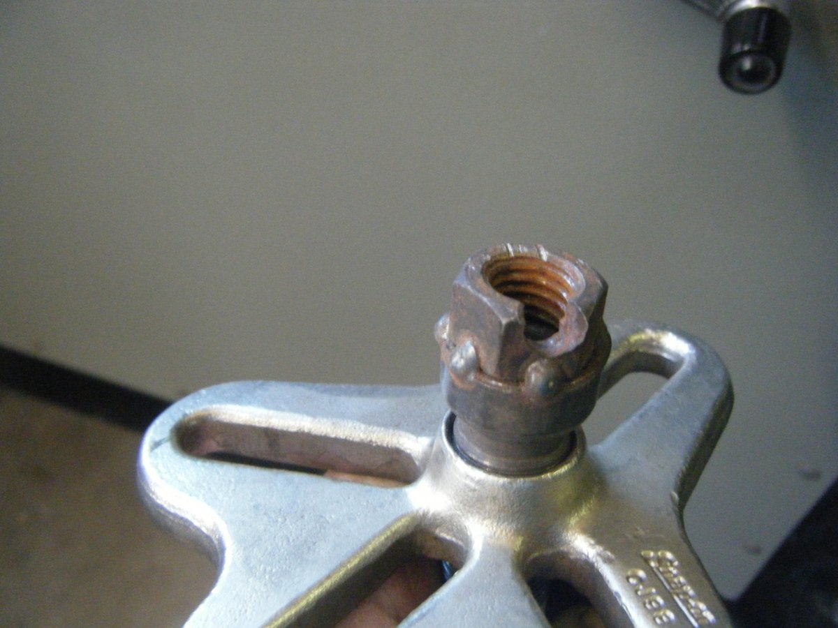

    this is a tip i made for my steering wheel puller to push on the shaft without crushing the fiber washer that isolates the horn wire. i cut a notch in a nut and welded it to an extra insert for the puller. the notch is to allow the wire to p*** through when it is pulled out and moved to one side. i made sure there was a little grease on the insert so it would not spin when the arbor is being turned. DSCF0001.JPG DSCF0002.JPG DSCF0003.JPG
