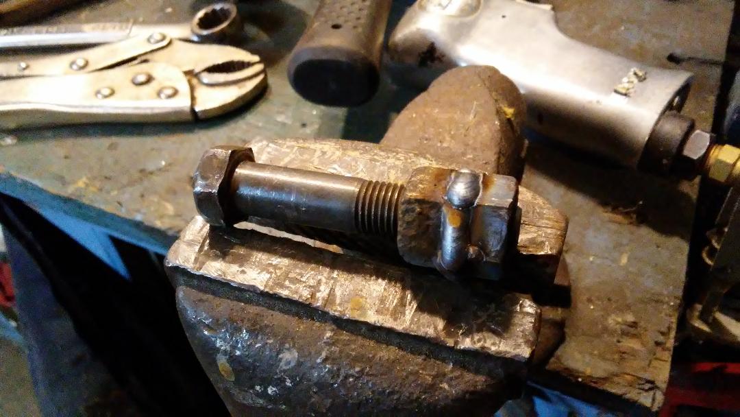

    Nothing fancy but very useful. Bolt with two flathead nuts welded together. Used to install head studs.

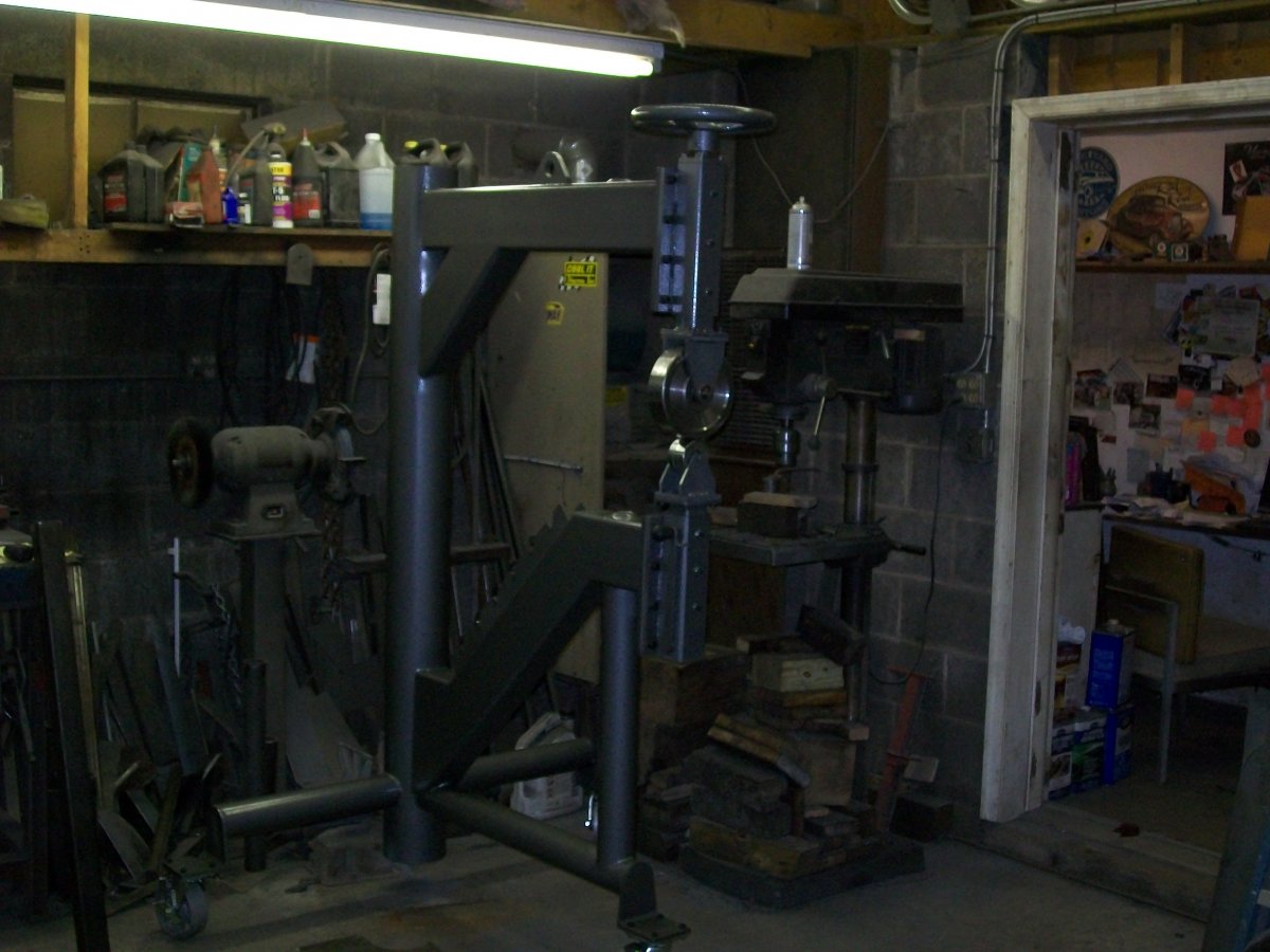

    Finally finished my English wheel. Using the Ebay off shore wheel and anvils until I can get the Hosier Profiles, hopefully in January. Works extremely well. Panels are absolutely track free and there is less than .002 deflection with 500lbs. applied to the throat. It weighs in at a tad over 900lbs. and has ports to fill the frame with sand when I build a power hammer off the right side. The gibs are bronze lined and can be set to zero tolerance. I've been using friends wheels for the last five years or so since I sold my last one to Homemadehardtop57. Nice to be able to just step over and shape what I need.

    Very nice EWheel!! I can see your casters bending the plate they’re welded to upwards over time but super nice build. Great job!

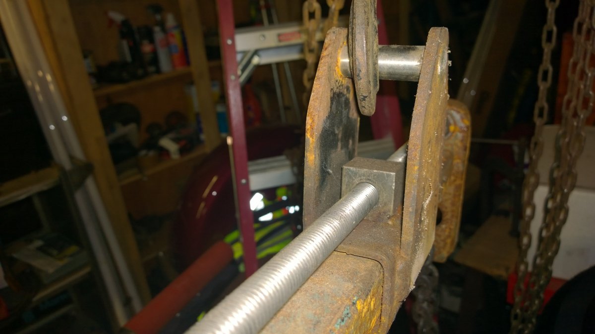

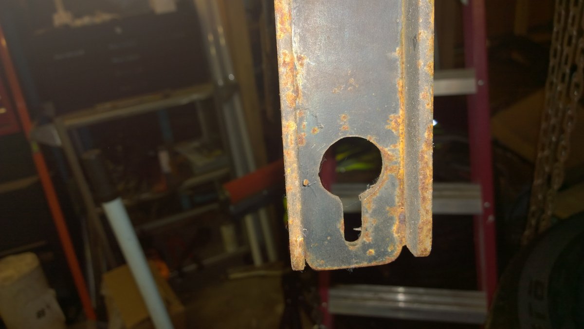

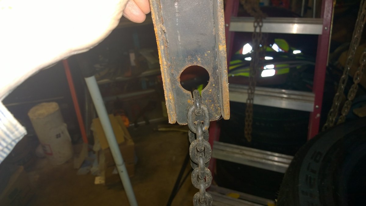

    Saw the thread about HF engine levelers and I though I would show one I build about ten years ago. They locked the other thread down so I'm putting it here. The patina was gotten by laying it in the corner of the garage after it got wet I think.

    That does it!! Now we all want one.
    Nice work

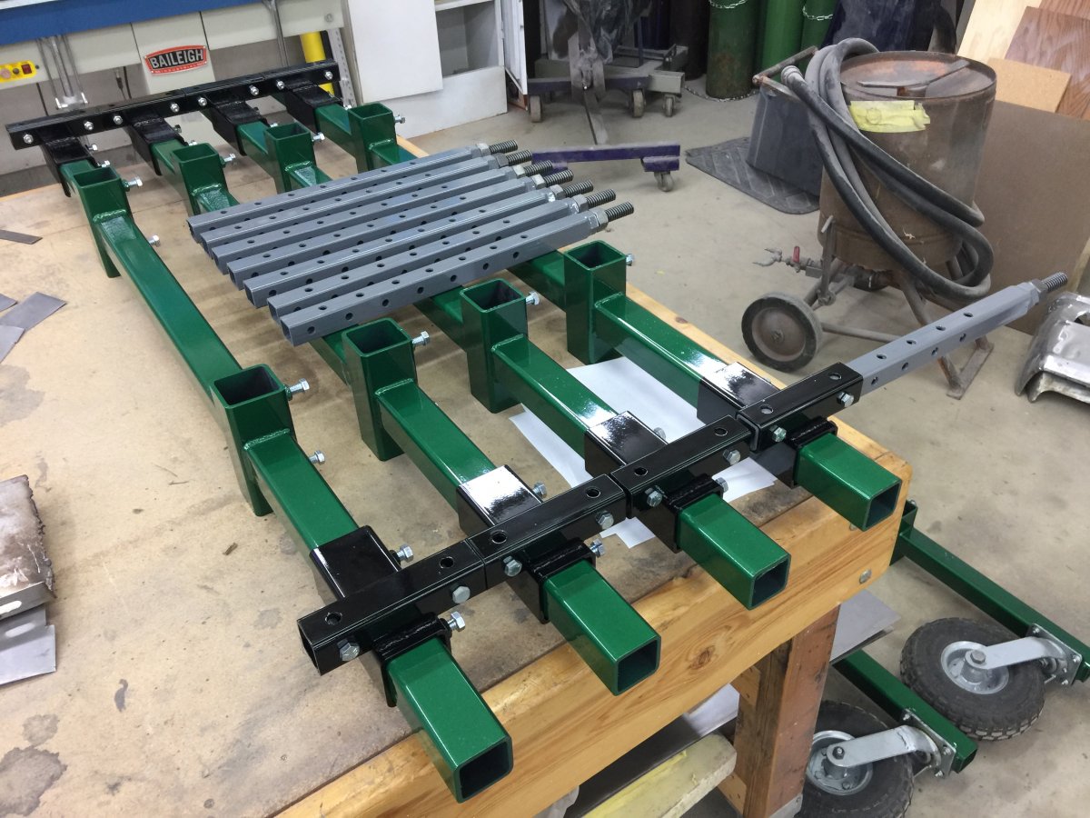

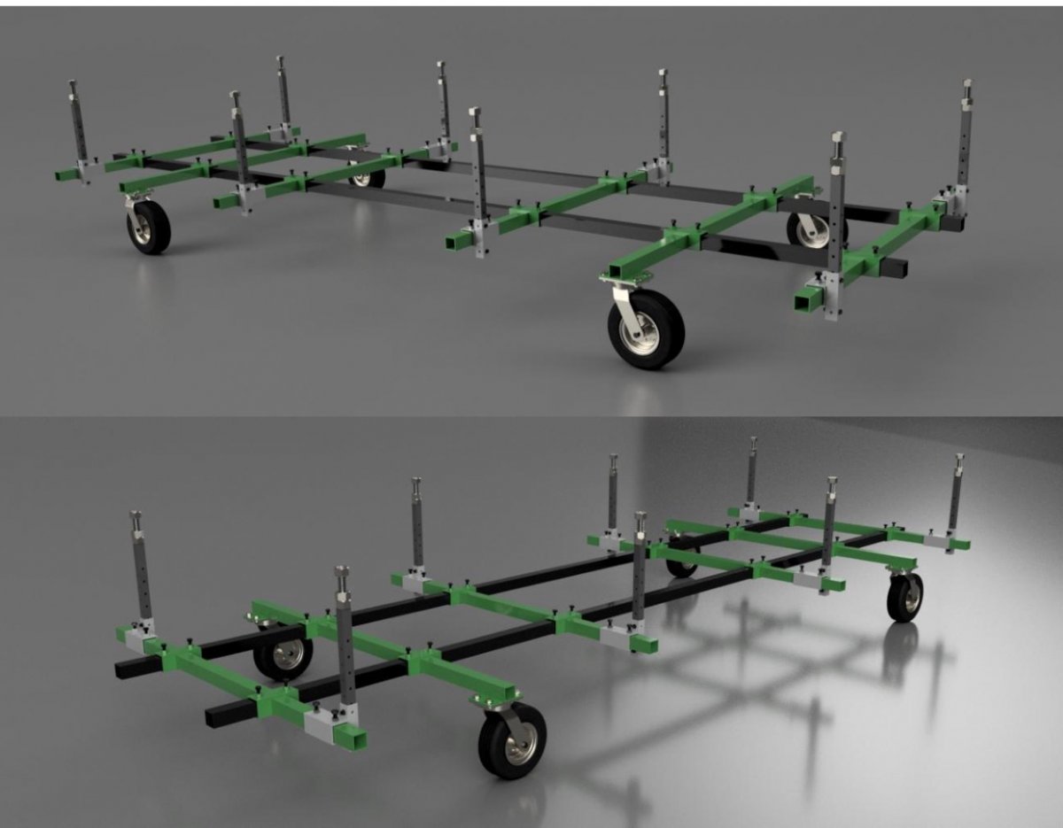

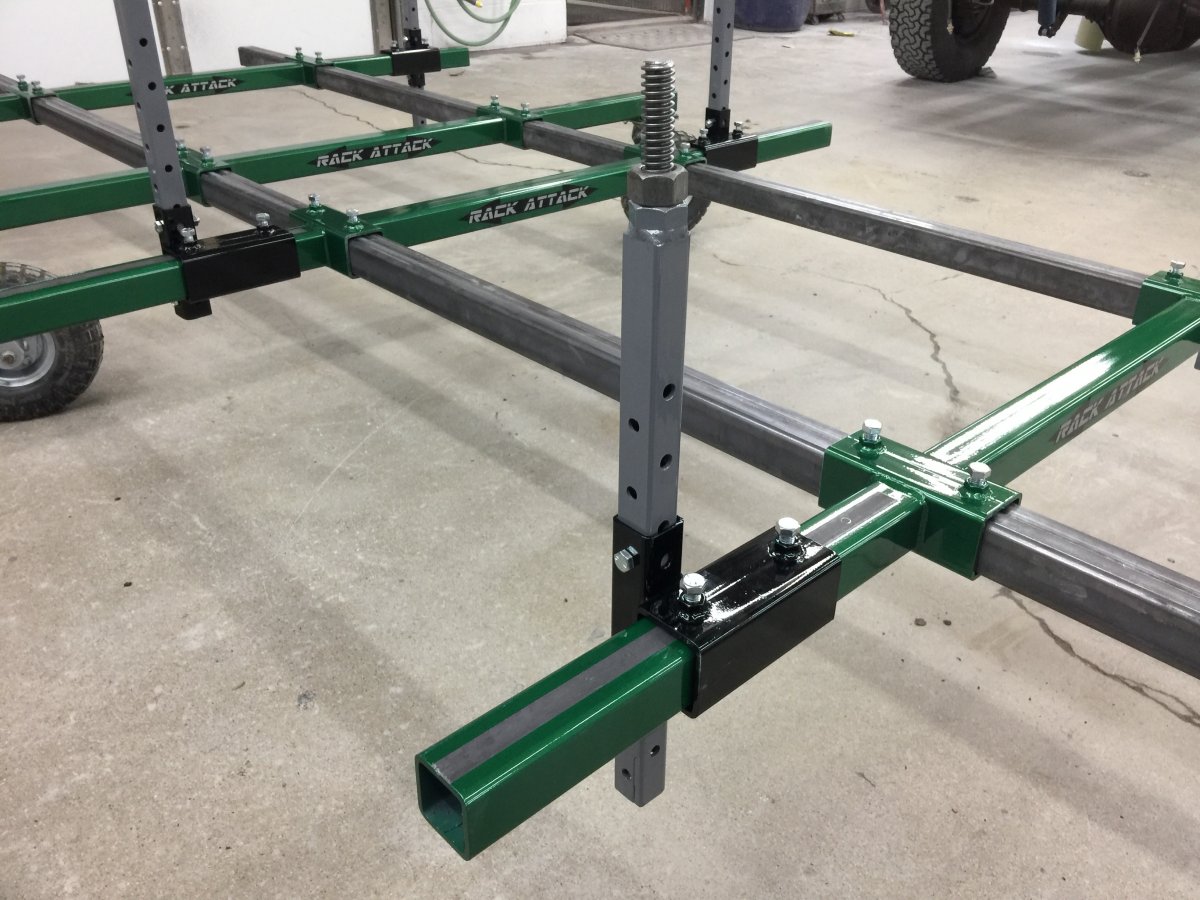

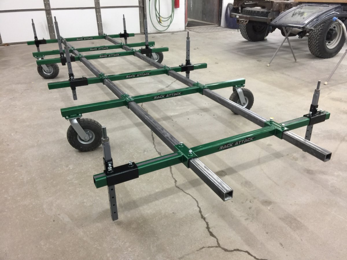

    I recently designed and built this fully adjustable body cart

    That looks Great! Gary

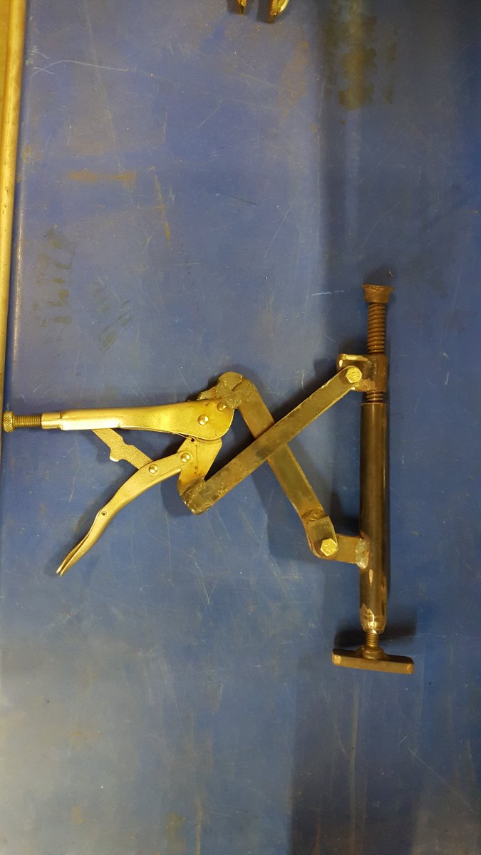

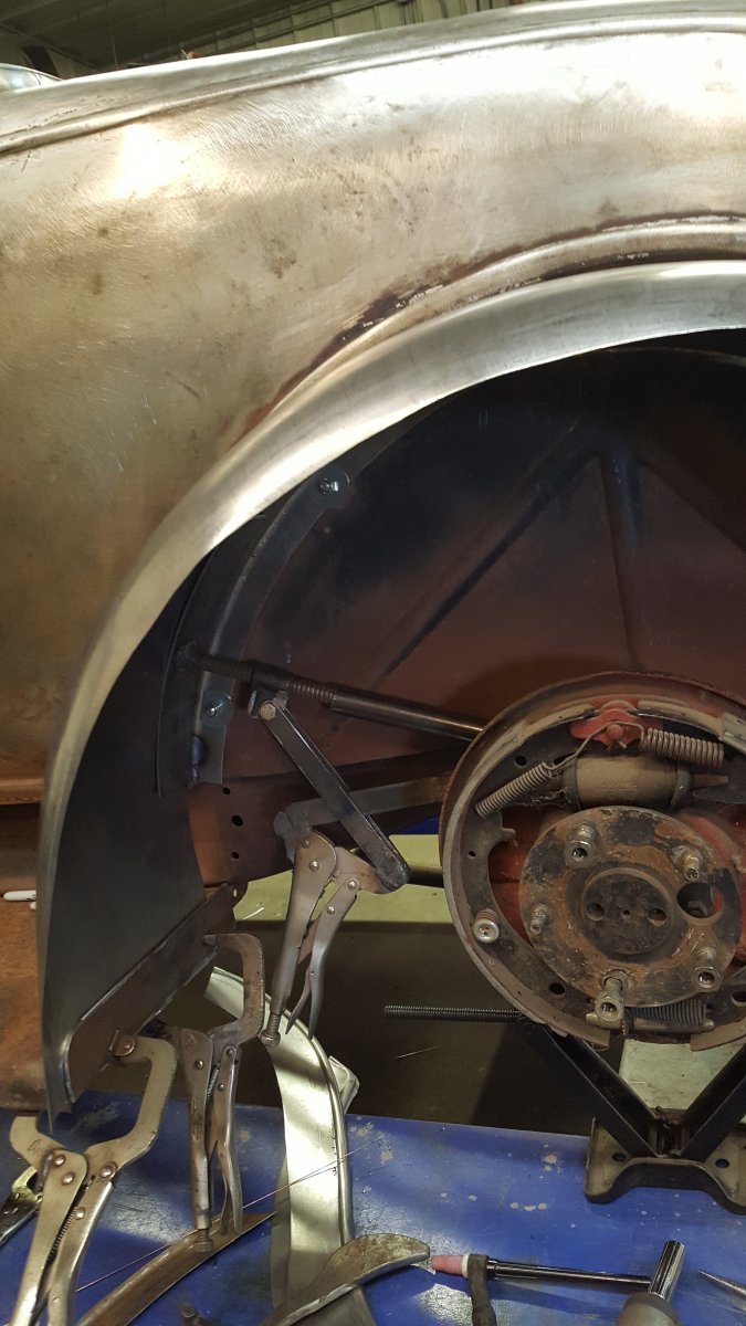

    I don't think I posted this here yet. It' a modified vice grip I made to spread. I used it today on my fender. 20171129_112039.jpg 20171129_112016.jpg I have a shorter one too.

    Great idea!

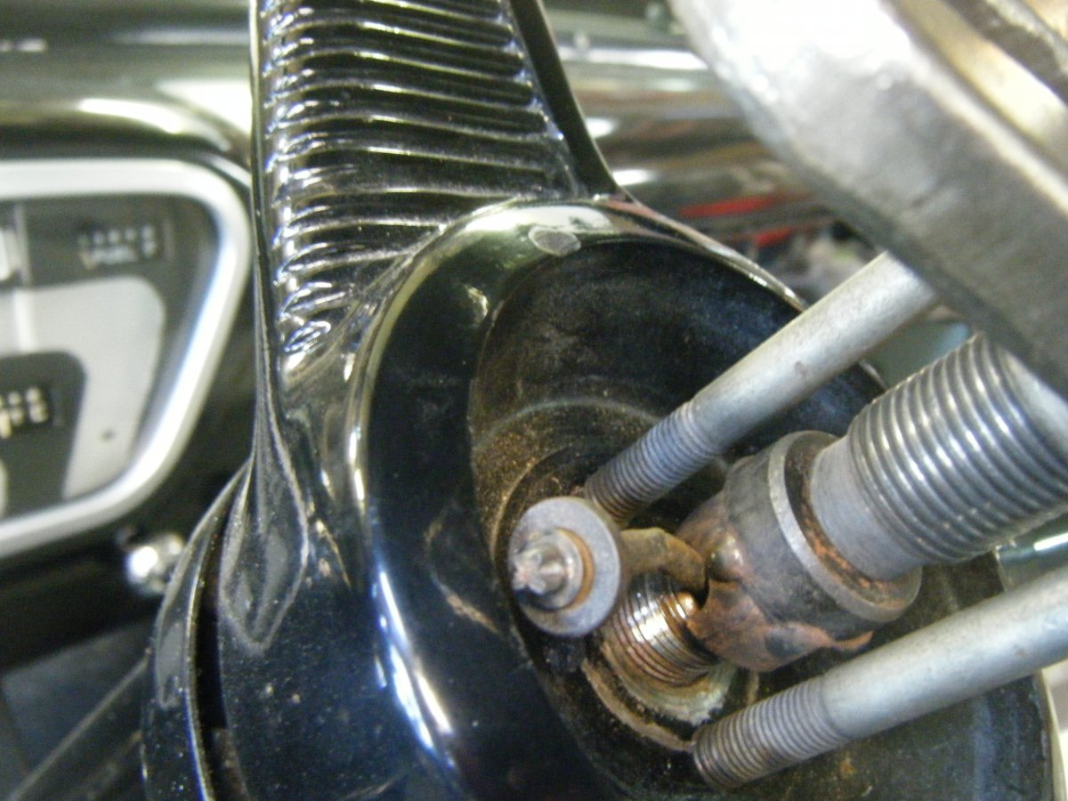

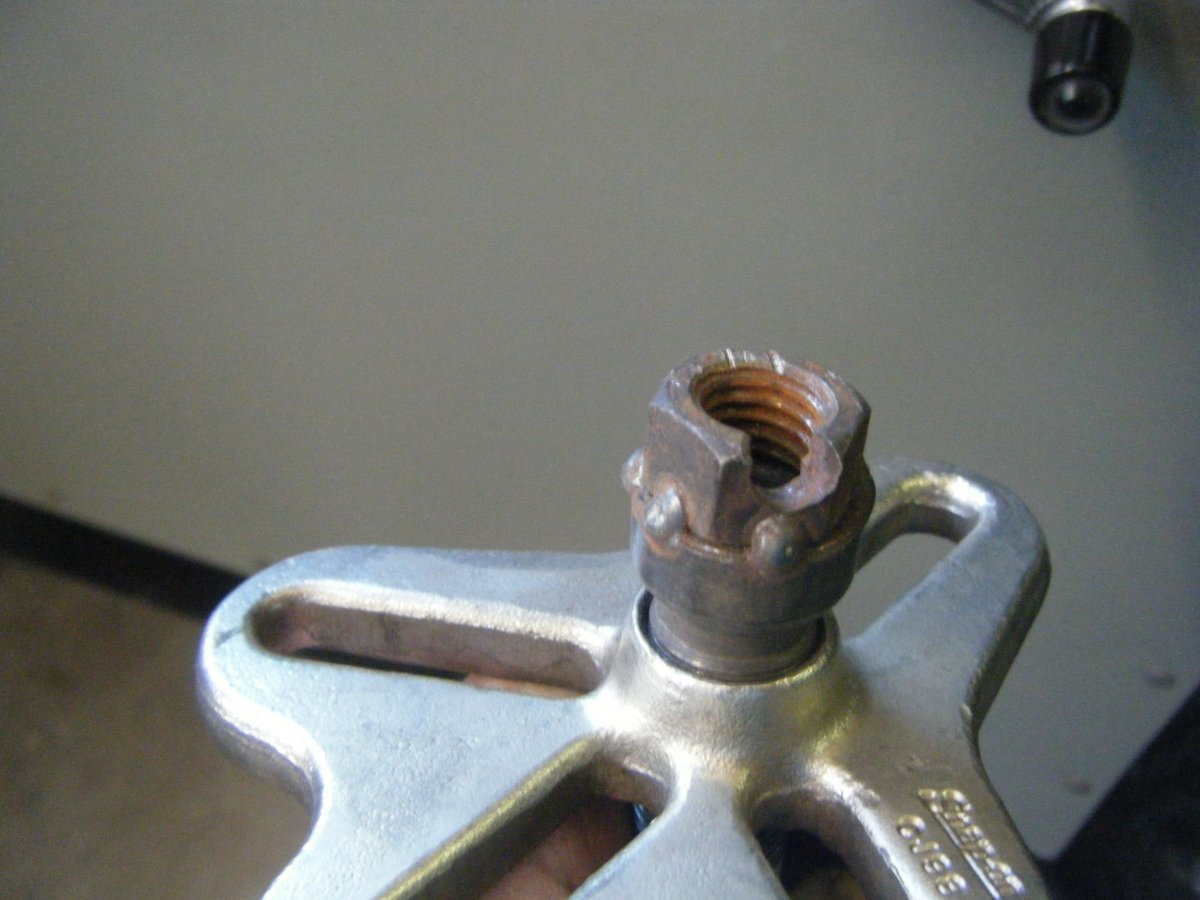

    [​IMG][​IMG]
    had to drill out exhaust studs on an aluminum head. tried welding nuts to what was left of the stud. was melting the flange surface. hokey drill jig did the trick.

    It was just a random green out of my color deck. I went back and looked up wat it was.
    Electric Green Met.
    Ford color: code SW (useage was like 1999-2003?)
    PPG code: 5492

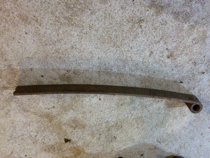

    Oh please... I posted a couple broken bolts with a hole drilled through them... surely your stuff can't be any more basic than that? Share your ideas, that's what sparks the ingenuity that creates even better ideas. Sometimes the simplest of simple tools can be very useful and time saving. I built this ******* last Friday nite on a whim... by Monday morning I had a job sitting in the shop that needed it. At first I didn't like it, too stiff because it was made from a main leaf, but I did like the extra weight and shape of the spring eye (something the purchased versions don't have). Rusty chunk of leaf spring and a worn out shovel handle... not exactly rocket science...
    4 "too short" copper rivets countersunk into the handle that was sliced in the center make it work. Note I retained the rusty **** look....errrr..... "proper patina" for working on vintage iron... That eye is great for working the back of vintage fenders or f'd up trailer fenders that got too close to a front end loader...I call it the super *******. When I ran into Gene Winfield at World of Wheels, he was raving about a shiny version from Eastwood.

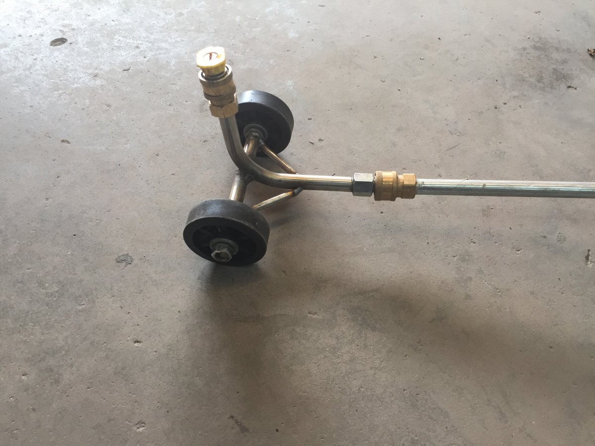

    I have not looked through all of this thread, but most of it. If I am duplicating I apologize in advance.
    Here is something I built in the past but I modified last week. It is an attachment for my pressure washer that enables the operator to stand beside the vehicle and wash the underside. It solves two problems for me, having a clean vehicle to work on, and standing instead of bending over or laying down. It originally had a skid plate but last week I added the wheels. This is an important feature as it keeps the device from turning sideways from the intended direction. Trying to hold on to a pressure washer wand that is turned at 90 degrees is like something from a 3 Stooges film.

    Great idea WZJUNK! I think that would be a great idea for those Bonneville guys to use when they get their Hot Rod home for the Salt flats.

    We made something like that at the fire station to clean under the trucks in the winter. Gets the salt and mud off without crawling underneath. Keeps the pump clean for the mechanics.

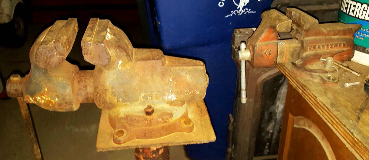

    Hey neat, I have that same craftsman vice.

    You should sell these at Bonneville. :cool:

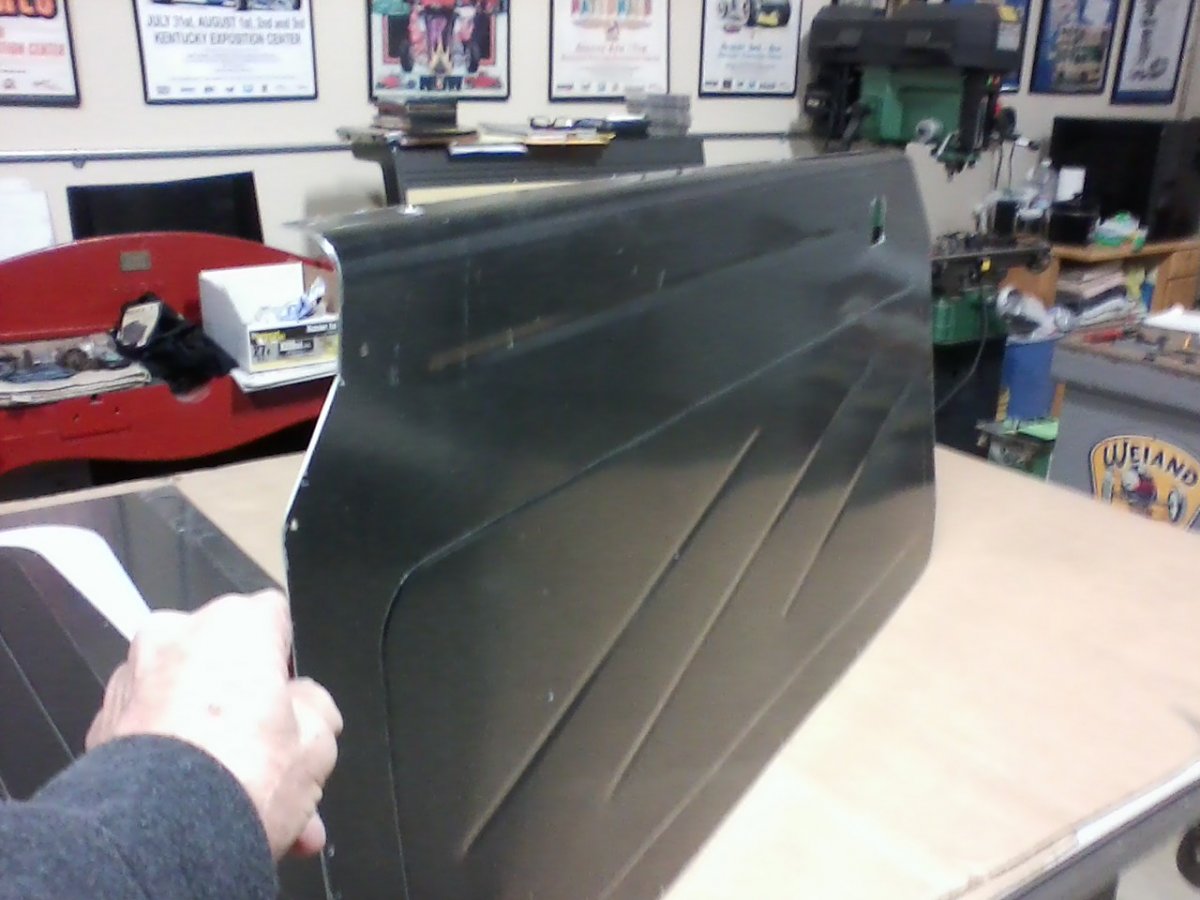

    Made this to go on my brake. Bends the radius on the top of race car door panels
