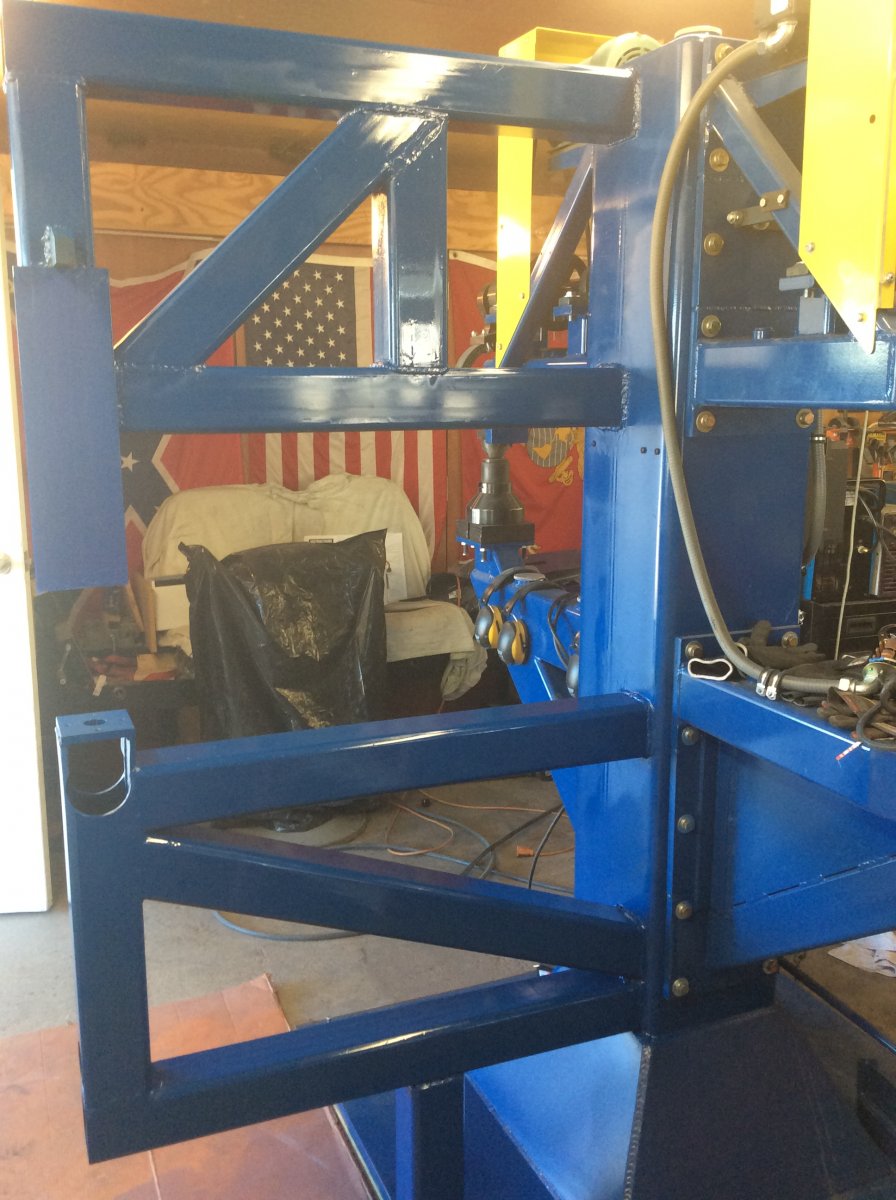

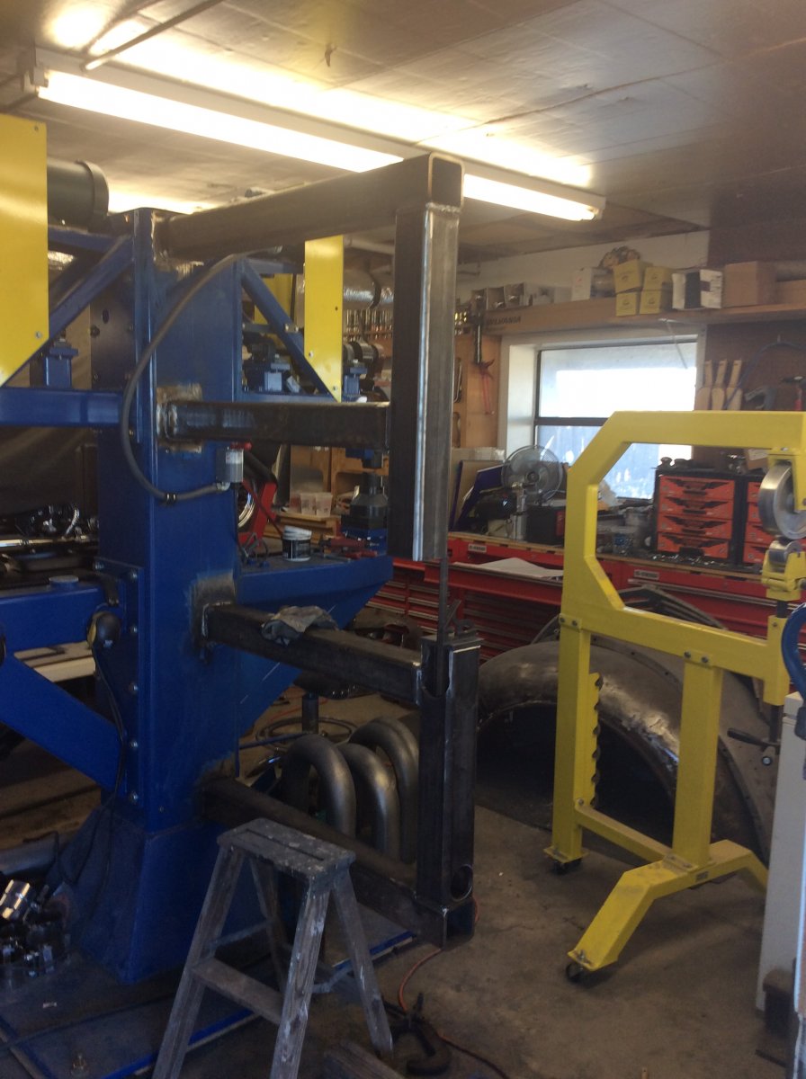

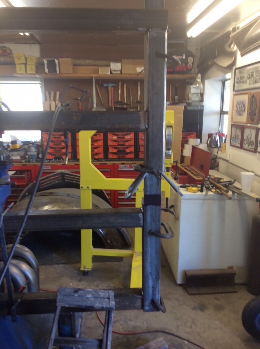

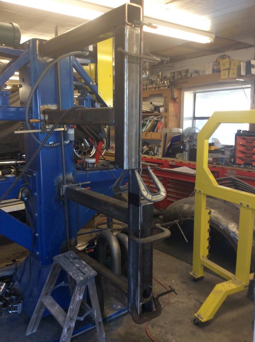

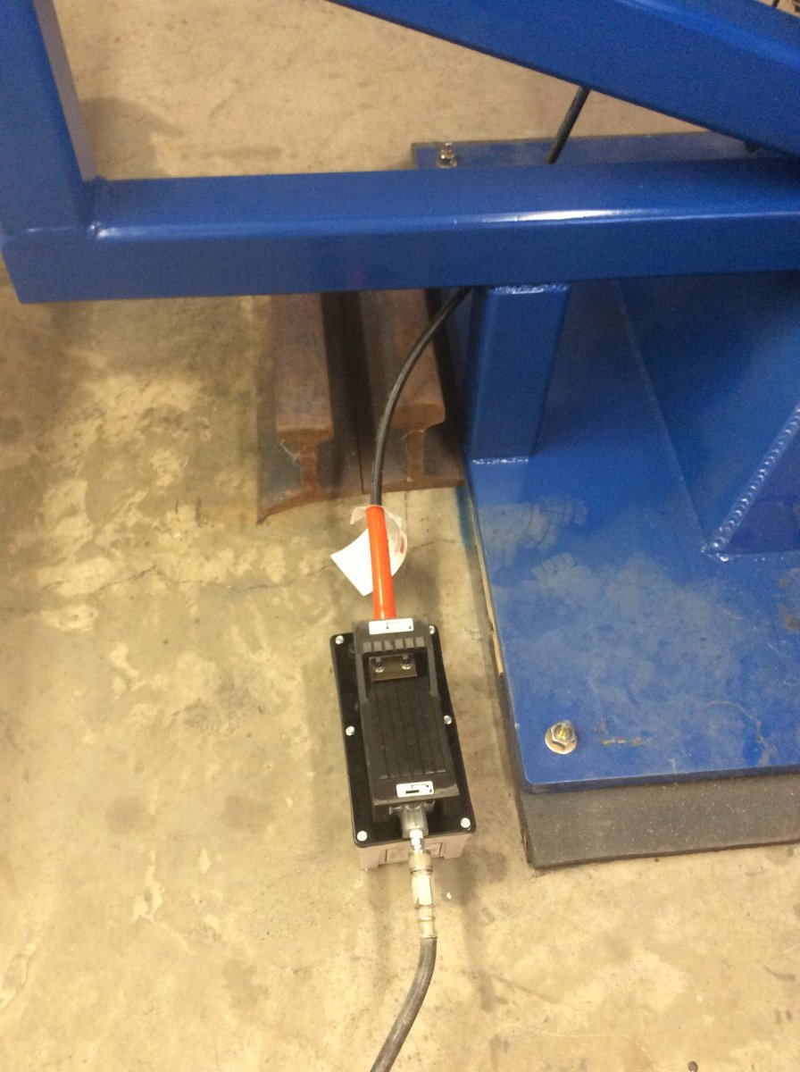

    Building a frame onto the side of my powerhammer for a 10 ton press for louvres , dimple dies and punches . Only working on it when it’s to cold in the other side of the shop where the projects are . Will post again when it’s done , painted , and working . Probably in next two weeks . Some welding done some tacked , and some needs to be ground out and redone . Blue

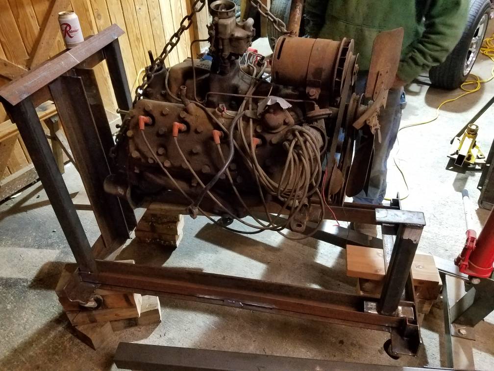

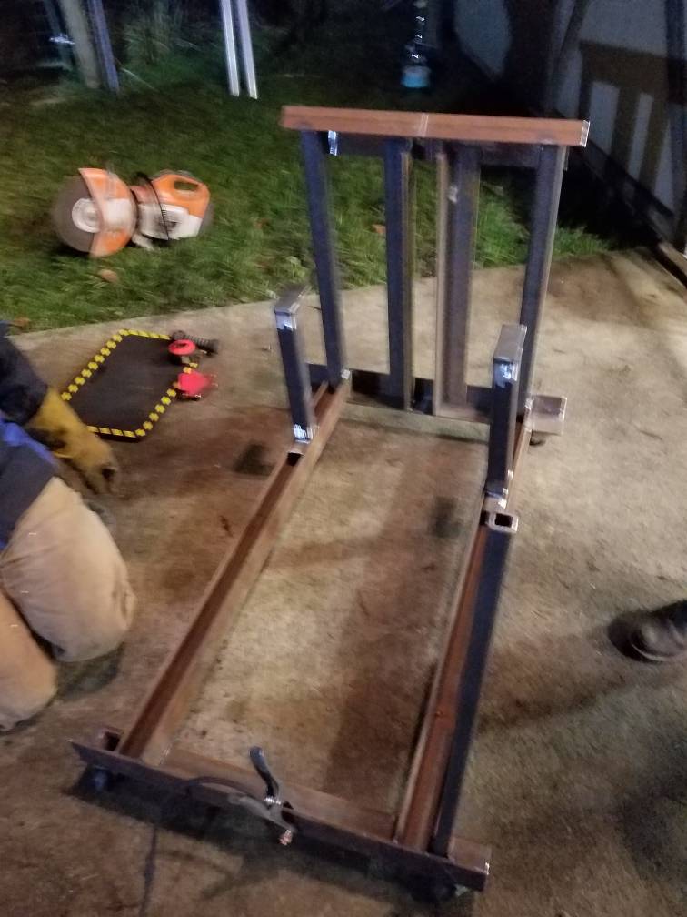

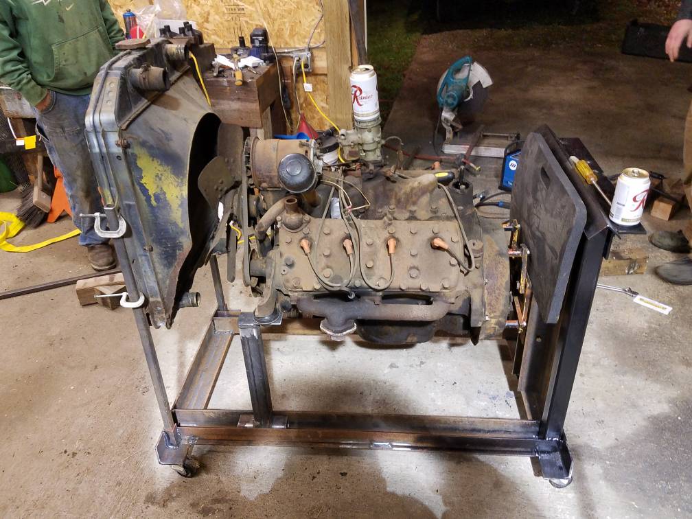

    built an engine run stand with integrated work stand. can roll the engine over while still in run stand to remove the crank shaft with out having to transfer engine to a work stand. still need a few anccillaries but the hard part is done. needed to build one any way to try and fire up a 255c.i. mercury flat head.
    [​IMG][​IMG][​IMG][​IMG][​IMG][​IMG][​IMG][​IMG][​IMG][​IMG][​IMG][​IMG]
    Sent from my SM-G930V using The H.A.M.B. mobile app

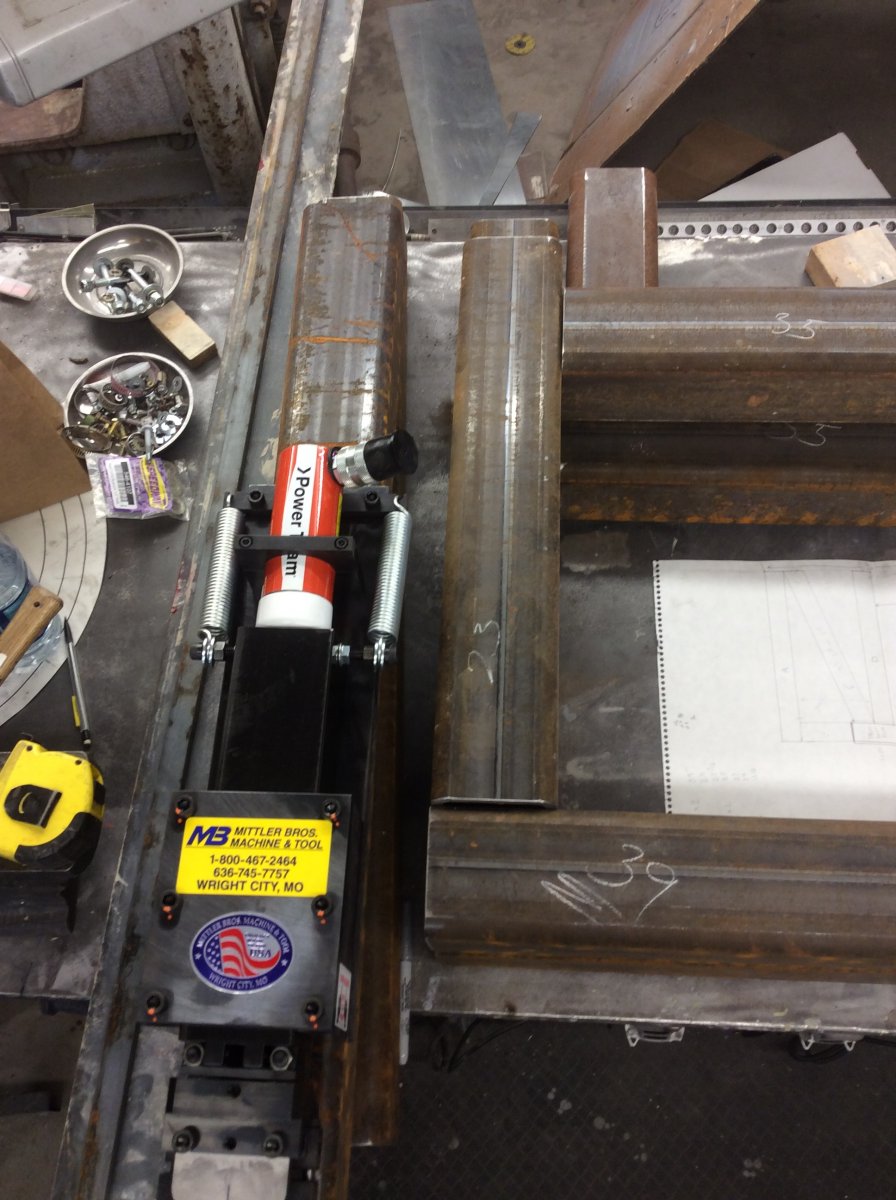

  6. Here's the electric bead roller I built a few years ago. 26" throat, swing up table. I powder coated it in a double blue vein color, IMG_20161217_104652_979.jpg IMG_20161217_105155_182.jpg IMG_20161217_104856_496.jpg
  7. That is a very nice execution of a very well thought out plan High Plains Drifter! Any chance you could would share a few details of the build? That's an interesting variable speed drive and what look like "smaller than regular" diameter dies.
    I hope the recent weather has not created unreasonable distractions for you, I have friends outside Rapid who have not enjoyed the past week or so.
  8. Hasn't got above zero in over a week! Think it was like -23 deg below straight air temp this morning! Well, most of the metal I used on this project was 1/4" or 3/8" thick. A 1/4" wall sq tube was sandwiched with outer "U" plates on each side which were 3/8" thick & was cut out on a plasma table. This housed the solid blocks that the 1" dia shafts go through. The blocks were machined out for oil lite bronze bushings and drilled and tapped for the outer mounting bolts. The sq tube was machined for the blocks and were slotted for the adjustment bolts. The motor set-up was purchased from Mittler Bro's for like $250. The dies are Harbor Freight and were opened up a little to fit the turned down shaft ends which I made 7/8" to accommodate dies with a 7/8" bore. I bought the manual HF set just to try. I plain on buying other dies. I think with the coupon I paid like $99 for the whole set. I also used the drive gears from that set to for the electric motor. The legs were cut out on the plasma table out of 3/8" plate. This unit is heavy and there is no flex, I've rolled 16g with it already with nothing flexing. The only down fall it's big and takes up like a 4ft space!

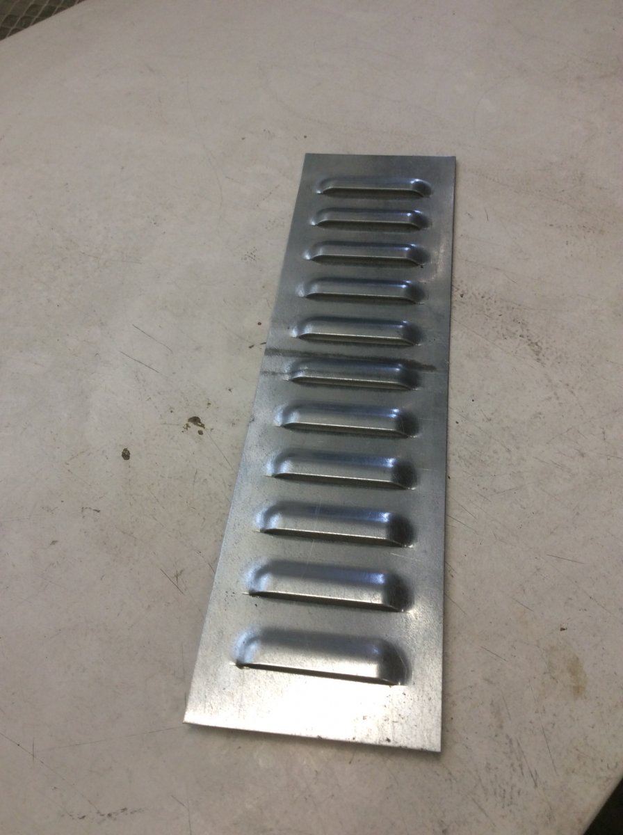

    Finished my press frame,sanded , and painted today. Will mount head and dies in morning if dry and will start playing with it as soon as possible. Already got an order for some louvres. Blue

    Finished up my press . Did some test louvres in about 2 minuets. Can’t wait to try out my punch dies . But for now back to work on the model A . Blue

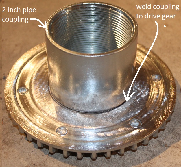

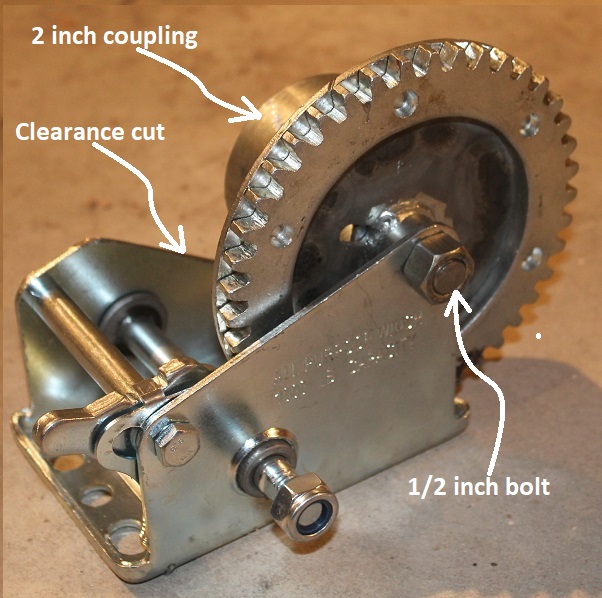

    I decided that I needed a gear drive rotator on my engine stand when I found that the handle for rotating the engine could hit the reinforcing strut on the back of the stand.
    I cleverly prevented damage to the engine stand by having my hand between the handle and the strut when I made this discovery.
    After finding that I couldn't afford a factory rotator I modified a Harbor Freight hand winch to rotate the engine stand head.
    I can now rotate the engine without hurting myself, the only problem is what to do with the left over cable from the winch.
