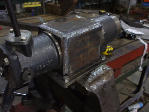

    In preparation for putting the sheetmetal in my Fordoor sedan project http://www.jalopyjournal.com/forum/showthread.php?t=147848 , I needed a bead roller. I copied the inspiring HF bead roller makeover do***ented here: http://www.jalopyjournal.com/forum/showthread.php?t=137858
    I used 3/8 plate to give the HF unit some style and extra stiffness. The tubing is 1.5" square by .12 wall, salvaged from s**** barrel at work. I also took two stainlees steel vacuum flanges out of the same barrel. Got a bent steel rim for the base. The steel pipe was out in the yard so I wacked off 3 feet. I used 1" x .12 thick flat bar to flange the 3/8" plate. Here is what it ended up looking like:
    Added a coat of black paint (black was on sale :D):
    Here is the first beads to come off the new machine:
    I have a gearmotor I still plan to add to the ***embly. I'll post a pic once I get the motor added to it.
    Here is the fisnished bead roller, motorized with a foot pedal:

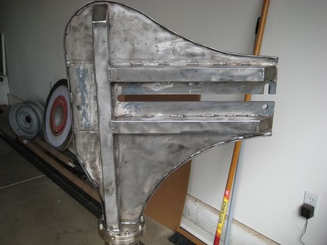

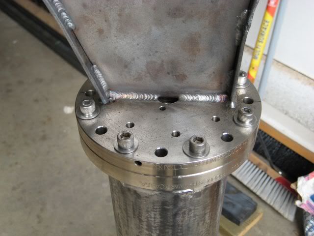

    I built my E-wheel before I got involved in forums,so I didn't take many progress photos.
    The radial arm saw adjuster does work good for a upper or lower adjuster.You can find them on e-bay or on Craig's list some times.
    I did build another e-wheel for a friend of mine(Bill H) We used a radial arm adjuster on his as well.
    Here is a few photos of how we did it.
    Kerry Pinkerton and Tim Doty put up a real good thread on how to build a reciprocating hammer.I really liked Kerry's design and he is a Master tool builder.I asked if they could help me build one and for the past three weeks I have been working on it.
    I still have a lot to do but I am getting close.My list of things to do is getting shorter anyways:rolleyes:.

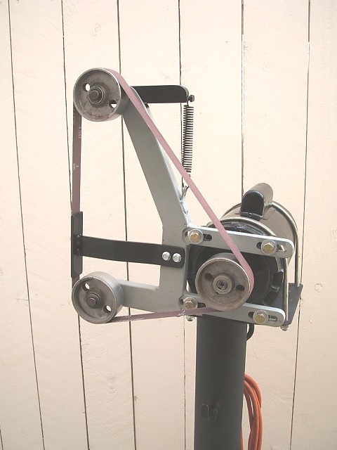

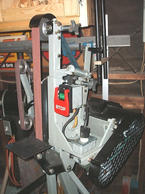

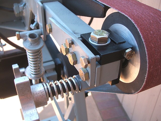

    I always wanted a belt sander / grinder whatever the difference is. I have seen some nice machines on knifemaking sites but they were expensive. I stole some ideas from the ones I saw and made my own out of stuff lying around the shop. The only things I had to buy were the wheels: 10" wheel from Grizzly for ~$65 and the two 3" wheels from Sun-Ray for ~$30 each. It uses a 1 1/2 hp 1725 RPM motor that has plenty of power for me but I can slow it down if I REALLY lay into the workpiece. Grinding normally it will put a full radius on a piece of 1" wide, 1/2" think steel in less than 30 seconds, fast enough for me. I can index the machine so the flat platen is vertical (most of the time) or horizontal. The work rest can be used in either position, against the flat platen or against the 10" wheel. The small wheels are adjustable in all planes for tracking. It uses 2" x 72" ceramic abrasive belts and cuts like the Tasmanian Devil.
    I use it constantly since I finished it. I never use the bench grinder any more.

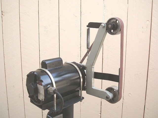

    The 2" machine is such a beast that I needed something more controllable for deburring, sharpening and the like. The previous owner of my house left an old 1 hp swimming pool pump behind when he left. Once I took the frozen pump off the motor worked fine. I used the pump attaching holes to mount a 1" x 2" tube frame. The wheels are from a belt sander I made in high school metal shop 45 years ago. They are cast aluminum with bronze bushings and a slight crown to make the belt track. I have a 1" x 42" 150 grit belt on it and it is really handy as well.

    WOW! Thiaw belt sanders kicks ***!!! I NEED one of those BAD!!
    Question, Jim: How do you keep the belt from walking off the pulleys?

    The little one has all 3 pulleys slightly crowned and no adjustment. The big one has adjustments on the 2 small wheels for tracking. I also just put a slight crown (only like about .030" or so) on the tension wheel to make it a little more stable. All you have to do is make sure the wheels are in the same plane and put a little crown on at least one if you can't adjust the wheel angles.

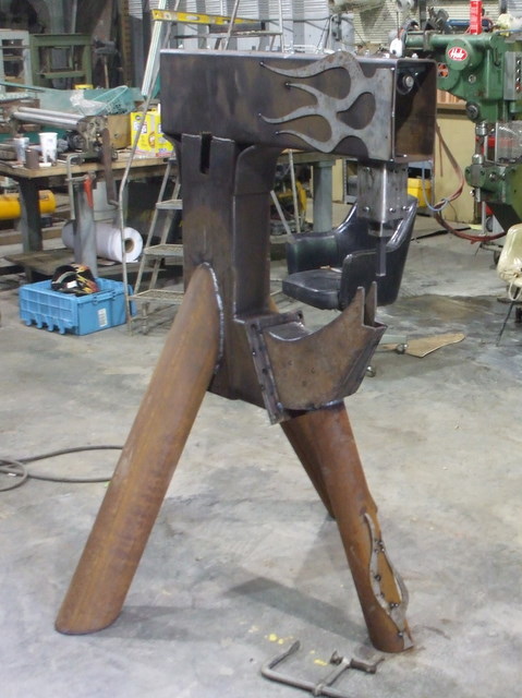

    Here's my English Wheel I made from a model A wishbone, its rough and none adjustable but its not too hard to go harder or softer just by applying pressure in different spots.
    That second pic is me working the twist and small dents out of my friends valance panel.

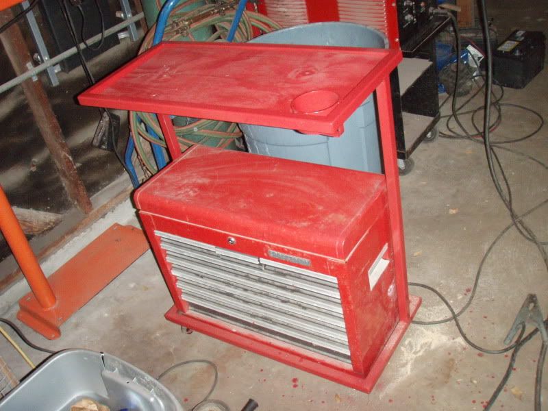

  25. I had an extra tool chest, so I made a wheeled dolly to bring the tools to the job, instead of going back and forth to the big tool box in the garage.
    I put the top shelf up high so the lid can still open, for holding nuts, bolts, and small parts.
    The most important part! I used a piece of pipe a little oversized, for those thick foam beer koozies I sometimes use.
    I may mount a light under the shelf, and probably a powerstrip as well.
