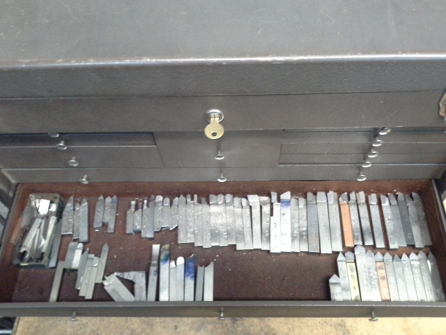

    Well, this is a home made tools and equipment thread so here are all the small hss and carbide tools I made or modified, I kept them when I sold my lathe thinking I might get a small lathe at a later time but never did.
    I bought a new 18x80 inch, 10 hp lathe in the late 80's from overtime money at work.
    It was fully tooled with all the best U.S. made support tooling, it had a removable gap under the chuck to swing about 22 inch diameter and also had a taper attachment.

    I need those....maybe with some good tooling I'd learn to machine a little better...hehehe

  16. I need to learn how to grind an edge on that kind of stuff.
    Any pointers Denny?

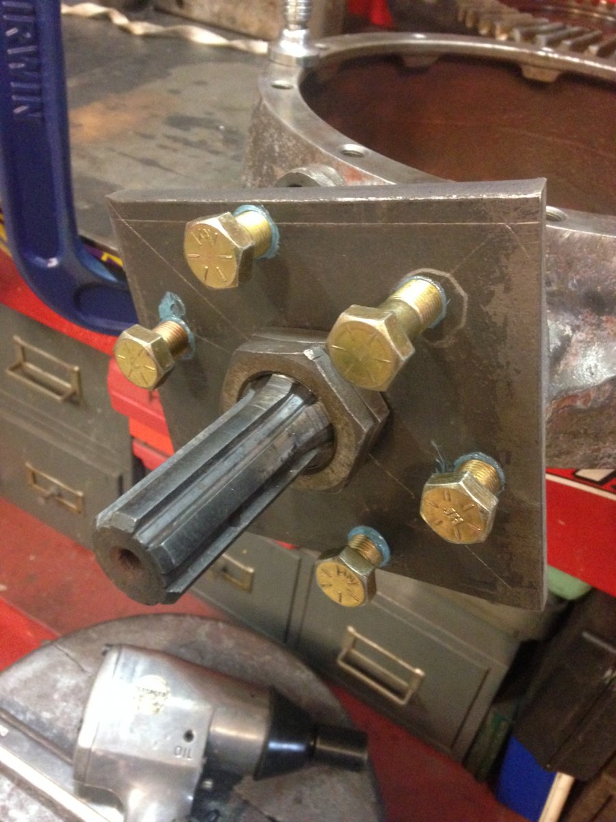

    Made this tool to pull the pinion bearing and race on a banjo rear. Impact driver shown but I didn't need it.

    Probably didn't need the grade 8 bolts either.
