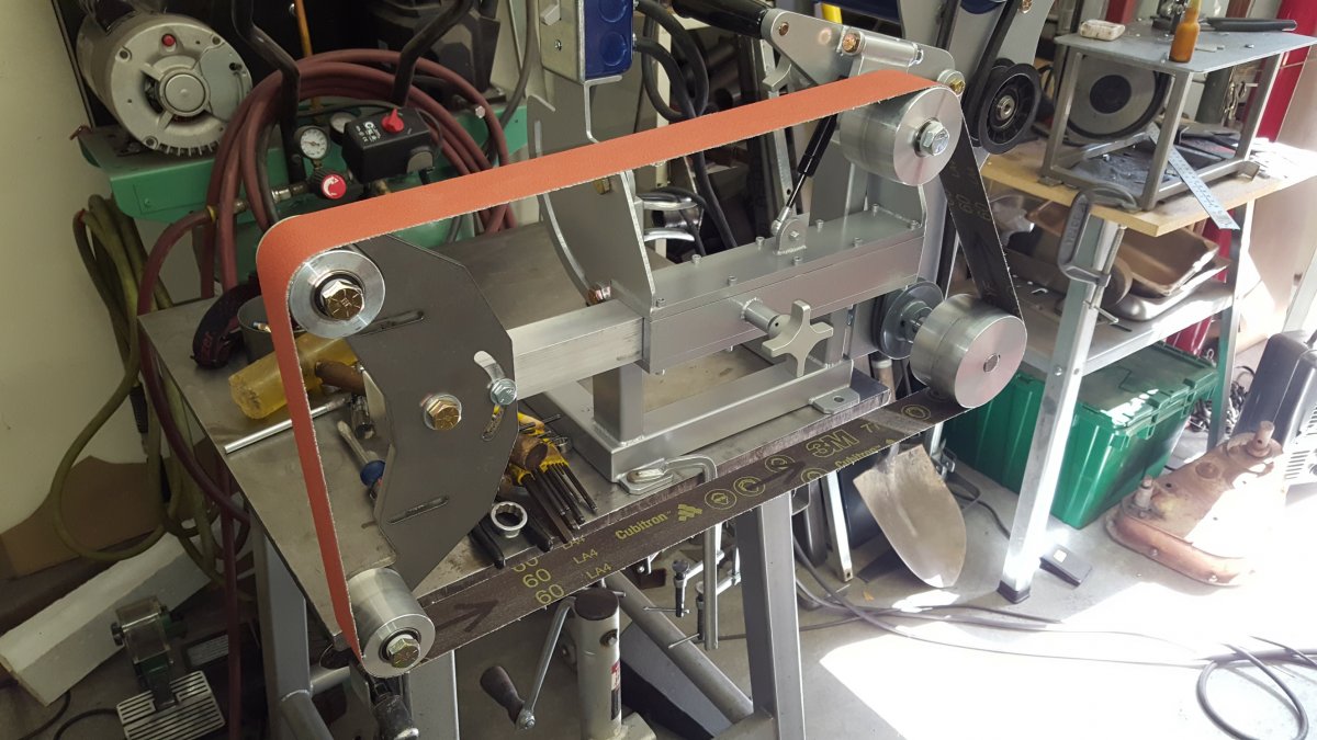

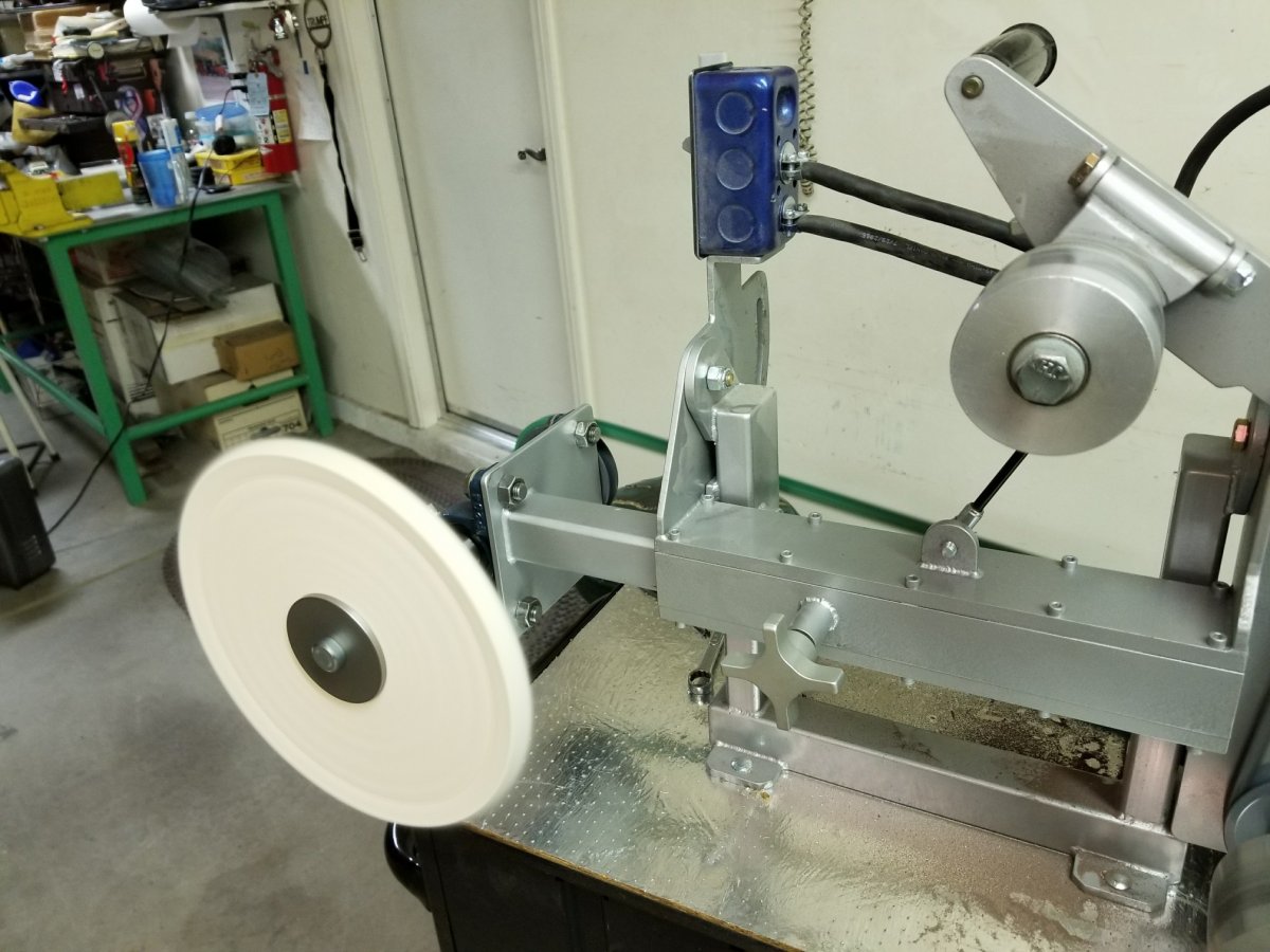

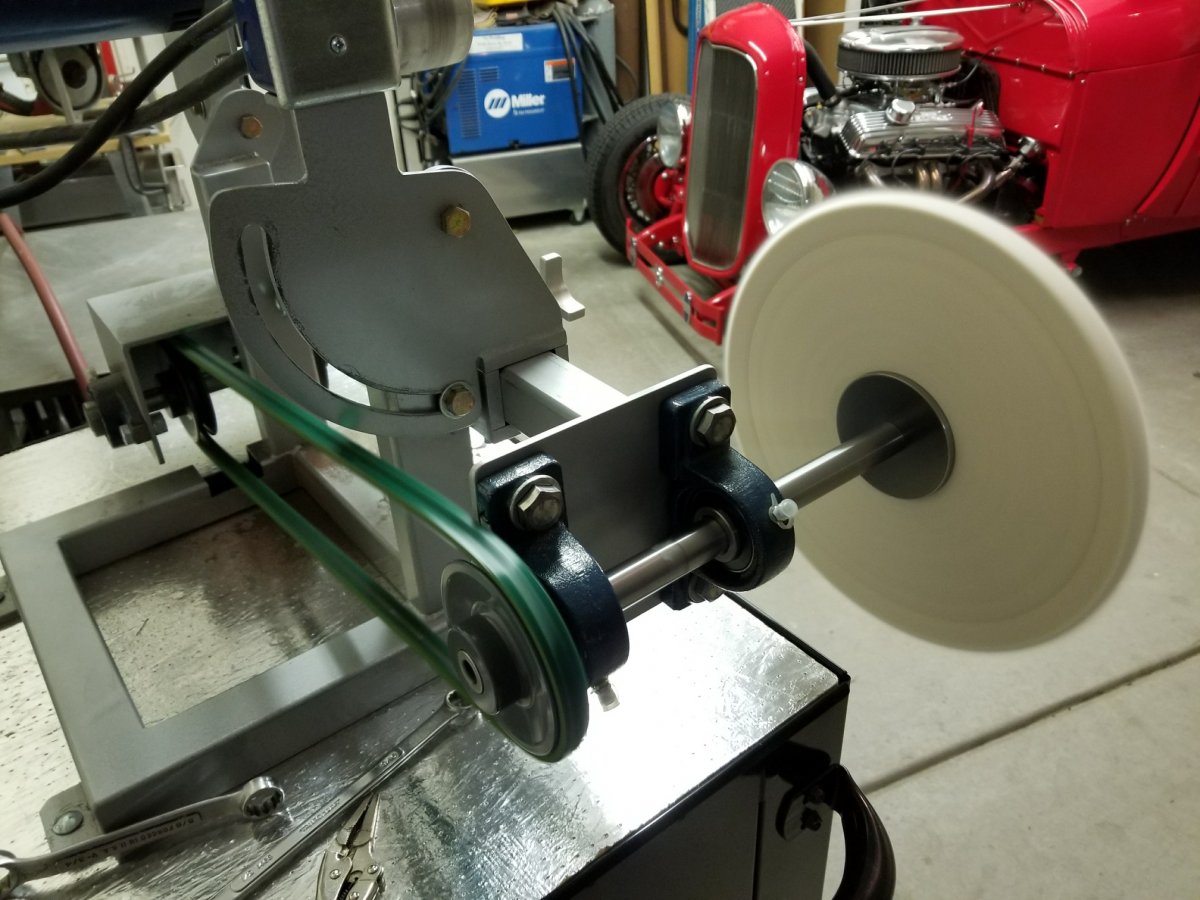

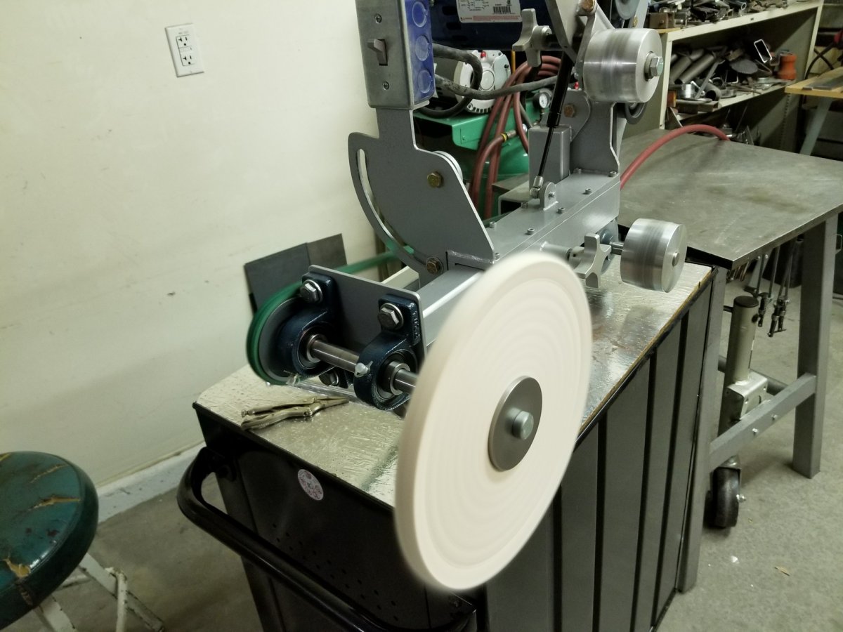

    Added a buffing wheel to my belt grinder.

    Lots of good ideas here. Stueee, I intend to copy your idea. I have a commercial one like you show and like the looks of yours a lot better. Camsore, looks like a very nice belt grinder. Mike, if you want something to do light work with you might look for an atlas or craftsman for less than your harbor freight price. A south bend 9' will likely be a little more.

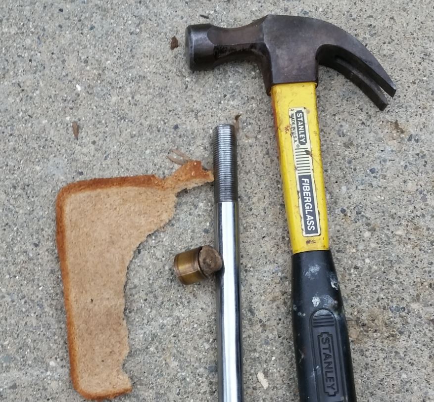

    I use silly putty to push out pilot bushings. Stuff in hole, use appropriate size rod to pound with, out comes the bushing. Never fails.
  14. bobbytnm
    Joined: Dec 16, 2008
    Posts: 1,805
    bobbytnm
    Great idea!! and a lot easier to clean up than grease. A big round of frosty beverages in your honor

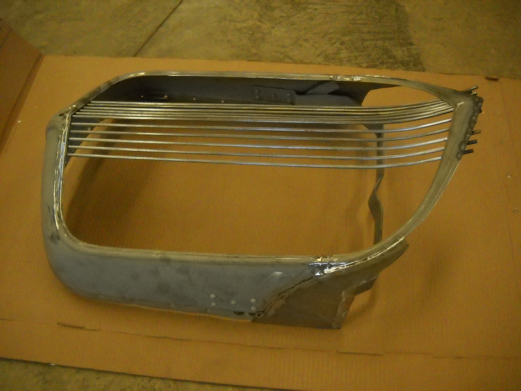

    So, I’m working on fixing and changing some stuff on a recreation of the Edsel Ford speedster. I needed to remake the front lower grill which has grill bars that start curved on the bottom, and as they move up the grill flatten out, then gently curve the opposite direction.
    Our slip roll has some grooves on the side of one of the rollers and would have worked for this, but creates too much waste on each end of the bars.
    So, I made a simple little bender for the job. I cut a couple strips of 1/2” thick steel and drilled and countersunk then to bolt in place of the jaws on a vice. I then welded some nuts to that and bolted on some spare bearings with some fender washers to help keep the rod in place. Now I have an easily adjustable bender, and I can remove them from the vice and stick them in a drawer when not in use.
    Here are some photos of it, and the grill I’m making using it.

    WOW Great tip and a great grill!:D

    Nice job on the bender! mine was much more crude.....but it worked.

    Yea, benders like yours work great as well. We have one like that too, comes in handy.
    I wanted to be able to fine tune this one a bit more since some of the bends are so subtle.
