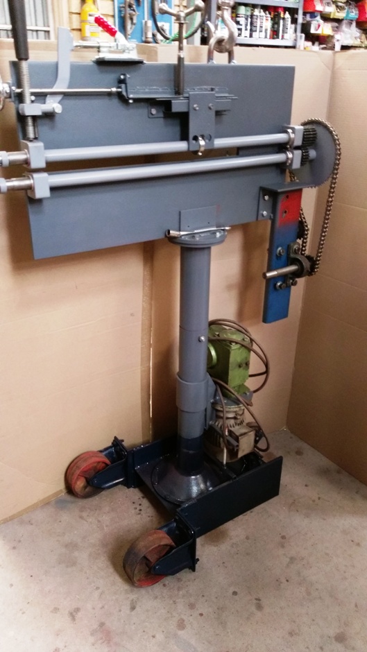

    My version of a traditional bead roller using part of a banjo diff as the stand and mostly junk from my stash to make the rest of it.
    It is almost finished...

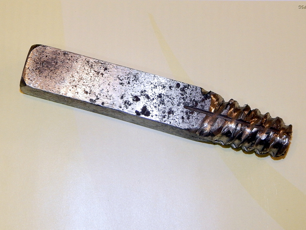

    This is pretty simple compared to most of the stuff on here. Early model A wrist pins are held in by a c clip in the middle of the rod that rides in a groove in the middle of the pin. Here one is:
    They tap out easy, but getting them back in is a trick. The clip compresses enough that the end of the pin just ****s up against it, can't tap or press it past without breaking something. I made this little tapered slug. The big end is just a thousandth or so under the pin size, small end has a nice, rounded chamfer. Just get it started and let the pin push it through. Worked fine.

    I might do a short thread on the bead roller in the new year, when it is done.
    No plans, just made from what I had...
    Before I started constructing my homemade bead roller, I scanned several sites and looked at numerous pictures on the internet which eventually had my head spinning.
    I figured a bead roller could be a handy piece of equipment to ***ist with the making of patch panels and floor repairs etc.
    I made a check list of the features I thought might be useful which included, that it be;
    Powered
    On a stand
    Relatively easy to move
    Have a throat of at least 24 inches
    Have a side offset adjustment
    A quick release which holds existing settings
    Run 1 inch shafts which step down to 7/8" for dies
    An adjustable guide
    Made mostly from stuff that I have in my stash
    Run standard 2 inch dies
    Run keyways on all shafts, even if not used

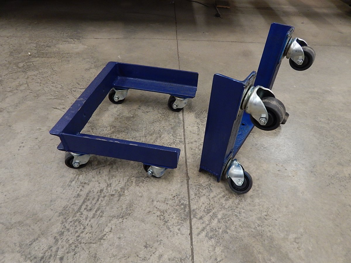

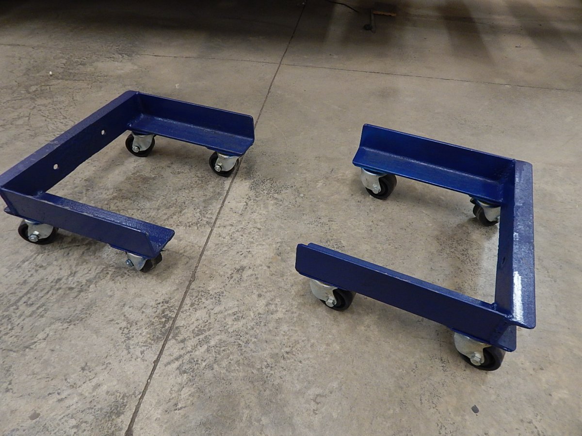

    I built some heavy duty wheel dollies to move large vehicles around the shop. Just some s**** steel and some casters rated at 500 lbs each. Good excuse to use the old stick welder!

  22. bct
    Joined: Apr 4, 2005
    Posts: 3,195
    bct
    I like the stick welder for stuff like this too . makes it more fun. no need to waste argon.
    RMR&C and loudbang like this.

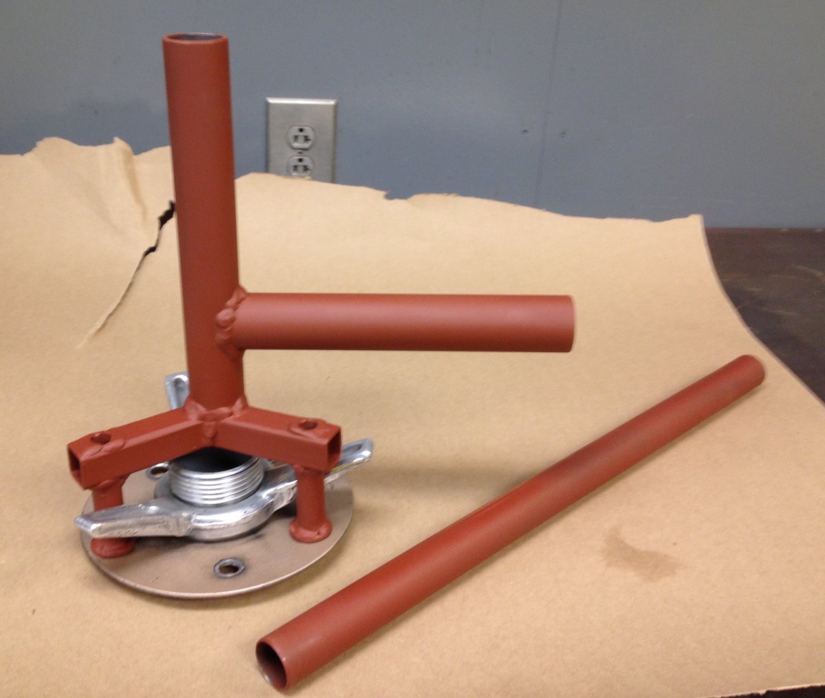

    This is another simple one. Screwdriver to remove and tighten GM light switch nut.
    The blade is a wall section from a piece of 1" square tube. The handle is a genuine Snap-on!
    My Grandson was the hand model :D

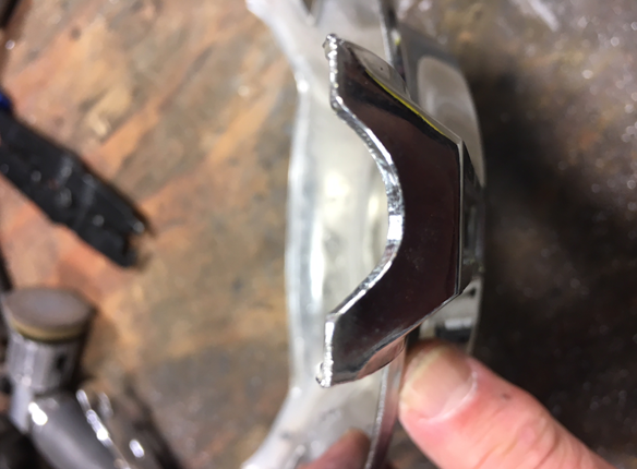

    Blue is good... just check my avator. I needed a big Easy Out to remove a piece of broken 1" tubing, but my biggest one was 5/8" . I grabbed a chunk of good quality 7/8" square steel, the 4 1/2" grinder and the die grinder with a 2" disc and this is what I came up with. I probably should have ground it further up the shank and made a shallower gripping area to catch more steel. I debated between a fluted style and the threaded version, so it got one flute up the middle of each side.
