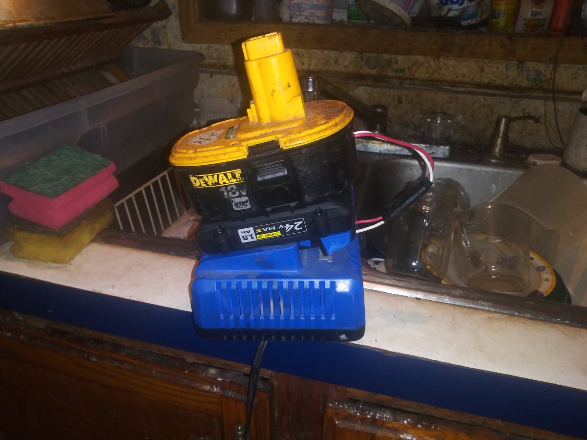

  11. ricko1966
    Joined: May 4, 2017
    Posts: 36
    ricko1966
    Your railroad track anvil is very cool I made mine out of a piece of train track back in 94 and still use it.My latest for anyone that's interested,isn't actually a homemade tool but rather an adaptation of an exsisting product.If you open kobalt 24v batteries, you will find a solder joint at each end of the battery 1 positive 1 negative.Solder in a couple of pieces of wire gut your junk every make batteries hardwire.the kobalt battery into your old battery and glue it face down to the bottom of the dead battery.Now it mates with your tool and can be slid into a kobalt charger, everything I own 18v or 24v is running on kobalt batteries with no issues.I really had no fear going in anyway because I always ran 6v starters on 12v when I upgraded and they always held up.I may be wrong but I theorize the tool will actually last longer.Remember the switch from 6v to 12v? The wire gauges dropped considerably.Oriiginally I used two prong connectors and industrial Velcro so I could swap the kobalt batteries around but they are so cheap it's easier to just build as many batteries as you need.

  15. ricko1966
    Joined: May 4, 2017
    Posts: 36
    ricko1966
    Top pic far right unmolested battery in the middle the two red wires are what you add the solder joint is already there to the left is the removed batt top.. 2nd pic gutted dewalt and Ryobi battery with pigtails soldered in. 3rd pic. Velcroed pigtails dewalt/kobalt battery on the charger.Im not doing pigtails and Velcro anymore.I don't like the wire loop hanging out and the Velcro isn't as secure as I like .They are all getting a minor rework.Eliminate the pigtails and glue the batteries in place..FWIW I chose the kobalt batts because they have the protection circuit and level meter and are inexpensive.

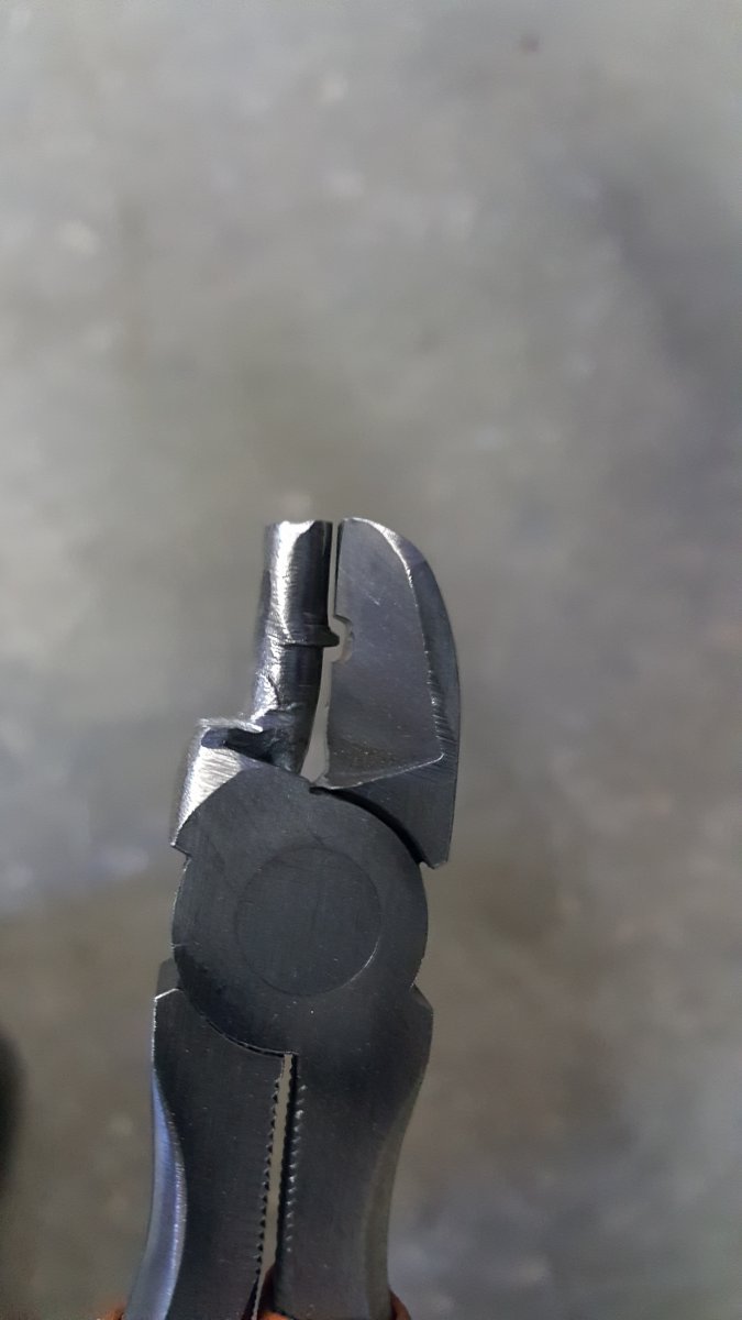

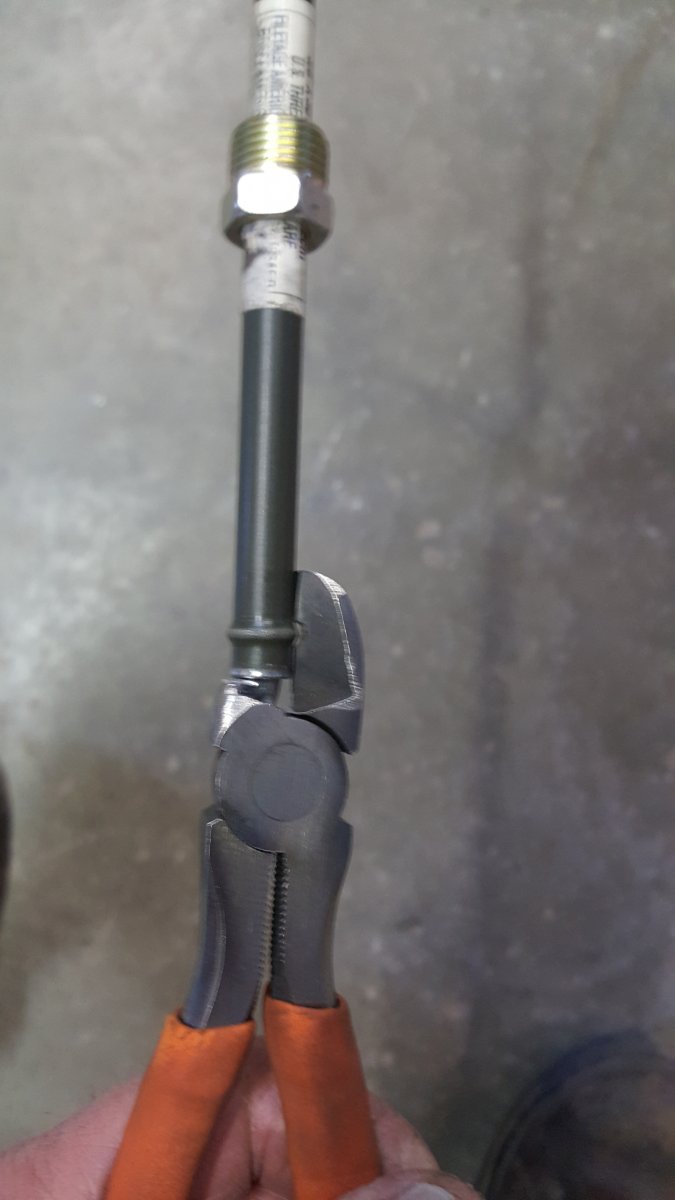

  16. Dyce
    Joined: Sep 12, 2006
    Posts: 1,980
    Dyce
    Made a 3/8 tubing beading tool from a cheap side cutter.
    fredeuce, charleyw, 30spdstr and 16 others like this.

  18. gatz
    Joined: Jun 2, 2011
    Posts: 2,274
    gatz
    Bravo !!
    And here I was always fussing around making sleeves to solder onto the tubing.
    @Dyce Do you heat up the tubing while forming it ?
    D-Russ, 56don, loudbang and 1 other person like this.
  19. Dyce
    Posts: 1,980
    Dyce
    No heat just turn the tube and squeeze. It forms quite easy.
    I just cut one blade off of the cutter and ground the remaining one down so it is about 1/8in wide. The part that slips into the tube I turned on the lathe and trimmed half of it down on the belt sander until it fit inside of the tube. Cut a slot and tig welded it together. It took about an hour.

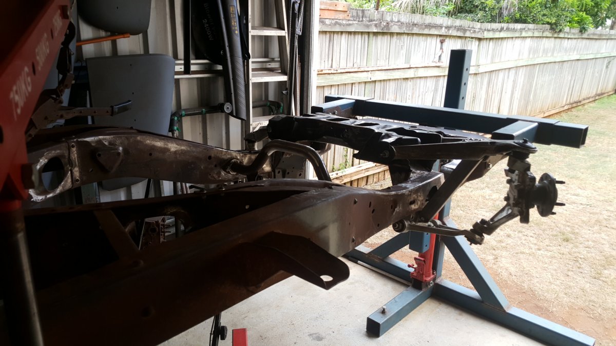

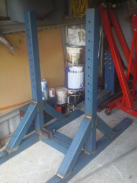

  29. mgtstumpy
    Joined: Jul 20, 2006
    Posts: 9,279
    mgtstumpy
    HD rotisserie, 1/4" RHS tubing and spiggots. Plenty of adjustment. I'll be able to easily lift the Olds frame with body and spin around. I added a 3/4" threaded balancer rod to get the CoG right. Wheels maybe later. 20170226_160546.jpg Rotisserie.jpg
  30. Sporty45
    Joined: Jun 1, 2015
    Posts: 1,388
    Sporty45
    Wow, that is heavy duty! I used 2 engine stands to twirl my frame around, but don't have plans to try to do it with the body on. I made a wooden body dolly to put the body on and it's high enough to get under the body to work on the floors.
