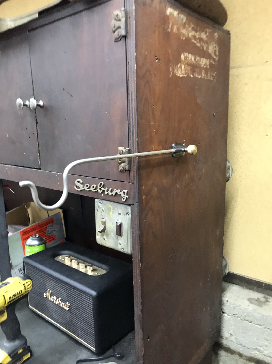

    I can't quite see how the grips are hanging. By the adjustment knobs?
    Sent from my Pixel 3 using Tapatalk
  2. David Gersic
    Joined: Feb 15, 2015
    Posts: 2,813
    David Gersic
    from DeKalb, IL
    Looks like they hang from the knob, yeah.

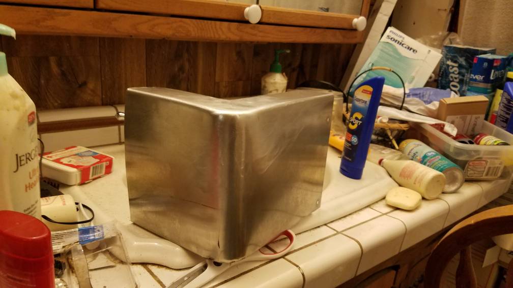

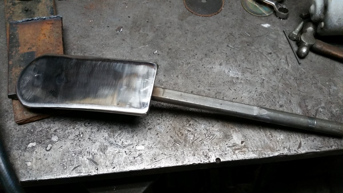

  3. I got the idea for these shaping tools from a youtube vid, so I made my own shaping anvils that fit in my bench vise.
    I used these anvil forms to shape this stainless steel practice panel from a cutting of a refrigerator door into some sort of ....
    .... well, something...
    I haven't used each shape yet, but so far it's been working out fine.
    I am just now getting the hang of working and tig welding stainless, and making the welds and seams invisible.
    Just getting started .
    Just clamp one in the vice, and bend the metal over it.

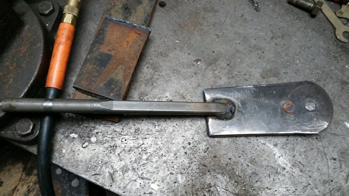

  4. I made this grounding device because I don't trust the "throw it on the table" grounding to be reliable.
    About a foot and a half of wire and two clamps.
    The pipe in the handle lets me also use it to hold parts that wont stay put.
    OR I can use it for welding parts on the table to parts that arent quite on the table. To make sure that both pieces have the same arc-attraction to the tig torch when starting the weld.
    WHY BE ORDINARY ?

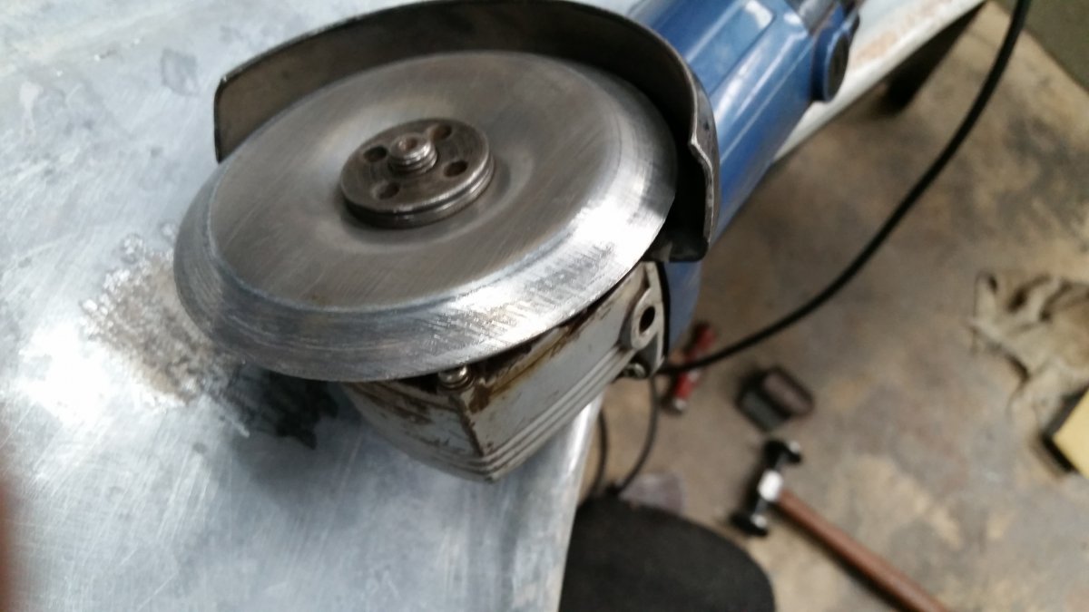

    I have been into the body work lately and have wanted to try some new tools but being the tightwad that I am. :D
    Shrinking disc. :)
    Slapping hammer :)

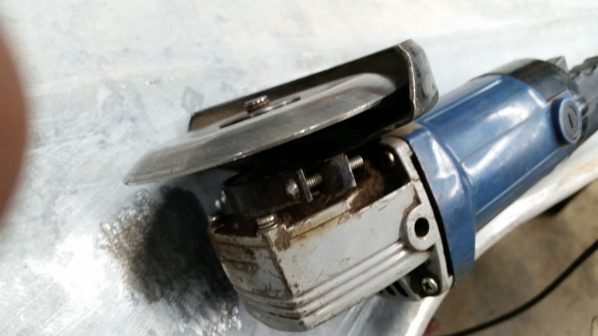

    In order for the shrinking disk to work properly it needs to be contracting the panel flatly. The arbor and attachment nut need to be below the contact surface.[​IMG]
    Sent from my SM-G950U using Tapatalk
    GuyW, biggeorge, loudbang and 3 others like this.

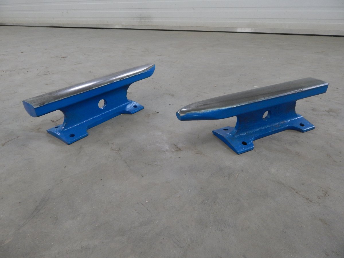

    I know there's been lots of railroad anvils posted here before... some of them are mine, but it's been a while and I made these 2 for my son and son in law for Xmas. Just used a cutting torch and grinders. Not really happy with the shape of the horns, but I ran out of time. DSCN4579.JPG

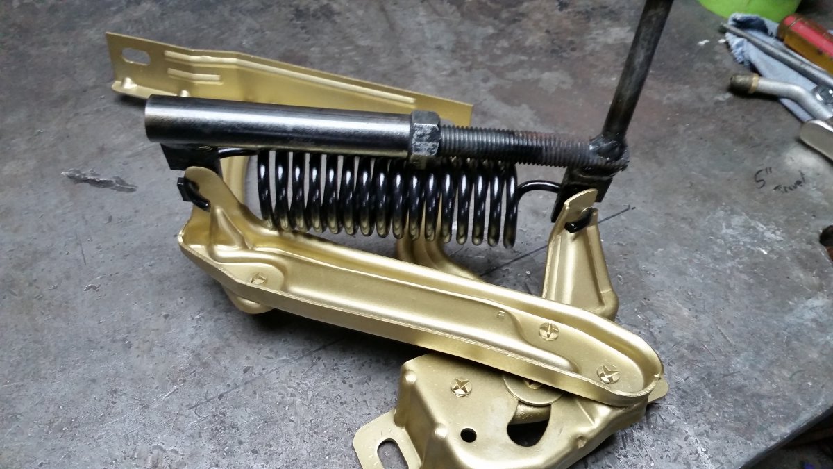

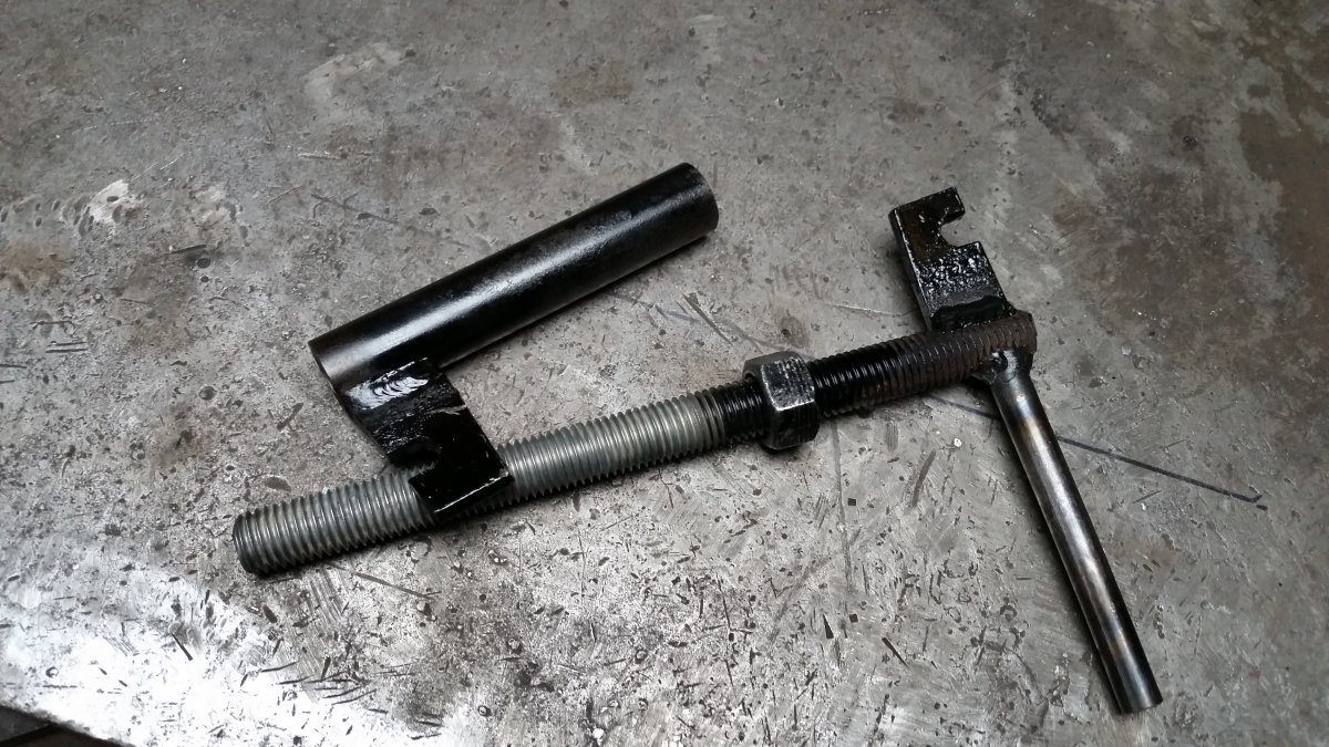

    Made this to remove the hood springs so I could clean and paint them.
    I used a piece of 1 inch tubing, some 3/4 inch all thread and some plate s****s.
  13. Boneyard51
    Joined: Dec 10, 2017
    Posts: 6,776
    Boneyard51
    Now why didn’t I think of that! Awesome! I have fought them before! When I was young and strong it was no problem! Hope you don’t mind if I copy yours?
    I bet one like that would work on some clutch springs too? Maybe?
    Bones

    Go for it Bones, the only thing I would have done different would be to make the tangs a little longer to make it easier to paint all around the spring.

    I needed one of those a couple of months ago. That looks way better than the screwdriver and wedges that I used.
    It looks like your method will result in fewer blood blisters.
    Hopefully I will remember this thread the next time I need to take a hood hinge apart.

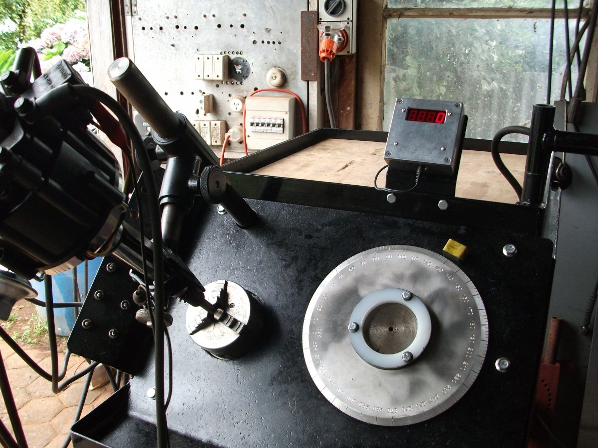

    Distributor machine

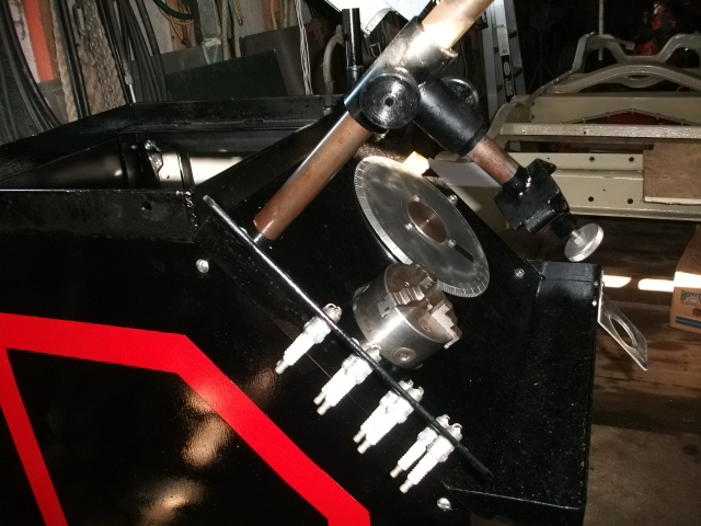

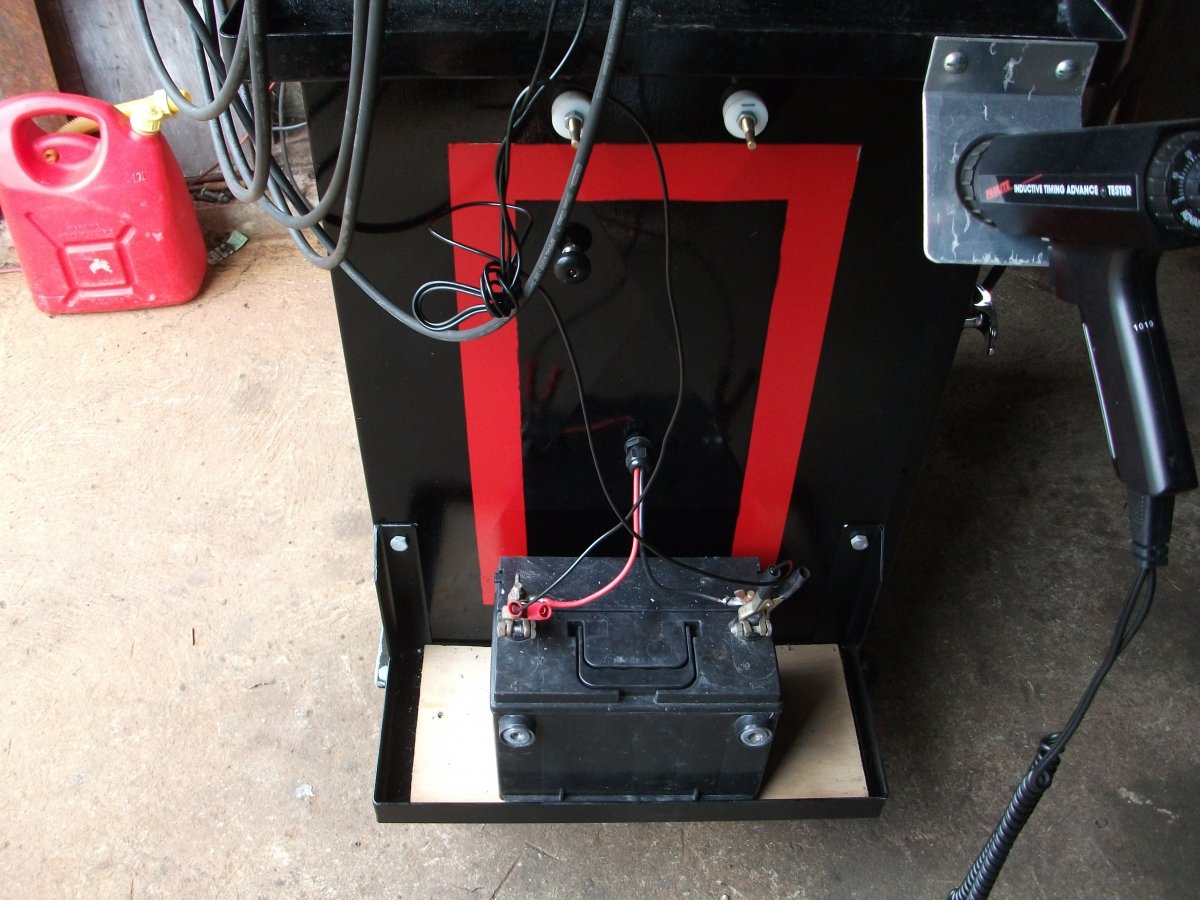

    All it does is replicate the ignition system in the vehicle. So it has a degree wheel which is made from a circle of aluminium plate with 360 degree marks, and fitted to a spindle. This is geared to another spindle which has a lathe chuck mounted to it. The chuck holds the distributor shaft. I used a toothed cambelt and toothed pulleys of an old junkyard engine to gear the two shafts together.
    So the distributor spins at half crank speed.
    The distributor body is clamped so it cant spin.
    The electric motor speed is variable, controlled by a VSD unit.
    The revs are measured with an electronic rev counter taking its pulses from a piece of aluminium tape on the degree wheel shaft. It has an ignition coil and 8 spark plugs fitted, and powered with a 12v battery.
    You the hook up a timing light, run it up, and aim the light at the degree wheel to see what's going on. Much like in the vehicle, but easier to make changes.
    This machine is no where near as sophisticated as a Sun or an Allen. All it does is makes bench settings for advance curves much easier to do, rather than in the vehicle.
    You can also hook up a Mity Vac to mess with the vacuum side of things.

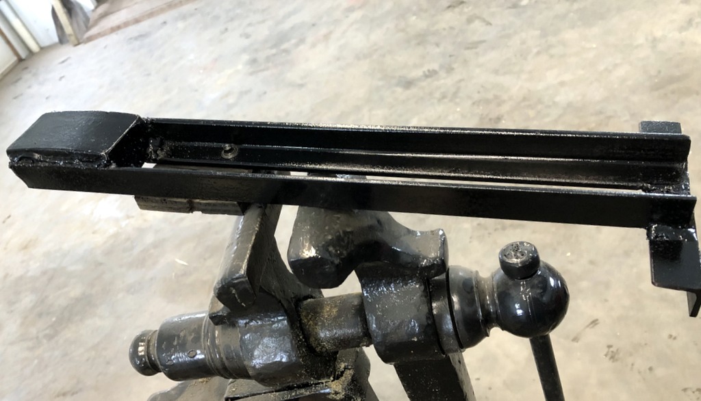

    I probably shouldn't have taken this pic on my black leg vise... makes it a little confusing. I don't imagine many of you are putting laminate flooring in your shops, but we all have the honey-do list. A friend of mine was renovating an older house with plaster walls. When trying to snap the laminate panels together at the ends or side walls, we couldn't pry against the walls or it would damage the plaster. I made this out of s**** iron with a plywood pad under the striking end to protect the flooring. The angle iron fits on the end of the plank, and striking the hard chunk of s**** iron at the end lets you pull it back into place and close gaps in the flooring... affectionately known as the Super Smacker Backer... it gives you enough clearance to swing the hammer away from the wall. An angle iron attachment for your slide hammer would also be another good option... IMG_3207.JPG

    I have plaster walls, and three rooms of laminate. I have a tool like this one, probably from Lowes
    Just a bent piece of steel. There’s a piece of (fuzzy side) Velcro on the back, so as not to scratch the floor. Hook the end, smack it with a dead blow hammer, and move on. Is yours doing this, or something else?

    Same deal... just a whole lot tougher for the hard to squeeze boards...

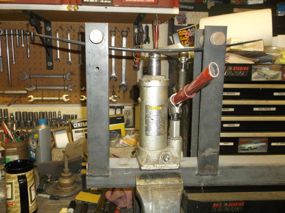

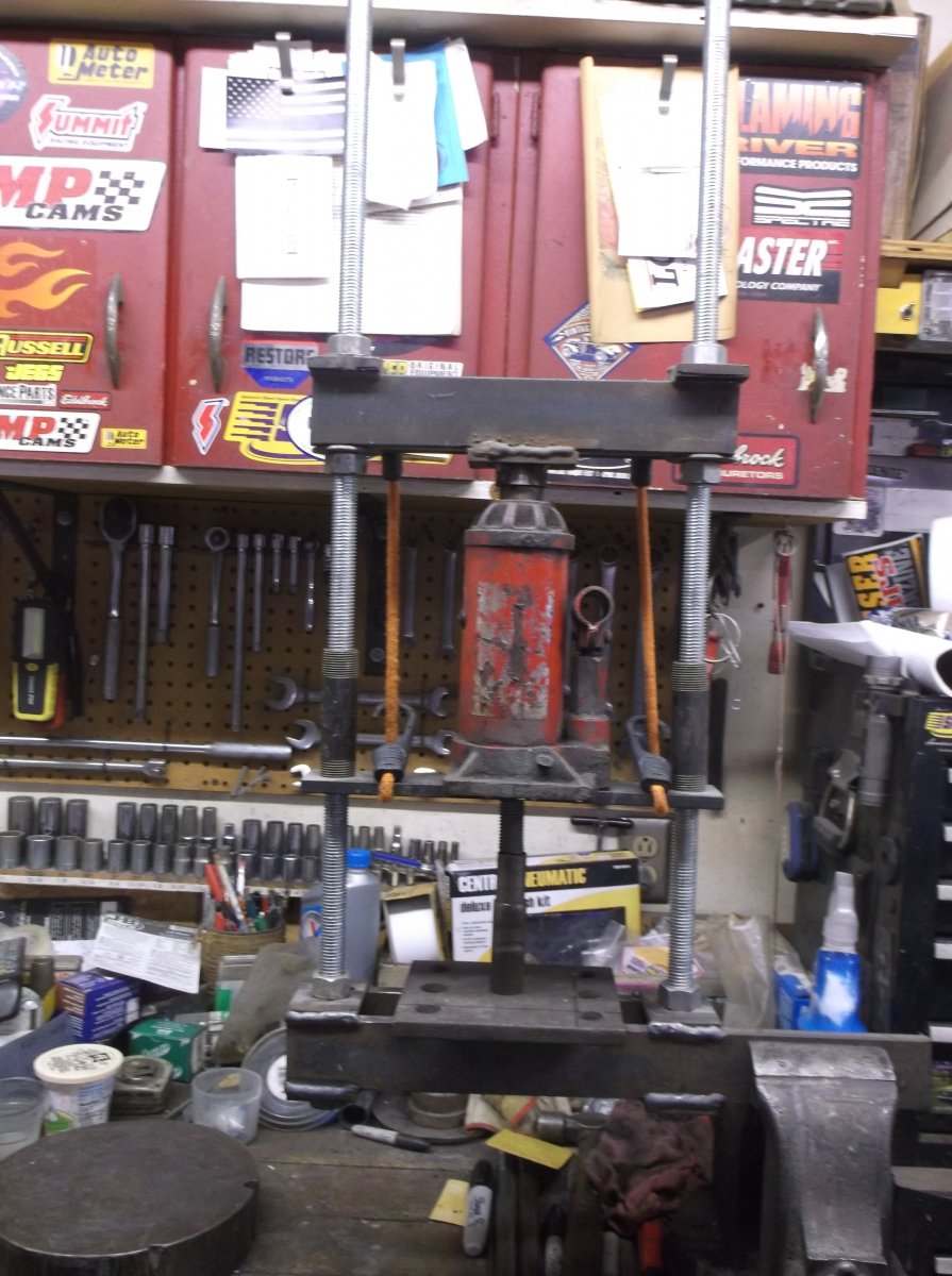

    1st pic is a press I made to press Ford axle bearings on several years ago. I've used it for many other press jobs since, and it works good. Best thing is, I just take the bottle jack out, take it out of the vise and store it under my bench. The other thing is a simple jig to re-arch or de-arch spring leafs.
    Gary
