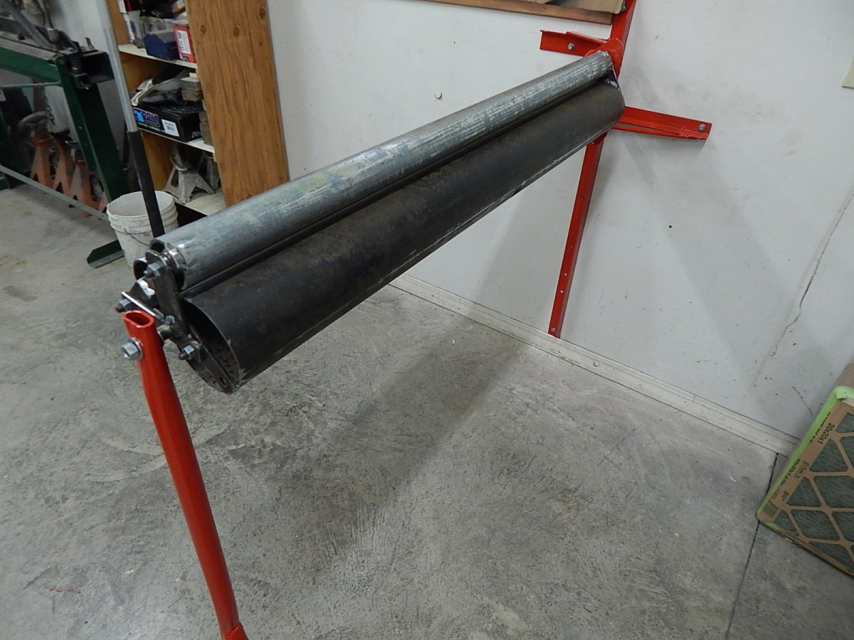

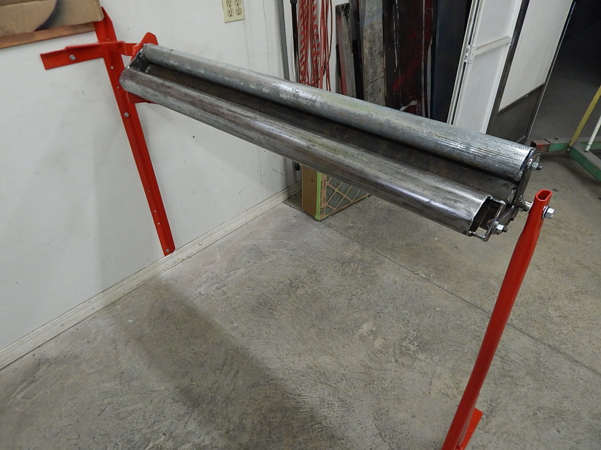

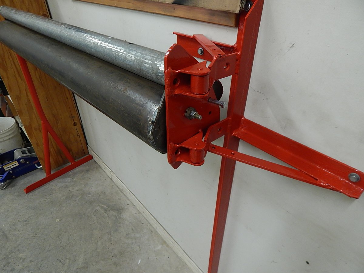

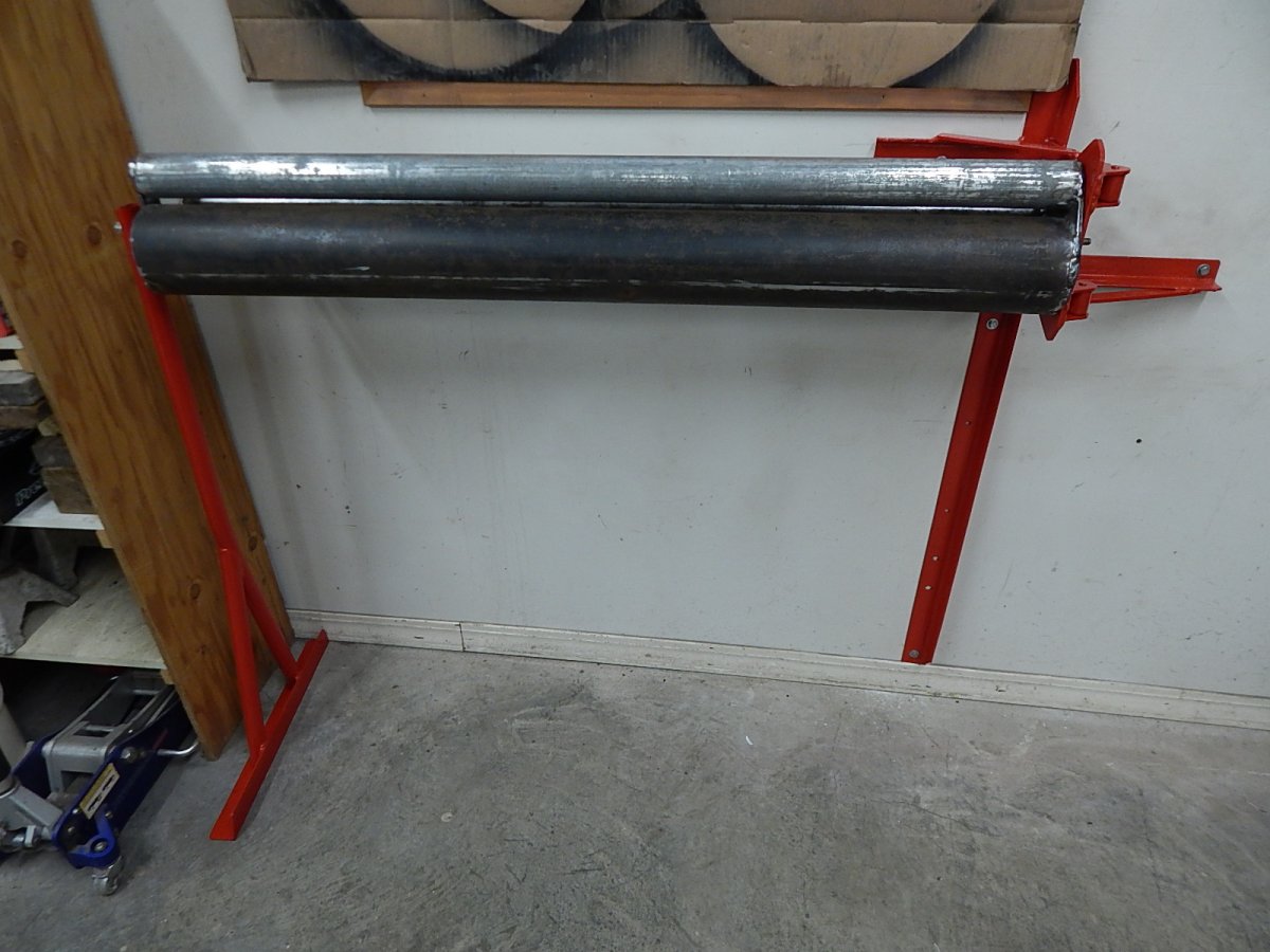

    Just built this metal bender from some pipe and s**** metal. The pipe diameters are 2.5, 4, and 5.5 inch by 4 foot long. The pipe ***embly rotates and can be indexed in 3 positions. It's hinged to swing against the wall when not in use.
    Should be handy for making trans tunnels, etc.

  4. I like that one end is fixed to the wall, helping it stay in place and rigid.

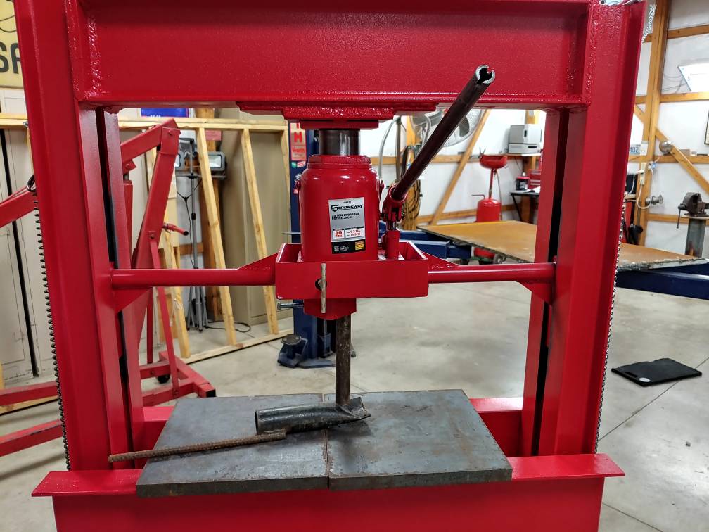

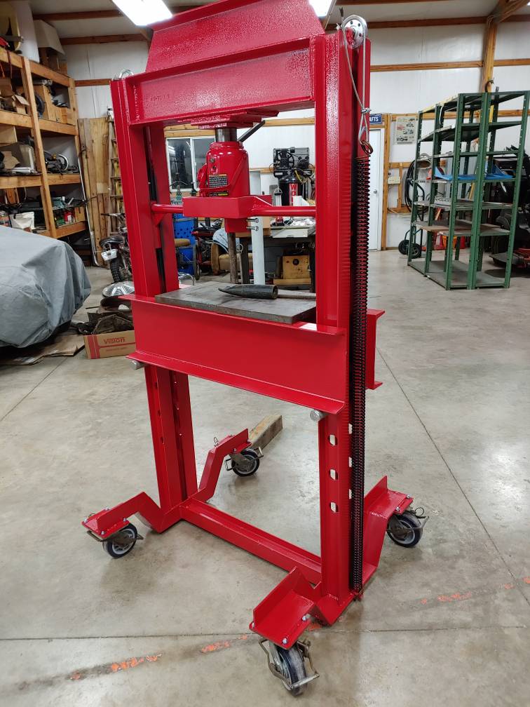

    Wanted a heavy press, but didn't like the ones I could actually afford. When I finally got enough s**** together last winter I got it build. Working on a press finger brake now, while going to night school for precision machine. I didn't like the return springs right in your face, so moved them outside with safety cables in them. 20191017_194756.jpeg 20191017_194813_HDR.jpeg
    Sent from my LM-V405 using The H.A.M.B. mobile app
    BradinNC, Phillips, brEad and 23 others like this.

  15. How are the rubber wheels holding up. I was thinking of doing the same to my large press, but all I have is rubber wheels, and am afraid that they will distort because of the weight of the press.

    The wheels are not true rubber. If you go to surplus center .com you can find lots of wheels that fit various casters. ( I paid about $4 a wheel). I dumpster dived for the set I have and rebuilt them. The casters on my press were rated for 500 pounds per wheel or so. And they have been on there for a year or so and no issue, roll great.

  25. Thanks, I was searching through my pile of "stuff" and I found a set of rotating cast wheels that even have locks, so my problem is solved.

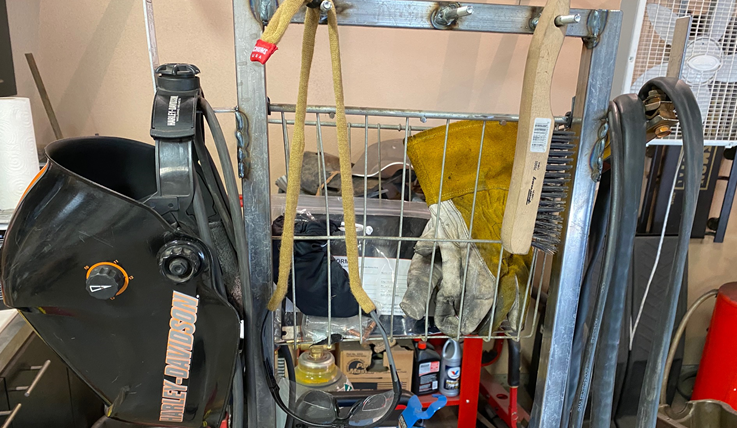

    In my own digs today and working on my new welding cart creation. A couple weeks ago I built an upright to get my welding cables and plasma cables off the ground. Today I added a basket to keep my gloves and tool kits in.
    A buddy said he had his old newspaper delivery rack off his Schwinn so he brought it over and said I could hack off one side. Which I proceeded to do.
    And used the clamps that so many hate to attach it to my cart
    Yeah, pretty cool huh? I also welded some bolts on the front to hang my brush, plasma gl***es, etc. And some hooks on the side that I bent out of steel that I had lying about to hold my helmet, clamps and the cables - welding on one side, cutting on the other. Basket is mounted high enough to open the welder service door.
    I added a lower shelf a few weeks back for my plasma cutter,
    And hooks on the side for the 220 plugs and some clamps.
    Now that's a welding cart!
