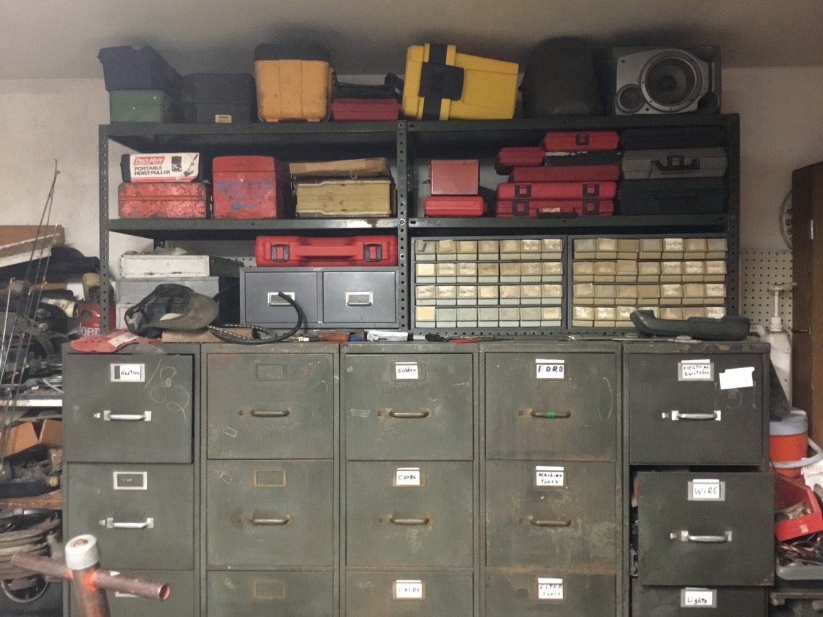

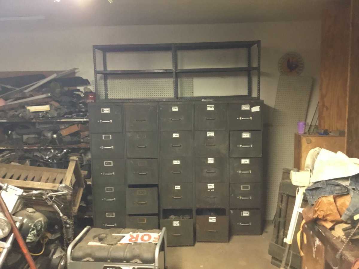

    63068D49-284F-49C5-9AD6-7450FFABE5A5.jpeg 675767F4-2995-4887-8DFA-5C976B56B398.jpeg
    This is what I did with file cabinets, for the first time in a while, I know where stuff is and where to put stuff I find while cleaning my shop!
    Well, I have added a Little to it, still working on it when I get time!

    Hey, you got almost as much sh** in your shop as I do. Lately I have been on a quest to get most of the drawers labeled...........then there is less of a tendency to forget that I actually have something already.:D:D:D

    I have actually labeled the drawers, as I couldn’t remember exactly where I was putting stuff and had to open two or three drawer sometimes before I found the right one! Once I’m sure I’m going to keep it that way, I will make some nicer labels, the one I have now are just scratch paper and a sharpie. I filled my upper shelves with all my “ boxed “ stuff like pullers, hole saws and other things that come in kit form. I’m moving my camping stuff to the attic, as I’m probably not going to tent camp anymore, but don’t want to get rid of it. I have some junk! But, I’m getting there, but Spring leaf cleaning and mowing is eating my lunch! And I’m fixen to put in a privacy fence behind and beside my detached garage, to store my “ junk” out of sight! Plus I’m trying to get my old motorhome ready to sell, as I already bought a newer one, and I have to fix some things on it, I’m helping my friend get his new home in shape, that he bought two houses down from me, I ‘m also helping another friend get two of his five race cars ready ( for what, I don’t know) ......I don’t know about this retirement stuff! I need to go back to work and get some rest! LOL!

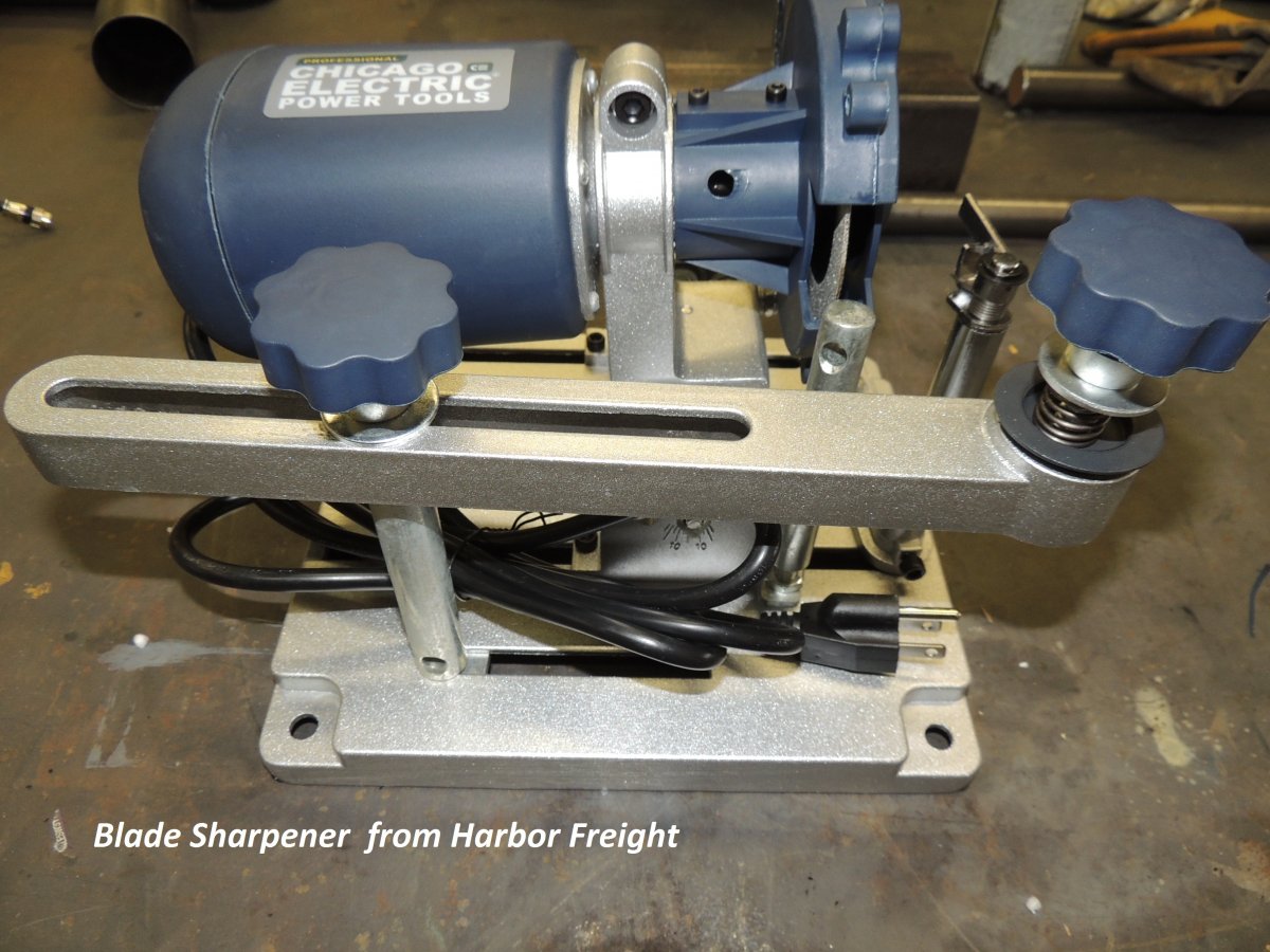

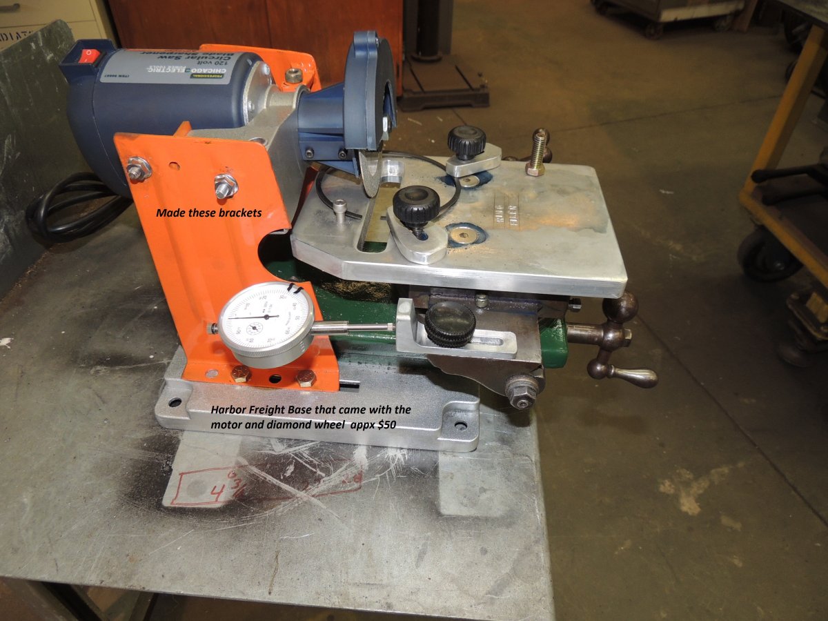

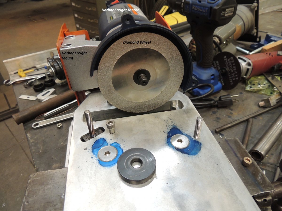

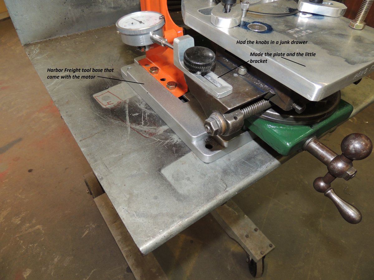

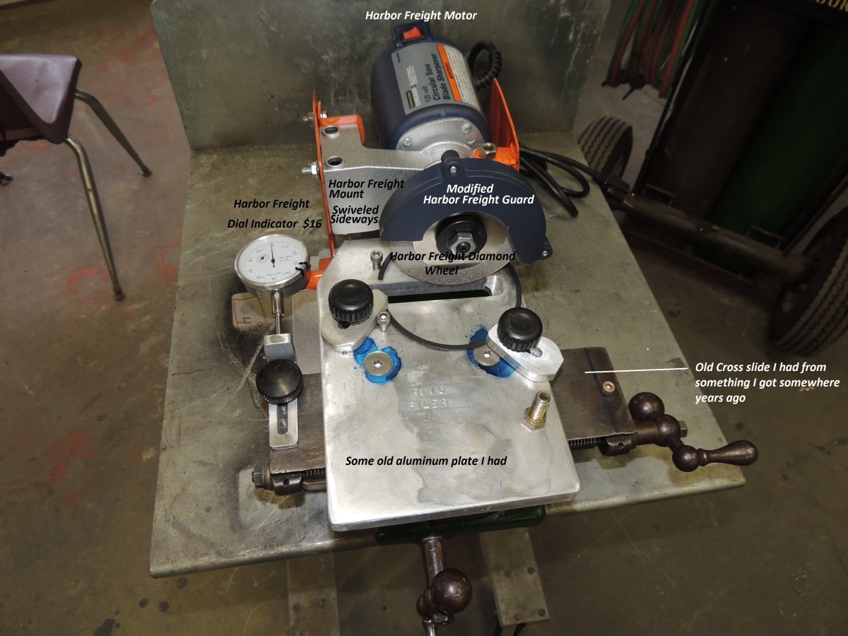

    Finally finished this thing today while I'm on quarantine.:D
    I decide I wanted a better ring filer than the little hand crank one I had. Didn't want to pay the nearly $1000 for the one I liked. Didn't want to pay about $400 fr one I didn't really care for. So I looked thru some "treasure drawers" and rooted out an old cross slide that I had laying around. When you go to auctions sometimes you buy cabinets and they have the darnest things in them. Probably where I got it. Took a trip to Harbor Freight and started looking for something cheap and useful. Found a saw blade sharpener . Bout $50 Never saw one of those before at HF cause I never had a use for one. Grabbed a nice little $16 Dial Indicator while I was there. It works good!
    Most of the other stuff was laying around or stashed somewhere in my shop just for occasions like this. Anyway after a lot of piddlin and sittin n thinkin, I came up with the monstrosity pictured below. Next I'm starting on a valve spring tester cause I'm too cheap to buy one of the good ones.
