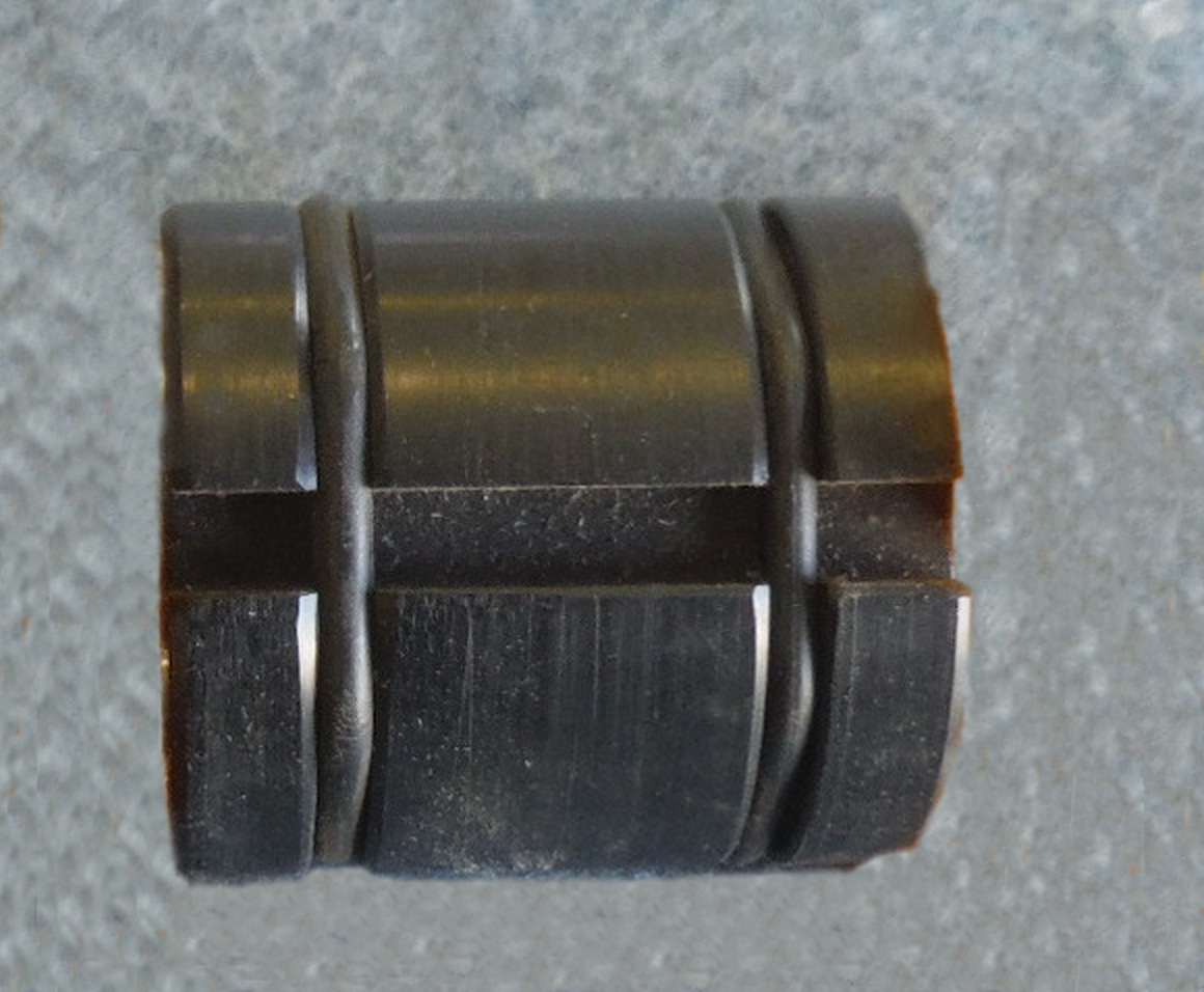

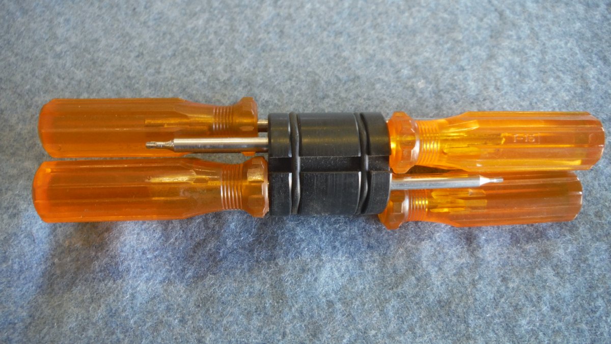

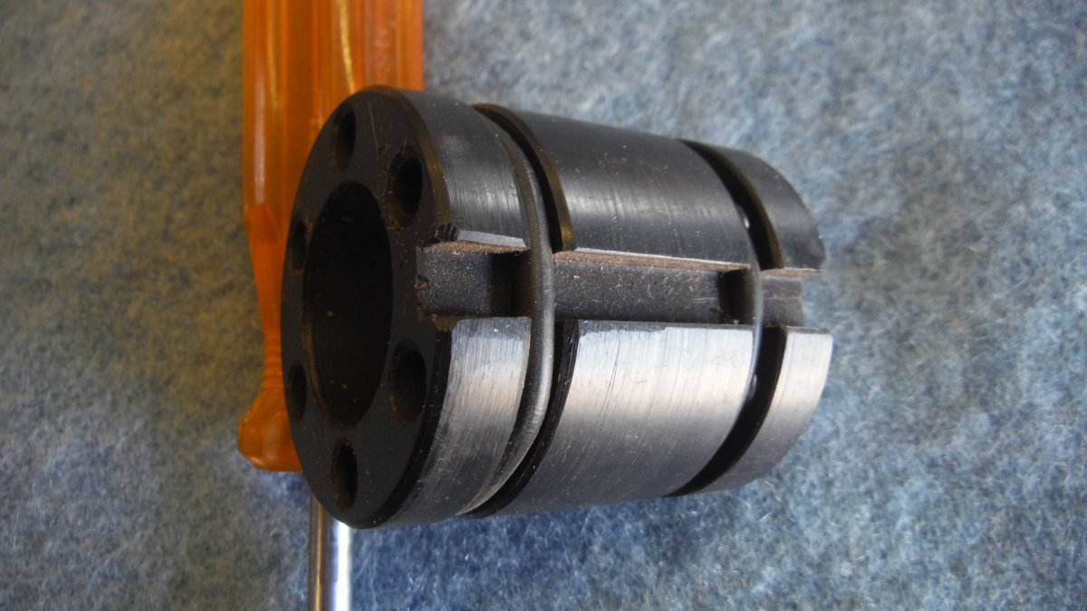

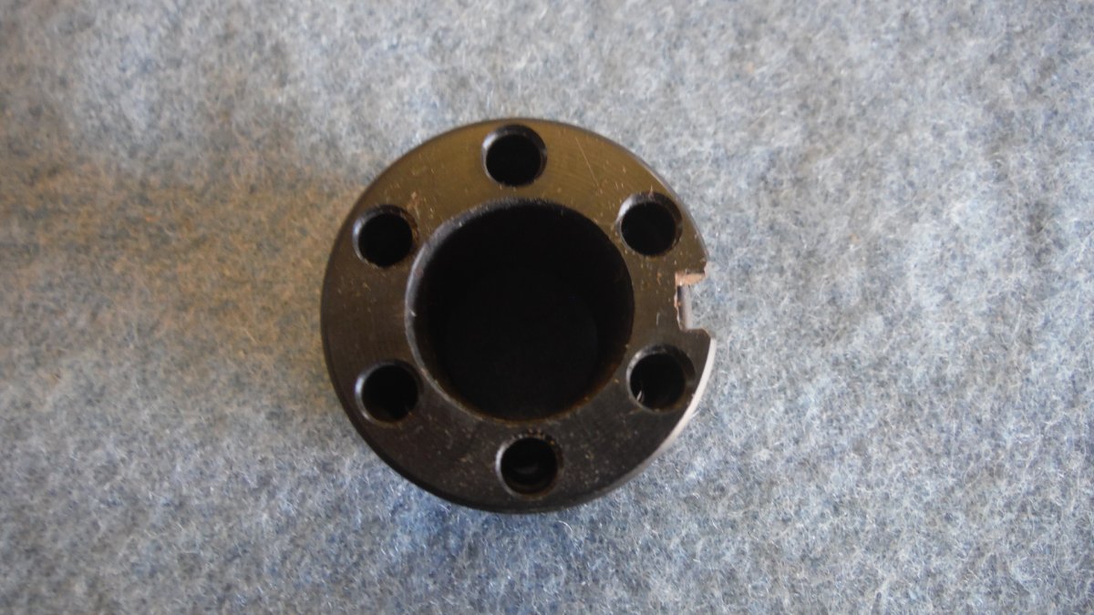

    This set of 6) Torx drivers (brand X) came in a plastic bag, which was always unsightly in the tool chest.
    I made this holder out of black Nylon to keep them arranged; it takes up a lot less space and looks a heck of alot better.
    The annular cuts for the O'rings intersect the Ø .25 holes so that the O'rings bear against the shafts of the Torx drivers. The O'rings provide enough friction to hold them in. The slot on the side is for removal of the O'rings.

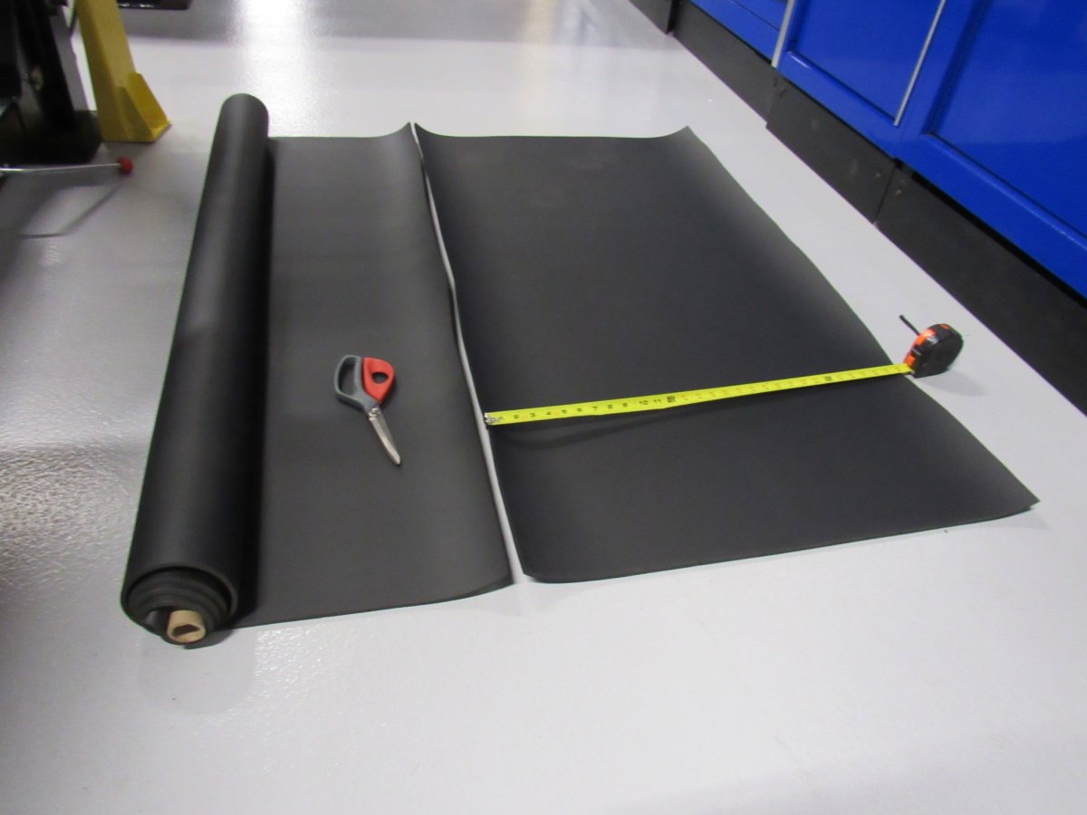

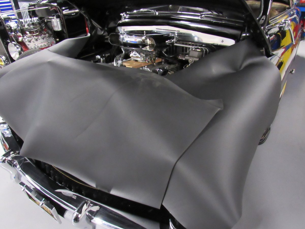

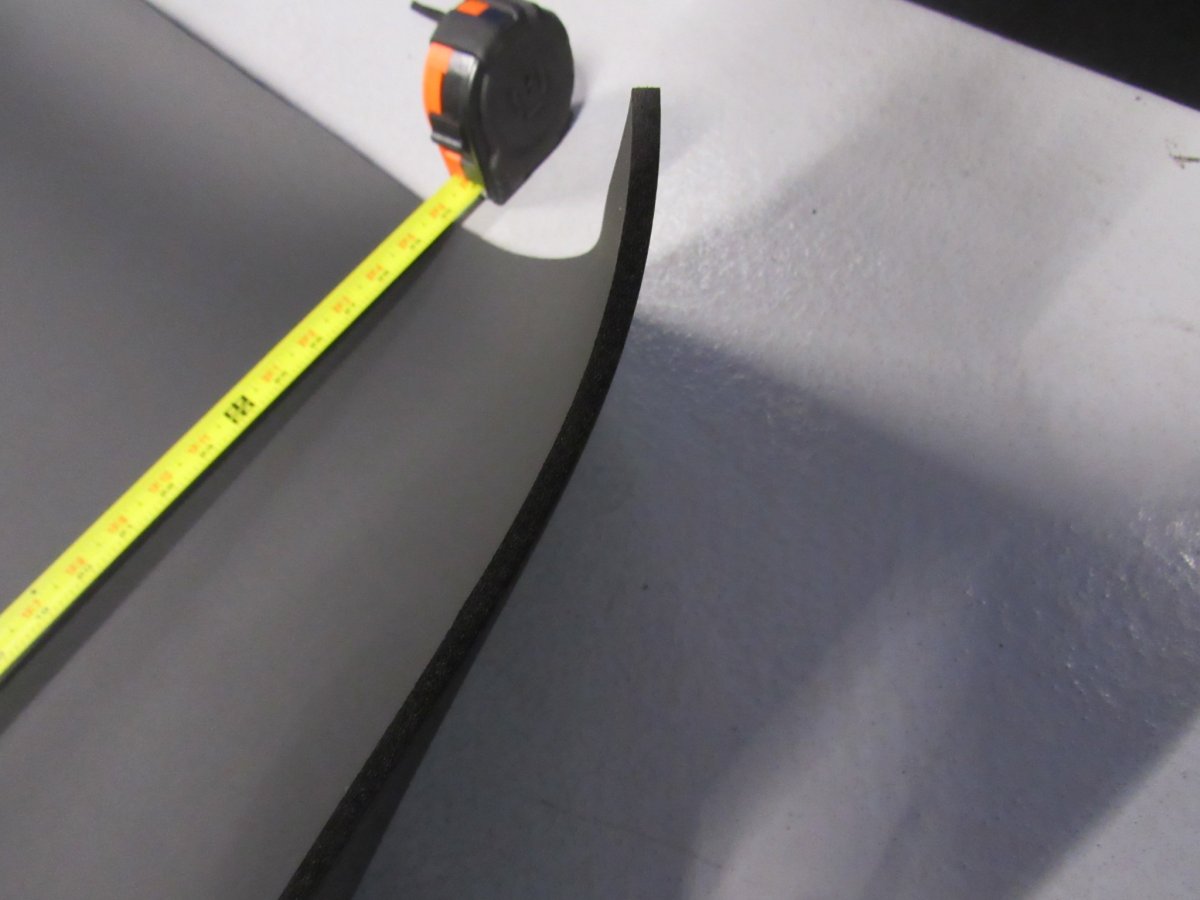

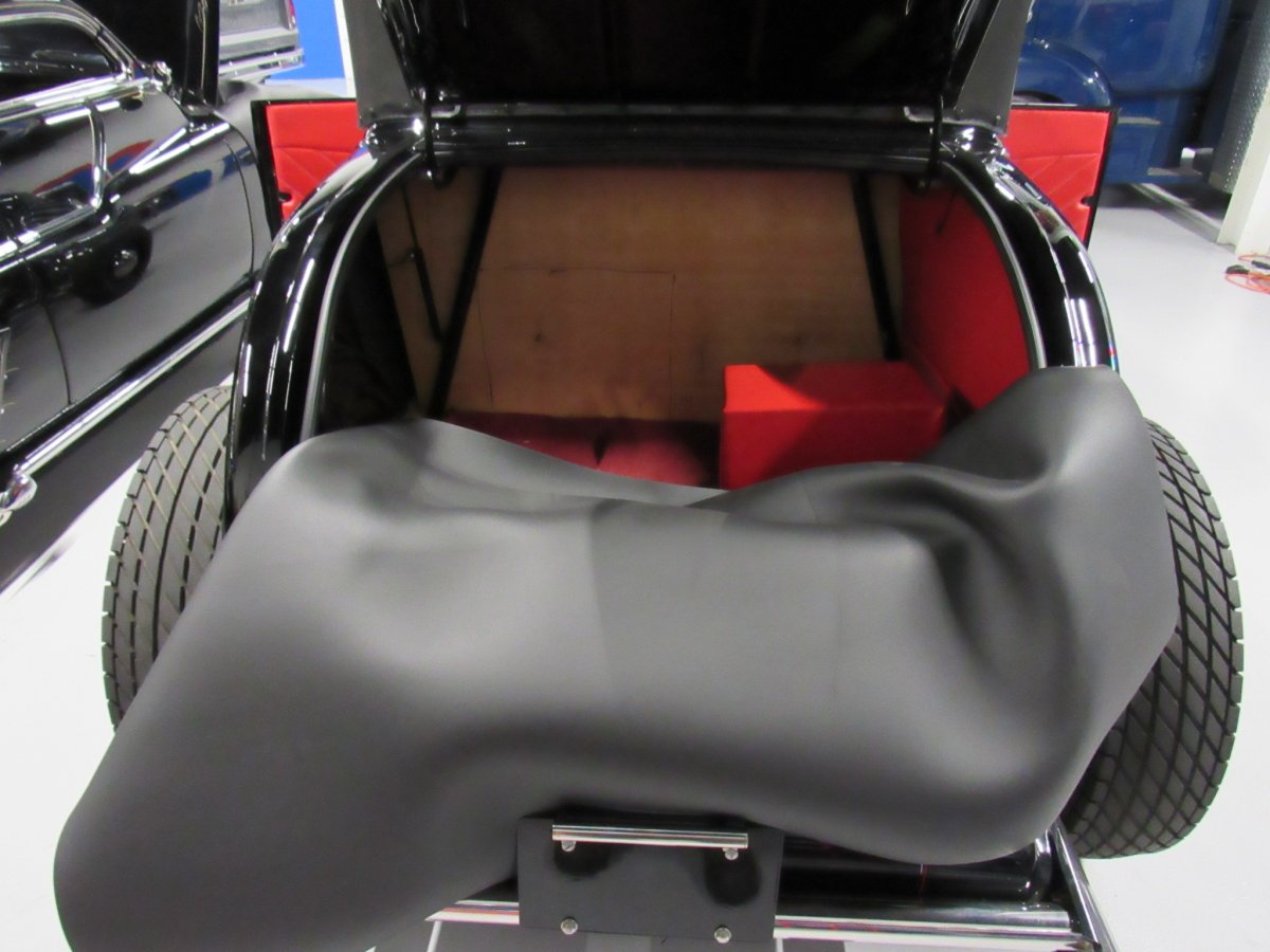

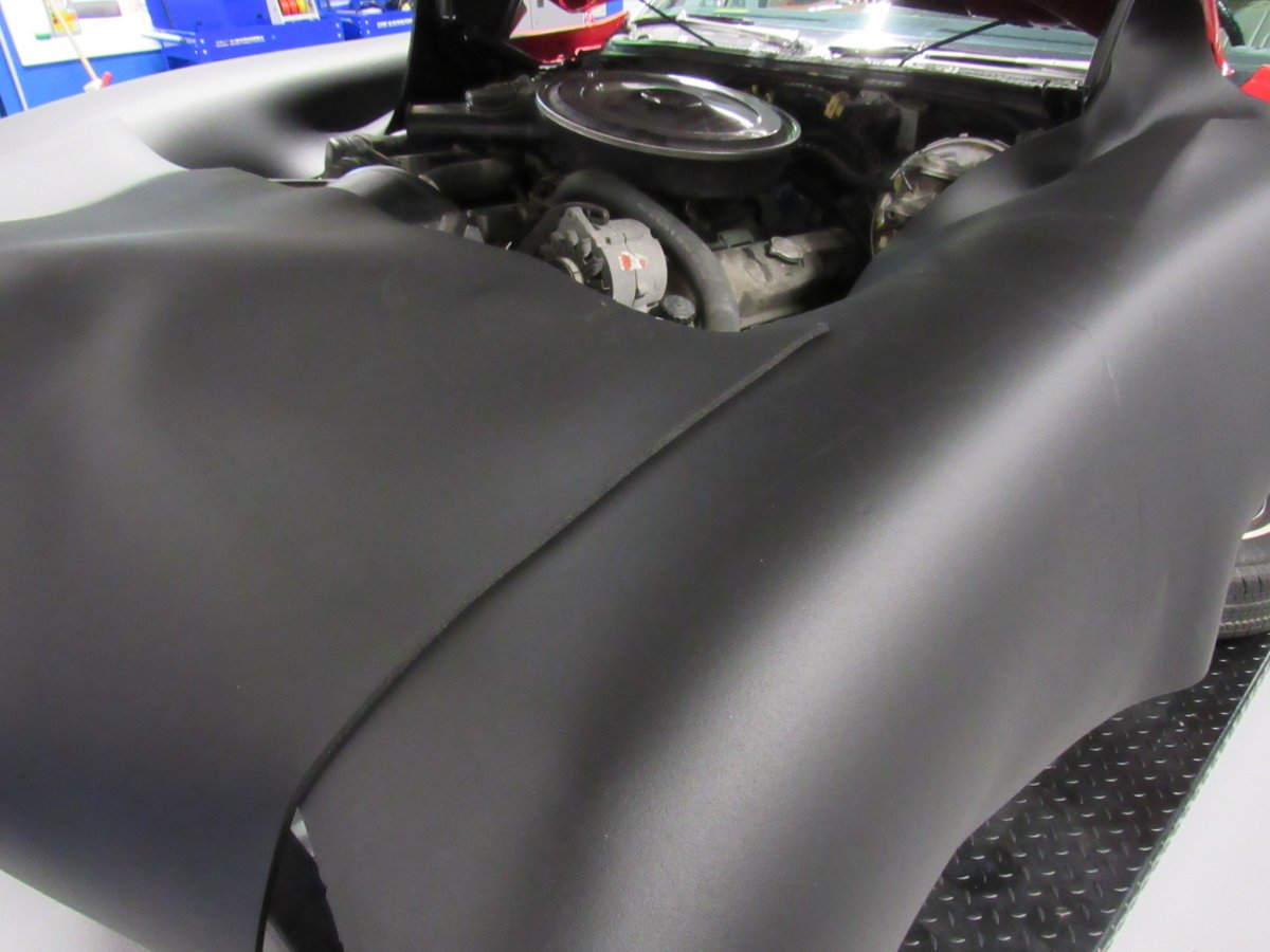

    I bought a roll of thick rubber padding to make fender covers. this stuff is a quarter inch and is almost the same material as my scuba suit. very durable. roll cost $120 and I cut it into 30" strips. IMG_9828.JPG IMG_9829.JPG IMG_9830.JPG IMG_9831.JPG IMG_9832.JPG way cheaper than touching up paint.

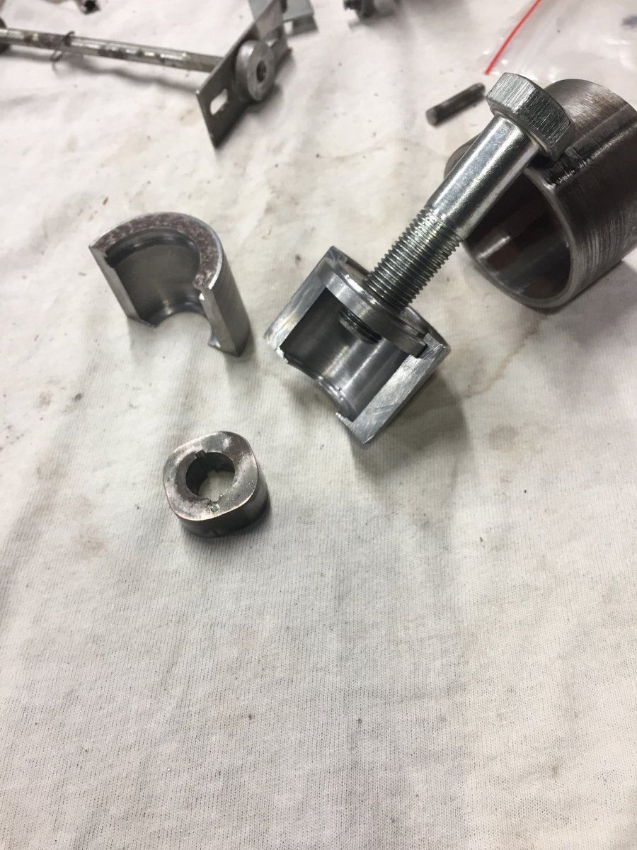

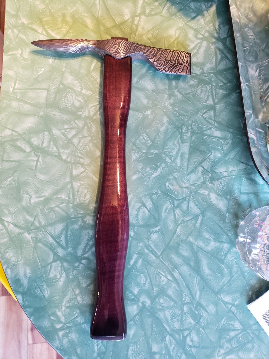

  12. Made this puller up to remove a distributor rotor. Seemed like an overkill until I turned the rotor over and found the damage done by levering it off in the past.
    8C717449-FF2E-4A08-A2DC-E86200C81306.jpeg 0D950FC4-59A8-4442-90AE-BAA06967EBFB.jpeg F9937BCD-44AD-448B-A806-08548B3B9A49.jpeg

  16. tb33anda3rd
    Joined: Oct 8, 2010
    Posts: 17,587
    tb33anda3rd
    I got it from our upholstery shop. I will ask him tomorrow.
  17. tb33anda3rd
    Joined: Oct 8, 2010
    Posts: 17,587
    tb33anda3rd
    I was able to reach him, he said it is called Presto-cell or something like that.
