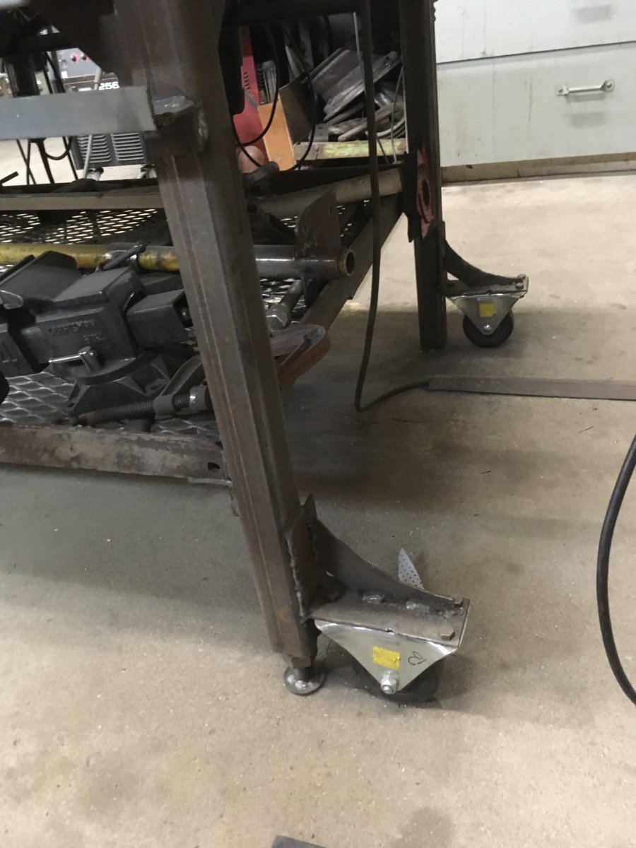

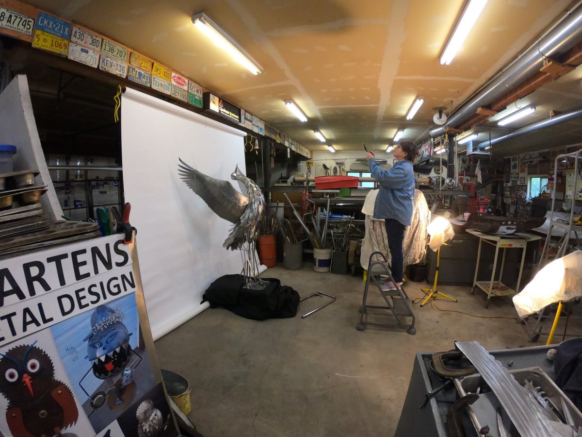

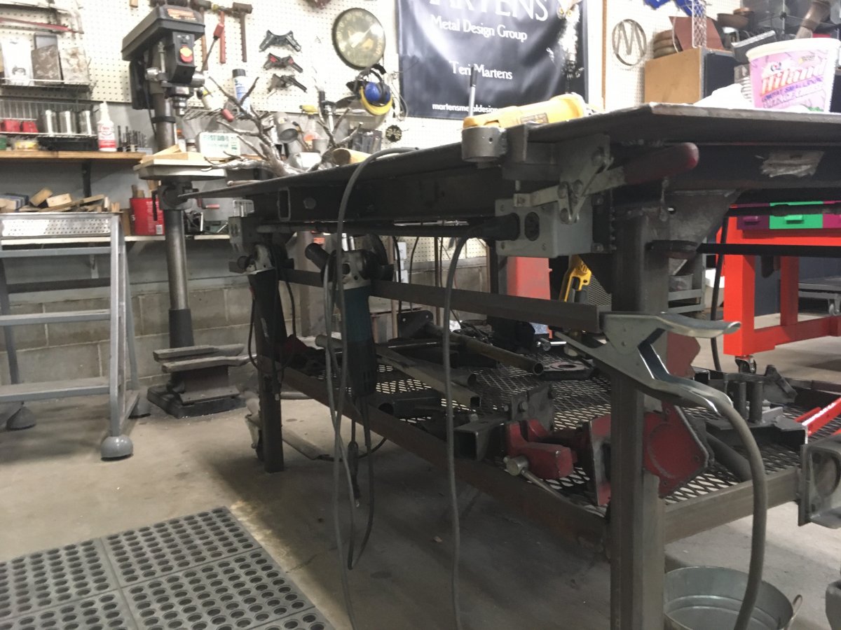

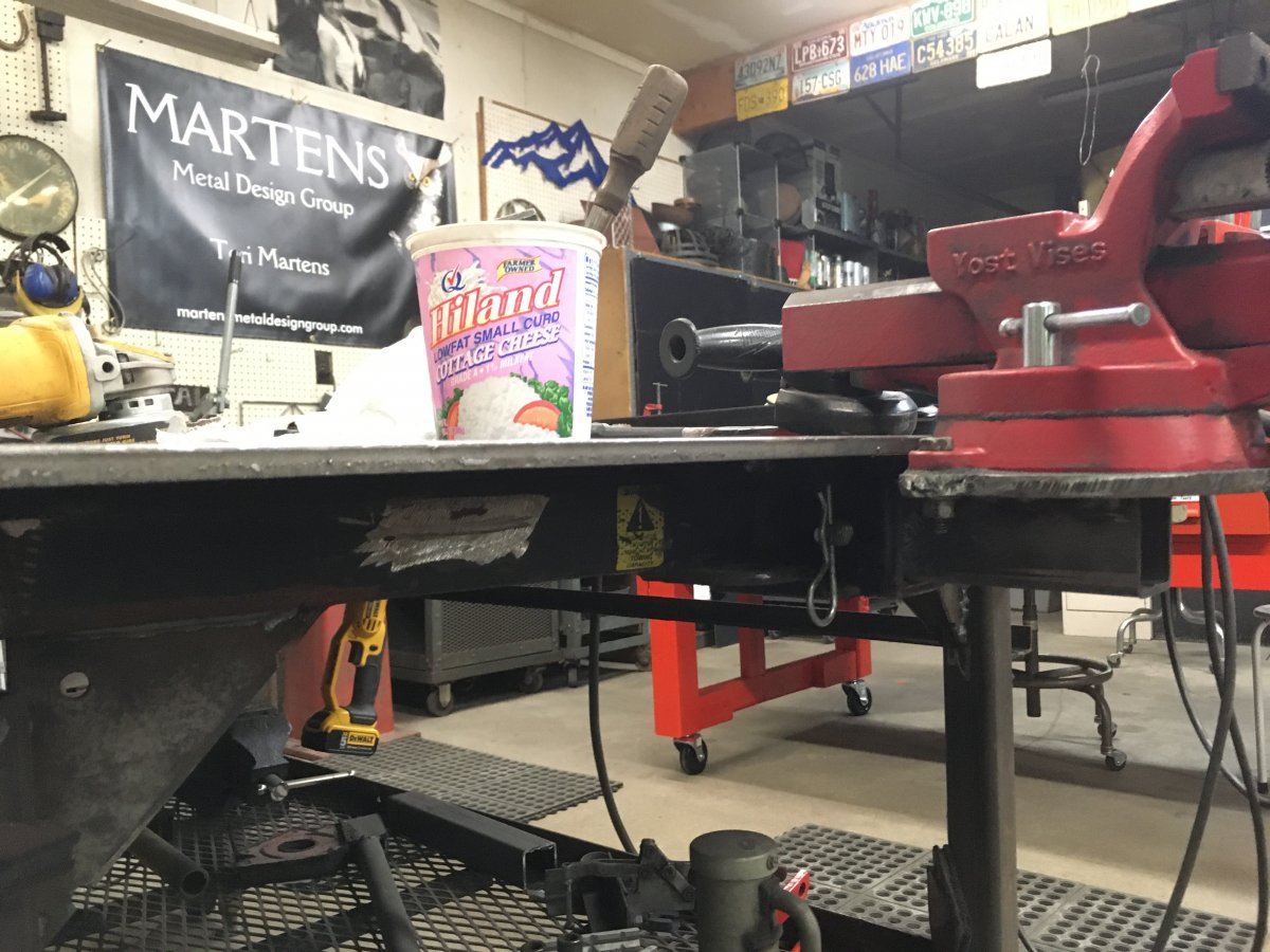

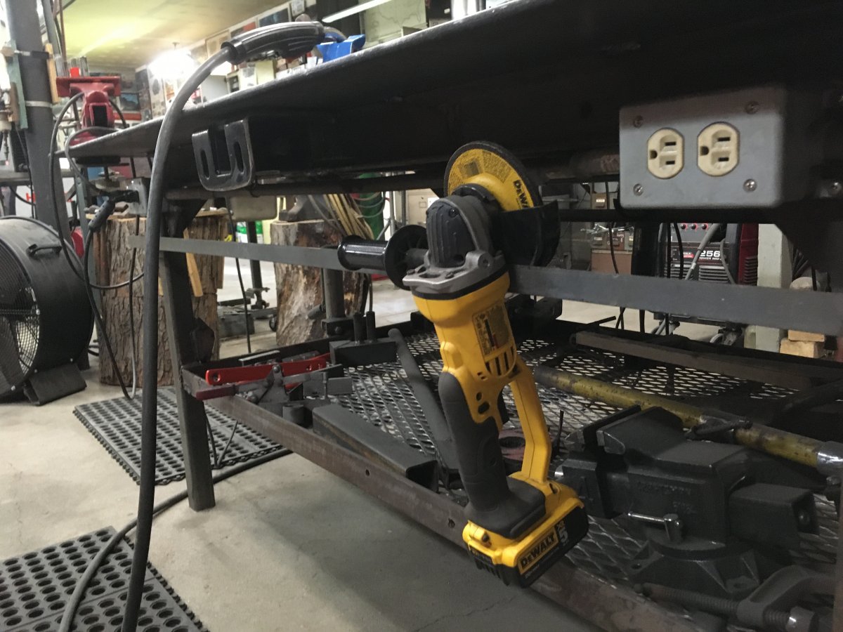

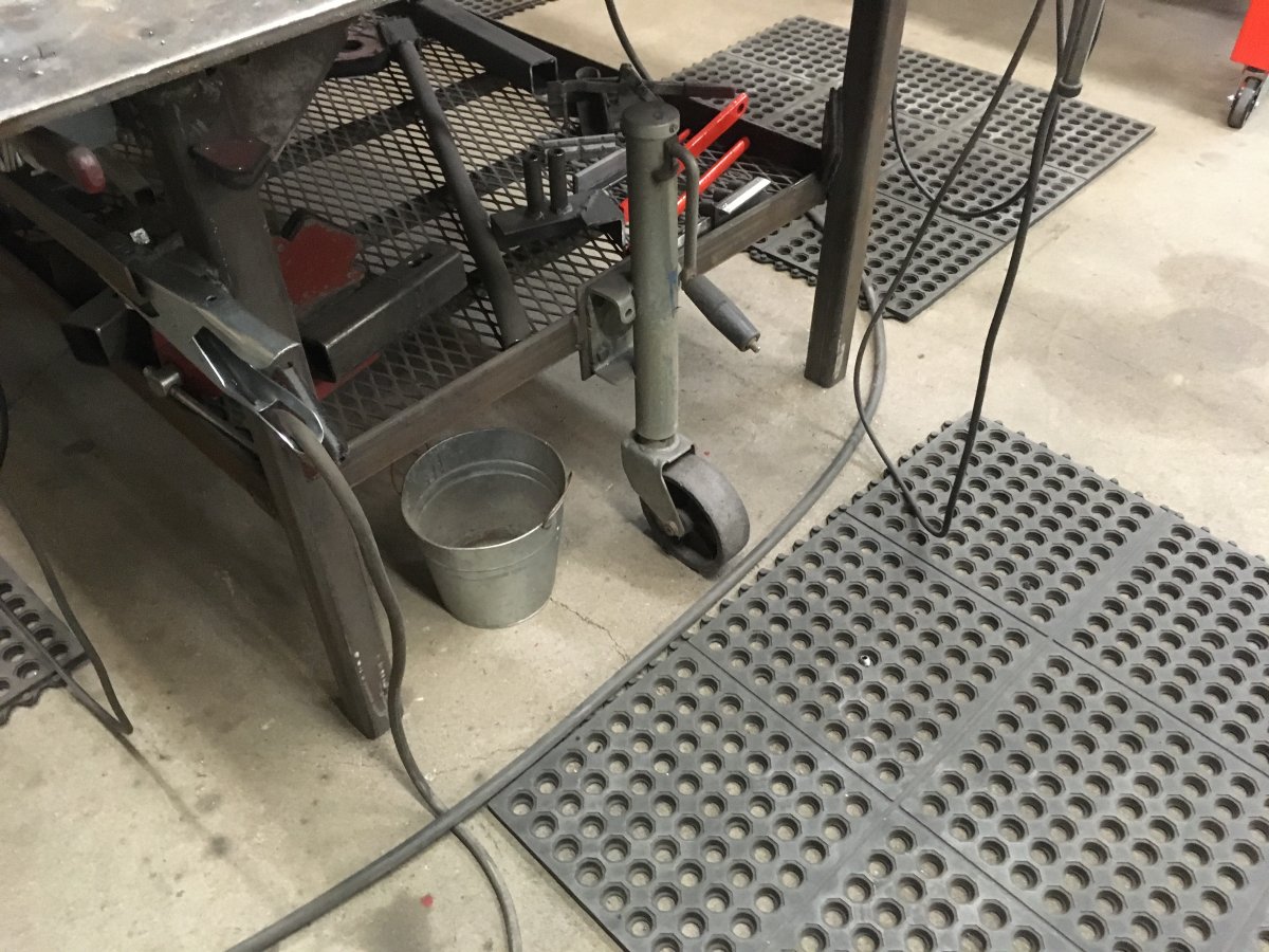

    My wife does metal sculpture and as her projects got larger she really needed a decent sized welding table...and she wanted it moveable. I had enough iron laying around to do the frame, had the steel supplier take a 4x8 sheet of 3/8ths steel and lob off two feet to make a 4x6 top. Thicker might have been better (I was worried about getting it out of the truck and onto the frame) but there are two big anvils and a two inch thick reject die plate to use for "real" hammering. I added outlets at each corner as well as a piece of angle to on the six foot sides to hang grinders from. I "engineered" wheels on one end and a trailer jack on the other so I could move it around. She suggested a "shelf" under the table and also suggested that we use perforate steel for the shelf so the dirt sifted through. I also added two inch recievers on three sides to accept what ever tooling we might want to use. That includes a vise, ring roller and tubing bender (think Hosfeld) The only time that frame moved was when I rolled it up to the truck to unload the 4x6 sheet:) It worked great:)

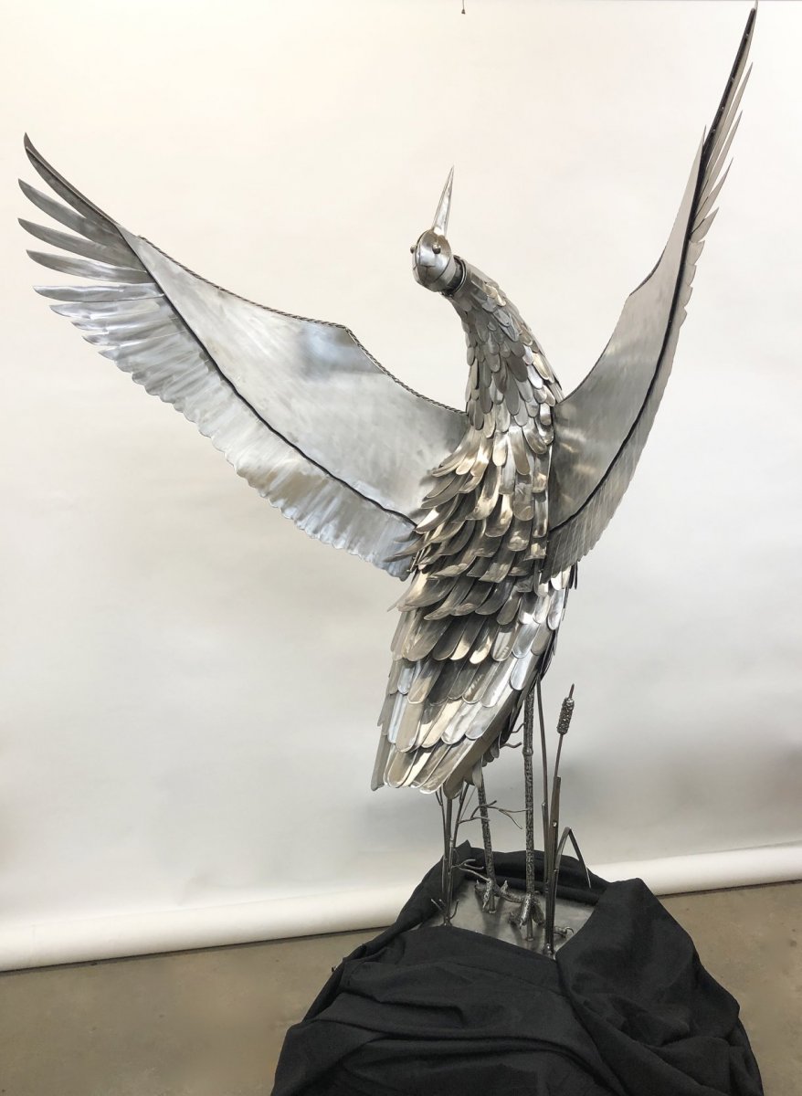

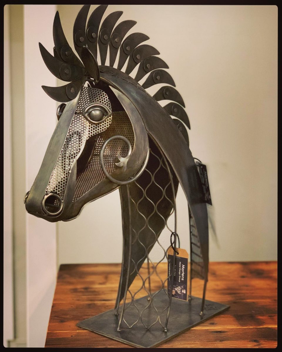

    @patsurf here are three pictures, I knew it happened and now you do too:) Horse.jpg Sand hills crane.jpg Teri shop.jpg

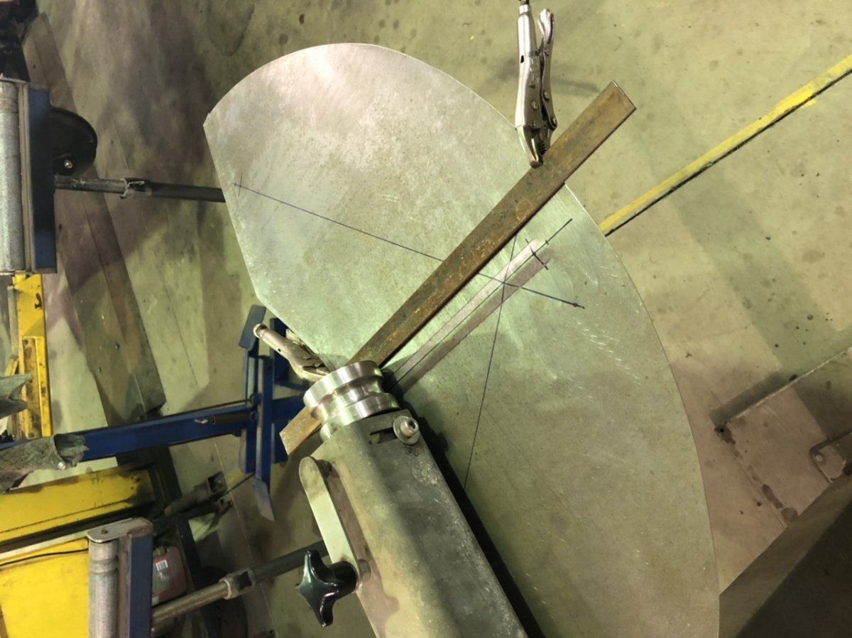

    2E2B9723-74C9-4391-95E8-B12B029BD405.jpeg This has to be the quickest, easiest and cheapest bead rolling fence/guide ever. 1”x1/8” flat held with vice grips. Just run the guide along the edge of the dies.

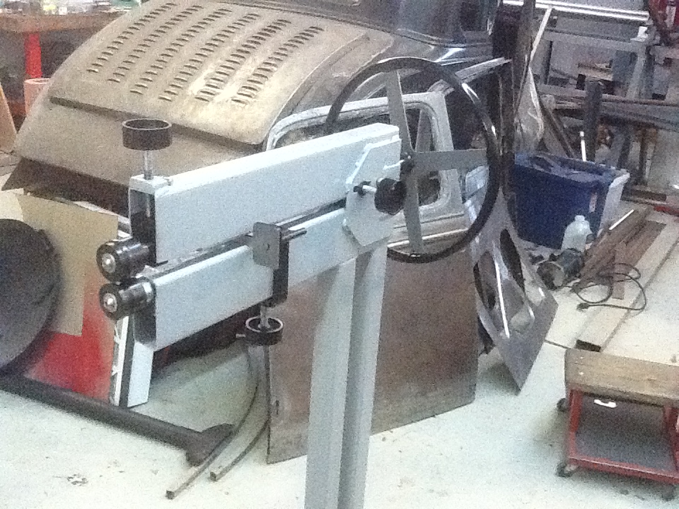

    Another bead roller upgrade....
    Started with this bead roller that I bought at the Fall Carlisle show several years ago; fortunately we had also bought a car to ship back to the UK at the same show, so this got put in the back for the journey home.
    Despite being made of quite thick plate steel, there was noticeable flex when using it.
    It really needed a stand too, so I fabbed this up from some s****.
    It was mildly irritating to need to lever up the top roller to release the work because the stock setup just pressed on the bearing block. I machined a block from a piece of Bronze to retain the head of a turned down caphead screw. The bearing block now gets lifted as well as pressed down.
    The moving bearing block just relied on the retaining bolt being left slightly loose, I found that the bolt often needed to be fiddled with whilst using the machine. Bushing down the M12 hole and fitting this machined from Bronze "top hat" bush which sets a few thou' clearance seems to have fixed that.
    As I seem to have worn out my welcome for handle turning from Sue, my partner, I decided to motorise the bead roller with a 24V reduction geared motor which came off a stairlift.
    The output shaft rotates at about 24 RPM, which is too fast IMO for a bead roller. I used two sets of timing gears from a 1950s BMC engine to slow down the rollers.
    The two pairs give 4:1 reduction with the jackshaft. I fitted a PWM (Pulse Width Modulation) speed controller as well. the actual operation of the rollers is by a foot switch which hangs on the frame when it's not in use.

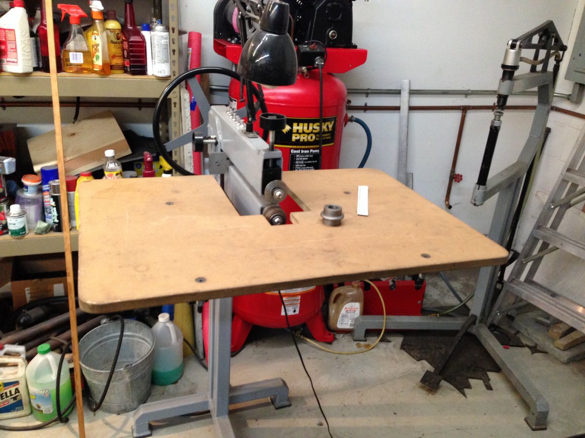

    I modified my HF bead roller into this

    Thank you. I have since added a table and an adjustable lamp.

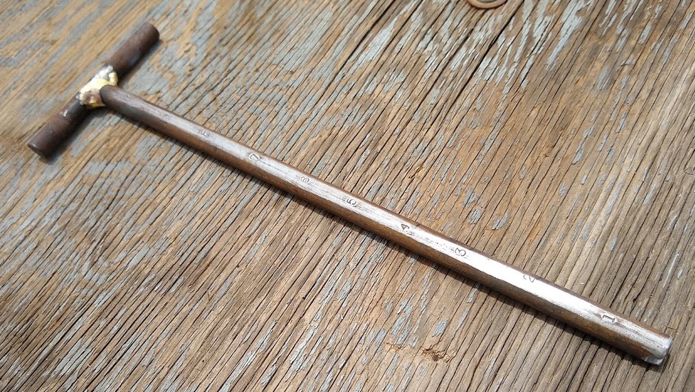

    I just made a gas gauge, for a T with a cowl tank. A special tool...and it has another purpose, if you check the bottom end and think about checking the oil level.

    Nicely done, Jim. Killed two jobs with one tool.

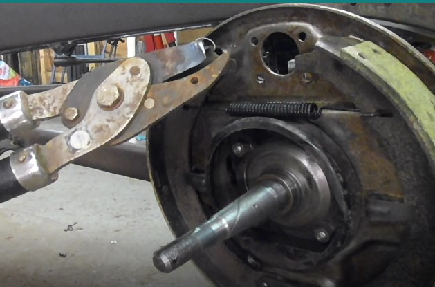

    I was struggling to pull a repro early Ford brake spring into place. I was told you can get special pliers for the job. I've never seen any before.
    I woke up the next morning with an idea.
    A discarded broken pair of loppers, 15 minutes and a piece of s**** metal strip and I had a perfectly serviceable heavy duty pair of brake spring pliers, specifically suitable for Early ford Brakes, with the pesky over strong repro springs.
    The handles had been shortened to about 18". They provide plenty of leverage with good positioning control of the spring end.
    I heated the sharp blade to soften it, bent it and put a notch into it.
    Here you can see the tool doing it's job.
    The metal strip gives the pliers somewhere to pull against.
    "It worked for me" as they say.
    Mart.
  20. loudbang
    Posts: 40,346
    That looks about like the ones made to do that look. My original has the end that goes on the shoe side has a point so it stays put on the shoes.

    the point was to fit into a rivet hole. when used on a bonded shoe they cut into the pad and have always drove me crazy making a mark in it. I like marts idea
