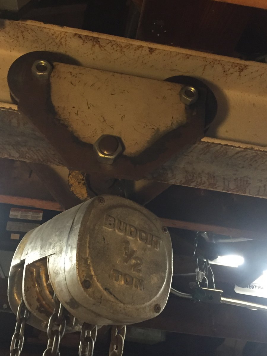

    Been preaching the benefits of building cranes in home shops for a long time. Always glad to see another example of someone who benefits from having one. I use mine constantly. Raised the bed off my daily driver pickup the other day and its just hanging there while I wait for the pump to arrive. Whole lot easier to move truck beds, bodies, and frames............

    You ain't lying - THAT's FOR SURE!!!!!! I would have to say that adding a beam in my garage was one of the very top things I've done to make working alone easier. I'm planning on adding a lighter duty one above the vertical mill for handling some of those heavier items.

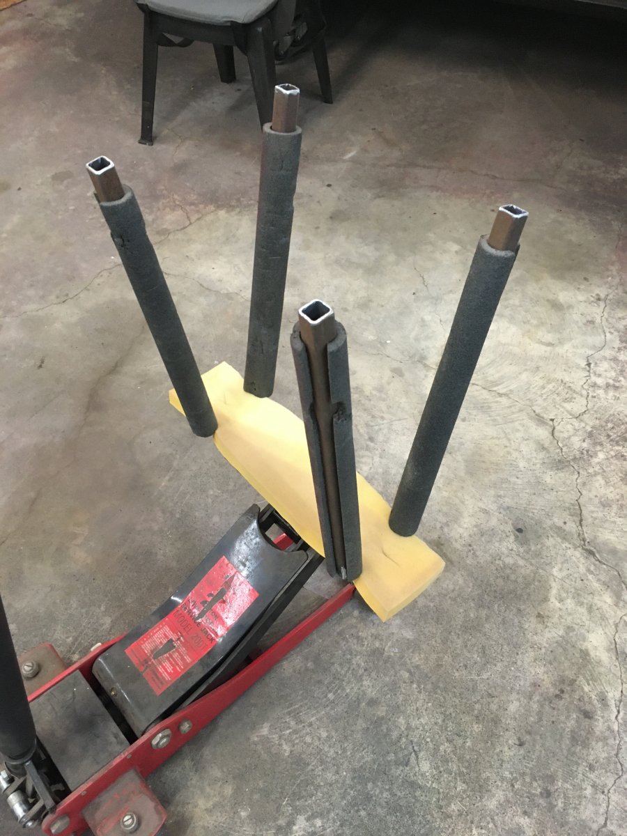

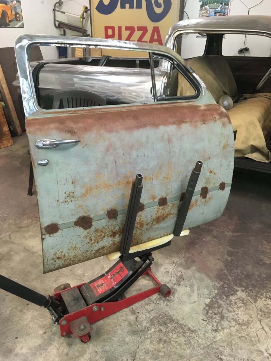

    I know these can be bought, but might as well use up some s****s laying around...tubing, unused u-bolts from a basketball backboard, pipe insulation, s**** foam, a little welding and I have a door cradle to remove and mount doors...works great.

    I like the trolley idea, but I'd sure like to see some threads sticking out through those nuts on the top. Scary!

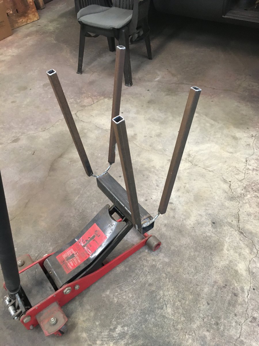

  10. HemiRambler
    Joined: Aug 26, 2005
    Posts: 4,207
    HemiRambler
    I was waiting for someone to notice that. :) The steel wheels are mounted with shoulder bolts that are threaded INTO the 1/2" plate. What you are seeing is the JAM NUT. Glad you're paying attention, but it's NOT as it appears.

    I used gravity to remove my doors and I was wondering how I was going to handle the installation. Now I know, thanks!

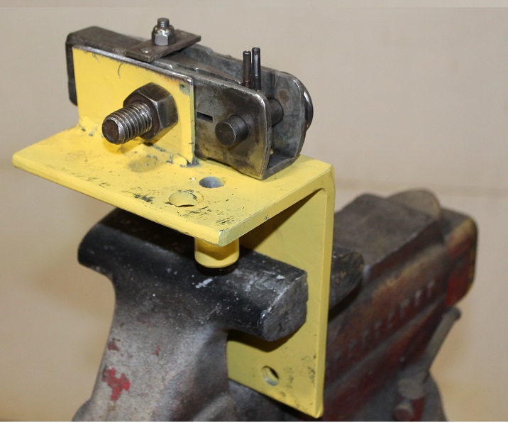

    I “suffered” with my manual tube bender for years before I finally converted it to hydraulic. I salvaged the cylinder, pump and directional valve off some purpose built getup I bought at the salvage place for 100 bucks! The adapters I made are WAY overkill but THAT was the s****s I had laying around at the time so I used it. The interesting thing about this project was when I finally got it going the pump was screaming past the blowoff valve at idle - after pulling my hair out I found out that I had the WRONG directional valve (it was closed center) so the genius before me had no clue what they were doing either! The funny part is AFTER I got the right directional valve it STILL screamed at idle. I eventually discovered that the sub plate was a MARKED wrong so basically that means I plumbed it wrong- yeah whoever made that sub plate was a real winner. Anyways it forced me to learn a lot about hydraulics which was a good thing. I also added a floor brake to lock it in place when not transporting it. It has made this such a pleasure to use I wonder why I didn’t do it sooner! B5080723-37A1-4A11-8DDC-C1E99E7B9E15.jpeg 80E3A8B5-F6A6-409C-BE5B-B5430BA1C8BB.jpeg 3220A2F8-7E13-40FE-B700-656CDB04FBDB.jpeg

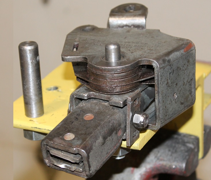

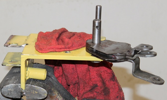

    I recently had the need to go through a Hurst Compe***ion Plus shifter. I checked the interweb thingy and discovered a nifty fixture for dis***embling and re***embling these shifters.
    Naturally I had to build a modified version, that’s what hot rodding is all about after all.
    This is the MK IIa since the design evolved somewhat during the rebuild process. Several of the holes got enlarged and some of the bracketry got ground down for better clearance. Not quite cut and try but close. I’m blaming the poor hole placement on my sharpie marker.
    The first station is for dis***embling the selector ***embly. It helps keep the parts secure and not wandering around the workbench. I had already removed the selector pins when the photo was taken and so I just set them on top for the picture. There is a hole in the bottom of the fixture for the pins to drop through as they are driven out.
    The next station is for ***embling the selector. Also shown are the custom tools I copied from the video.
    If you watch the video you see the reverse lockout spring getting compressed by hand. I made a receiver out of pipe for the end of the “key” to go into. This enabled me to compress the key and spring with a C clamp. After clamping I had both hands available to finesse the parts into place.
    After getting the selector sorted out it was time to stack the shims and shift arms onto the stacking pin. The pin is handy if you are like me and must try every possible combination of shims and arms before getting them correct.
    Then on to the last station in order to get the housing and the selector all together. I managed to repeat this process several times as well, kinda made it worth having the fixture.
    Now to find out if it all works. Putting the shifter onto the fixture with the reverse side up makes it possible to go through all the gears. This station is also good for testing the good deal shifter that you just dragged home.
    After this adventure I have a much better “handle” on how these shifters work. I think of having the fixture as insurance against having to rebuild another shifter.

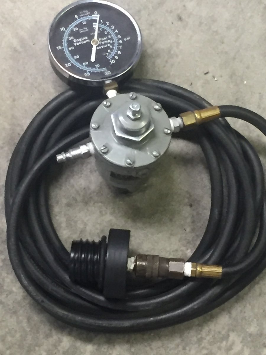

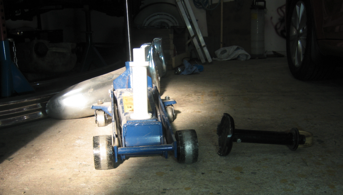

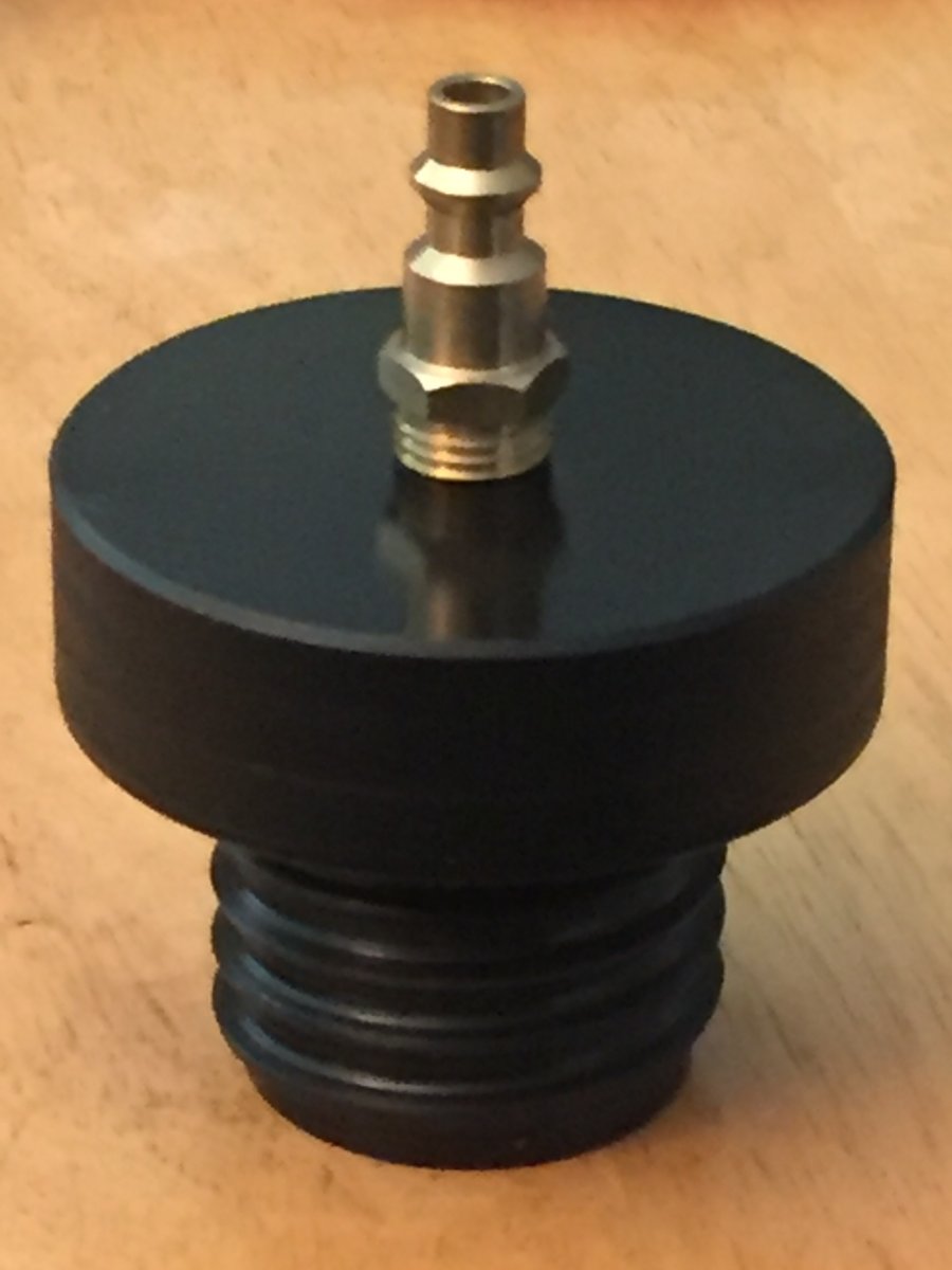

    ...Looking for an elusive FUEL system leak. Yes , it would have been easier to modify a stock gas cap...I didn’t have one. Yes, it would have been easier to buy one...I’m Too cheap for that. Have lathe - will travel (to my junk pile anyways). Now I need to find a low pressure regulator as I don’t want to blow my tank apart. 734F9213-1AA9-44A6-88F5-26DA6B09E98B.jpeg

    Have you considered a shop vac as a pressure source?
  20. seb fontana
    Joined: Sep 1, 2005
    Posts: 9,195
    seb fontana
    from ct
    Be carefull, 5lbs will start to deform the tank! How do I know?:eek:
    The 39 guy, loudbang, daren w and 2 others like this.
  21. HemiRambler
    Posts: 4,207
    HemiRambler
    I hadn't actually, I wonder what they put out?
  22. HemiRambler
    Posts: 4,207
    HemiRambler
    I had heard to keep it under 5 - I guess I'll have to keep it way less than 5!!!
  23. '51 Norm
    Joined: Dec 6, 2010
    Posts: 872
    '51 Norm
    from colorado
    I don't know for sure since I never measured it. I doubt that it is more than 5 pounds.
    Finding a pressure regulator that can control below 5 pounds might be a trick.
    I would look at one that is for a propane cylinder since I think that they put out something like one pound. The problem then is that they are not adjustable.

    You can limit the pressure roughly by just allowing some (a lot) to leak. More leak = less pressure. I did that when pressure testing a radiator. Just apply air but allow most to bleed off.

    If you scroll back to post 3812, you will see where I made a breathing air set up with low pressure. I found an inexpensive low pressure guage on Amazon and an adjustable pressure valve (0-100). The valve works well at the below 10 lb range and is quite controllable. Easy to put the Gage exactly where I want it......but I'm using a low pressure breathing air pump. You would need to reduce your pressure with it's large pressure control down near 10 lbs and then fine tune with the secondary valve.

  29. HemiRambler
    Posts: 4,207
    HemiRambler
    I dug thru my junk pile and found this regulator. Hooked it up to some long hose for few reasons. First I could test the regulator with at least some volume to see how easy/difficult it’d be to adjust. Also I wanted to make sure it was adjusted WAY LOW before hooking it up. Also I wanted the regulator down with me under the vehicle so I could tweak it even disconnect the air if anything started to look goofy. I borrowed a gage off an old fuel pump tester because it goes so low
