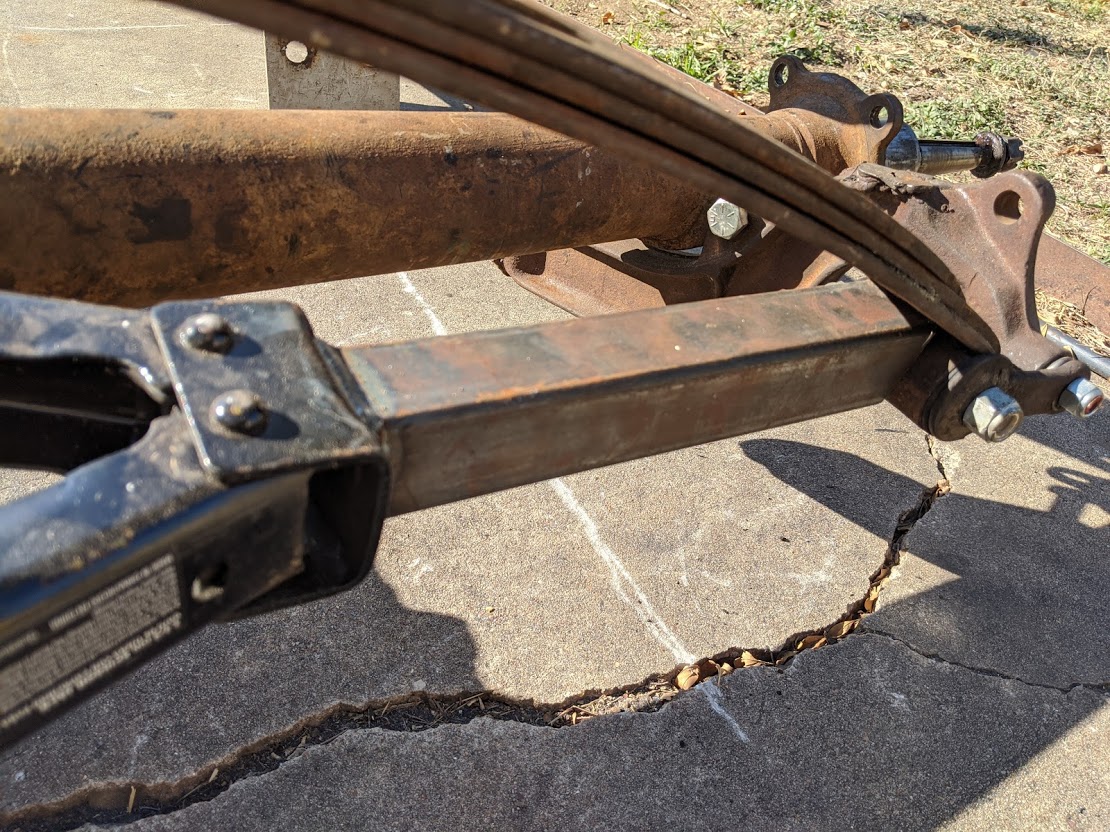

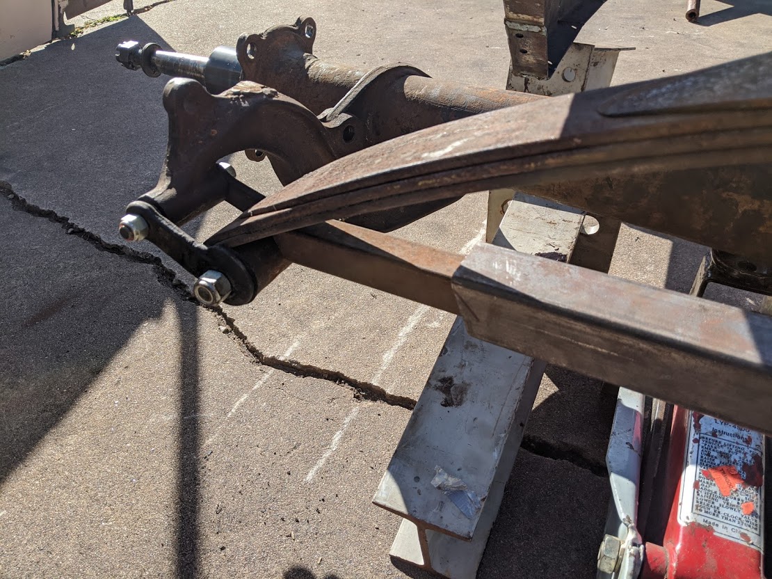

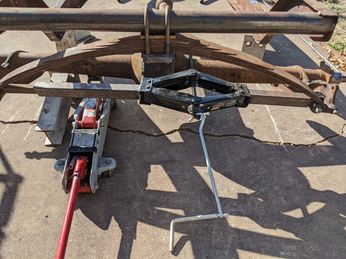

    Maybe in the the 131 pages this has been done before, but I had a few of these stamped steel screw jacks from another project and just welded some s**** tube on for a simple and cheap, but very effective, spring spreader. Just used it today, thus the pics and the post.
    3dnsouth, whtbaron, bct and 30 others like this.
  15. Jokester
    Joined: Jan 29, 2005
    Posts: 796
    Jokester
    Don[t jack it too far, it'll crack your sidewalk!
    .bjb
    32SEDAN, 61Cruiser, loudbang and 3 others like this.
  16. Those stamped steel screw jacks come in handy!

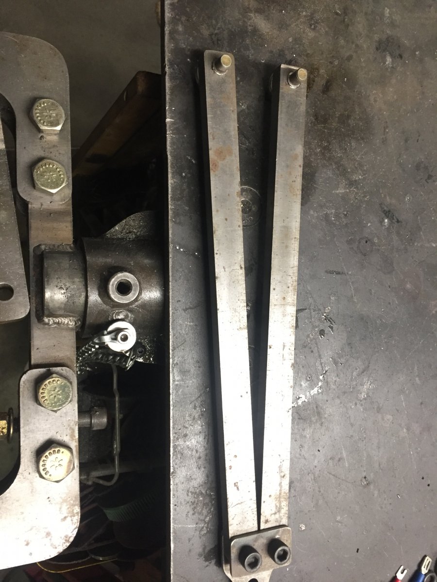

    Another super easy tool to make. Needed an adjustable spanner wench for working on rear end bearing adjusters. The “pins” are just bolts with the threads machined off (this way they are not only replaceable if you damage one, but you can also have different ones made up if you need another size pin). A drill press and a grinder is all you really need to make one of these - or - get lucky at a swap meet and find a "real" one! 8042E149-6819-4442-B98D-442A5410EA10.jpeg

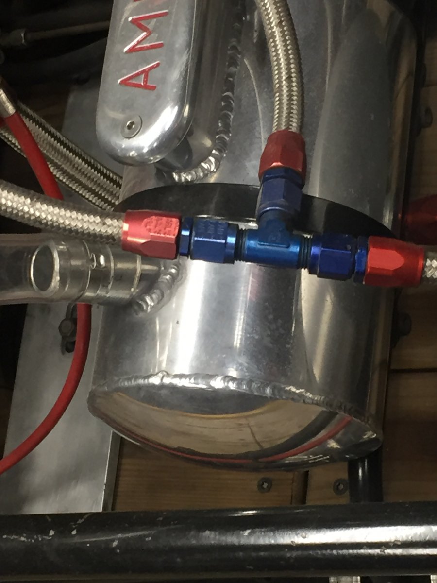

    BA3387F3-CE3D-45E7-892E-30DC65DB926E.jpeg Here's a SUPER EASY way to form DOMED end caps for various projects - in this case it was a larger sized dome for a PUKE tank for my dragster. The "tool" I made to do this was nothing more than a PVC domed cap from the hardware store - I put some cement in it just to have a flat surface to press against - not sure if that was really necessary or not. In the video you can hear a "pinging" or "cracking" noise - I later discovered that was nothing more than paint chipping off from the s**** metal I was forming.
  19. loudbang
    Posts: 40,346
    Ingenious solution. :)

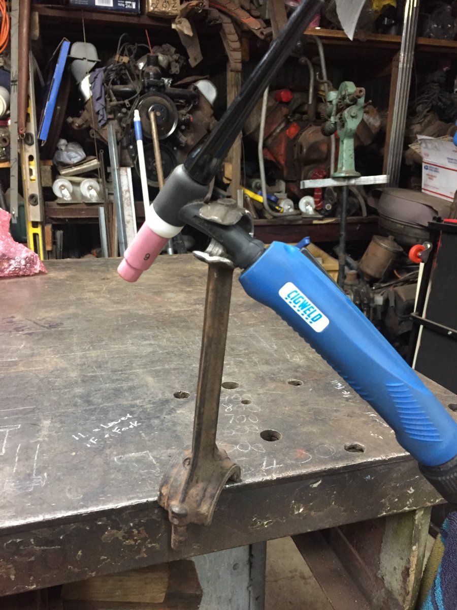

  20. A models just keep on giving, I needed a holder for the tig hand peice and the early rods aren’t much favoured so with 5 minutes of mods,, cheers Henry. 7CA6A878-0D2B-4A87-96F2-C53CBDFFEF69.jpeg

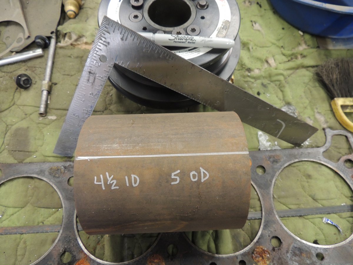

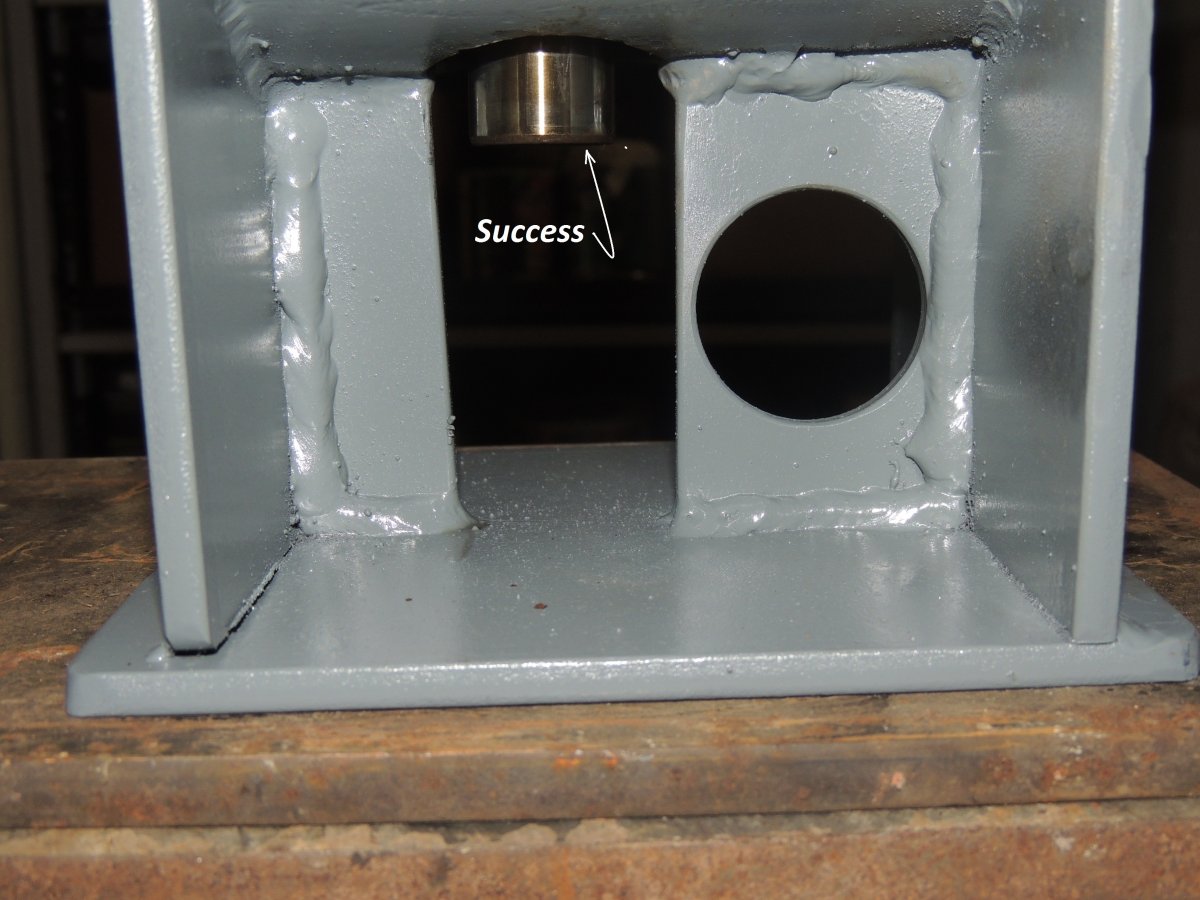

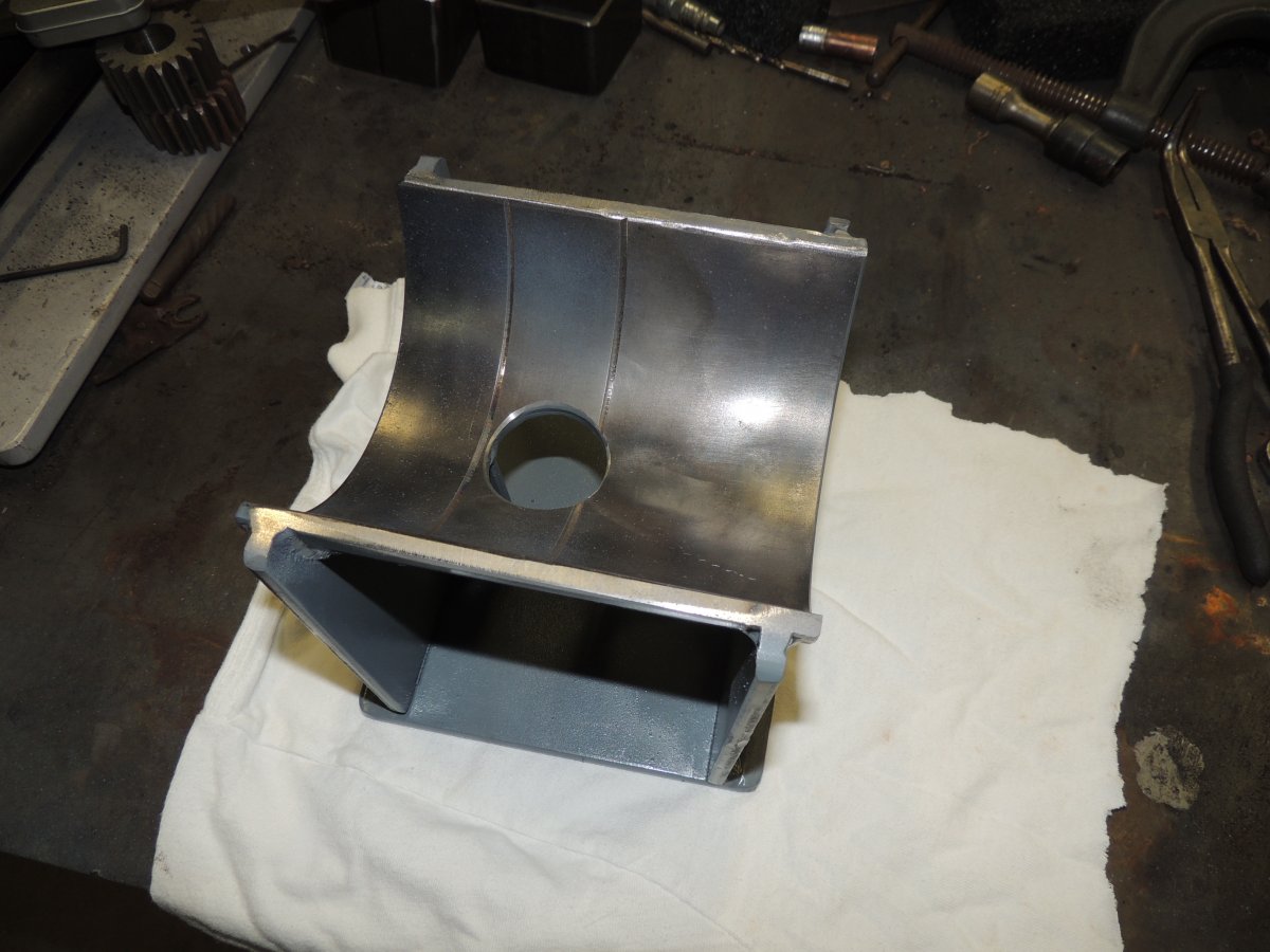

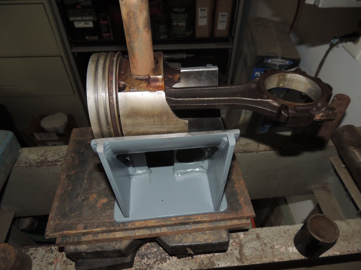

    Piston Pin Remover
    Ok............I used one of the silver SHARPIES to start this project. You can see that it helps by making a nice easy to see cutting line............Nuff said about that!
    I used a piece of pipe and cut it in half. Hole sawed a hole in it and a couple of reference lines on the lathe to help with placing the pin in relation to the hole. Then a couple of legs to support it and a base plate. Pretty simple to make. Got the other half of the pipe left if anyone wants it........:p
    Budget36, brEad, Okie Pete and 20 others like this.

    Ekimneirbo, you make the koolest stuff! I don’t have the patience to do that kind of work any more! I guess I just getting grumpy in my old age! :(

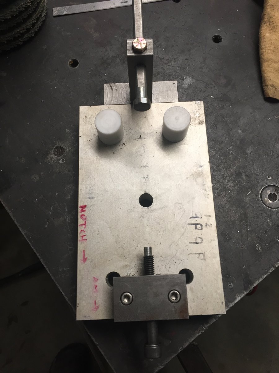

    Well since Ekimneirbo mentioned Sharpies AND Piston Pin Removal tools :) I can’t help but show my Piston Pin Installation Tool (please note I use a sharpie to remind myself which way the piston notch goes when you’re installing the piston). I see the bumper for securing the piston has fallen off- I guess I’ll have to improve that next time I use this. The rod on the top of the photo is the pin stop -you adjust that so the pin doesn’t go too far in. (BTW that rod is nothing more than a 3/8" bolt with the head turned round and a flat milled on...aka stuff from the junk pile). The screw on the bottom secures the piston to the fixture (I'm thinking I should add an o-ring groove and let the o-ring retain the nub from falling off again.
    No you absolutely do NOT need one of these to install press fit piston pins, but it’s a lot easier if you do and you can make them extremely repeatable. You only got a second or two so it's best to be methodical and this helps IMHO.
    P.S. I see Ekimneirbo has added paint to his while mine starts to rust. I may have to step up my game. C5EDC52D-AEDE-458E-961E-16AFF48C7FC0.jpeg

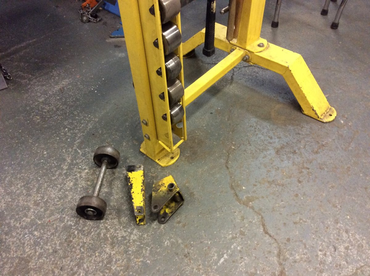

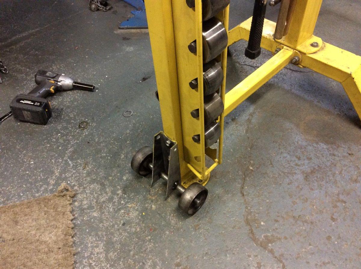

    E8C70EE5-7286-4786-94A0-5B3E3604B0EC.jpeg 52098312-5A1A-4CBA-BDE5-2BF4CEB1915F.jpeg Got a small shop and have keep equipment stored to the side , etc. Got tired of dragging this English wheel around so dug out the remains of an old floor jack and put them on the back of the English wheel . Now lift the front slightly and I can easily roll it around . And that’s why we don’t throw junk out .....
