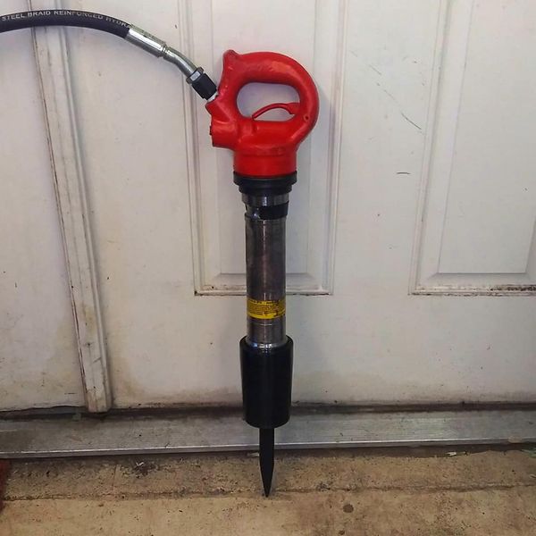

  2. “Air powered sledge hammer” you want??
    Hell dog rivet buster.
    Really Knocks the **** out stuff and not hard to handle. Different bits available too. Need lots of air..but you’re going to get thru it or out of your way.

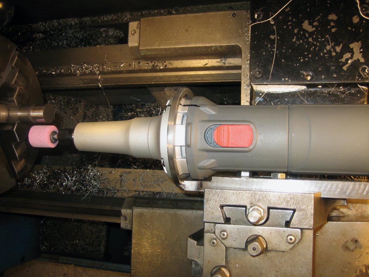

  21. j hansen
    Joined: Dec 22, 2012
    Posts: 11,738
    j hansen
    I liked the Toolpost Grinder idea that @ekimneirbo had,so I made my own. Thanks for that. IMG_9511.jpeg IMG_9510.jpeg

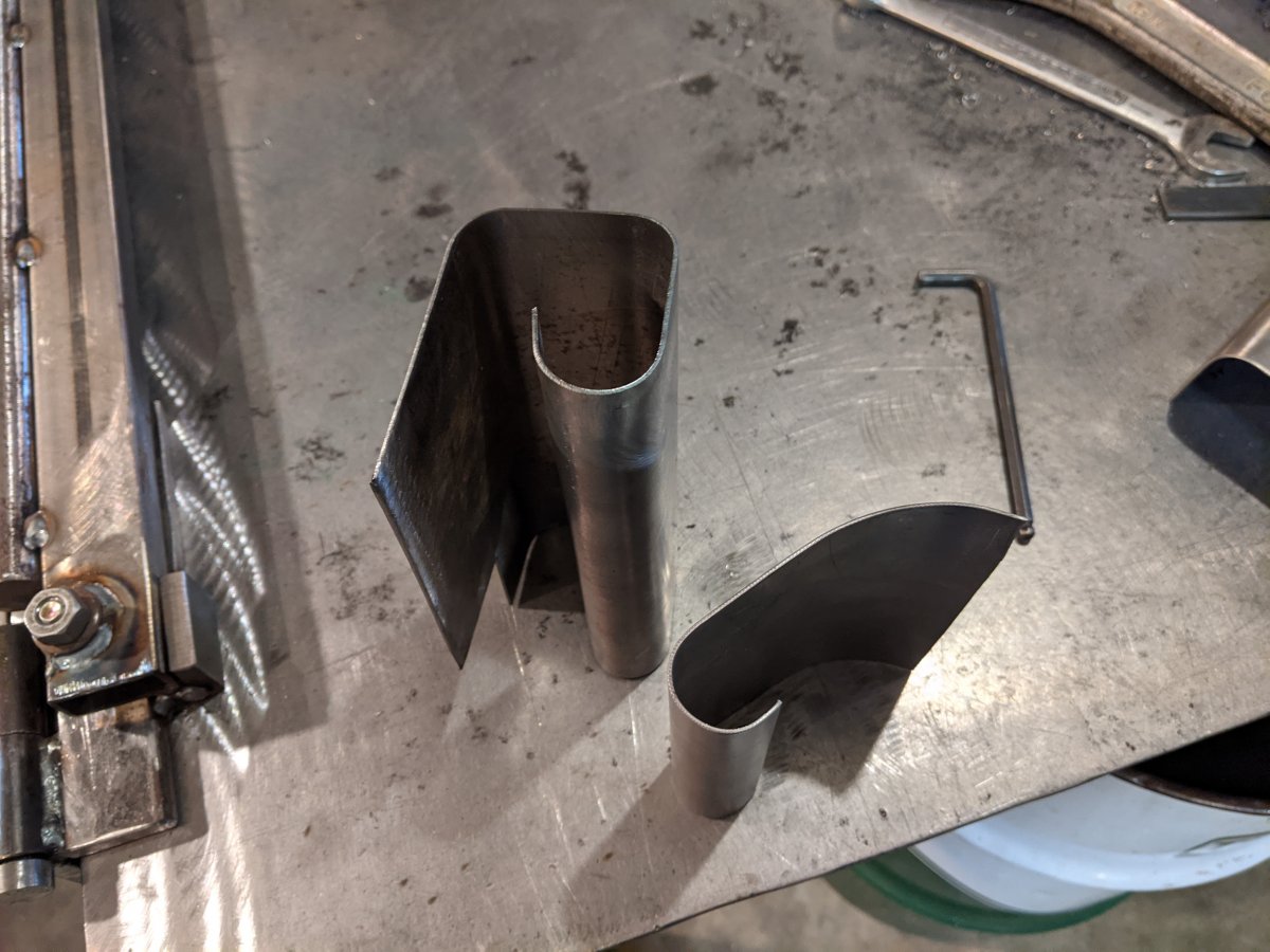

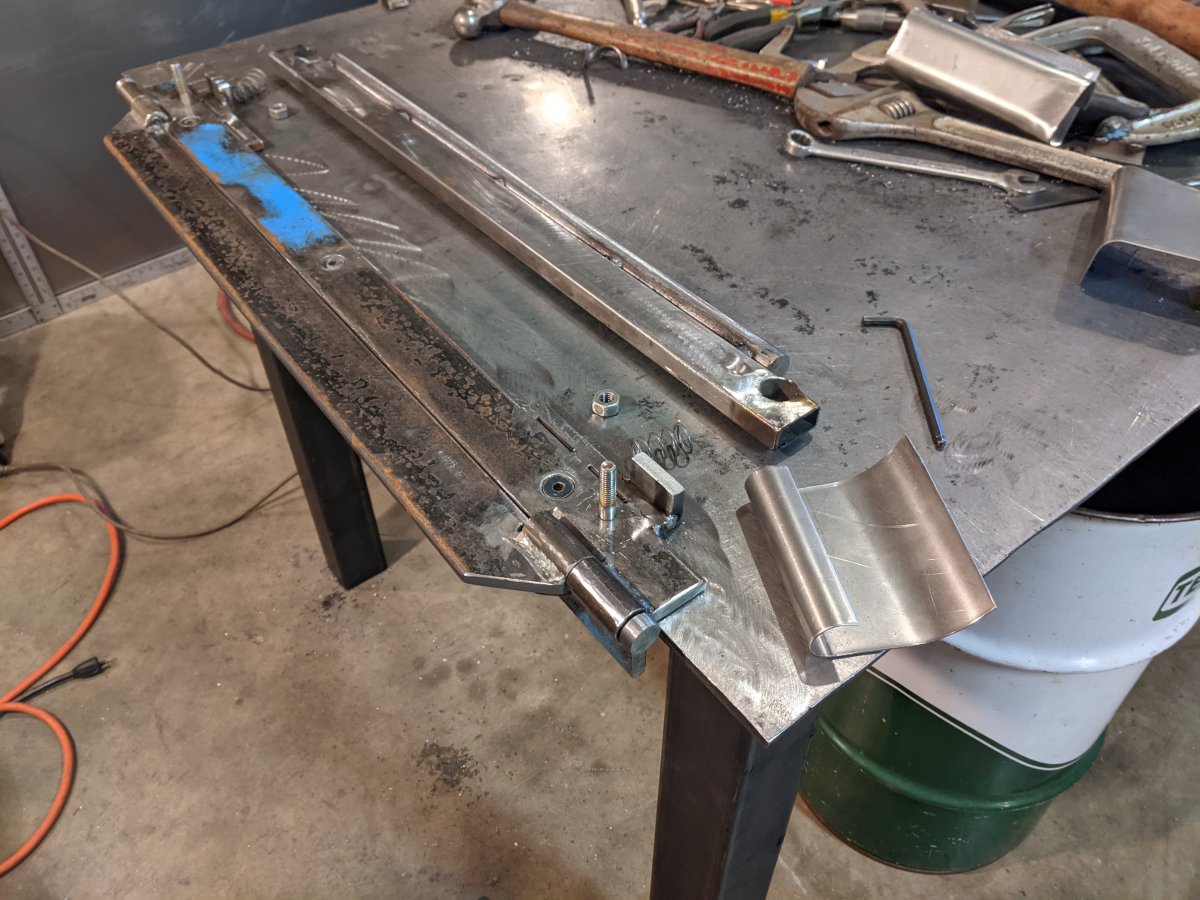

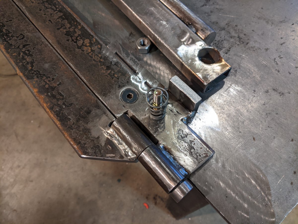

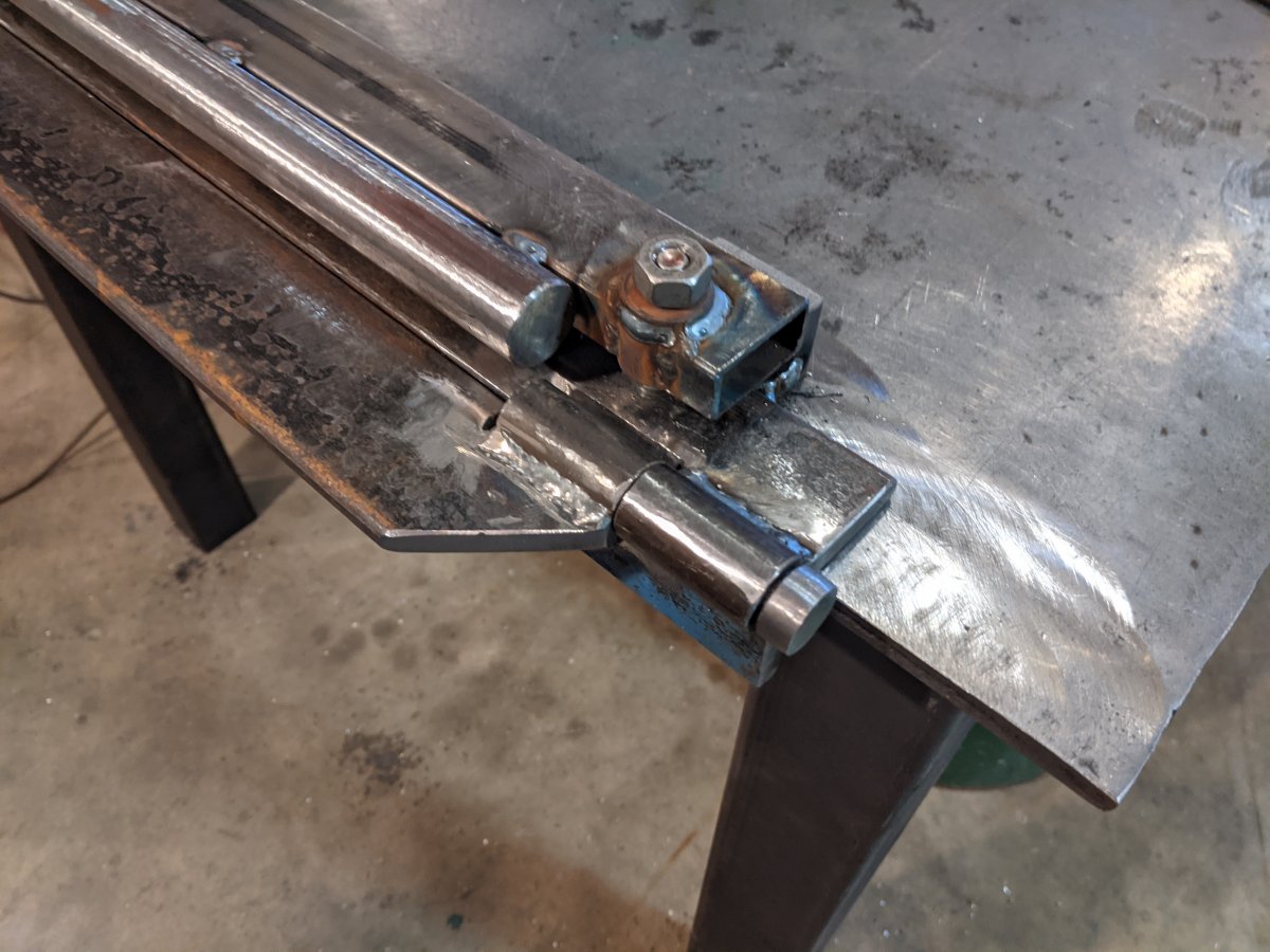

    Made this bender to bolt to my welding table yesterday.
    It'll take a 2' wide piece of 18 gauge and put a nice clean 1/2" radius bend in it.
    Bend slip bend in increments and it'll bend any radius greater than 1/2"
    Bend to 90°, slip it out 1/2" bend again and it'll bend 180°
    Should work just fine for what I have in mind.
    PXL_20210208_232715005.jpg PXL_20210208_232743077.jpg PXL_20210208_232818304.jpg PXL_20210208_232452637.jpg PXL_20210208_233002904.jpg
