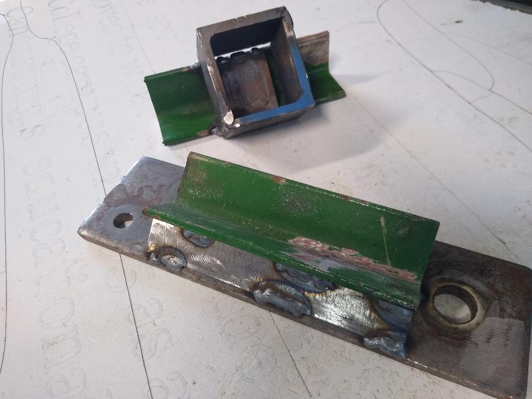

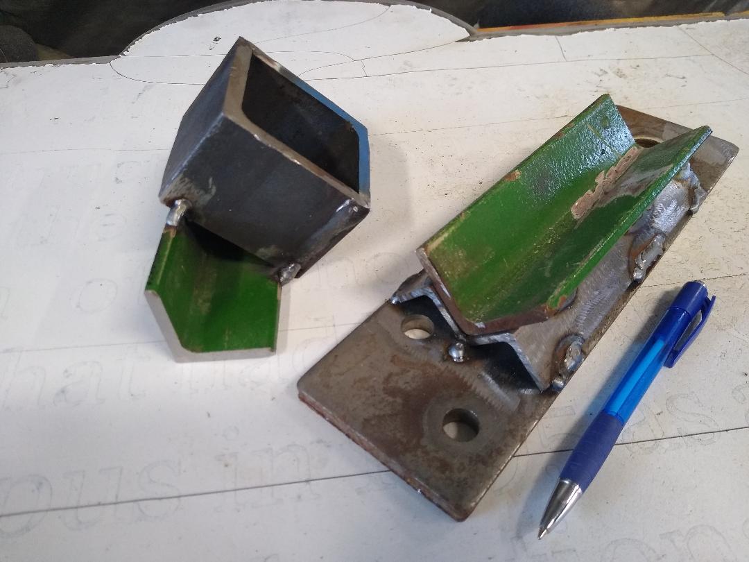

    Was over at a friends the other day...he was jacking up the front of his roadster when it slipped off the jack, which in turn, crushed the bottom of his grill shell and bent the **** outta the grill...when I got home made this simple jack alteration
    My jack has a removable pad, so I took a short piece of 1.5" c-channel I had lying around and made it fit my jack....my beam axle (Superbell) sits nicely inside and will not allow the jack to slide out...takes about 30 secs to switch it from pad to channel and back....simple but works really well 23D69863-1996-4DF4-A0D2-D4703ABAB4E3.jpeg

    ^ Great idea! I'm going to make up a couple of these right now.

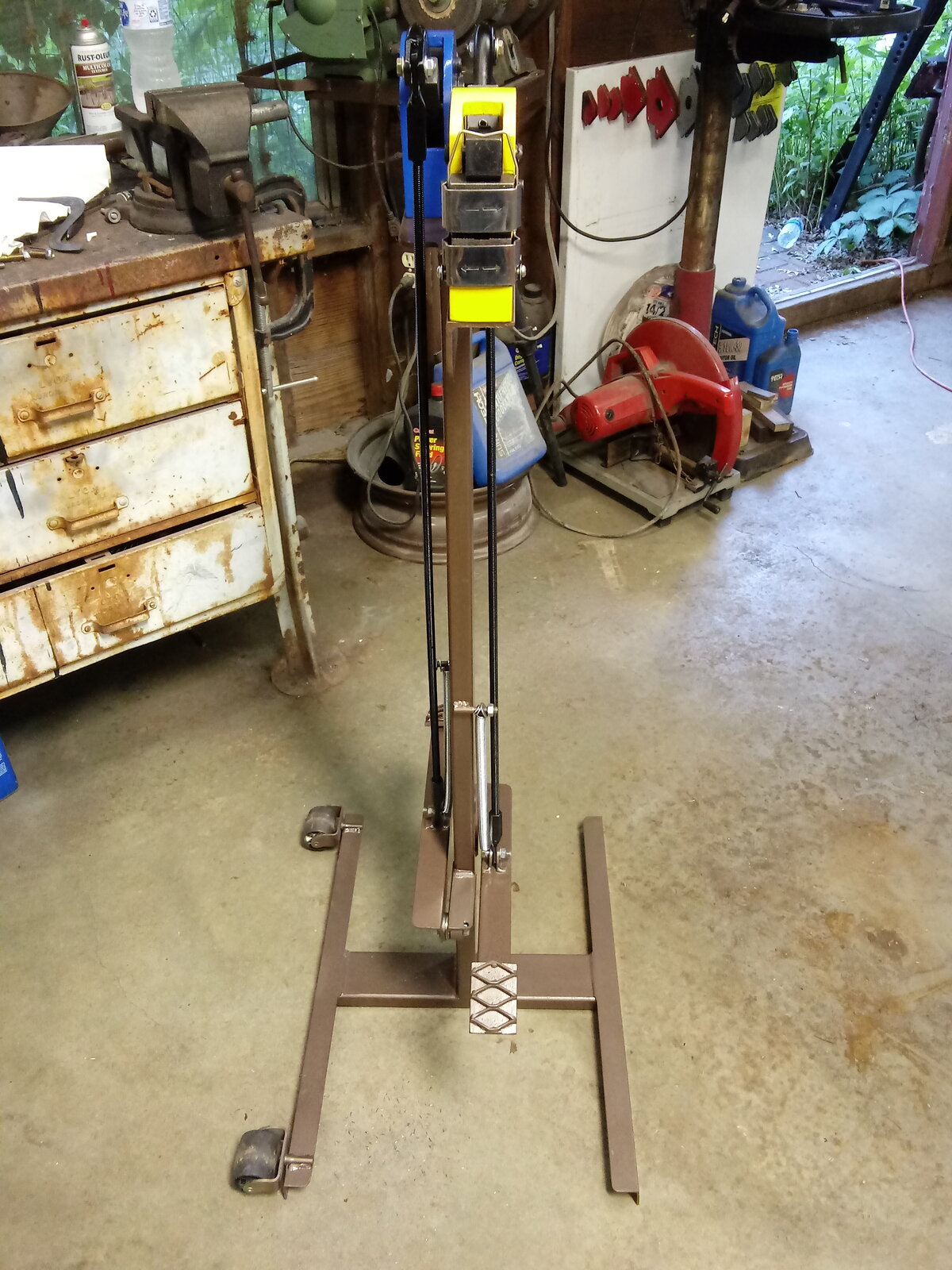

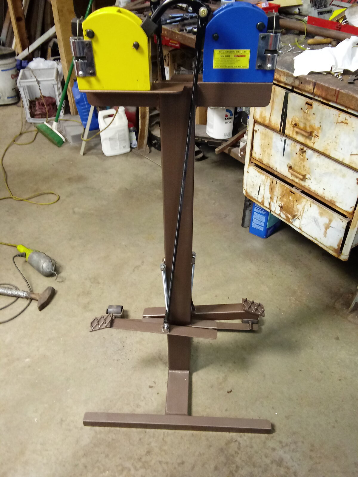

    Just finished the stand for my shrinker/stretcher.
    TigerFan, mkebaird, Stueeee and 8 others like this.

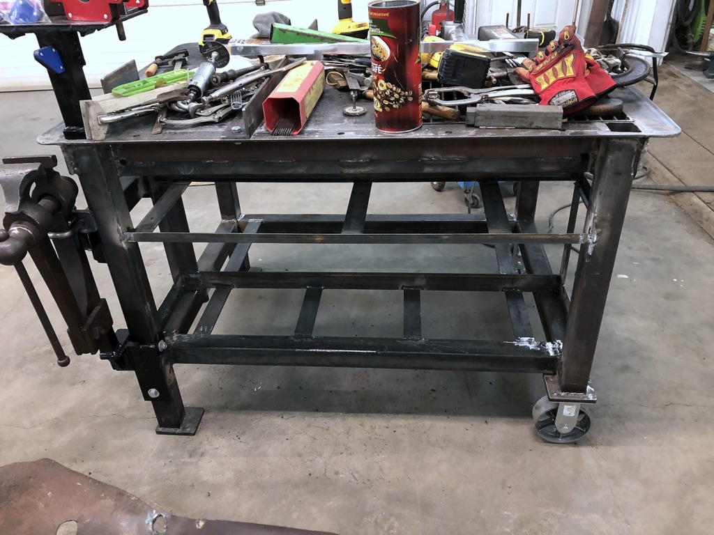

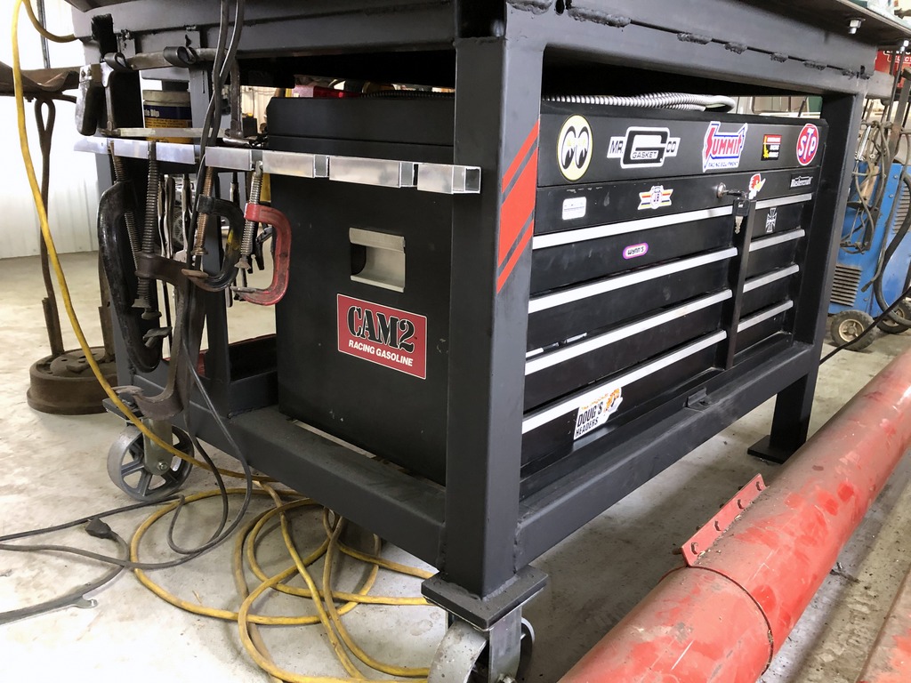

    I see I missed the welding table discussion a couple pages back. I made this table last winter starting with a 2" thick piece of odd shaped steel for the top. I was originally going to drill the top for attachments, but when I found out that was no fun, I made a 3" angle frame around it and drilled the holes there. Comes complete with the vice grip rack and mud dauber guard, even though we don't have mud daubers up here. Probably weighs in somewhere north of 700 lbs so I used heavy duty castors on one end and a floor jack tab for the other end. Stays put when I'm working. Has a heavy duty vice and a post vice and an extendable end. IMG_4571.JPG IMG_5133.JPG IMG_5159.JPG IMG_5167.JPG
    Jet96, brEad, enloe and 8 others like this.

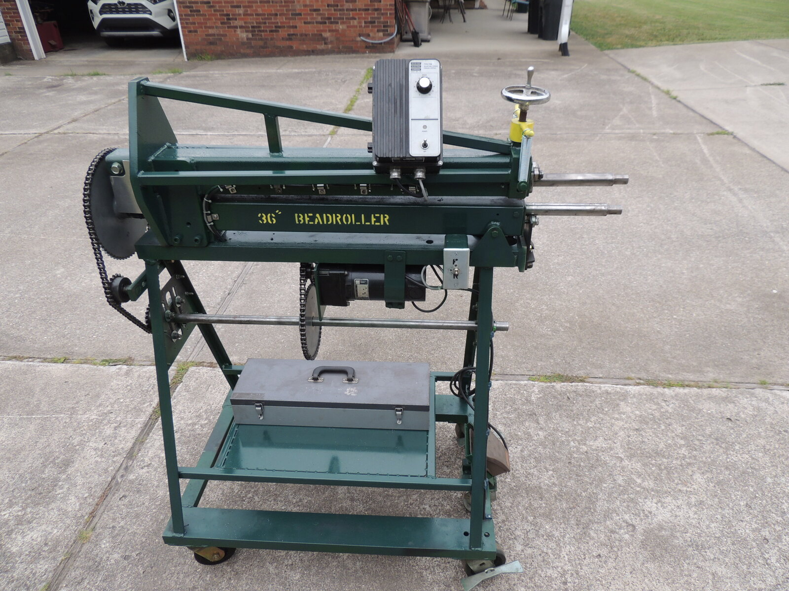

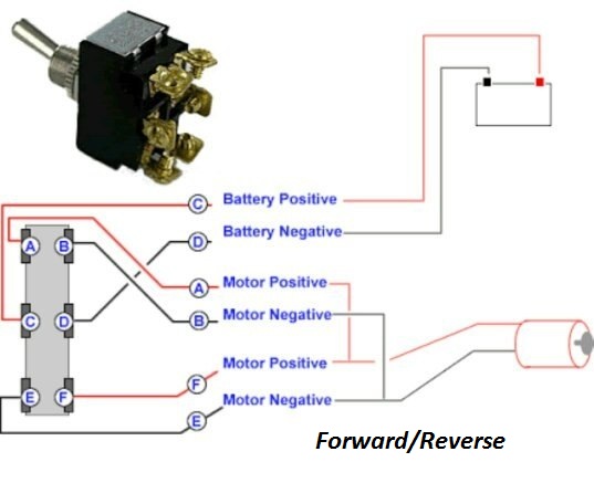

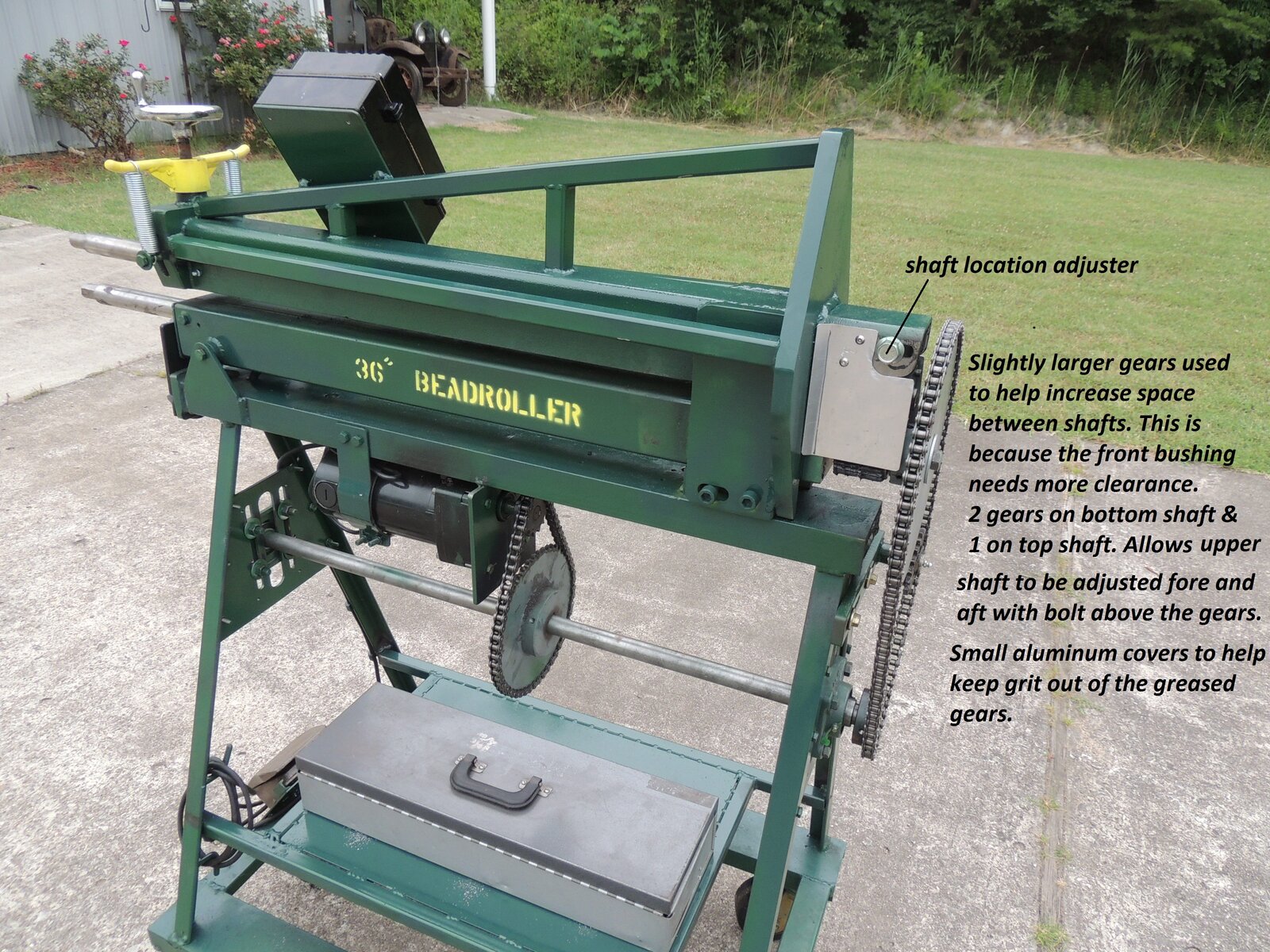

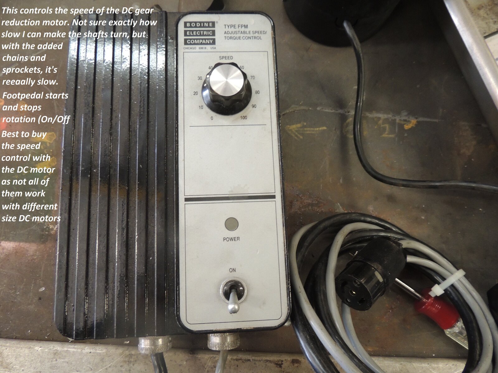

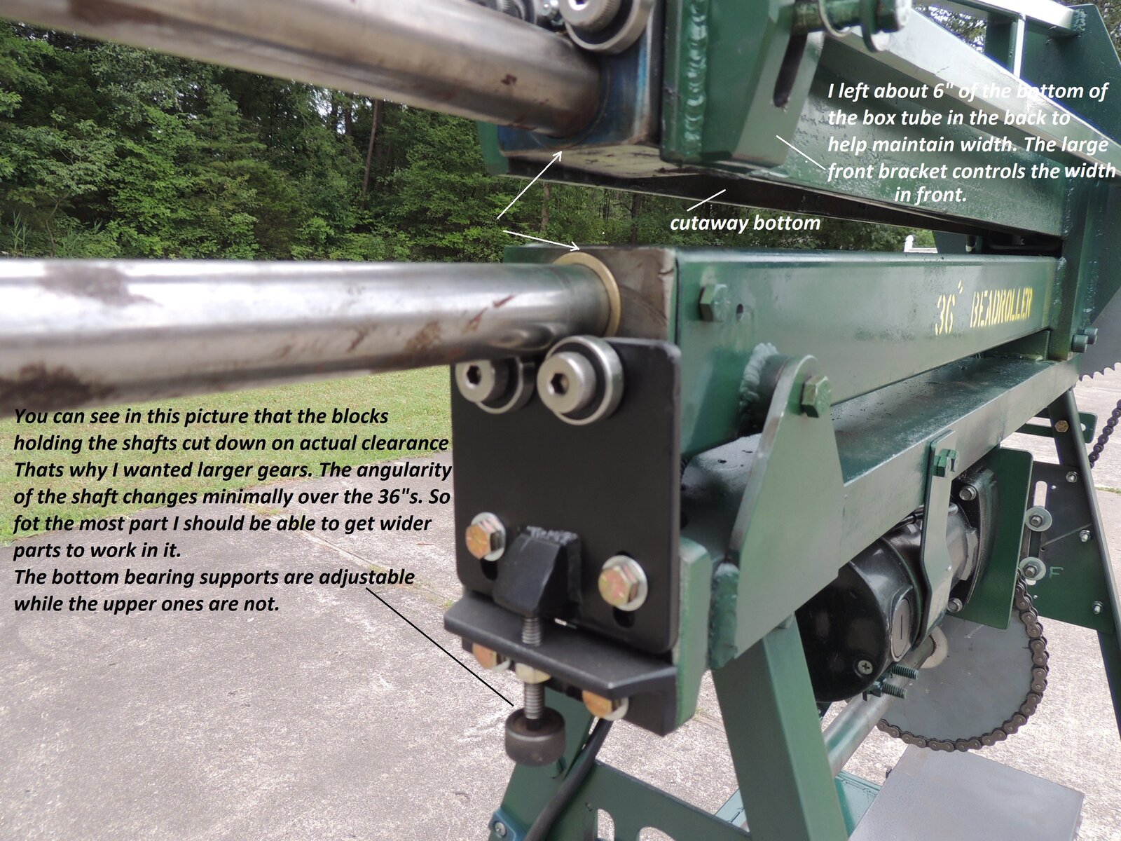

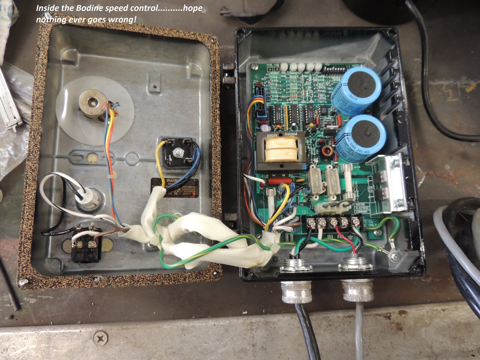

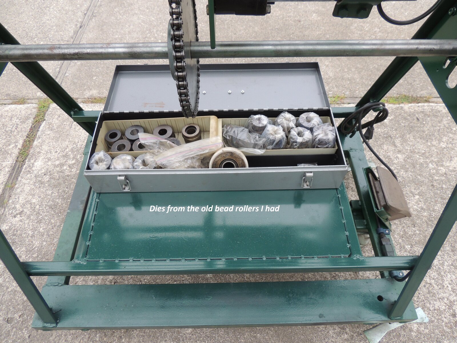

    Here is a Bead Roller I just finished. I wanted one with clearance for longer stuff and had most of the parts laying around from different other stuff. Some of it I had to buy new though. My recommendation to anyone wanting to build something similar is ........Don't. It was waaaayyyy more work than I expected. Probably a lot better to just modify an existing cheapo, or use box tubing and put the shafts on the outside of the box tubing. I like it now that its done, but wouldn't do it again.

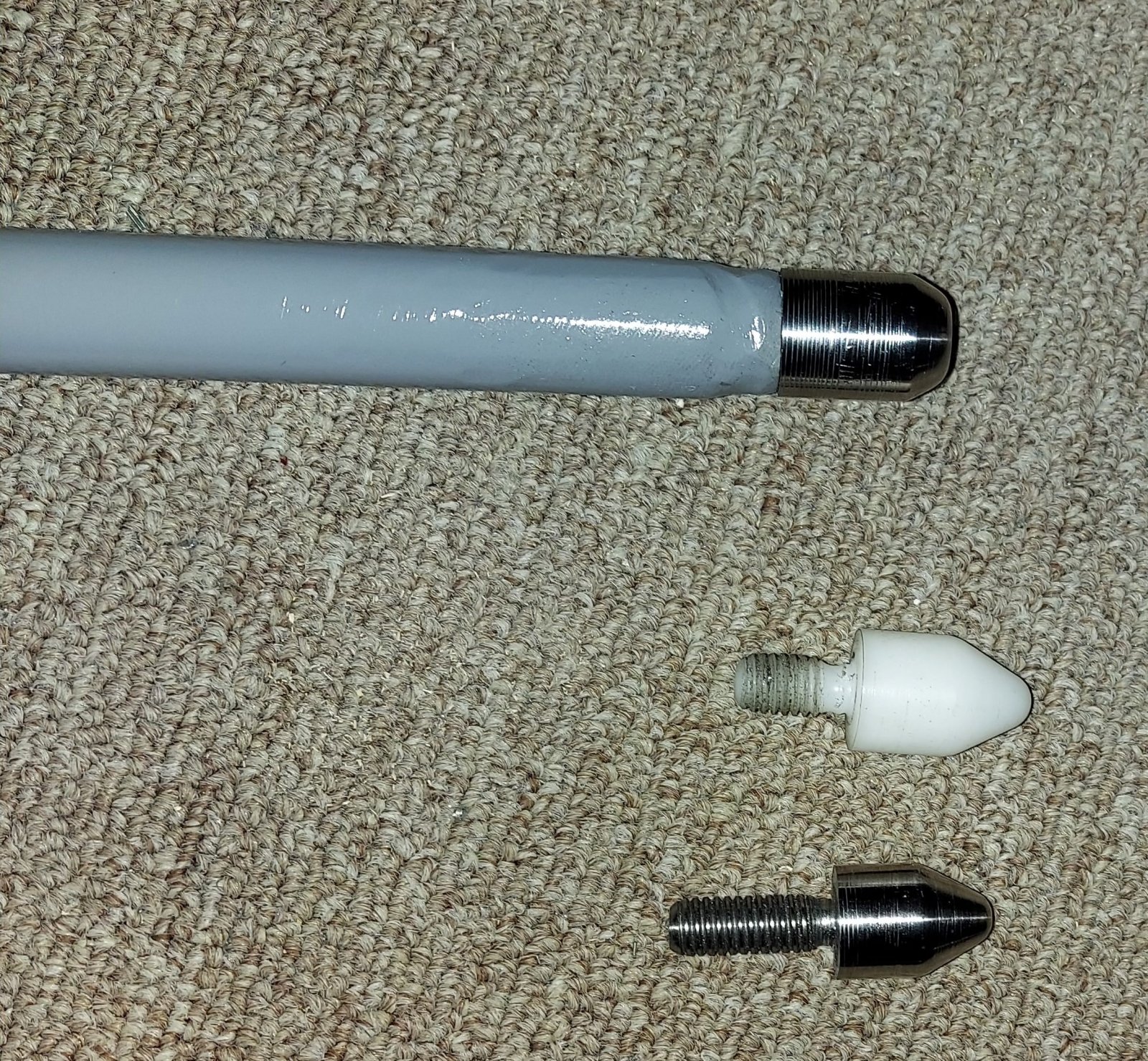

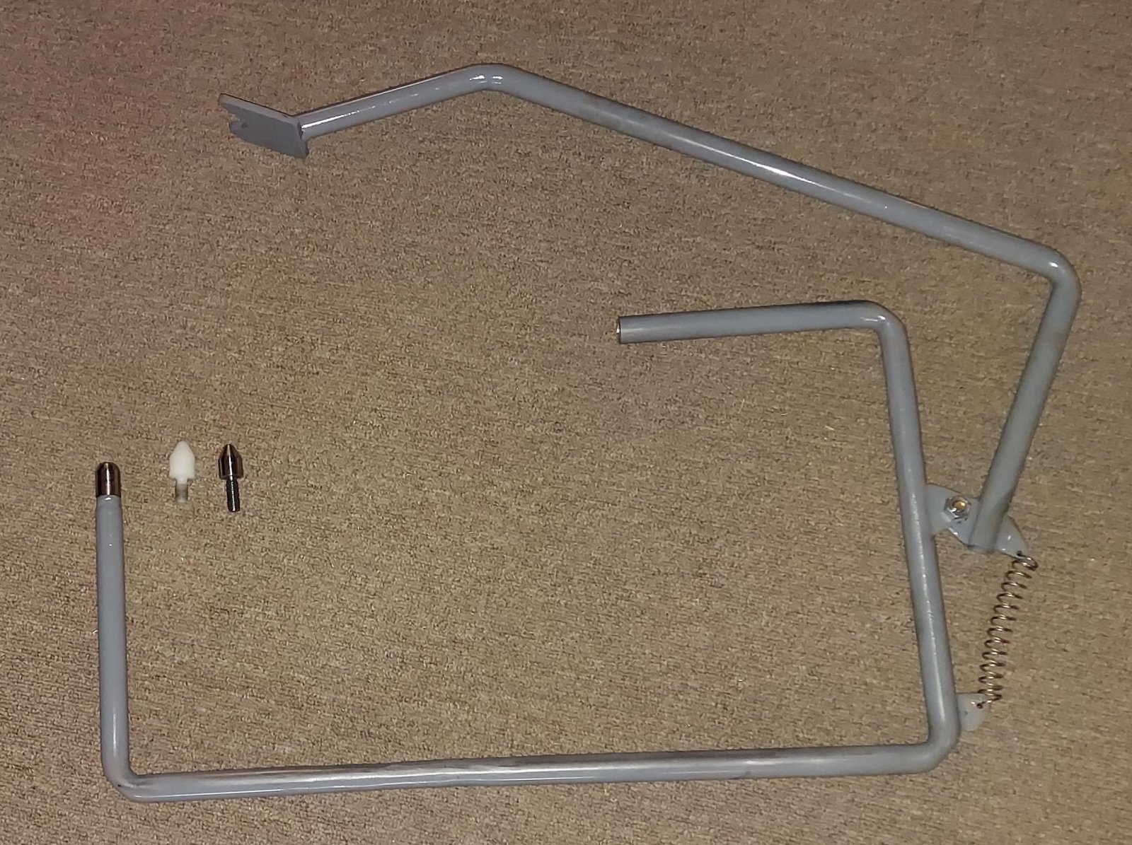

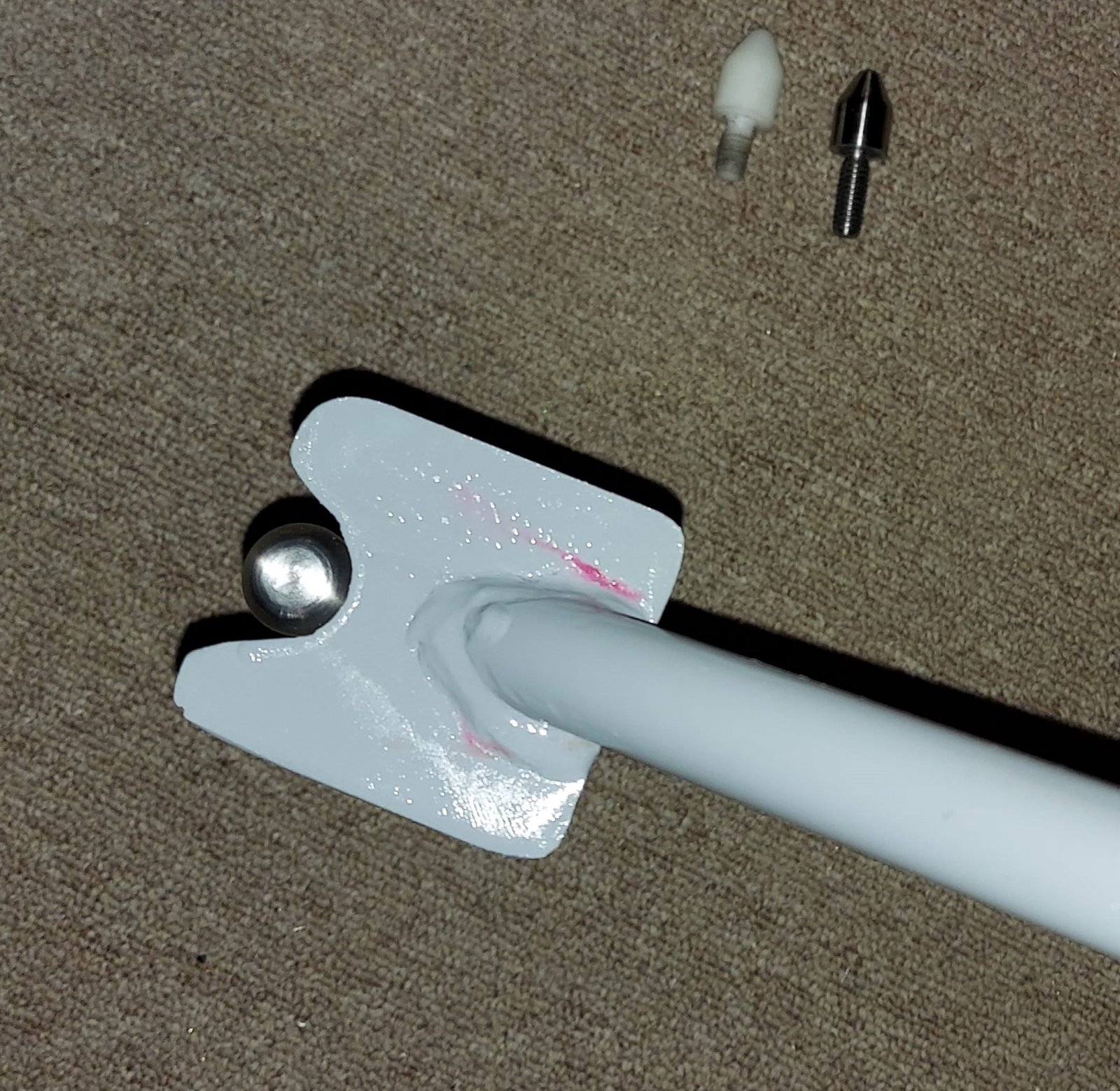

  26. Pretty simple, very mechanical and something I always wanted but didn't want to buy. So I built one. It was lots of fun, only lost a small amount of blood, just the bad stuff that didn't like me anyway and a few burns.
    Made it from 3/4 inch steel tube 1/8 wall and some 1/4 flat steel for the base and the tabs and a random spring I found in the garage.
    I used my cheap off-shore mini lathe to make three different tips for it. The white one is delrin, the other two are mild steel.
    20210823_183845.jpg 20210823_183901.jpg 20210823_183913.jpg 20210823_183950.jpg

    ^^^Nice job, But I'm sorry...what is it and what does it do? I have no idea. I may need to make one though. Lol

    looks like a dent removing tool to me??

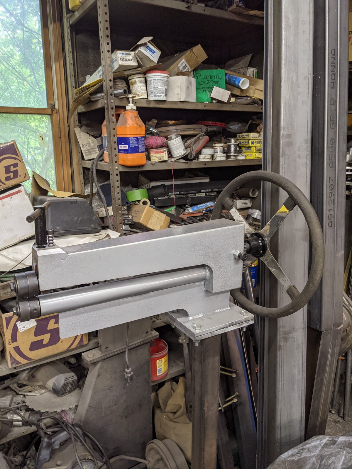

    Whacked out this bead roller frame. I used the July, '94 American Rodder article as a muse and altered dimensions to work with my offshore cheapy guts. Works damn near as good as my old Pexto which I dearly miss. All shafts are br*** bushed and run just right.

    Looks like a Bullseye pick to me, nicely done too!
