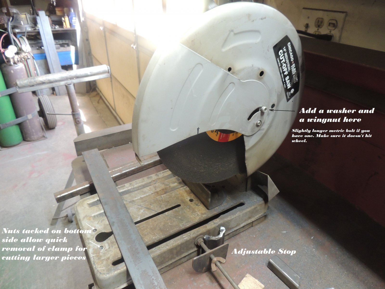

    Heres a small modification I did to my chop saw. Makes it easier to keep the guard up wheen changing wheels. Its also useful when you need to keep the guard up some while cutting. Be sure to wear your safety gl***es if you move the guard up when cutting.

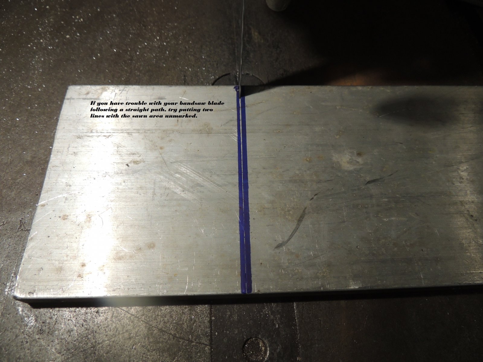

    Here is a trick I use on my bandsaw to help me cut straight. Put a line on each side of the cut. Might be my imagination, but I swear I can cut straighter lines when I do it this way.;)
    VANDENPLAS, chevy3755, X-cpe and 14 others like this.

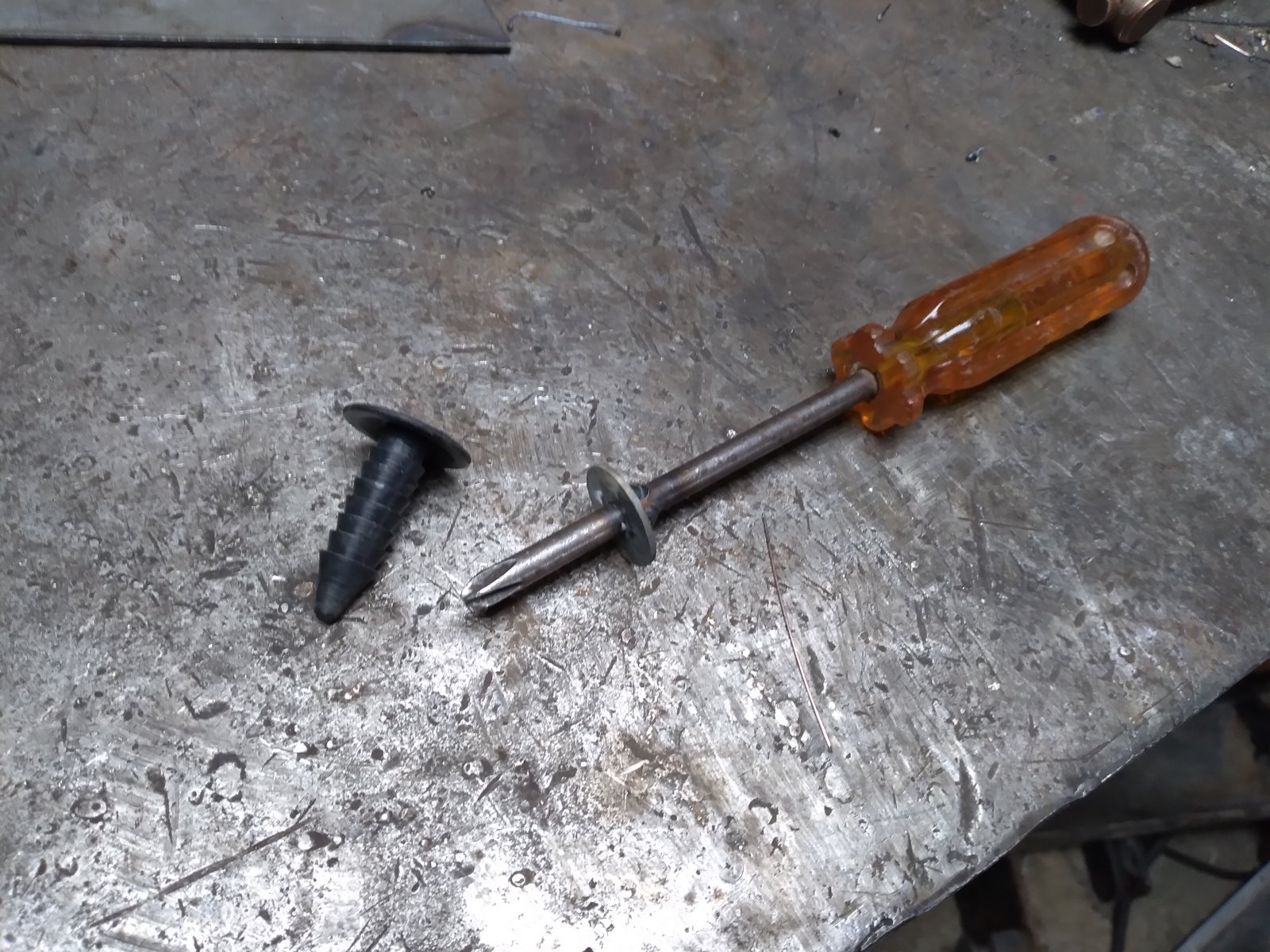

    Well, It's nothing fancy but, if you've ever had to pull the seat-back off of an early Ford pickup, You know the retaining pins are difficult to access.
    I started looking at installing my new third brake light ***embly in my '46 pickup and needed to remove the seat-back for wiring access and mounting the light. But first, I decided to make a tool to help remove the retaining pins. Needed something that makes accessing them easier and won't gouge up the upholstery in the process. A 5mm wrench and old punch sacrificed themselves to make this. It works by slipping over a pin, between the seat bracket and behind the head of the pin, then tapping the tool with a hammer, driving the pin out of the bracket.
    Those pins are tricky to get out....not anymore!:D
    VANDENPLAS, dirt t, LAROKE and 10 others like this.

    Now, how in the heck do you get them back in?

    Ha! First start the pin in with needle nose pliers, then use the tool to drive them back in. The pins have a rounded head that will self center into the face of the little crows foot on the tool. Easy peasy! ;)

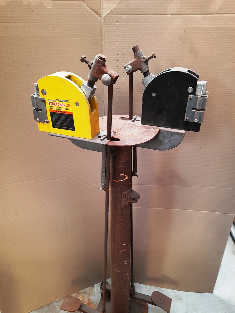

    Yeah, I made my own strinker/stretcher stand with foot pedals.
    Longer pedal stroke seems to help with control.
    I used an old Ford torque tube for the post.
    I will get a pic and post it later...

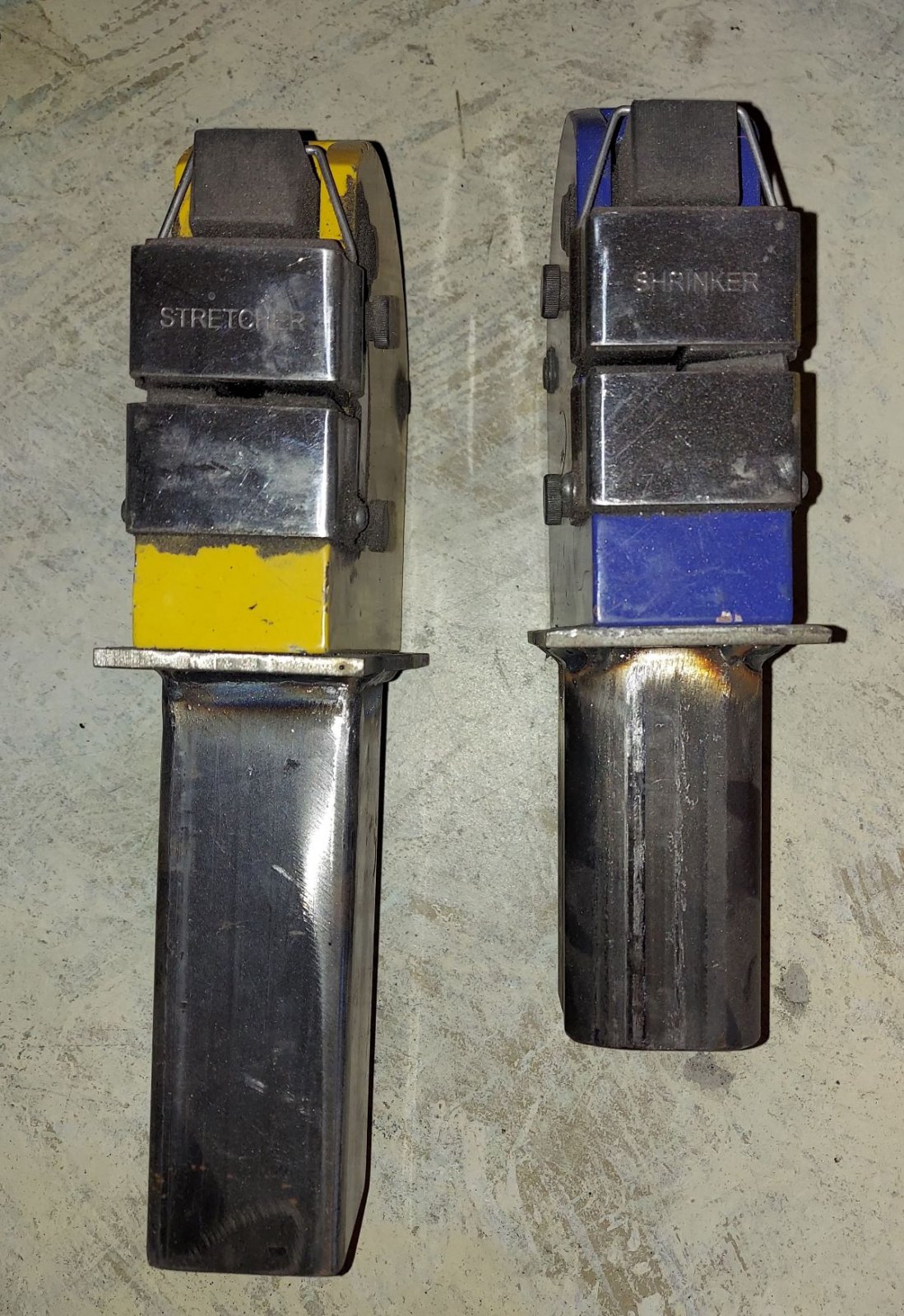

  17. ekimneirbo
    Joined: Apr 29, 2017
    Posts: 5,396
    ekimneirbo
    from Brooks Ky
    As you mention, there is often some finesse involved in using any sheetmetal tool. When Ido something manually, I get tired more easily these days. Also, my son has bad arthritus in his knee and has had some operations to delay a knee replacement as long as possible. He's only 41.
    The thing is that most of the shrinking and stretching doesn't require too much finese. Basically step on the pedal and try to use muscle memory to replicate what you just did. It works fine. When you need to finese it a little, then just use a little less pressure. The air operated set up can also be adjusted for finese. Do the common work and get something close, then adjust the clevis on the rod from the cylinder a little and you have less presure and more finese.
    There isn't anything wrong with doing it manually, but I think someone can finese with the power unit as well. Like I said, a lot of old guys like myself don't have great knees anymore, so this is just something they might be interested in.
    If someone wanted that inth degree of finese manually, all they need to do is pull the pin to disconnect the air cylinder and stick a longer handle in the shrinker/stretcher and finish the part. Very easy and quick.:)
    fauj and loudbang like this.

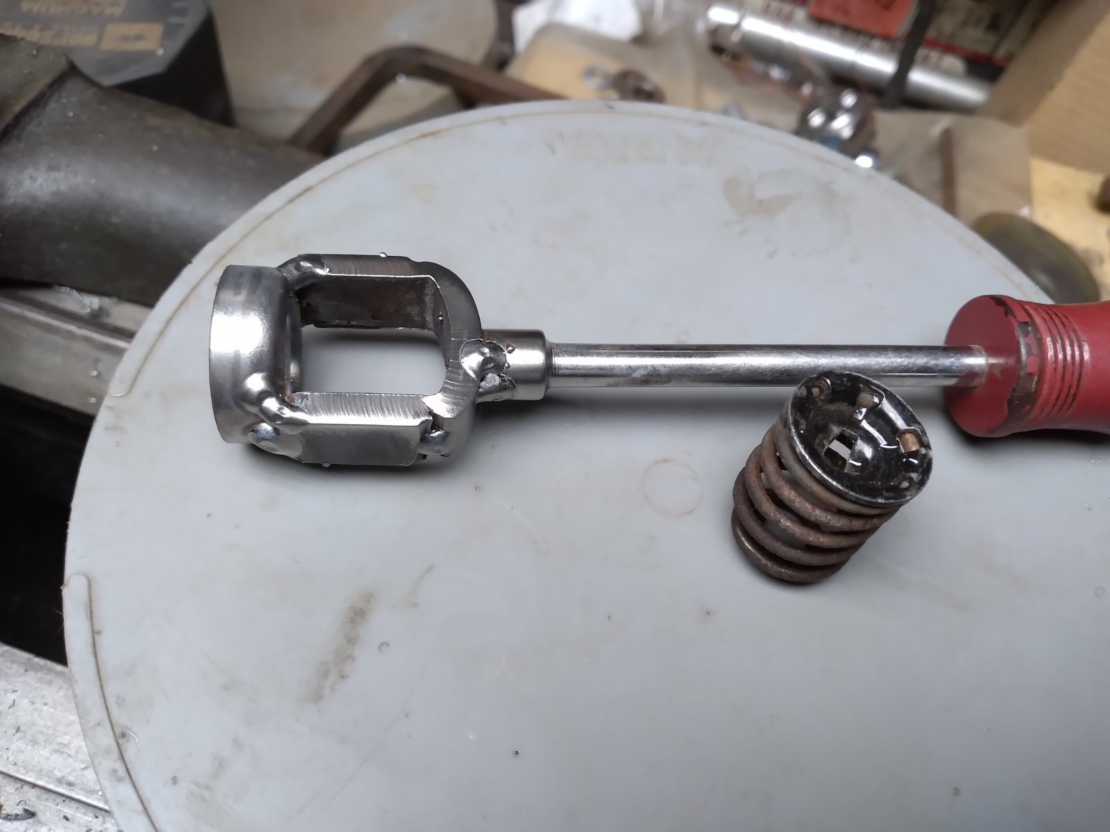

    A friend came round today with a modern cylinder head with bent valves. We tapped the valves down so the springs could be compressed. Because of the design none of my compressors would go down far enough to reach. I just cut a piece of tubing about 1" long and took about 90 degrees of wall out of it and we used that to extend the compressor and get the job done. Funny enough the compressor was an ancient one that was given to me by a very old man when I was a very young man.

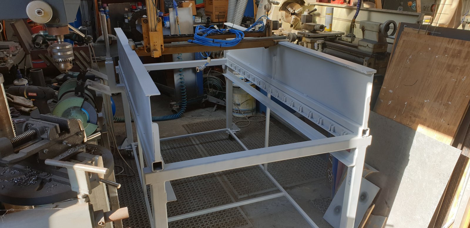

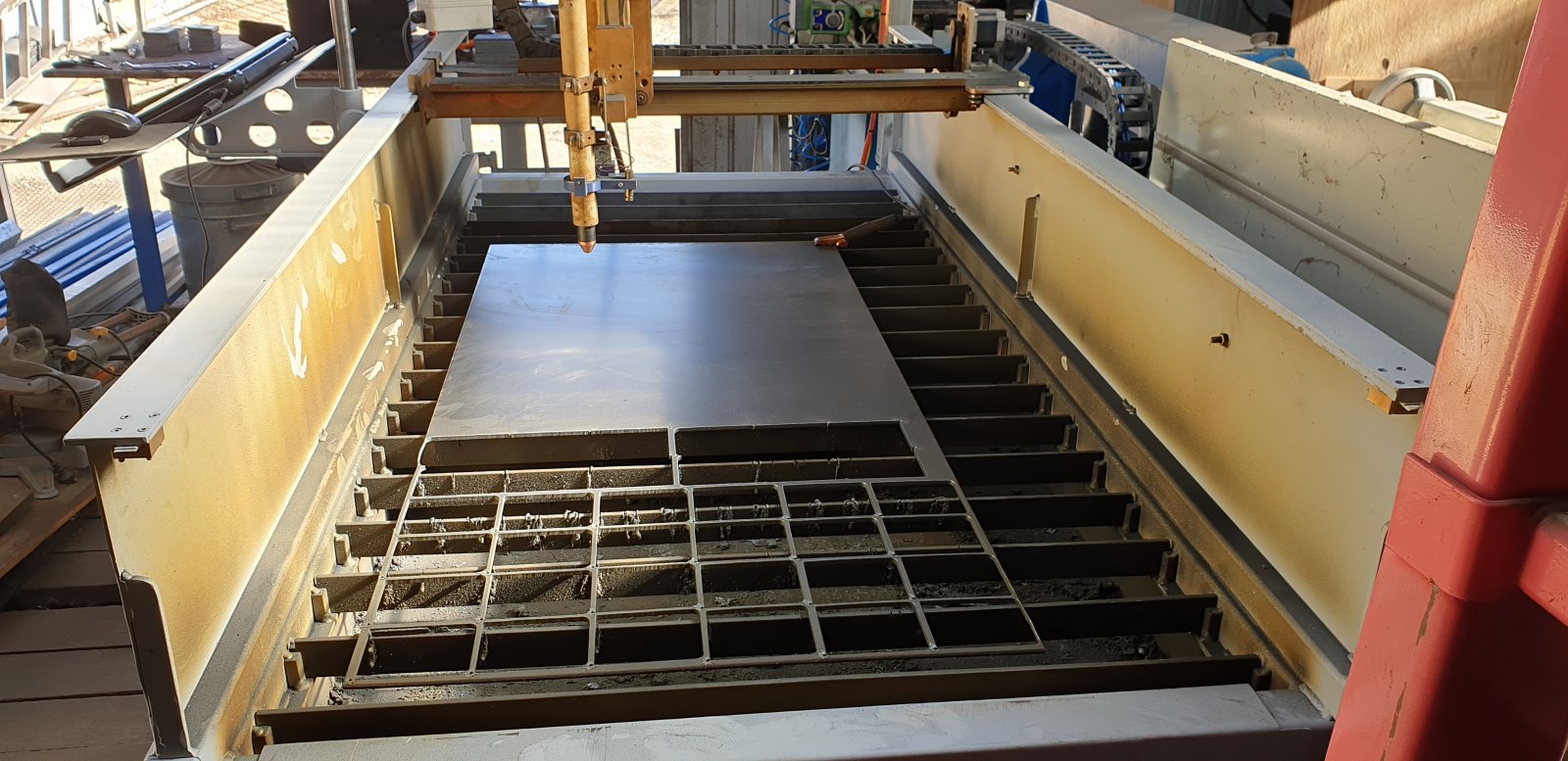

  19. I posted a video and pics of a cnc plasma table I made about 10 years back. It was only a small table. Have built a bigger table earlier this year. Here is a short video of it. Will post build pics soon.
    Mtw fdu.

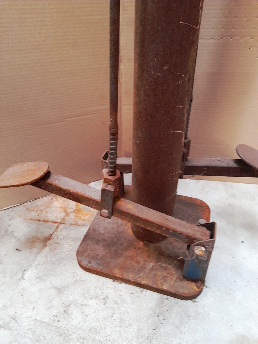

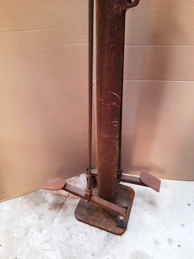

  20. fiftyv8
    Joined: Mar 11, 2007
    Posts: 5,401
    fiftyv8
    from CO & WA
    As promised my torque tube shrinker stretcher traditional style.
    I found some reo bar that has its impressions in a thread arrangement so a nut will turn on to it.
    I used a piece of this reo bar near to my pedals, should I require any adjustment.
    I stuck with the original patina, truth is I never did get around to painting, although my intentions were good.
    Kinder used what I had... 20210912_144214.jpg 20210912_144222.jpg 20210912_144227.jpg 20210912_144239.jpg

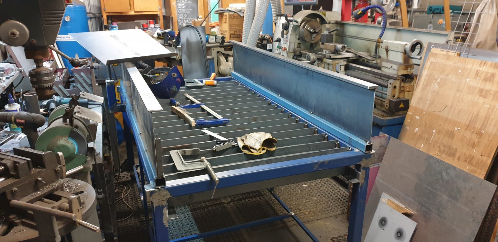

  21. Here are some pictures of my cnc table build.
    Mtw fdu.

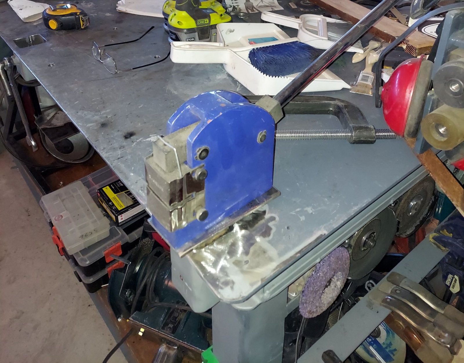

  22. Rusty J
    Joined: Nov 25, 2019
    Posts: 155
    Rusty J

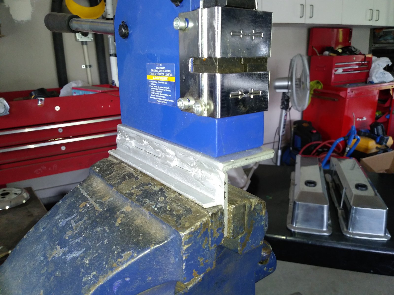

    For my shrinker/stretcher base, I decided to go a bit differently as I didn't need the foot pedal setup at this time, so using some s**** and 2 fender bolts I made this setup that clamps into my vise, and the whole bracket is about the size of my hand, if I need the stretcher - I swap the units by unbolting. I also made a dolly system for my engine hoist so I can move it across my gravel driveway - I'll post pic's of it soon.

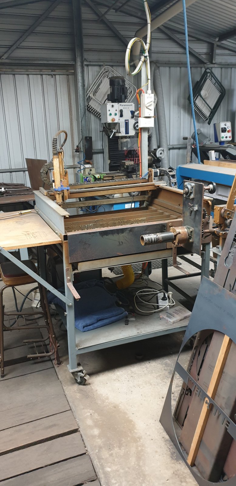

  25. Thanks for the likes guys.
    Here is a pic of my old table. Some of you may remember from a while back.
    The table was half the size physically but the overall cutting size was 650mm x 450mm. Now it is 1350 mm x 650mm.
    I still need to add a rotary axis similar to the other one but it will be over the table instead of at the end.
    Mtw fdu.
    Richard D, loudbang and saltflats like this.
