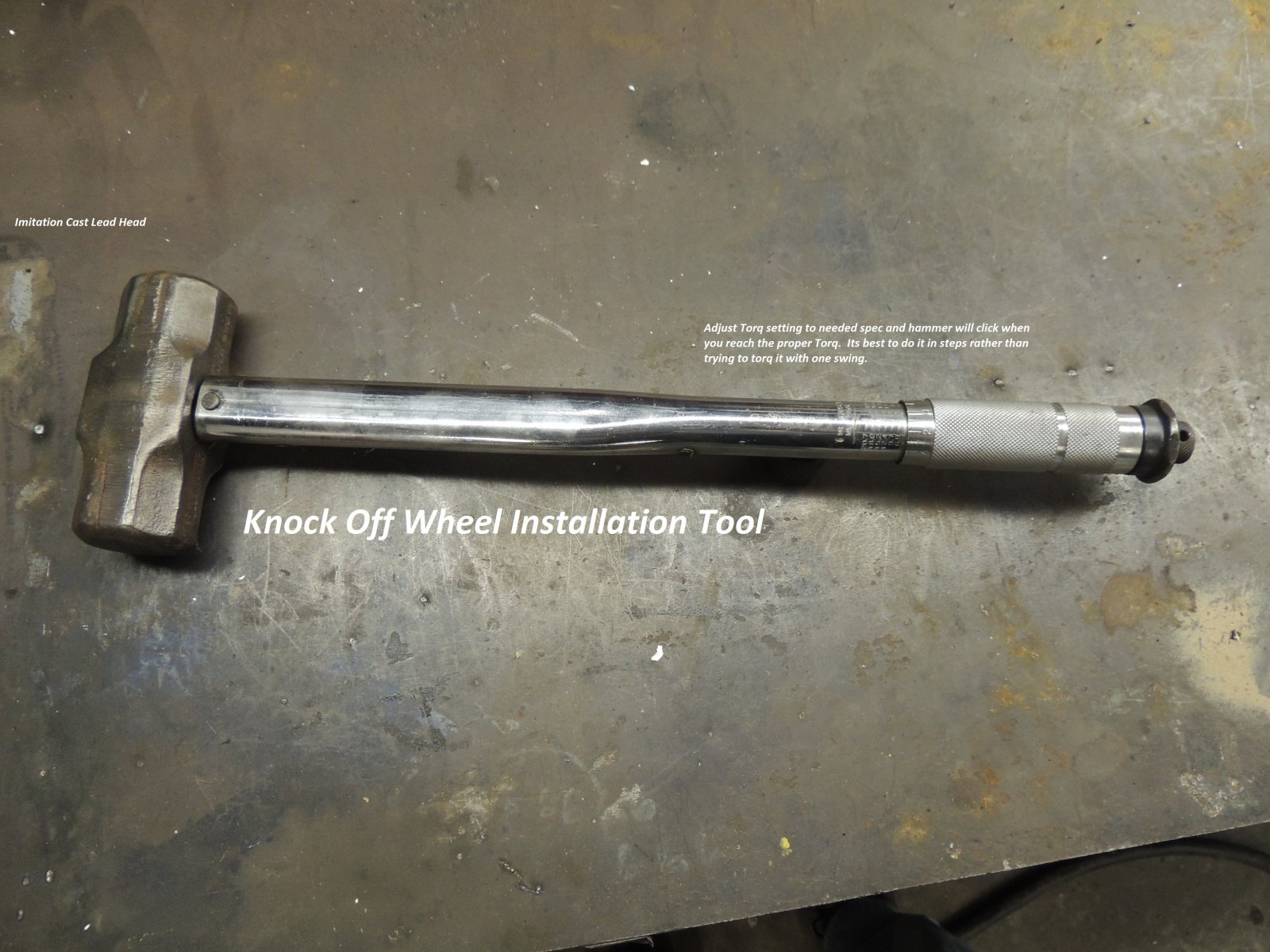

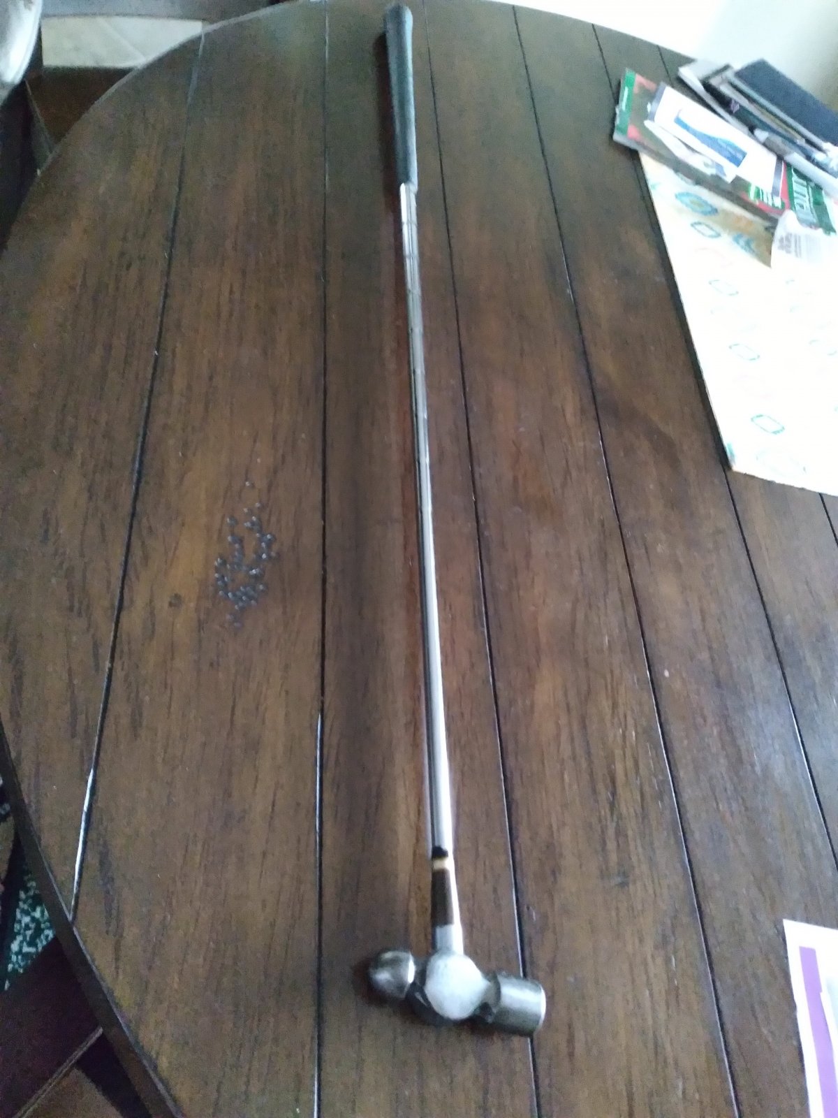

    That reminded me of my Torque Hammer for installing knock off wheels.:p
    :D:D:D:D:D:D:D:D:D:D:D:D:D:D:D:D

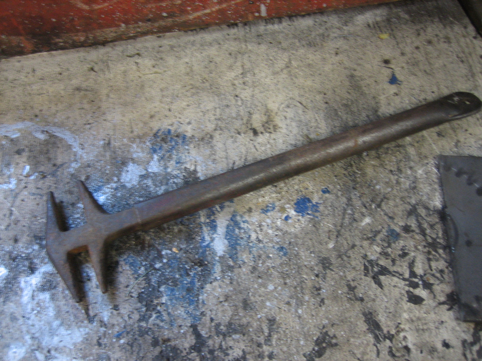

    Anyone know what this tool is for? I use it for bending and tweeking metal. I suspect that is its intended purpose because jewelers pliers and such have the same sort of rounded jaws

  8. Wire fence crimp.

    I've seen similar looking tools used for bending hinges to align doors.

    Looks like something a blacksmith would use to bend iron.

    That looks like it. Called a scroll wrench

    It looks like a tucking tool to me. For shrinking sheet metal edges.

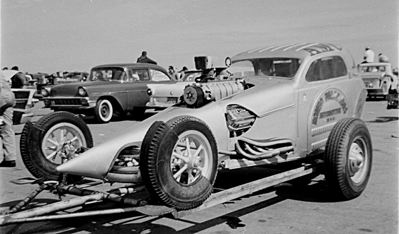

    A couple of half tire stops on front of a race car trailer...
    Hello,
    In early drag racing, towing race cars not built for daily driving created all sorts of situations. Some could be towed with tow bars and that worked out ok, if the trip was not a far away dragstrip. Most compe***ion race cars had homemade trailers that were usually, single wheel versions with careful positioning of the single wheel for balance and handling. But other than ropes and straps holding down the race car, what was to keep it aligned/not moving on the narrow channels for the tires?
    Gerry Card used a nice looking tire support and locked in place item for the narrow front wheels of his Compe***ion Coupe.
    Jnaki
    Being a lightweight Compe***ion Coupe, the extended trailer with the tires built in to the rear portion of the trailer did its intended job. The front narrow tires, now had a place to call home.
    We saw this Compe***ion Coupe in the 1960 Bakersfield Smokers March Meet and it was painted black, but the basics were there in the design.
    Gerry Card Compe***ion Coupe

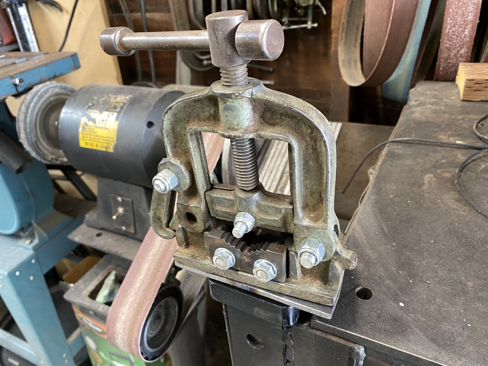

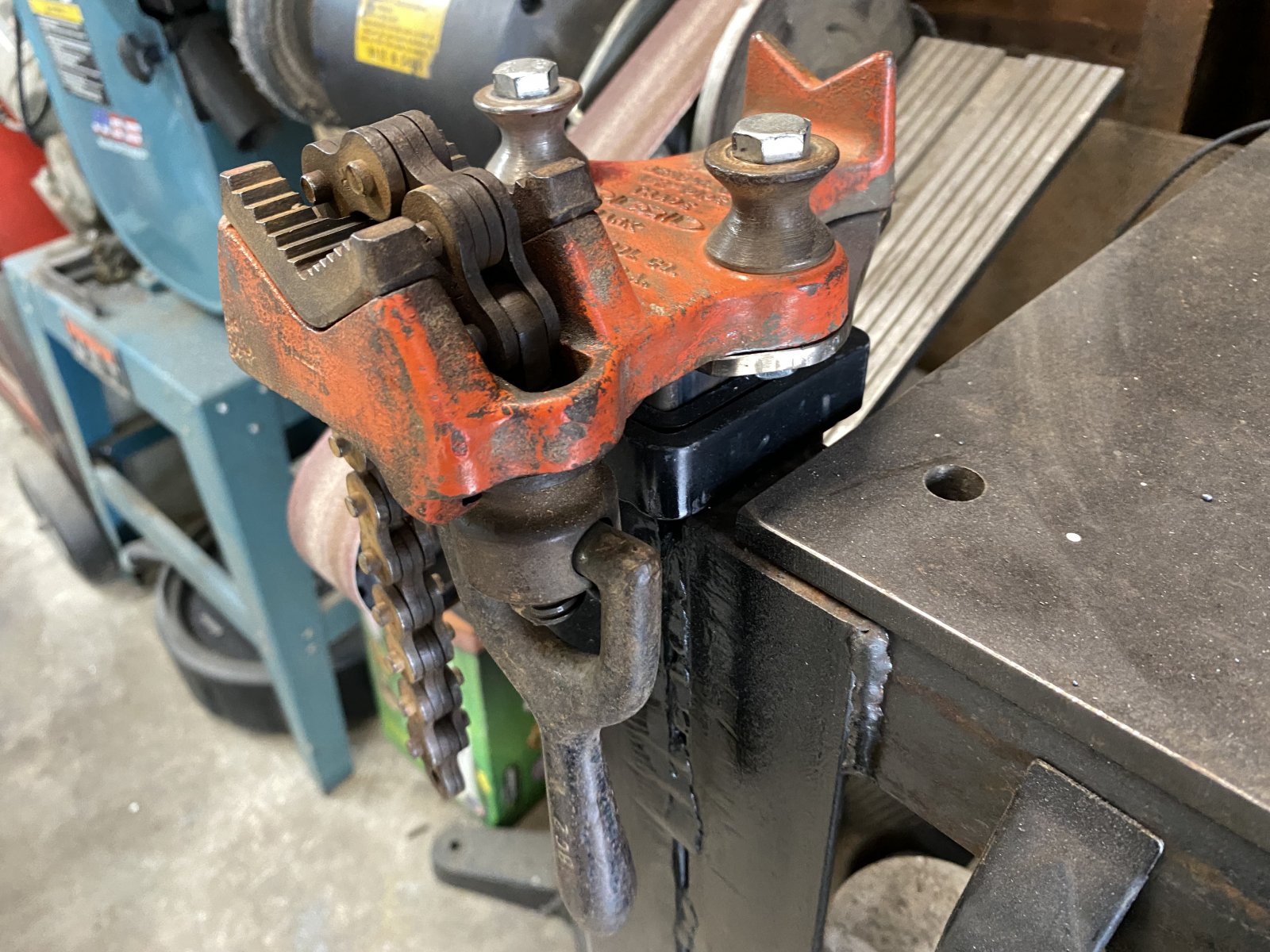

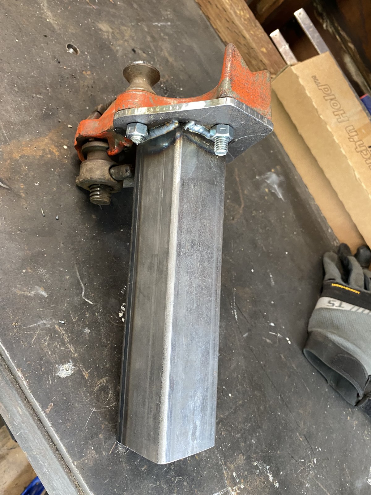

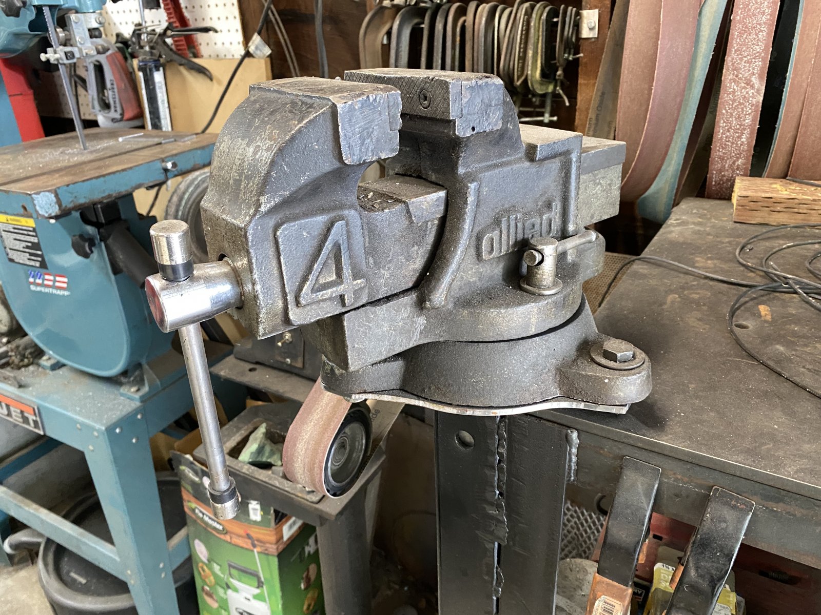

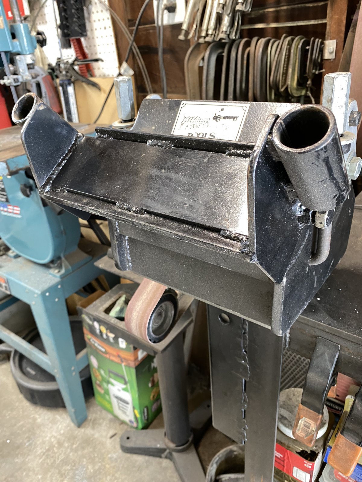

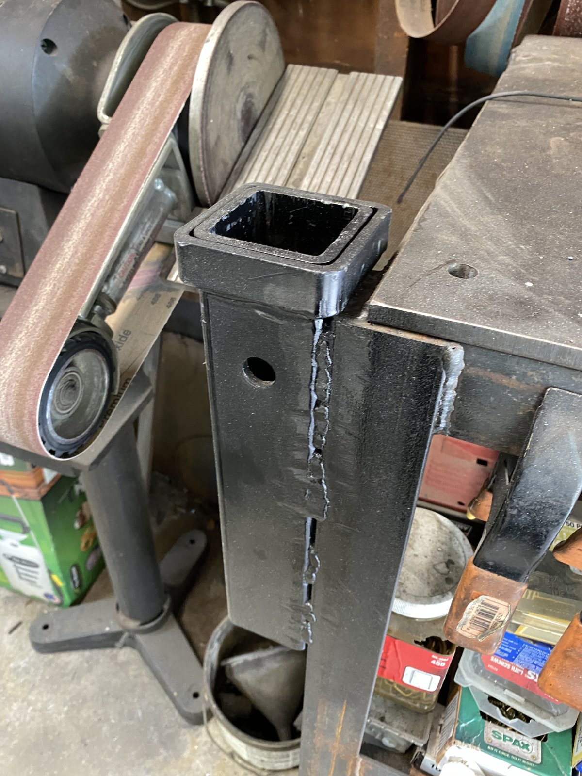

    My shop/1.5 car garage is a little short on space so I came up with this for multiple bolt down tools....Used an old receiver section welded to the work/welding bench...easy swap out for whatever I need at the time. 838A006A-0D3D-474D-B528-74DBC1B87891.jpeg 9B49C808-6DA3-4FDA-BC72-8F965D49AA0B.jpeg 49807055-CEE8-4A0C-ADAA-14BD47940829.jpeg D13224F0-BA35-47B3-82F8-34967E391130.jpeg FE3D0900-81F6-4657-BBFB-17CE017EF29C.jpeg 6931B3CF-1BA3-4234-8438-A7E883AD11AB.jpeg
  21. chiro
    Joined: Jun 23, 2008
    Posts: 1,316
    chiro
    ^^^I really like that and I'm gonna steal it.
    Andy
    Cosmo49, LAROKE and loudbang like this.

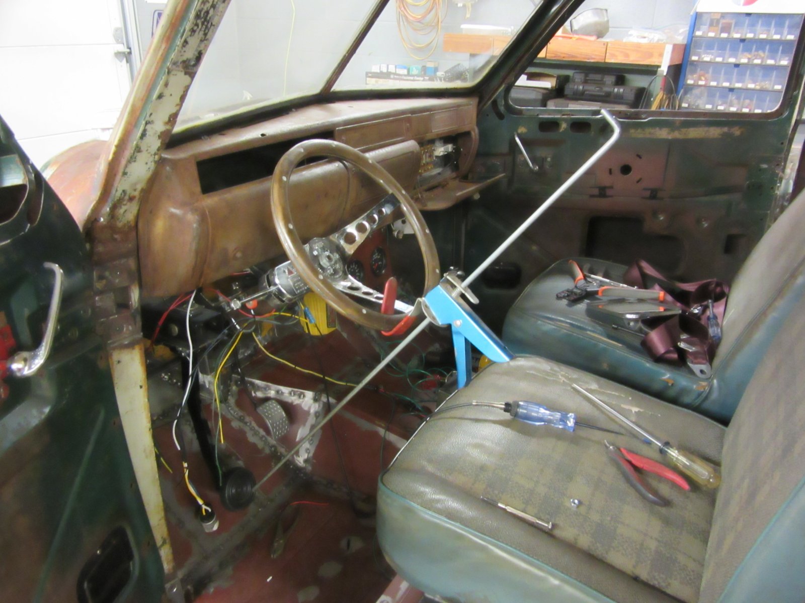

    I showed using this tool on another thread and it was suggested I post it on here. It is not homemade but I would think a person could duplicate it. It is a throttle rod and in my life we mainly used it to hold the rpm while spin balancing tires on the car or for AC working when charging the system. Also handy for one person brake bleeding. Here is the l STUDEBAKER BUILD 004.JPG ink https://www.toolsource.com/general-...rottle-pedal-depressor-universal-p-54386.html
  23. Sporty45
    Joined: Jun 1, 2015
    Posts: 1,388
    Sporty45
    I like that! It looks like you fab it up from an old caulking gun too. :cool:
  24. J. A. Miller
    Joined: Dec 30, 2010
    Posts: 2,352
    J. A. Miller
    from Central NY
    Yeah, and for a lot less than $35.00!!
    Sporty45, fauj and loudbang like this.

    Gene Winfield built a metal working station with a post like yours. Chad Hiltz bought it, and you can see it in a few of his videos. I really like the idea and might copy it one day.
