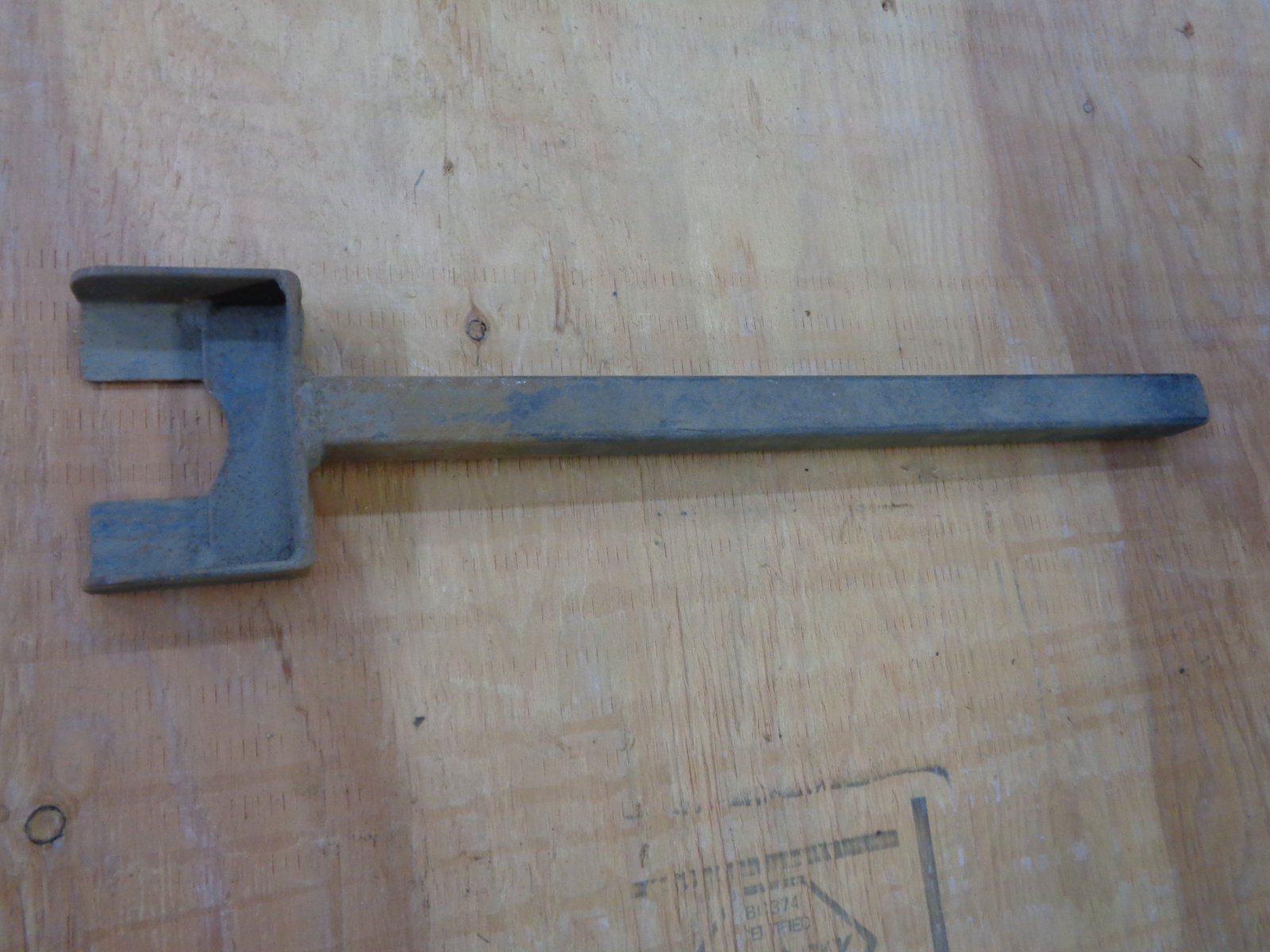

    Wrench for the input shaft front bearing retainer nut on a Muncie.

    Made one that was almost identical to that a while back. Unfortunately I don't remember what it was for or where I put it. But it worked perfectly. Thanx for the reminder.
    Now I'll be looking for it the next trip to the shop. Yeah, it's only a few steps from the house but I'm old; it's cold; there's many inches of white rain out there right now; I ran the snowblower for an hour and a half yesterday and don't feel like doing any more; I'll look after the next meltdown.

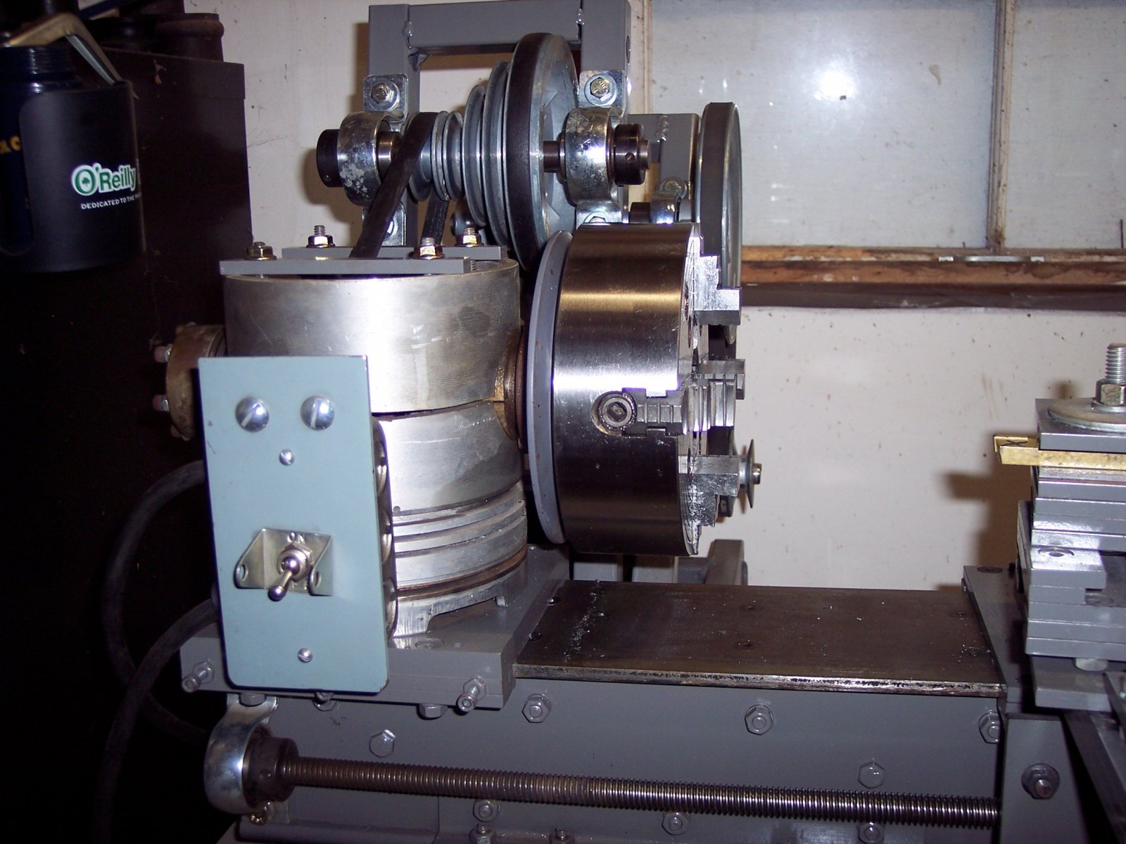

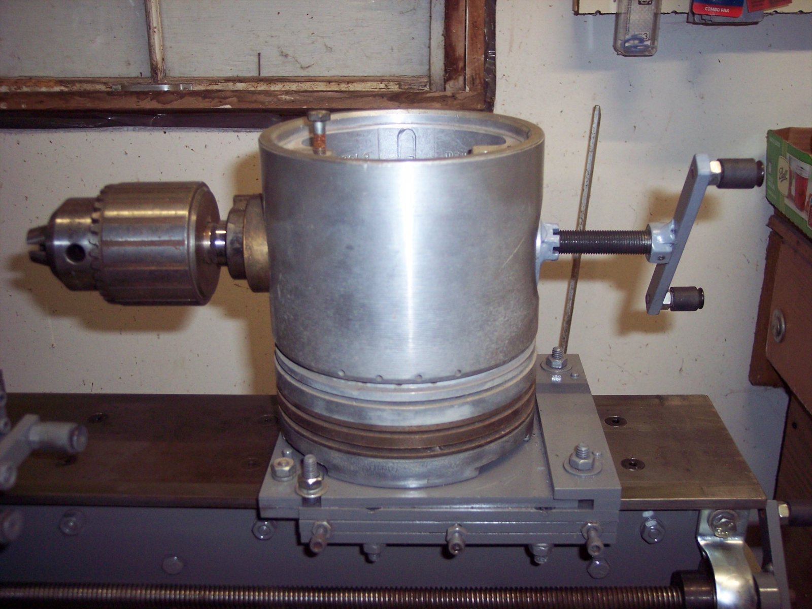

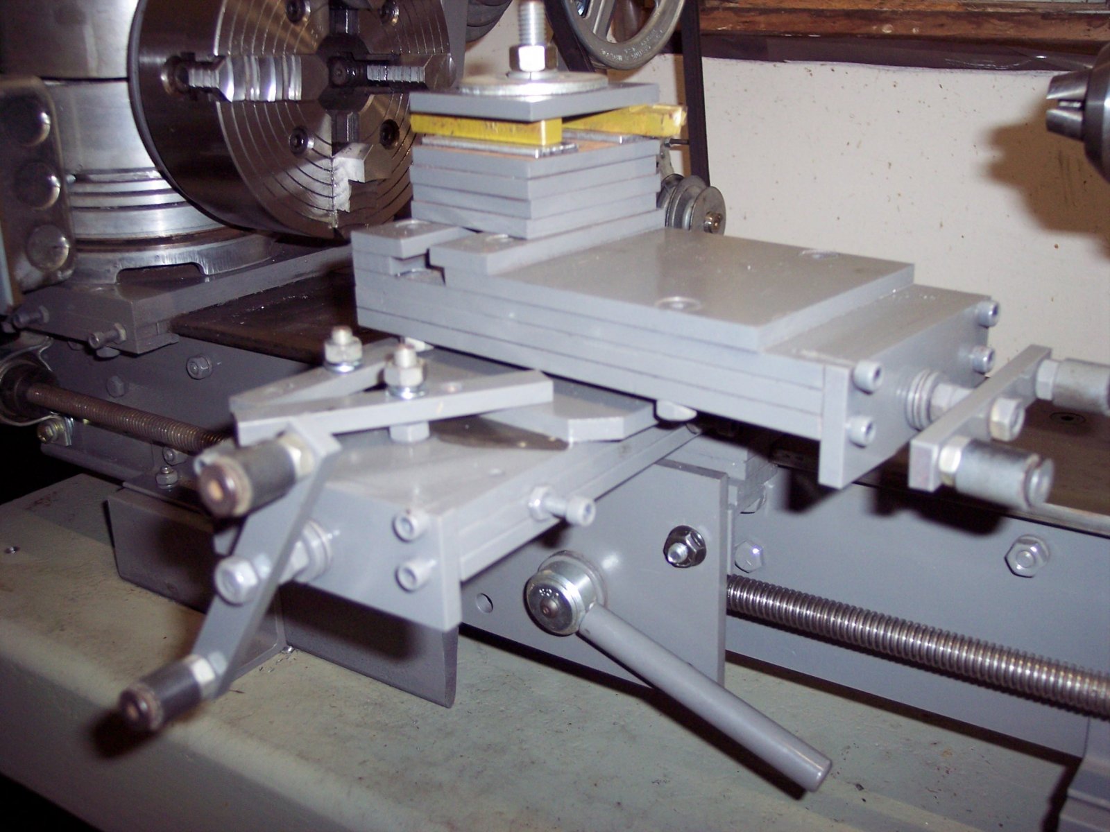

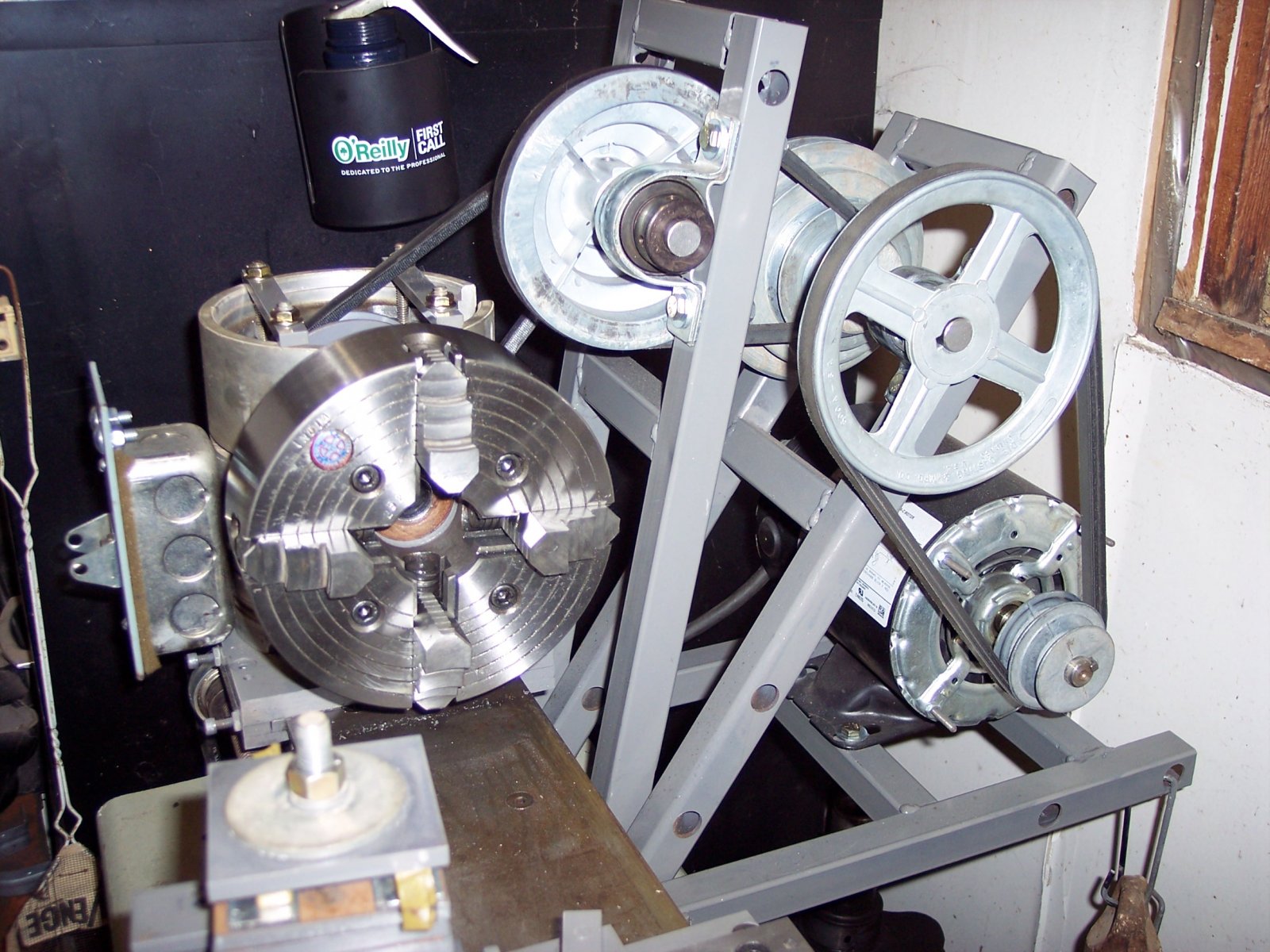

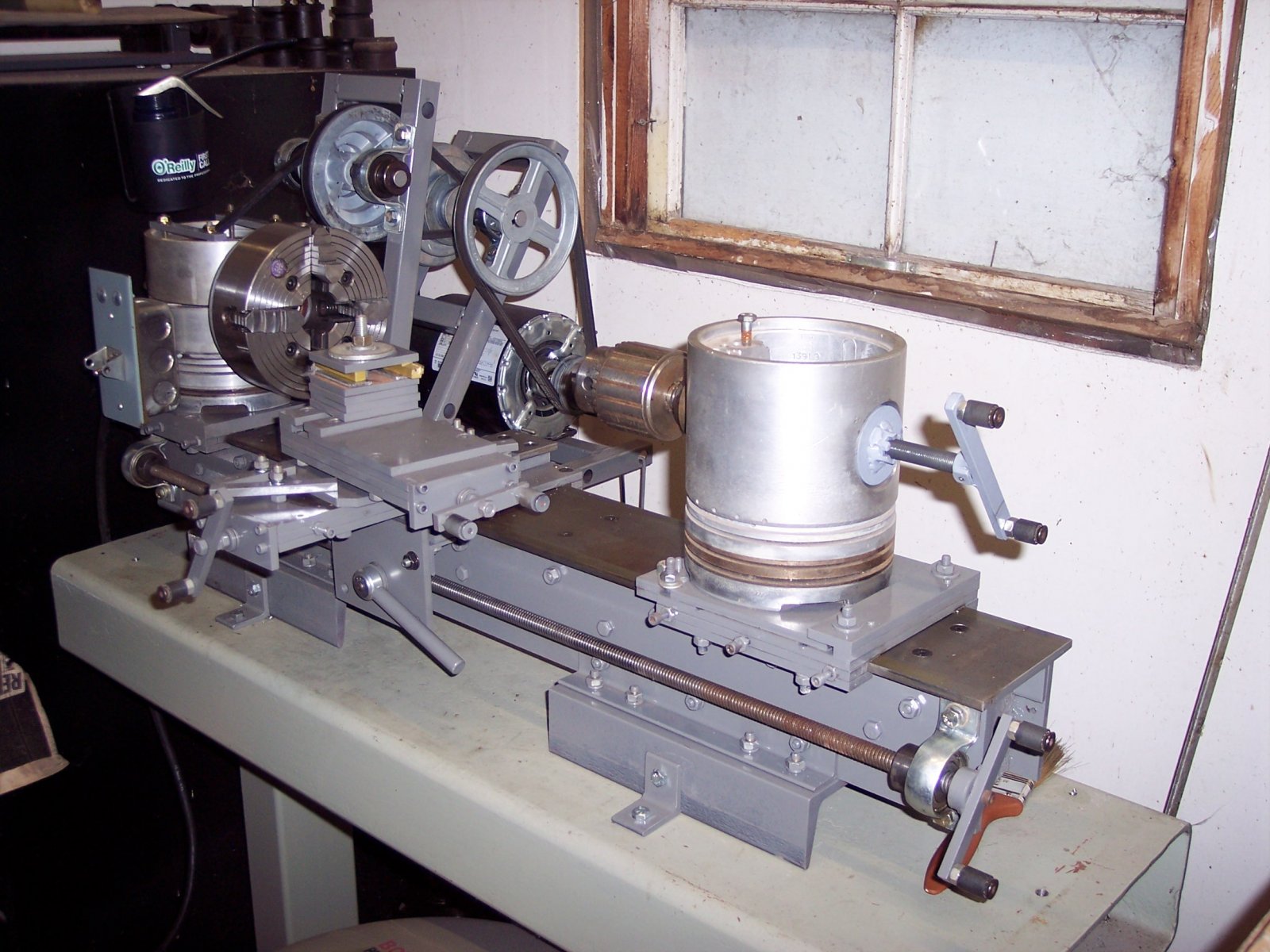

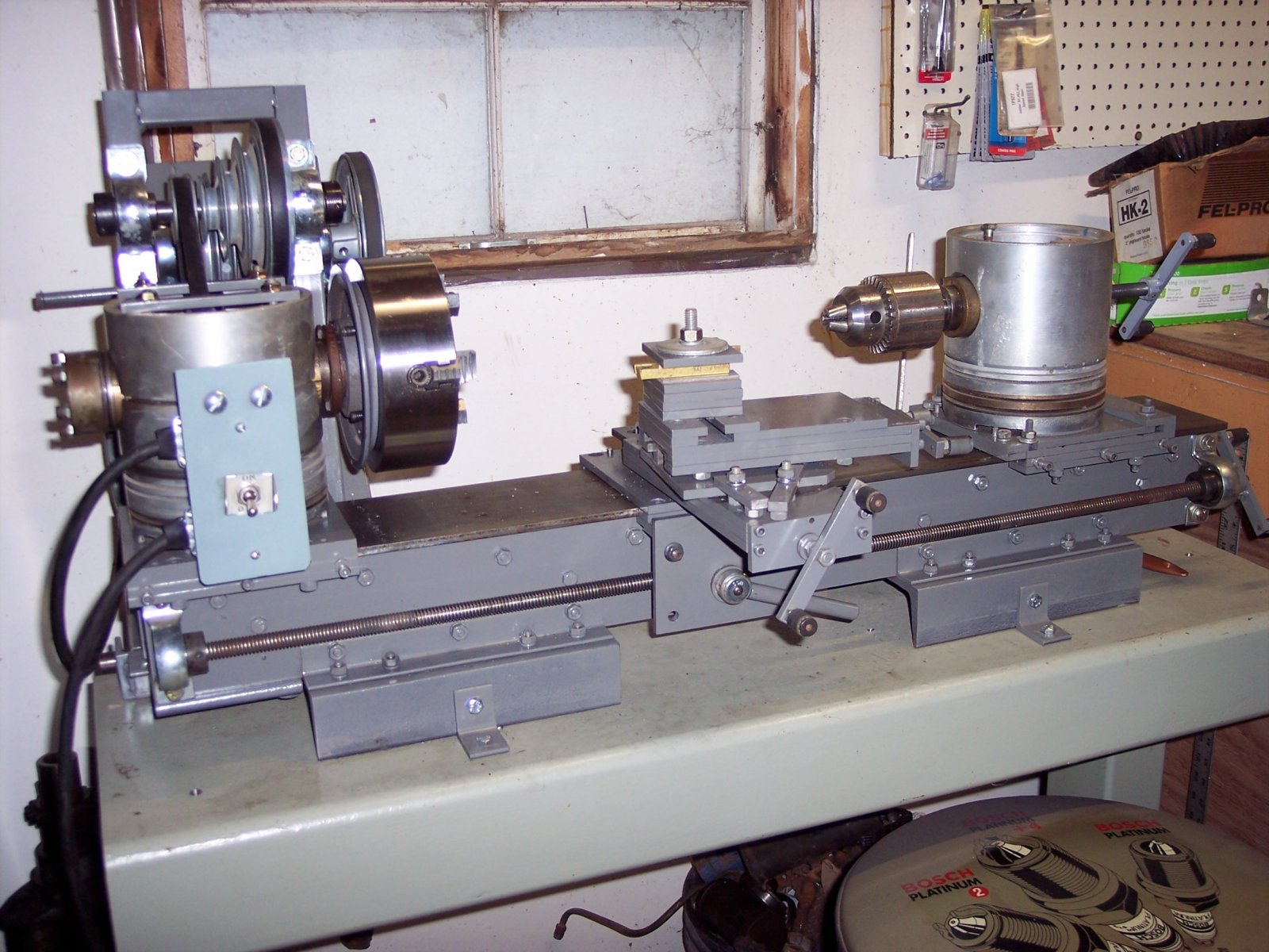

    Not sure why it posted all the pictures twice. Anyway, there used to be a company called Lindsey Publications that did reprints of old technical books. Steam engines, machine shop operating manuals, that sort of thing. They also published do it yourself tool books and plans. Got the plans years ago, started building it, and it sat on my bench forever. Couple of weeks ago I decided I wanted my bench space back so I got my *** in gear and finished it. Headstock and tailstock are ***mins diesel pistons, pretty much everything else is cold rolled steel.

    I've got a set of books reprinting make your own things from the '30s from Popular Mechanics However most of the starting parts can't be found

    Nice job! I'm into plaigerizing people. I have an older Delta Double Duty wood/metal lathe, but unfortunately it didn't come with the metal machining attachments. But looking at your piece of machine art, I can now see how I can make the missing parts.

    I like the home made lathe. Very cool.

    @bigdog Nice job on the lathe. I have those plans. There was also a milling machine made using the pistons as well if im not mistaken.
