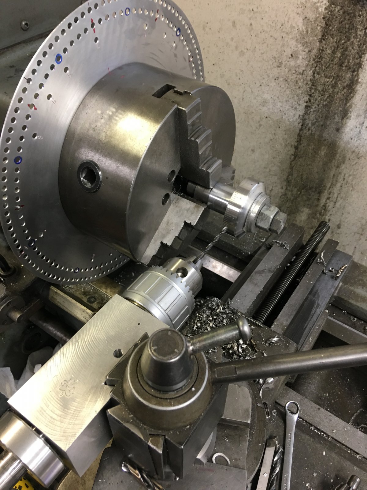

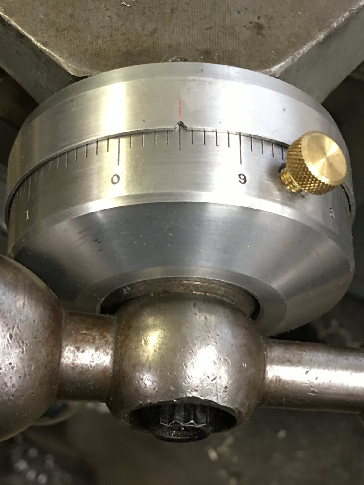

    my lathe has been missing the compound dial since I took ownership of it. Finally made and installed the dial. I’m real pleased with the results.

    @TRENDZ ,
    Nice job on the cross feed dial. I'm also impressed with your indexing wheel.
    What hole patterns do you have? What do you use it for?

    Great job on the dial. It looks very professional. I like the toolpost mounted drilling head too. I love using my lathe and milling machine.

    The indexing wheel is just thin sheet aluminum. I made it with 100 holes on the inner ring(specifically for this project) and 120 holes on the outer ring. It is located by 3 small dowels on the back of the chuck with small screws to hold it on. The dowel pins are strategically located to change the placement on the chuck so that the wheel can be moved to use the 120 holes in three positions… making it divisible into 360°. The wheel is easily removed to prevent damage. There are a few other common pattern holes (8, 6, 5, 4) to make it less likely to miscalculate counting/ dividing.

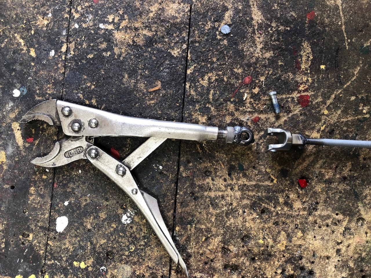

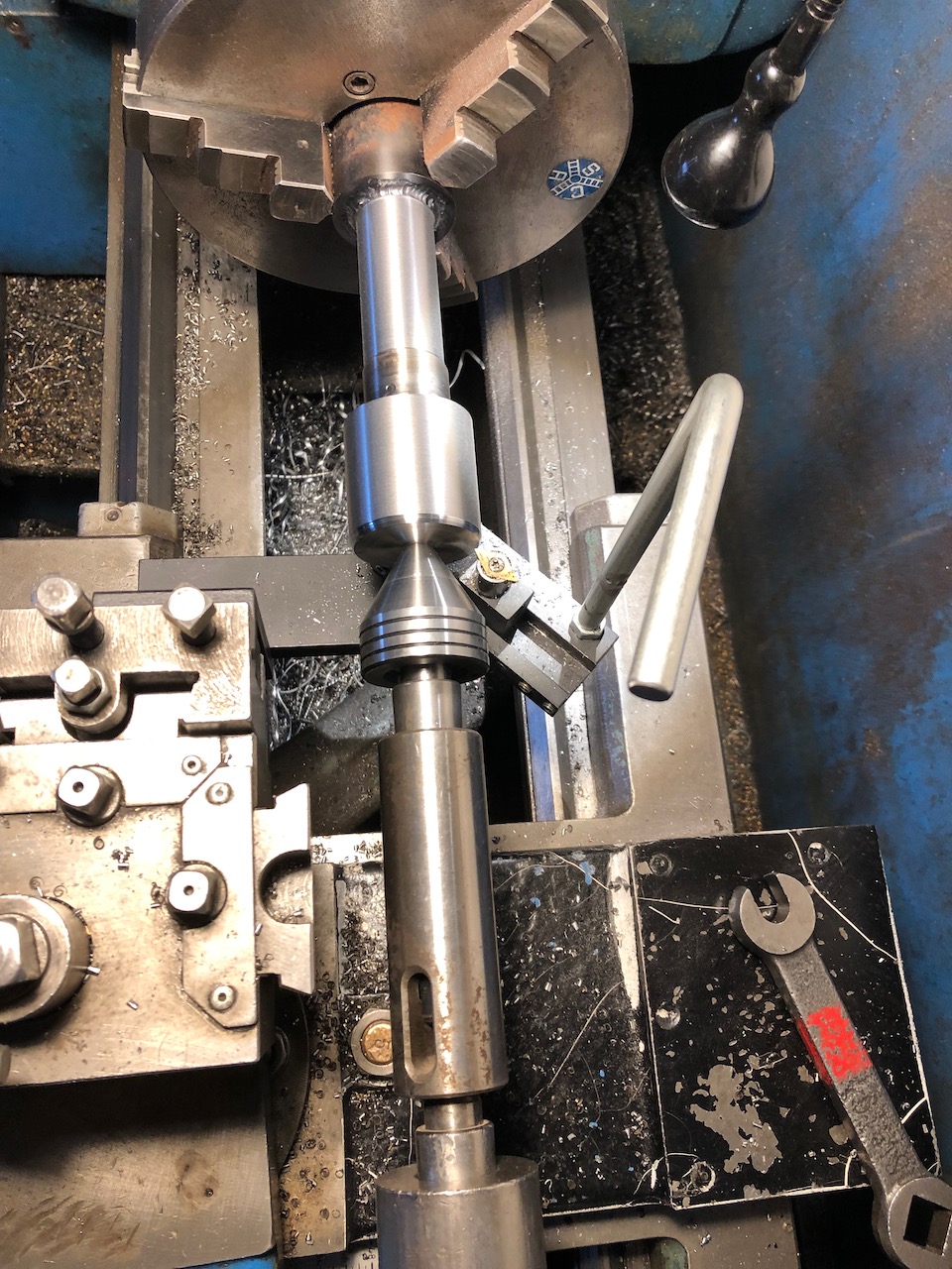

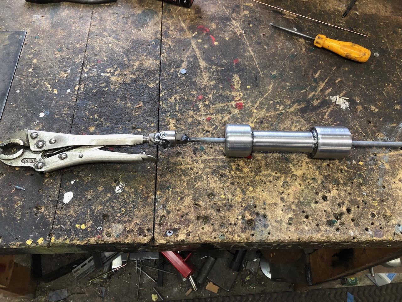

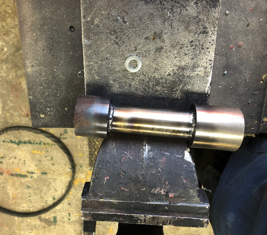

    I had no desire to pay 60-120 USD for a locking plier/hammer.
    I looked in my s**** boxes,did some welding and a little turning work.
    I will buy beer for all that money instead. IMG_1134 (2).jpeg Skärmavbild 2022-04-16 kl. 14.36.58.png IMG_1138.jpeg IMG_1141.jpeg

    Good job! Very nice lathe work.
    Here are a couple more that have been posted on the hamb (probably on this thread):
    Note that all of these can still be used as a regular vise grip by unscrewing the rod or pulling the pin.

    @j hansen I like your adaptation! You can take it apart and just use as a vise grip if needed.
    I'll be stealing this plan!
