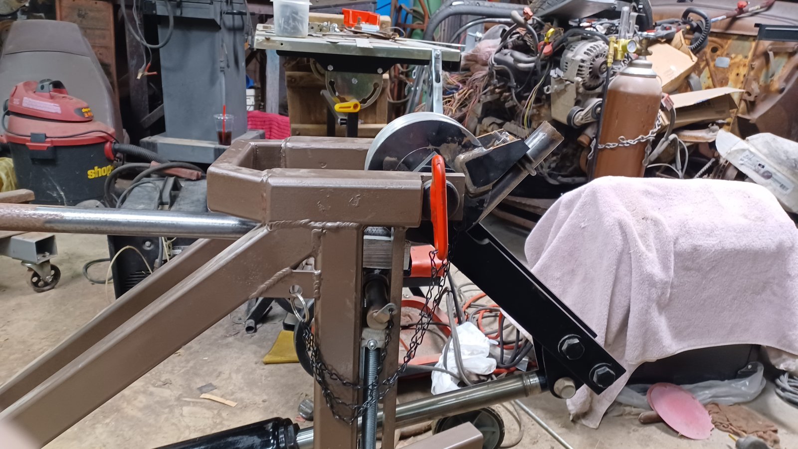

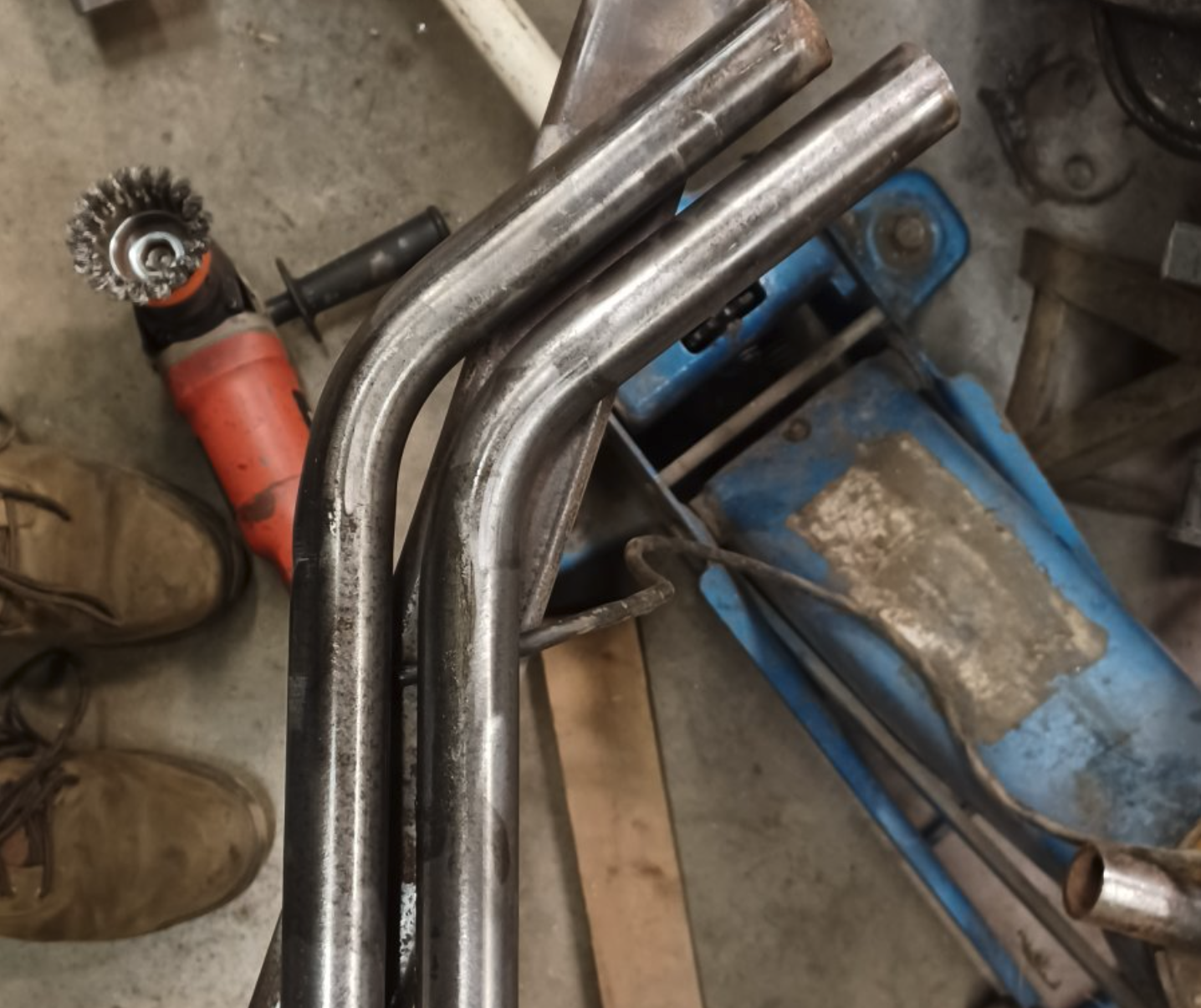

    Finally!! It's been 3 yrs since I built my homemade heavy duty tube bender. Even made my own dies. Built it to be universal so that I could use any companies dies on it.
    Wel tonight I finally got to the point I'm ready to use it and it worked great! The first tube was kind of a pain figuring out how I wanted to set it up, the second one took longer to set up than to bend it.
    Really happy with the way it came out! Between old stuff I had laying around and using the ram out of my engine hoist I'm into it for under 150 bucks including the metal for the 2 dies I built with it.
    Here's a few pics.

    It's 1-1/4x .120 wall tube. Finished the bends in those today, downside is, I use the jack from my hoist so now I need to pull the engine and trans out so I can finish install the tubes, then swap the jack again so I can install the engine trans again to build the trans crossmember which means swapping jack again!
    Maybe it's time for a trip to harbor freight to see what Jack's they have.....

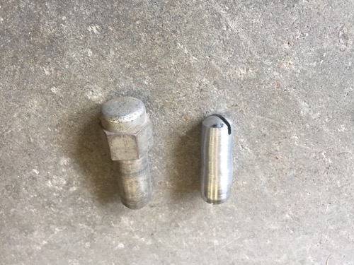

    Large mag wheels with the long shank lug nuts are getting hard for me get back on the studs and align the studs to start the lug nuts. I ground the hex head off of a couple of old lug nuts and cut a slot in the top with a cutoff wheel. Now I can screw on two of these guide pins, slide the wheel on, start a couple of lug nuts, and then remove the pins with a screwdriver.
  11. I love these simple but slick tricks like this! Good use for those rusty chipped ones you don't throw away 'just because'... LOL

    This is clever. I struggle with them too. End up sitting on the ground with the tyre on my lap, using my thighs to lift the wheel up and down to get the lugnuts to align. I end up filthy dirty. Your way is smarter.

    Good one! I already made some, works great!

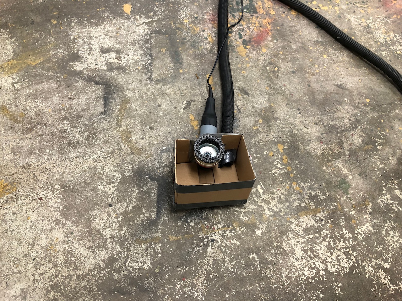

    I have been thinking about painting the garage floor for over 10 years now.
    And now is the time,but I wanted to at least wire brush the floor first, but I didn`t want it to dust up to much.
    So I took a cardboard box and grinder and my vacuum cleaner,and it became a spark and dust catcher,not Heavy Duty but it was enough to do the job.

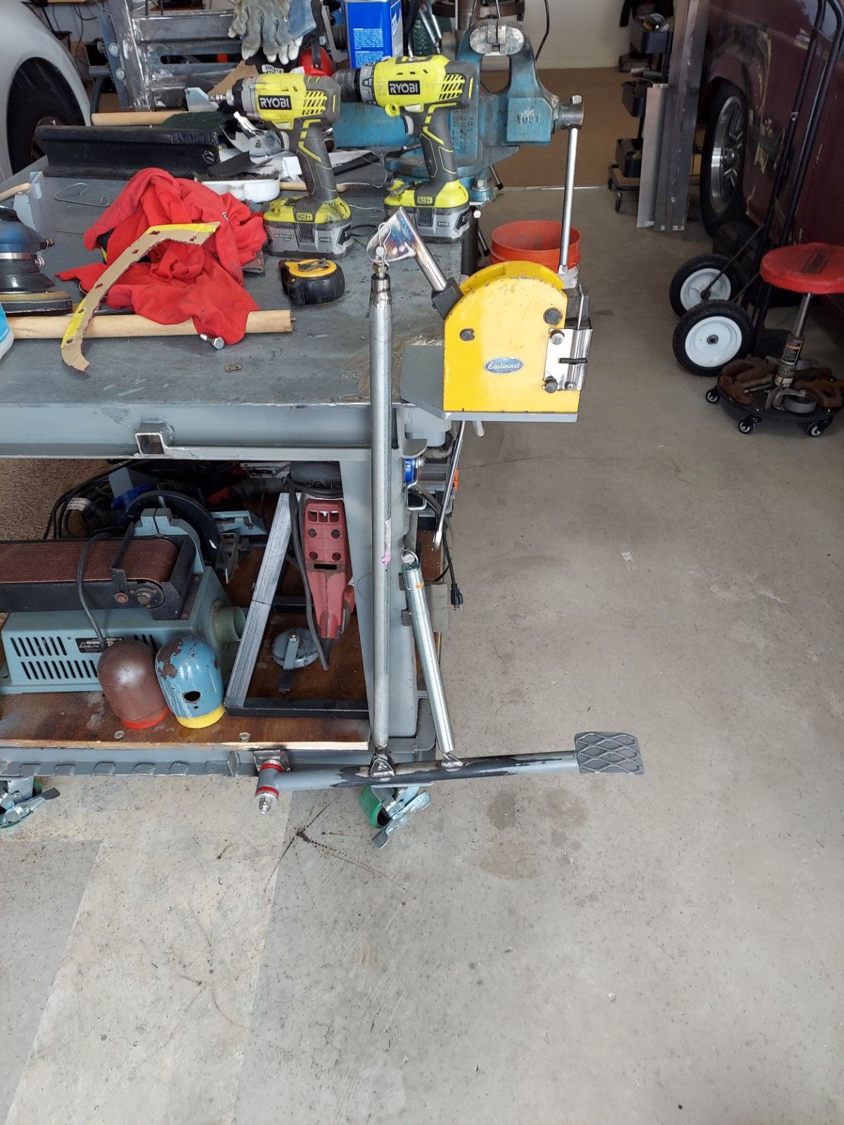

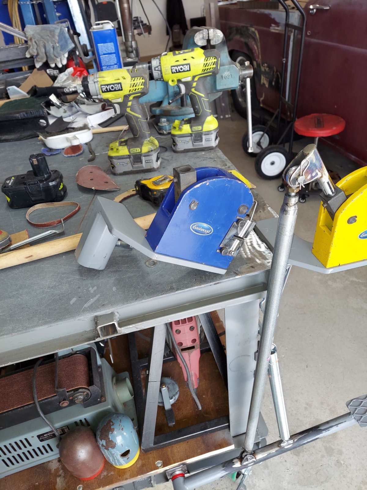

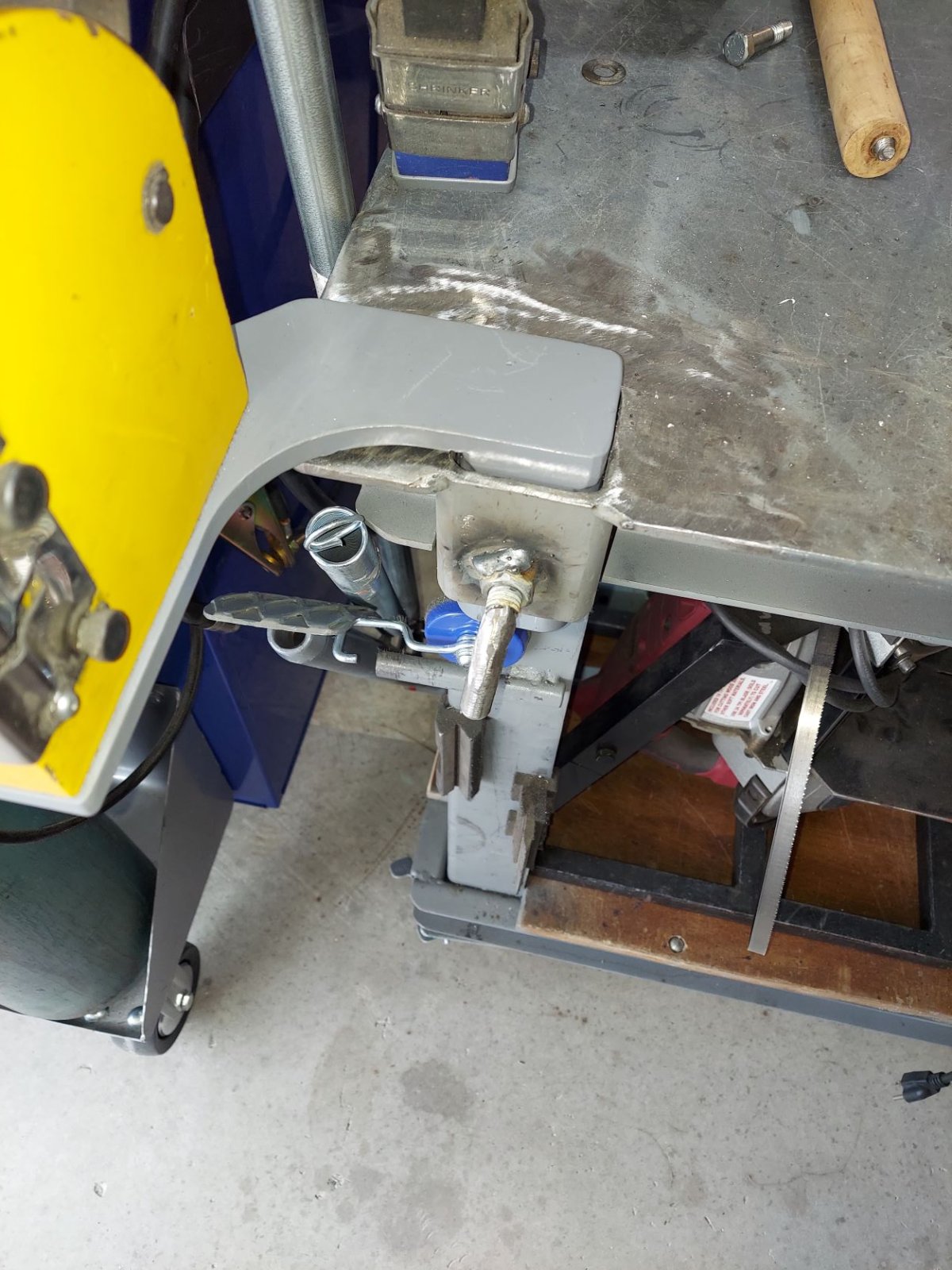

  24. I got tired of trying to use my shrinker - stretcher set by hand. It was too difficult to try and hold the work piece and get consistent movement. My work bench has receiver holes, so I designed a bracket and had two of them cut out of 3/8 plate at SendCutSend.
    I then used an old 4 link bar to create the lower pedal ***embly and used some rod ends with some metal conduit tube for the actuator arm. Welded the lower bracket to my work bench and hooked the return spring to the ground lug on my bench and I have to admit that it works pretty damn well. I should have done this years ago.
