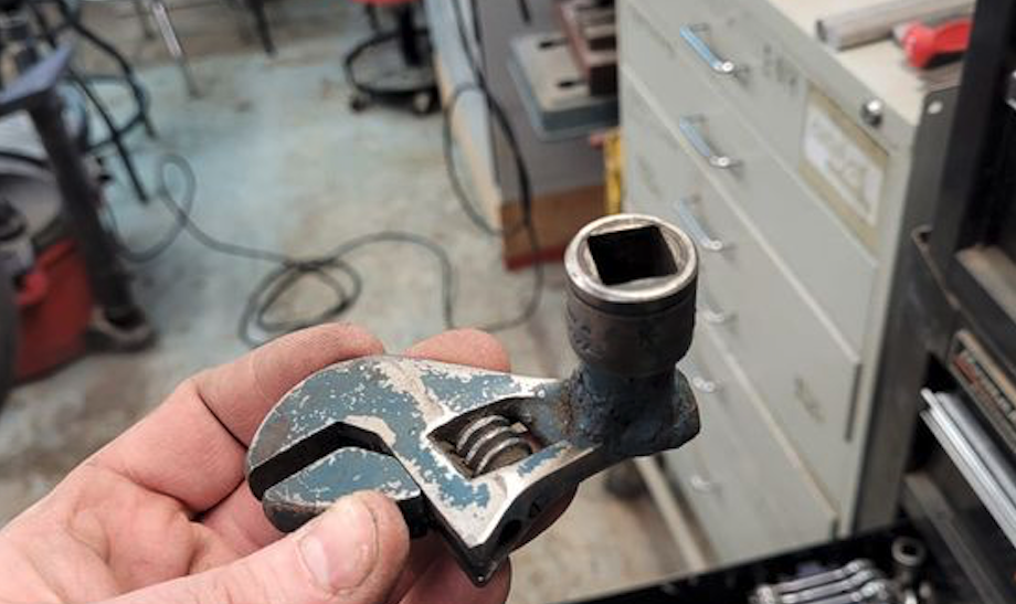

    Best hydraulic fitting wrench a man can own , I have 2 .

    I understand that it comes in different sizes,,,,,which ones do you have??
    I only have the metric ones, from 6mm to 65mm:rolleyes:

    I haves made from 6,8,10 and 12 in Adjustable wrenches .
    Notice I did not say : Cresent Wrench

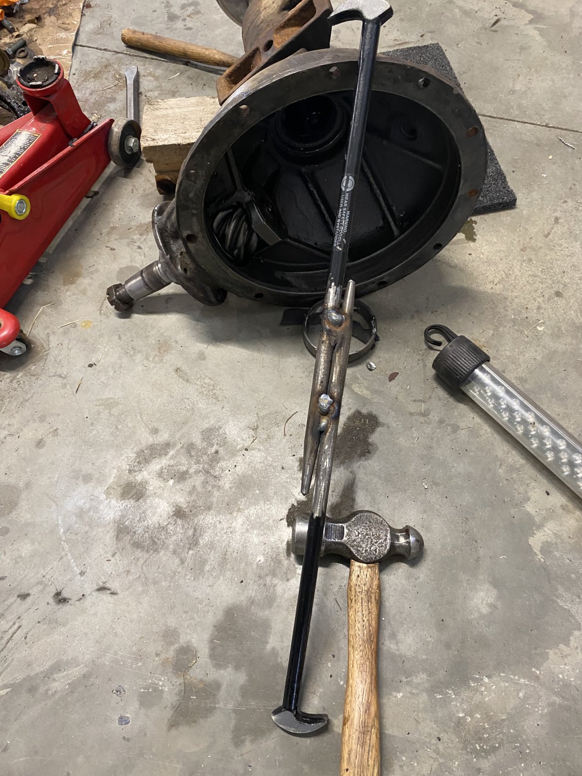

    95E188D8-7157-43BB-9B8F-7C293E5D6877.jpeg Since my puller didn’t get laughed at, here is another. Race/seal puller made from 2 cheap hobo freight pry bars. I cheated and welded a bead across face of race. Wasn’t much of a lip for puller to grab. One end hooks race/seal, the other gets the business end of a hammer. Works for me. Now back to Cl***ic Rewind and the musical stylings of Heart.
