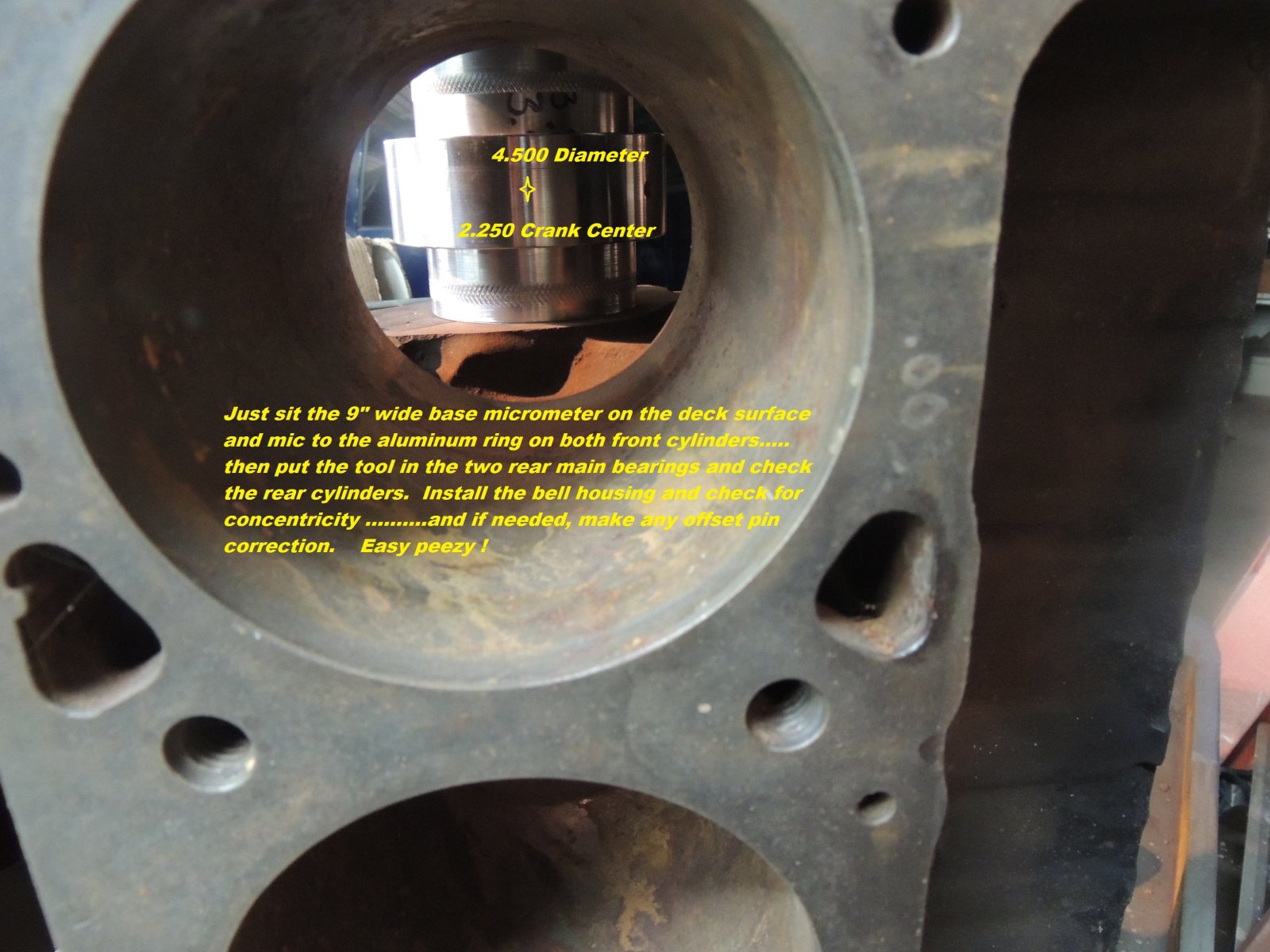

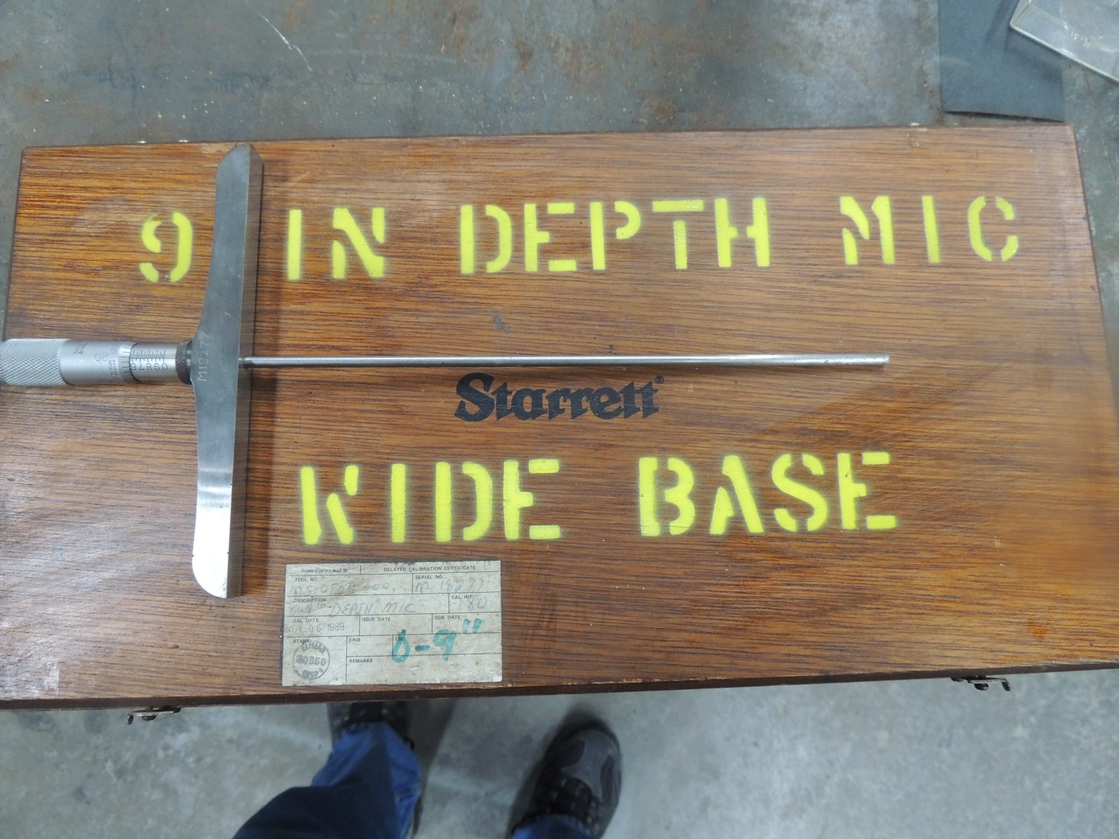

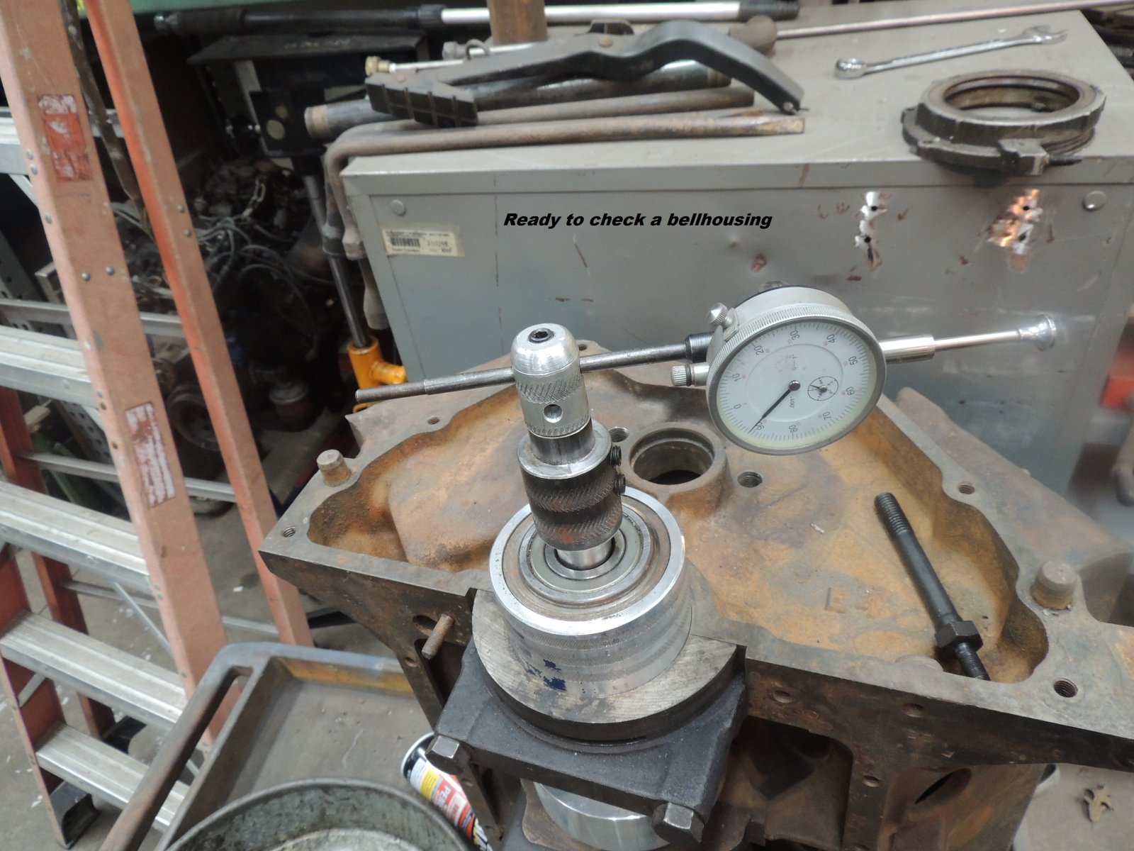

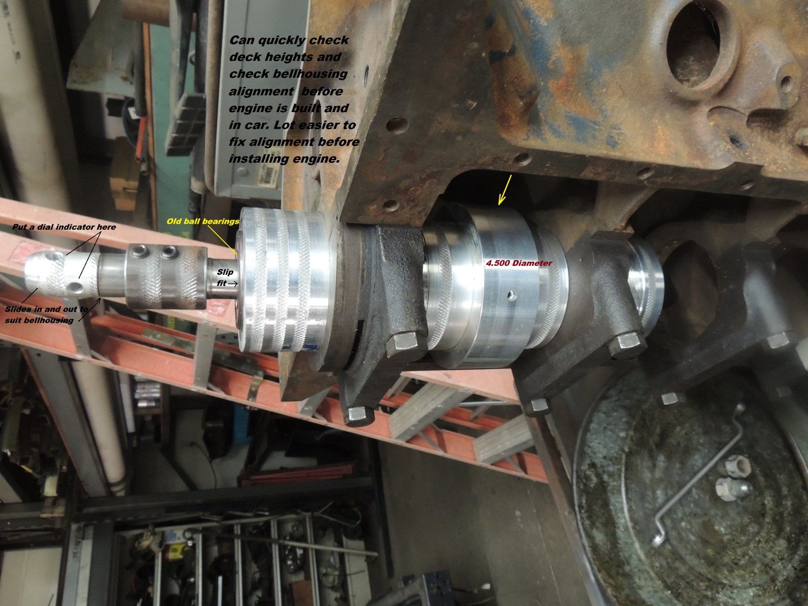

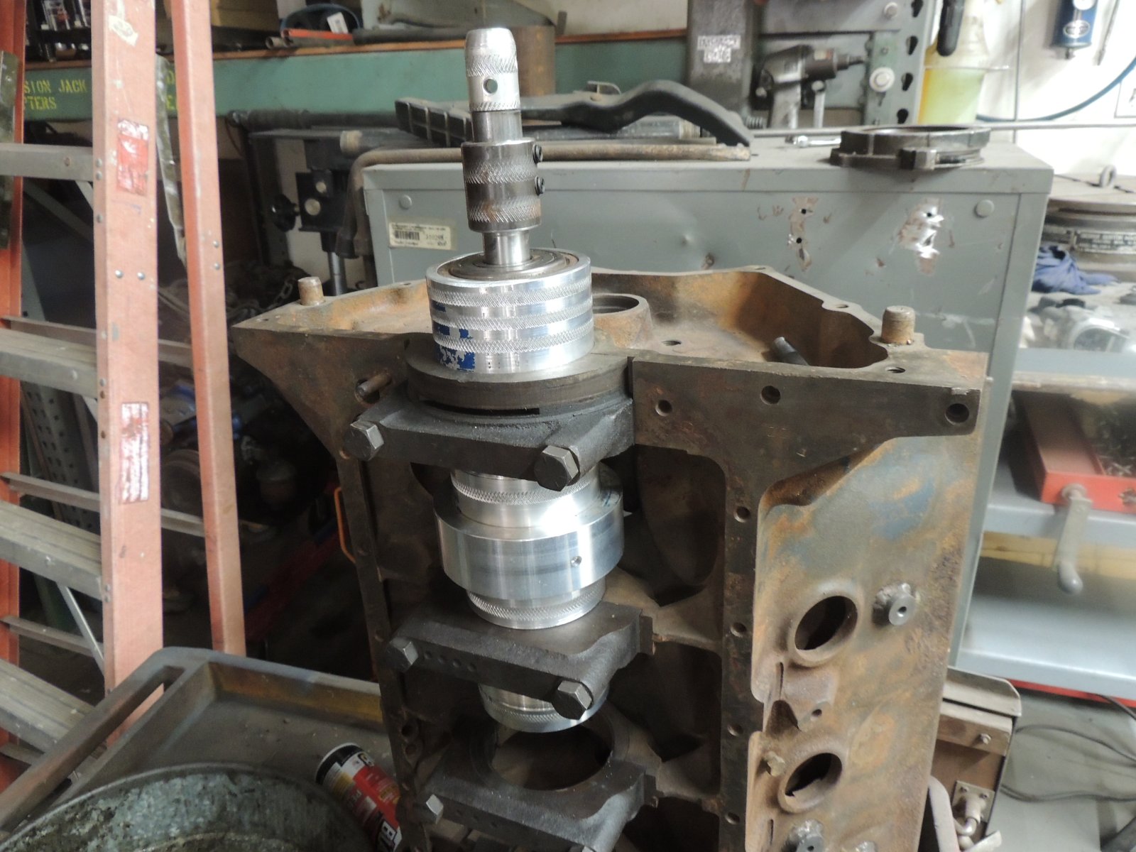

    Tool for checking Block Deck Height (and Bellhousing Concentricity)
    When building an engine, we can either ***ume the block we are using has never been decked or we can measure it. I know there are specialty tools for checking the deck height, but I decided to make my own.
    I had some aluminum tubing, so I made a ring to put on it (press fit/shrink) so it would protrude up into the cylinder a ways. My original idea was to make another tube with a flat top and bottom that I would insert into the cylinder. Kinda like a piston and rod replacement. Just slip it in the cylinder till it settled against the ring. Then measure from the deck to the top of the tube. (maybe an inch down in the cylinder)........but as luck would have it, I found a smokin deal on some WIDE base depth mics 9" long. $50......
    So I bought those and like them much better.
    Anyway, I turned the aluminum tube and the ring in my lathe so all would be concentric. I only turned the tube a short distance and to the same diameter as the main bearing support (with no bearing installed). The ring was turned to a known (4.500 diameter/2.250 radius for centerline)diameter. Simply place the tube in the main saddles and snug the main cap bolts. Then Mic down to the ring and you know the exact deck height.
    Switch it to opposite end of the engine and mic those two cylinders.
    Then the idea came to me that while doing this I could also check the concentricity of the bell housing I will be using and make those changes easily before installing the engine. So I added a couple of old bearings I had in a drawer and made a shaft that slips snugly into them. The shaft is hollow and allows an adapter to fit in it that will hold a dial indicator and can be adjusted to the length needed to fit the housing .
    While it takes a little time and effort to make one, it allows for measuring before and after machining the block and getting deck height and quench set correctly. Most people just ***ume that they have a certain compression ratio because the piston manufacturer said thats what it would be......but different deck heights, different gasket thickness, and piston dishes or valve reliefs can have a significant effect on what you really end up with. I'll also include a picture of an inexpensive calculator some of you might be interested in that makes calculating CR easy........as well as a lot of other things. You can quickly see what small changes in combustion chamber volume will have on your final CR. Its REALLY SIMPLE to use. You can calculate your CR in about 2 minutes with a few simple entries. Then push the CR ****on. Then if you want to see what adding/subtracting some combustion chamber CCs will do........you only have to change the CC info and push the CR ****on again. So you can quickly and easily see what effect changes make. Bout $40

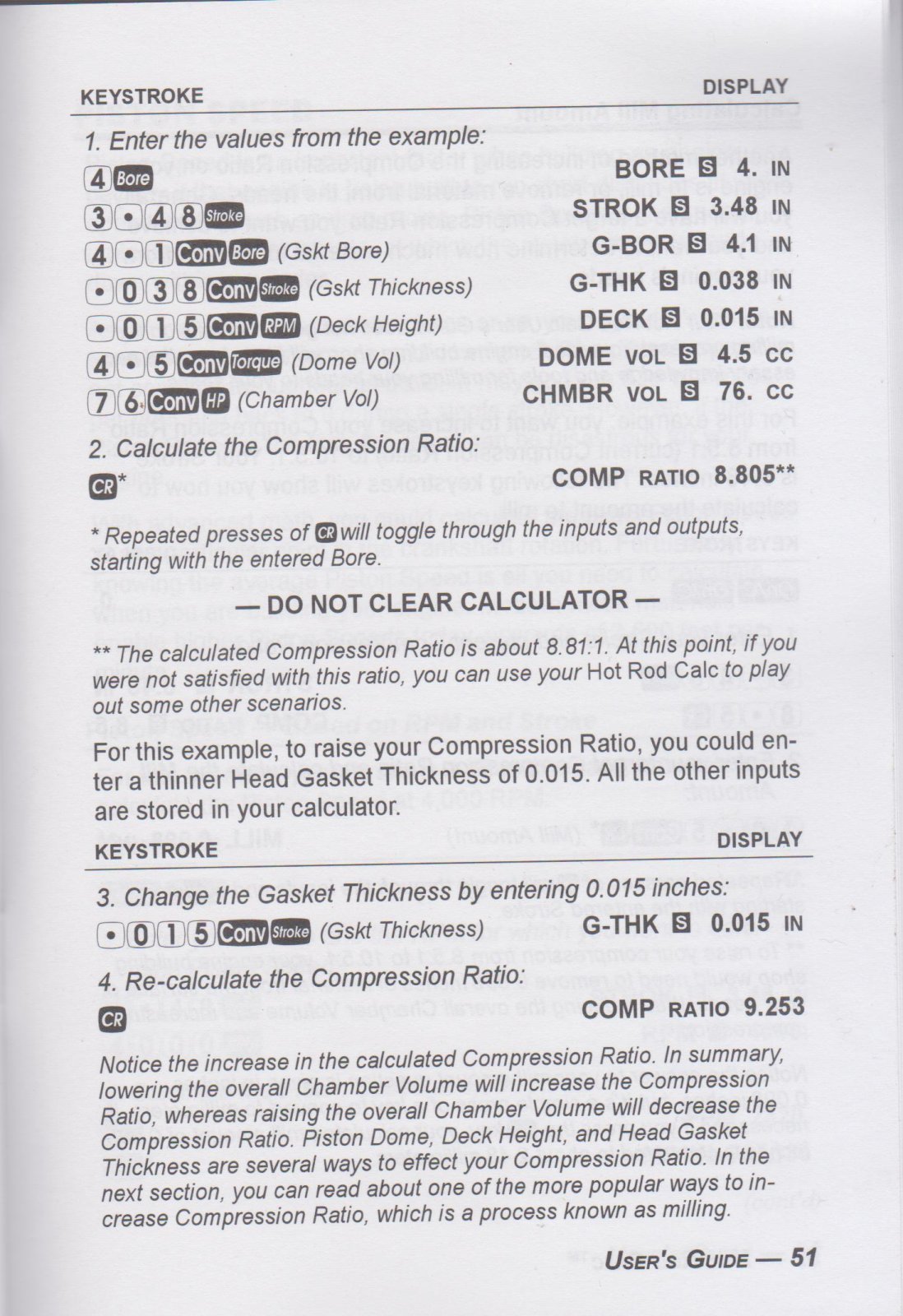

    Put the Diameter of your Bore in..............then press BORE
    Put the Length of your Stroke in...............then press Stroke
    Put the Diameter of bore in the head gasket..........Then press Conv then Bore
    Put the Compressed Thickness of your Head Gasket.........(.039 ?).....Then press Conv then Stroke
    Put the CCs of the head you are using............Then press Conv then HP
    Now push the CR ****on and you have your Compression ratio.
    If you change the CCs, you don't have to change any entry but the CCs as it keeps the other info.
    Now that example is for a flat top piston with a zero deck height. If your piston sets below the deck or has a dish in it, then you have to add that amount of CCs to the heads CCs so you have the total CCs of the combustion chamber. Again, pretty easy to do.
    Here is an example from the instruction book.
    Notice that a simple change in head gasket thickness of .015 made almost 1/2 a point difference in the compression ratio. So if you don't allow for the CCs of being below the deck, having a dish or a domed piston, you won't know for sure what you have.
    Notice also that it calculates tire size and gear ratio vs speed.

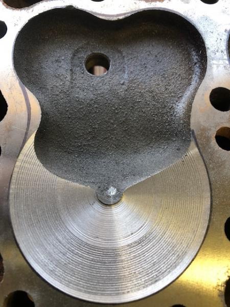

    IMG_0722.jpg IMG_0723.jpg [​IMG] Tool for recutting domes in Ford Flathead heads
    Made this from an old lug nut and a piece of a file. Needed to recut domes for piston clearance after milling the

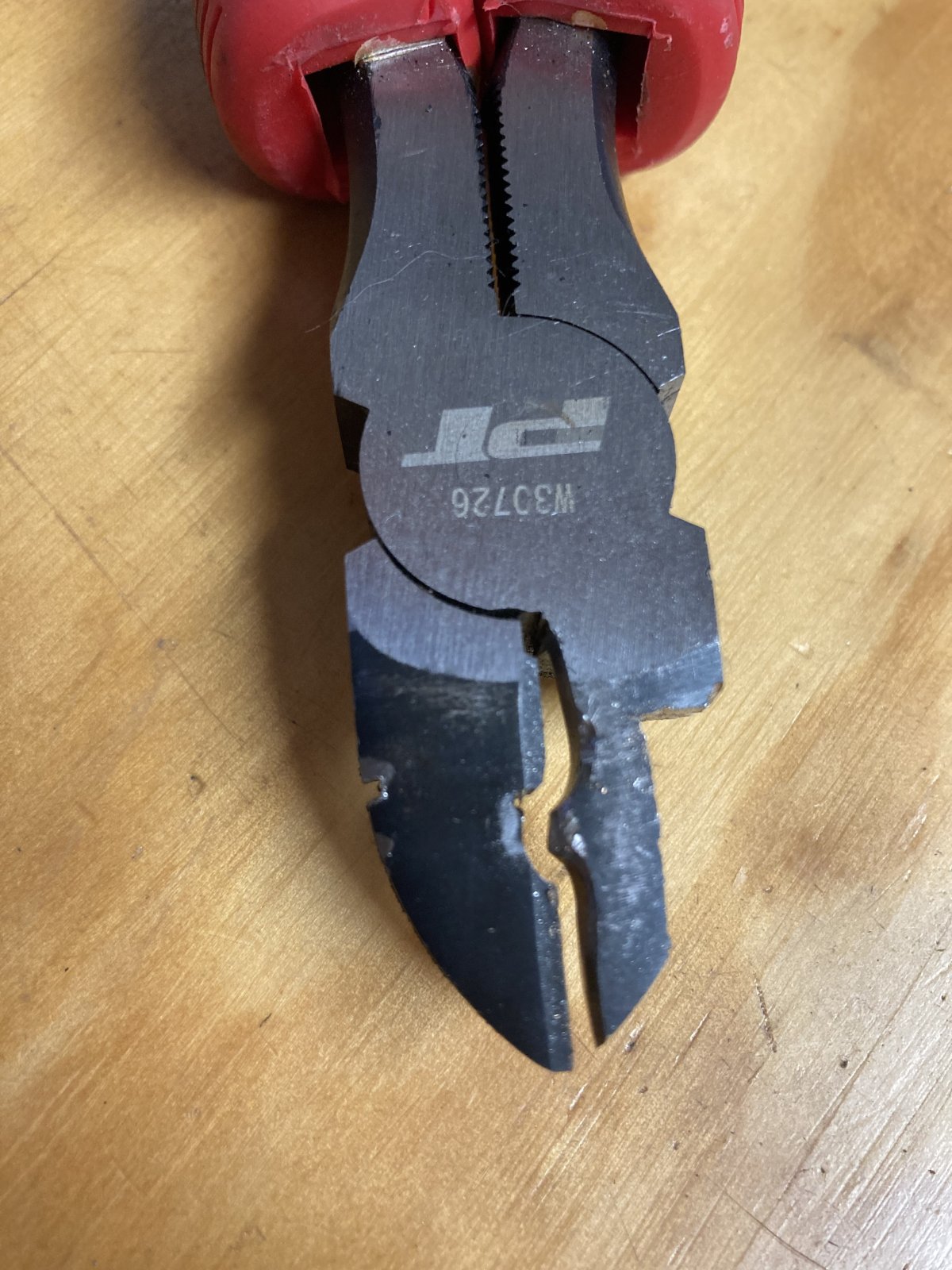

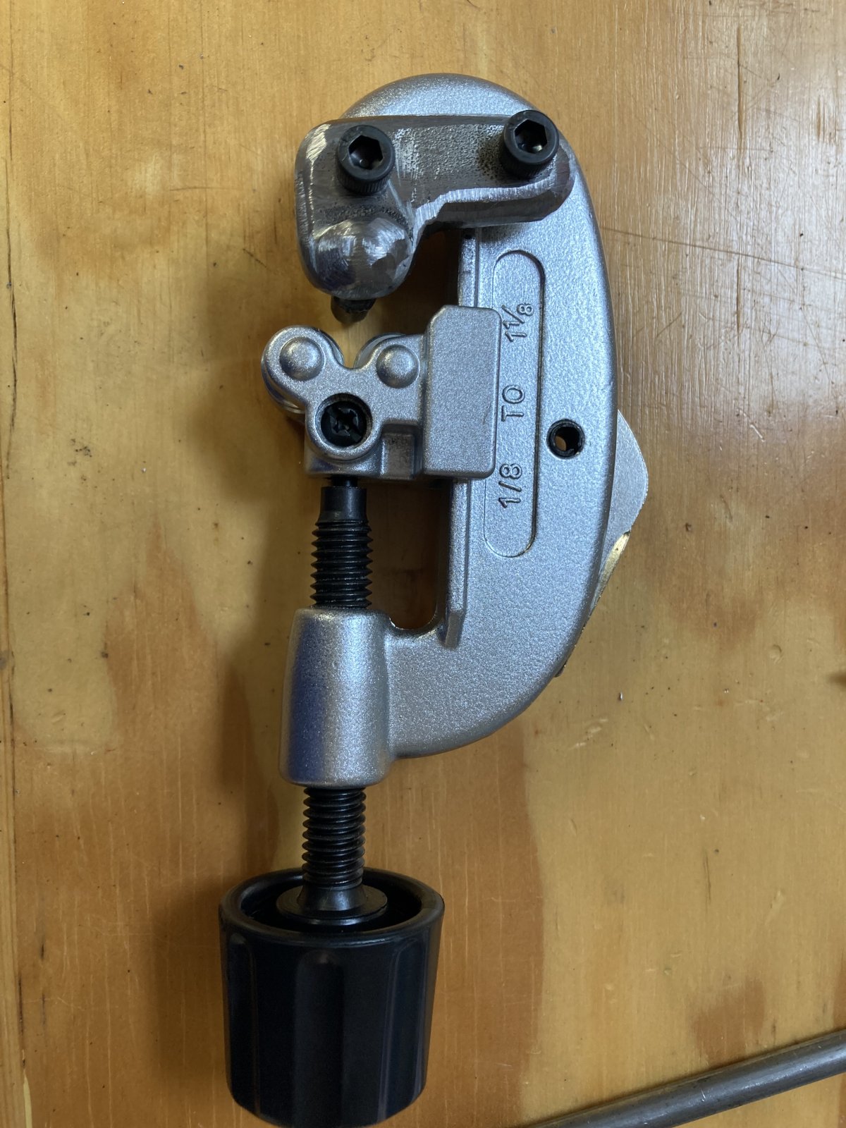

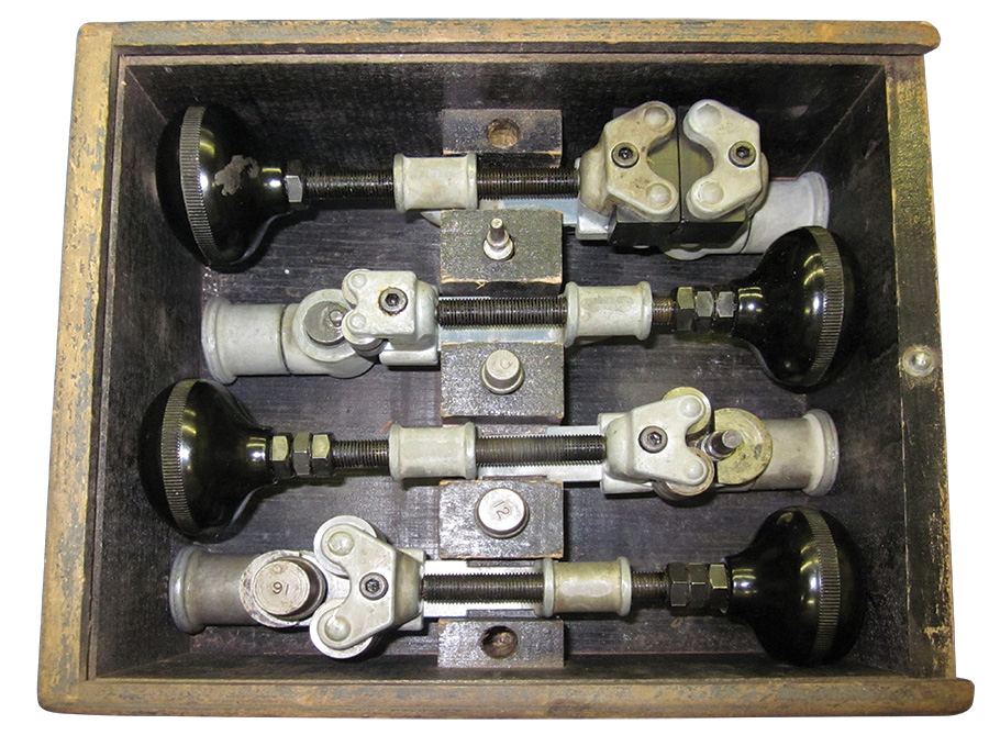

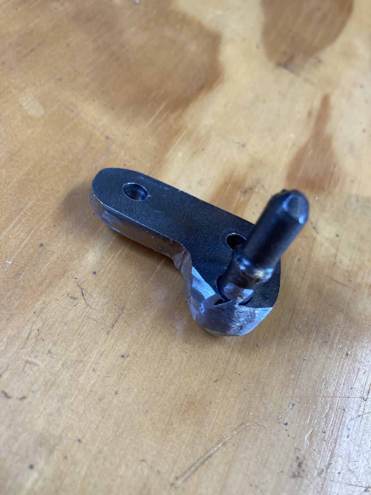

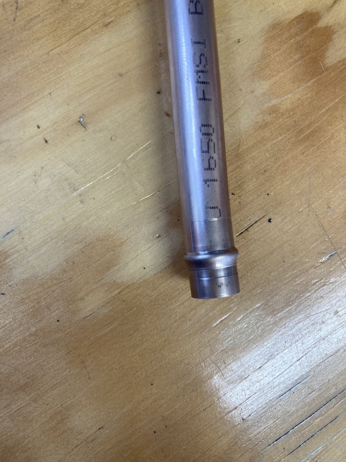

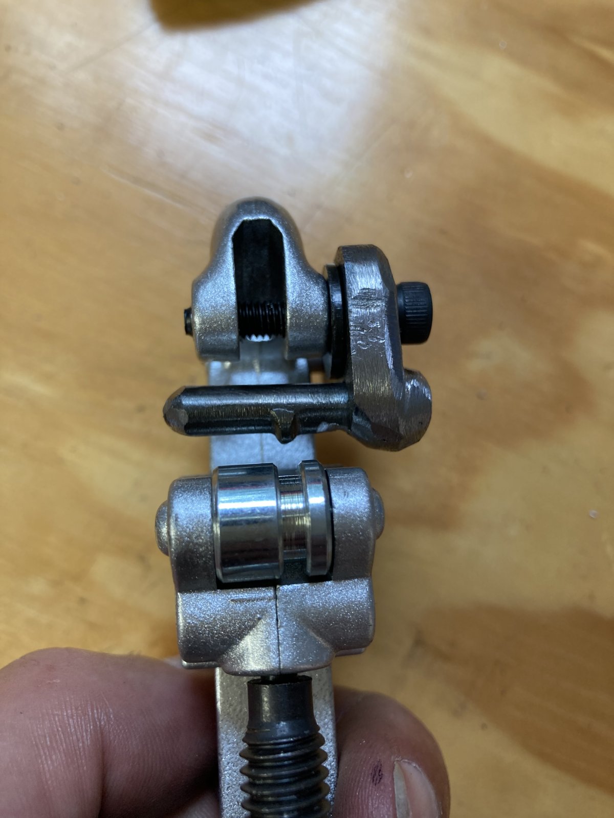

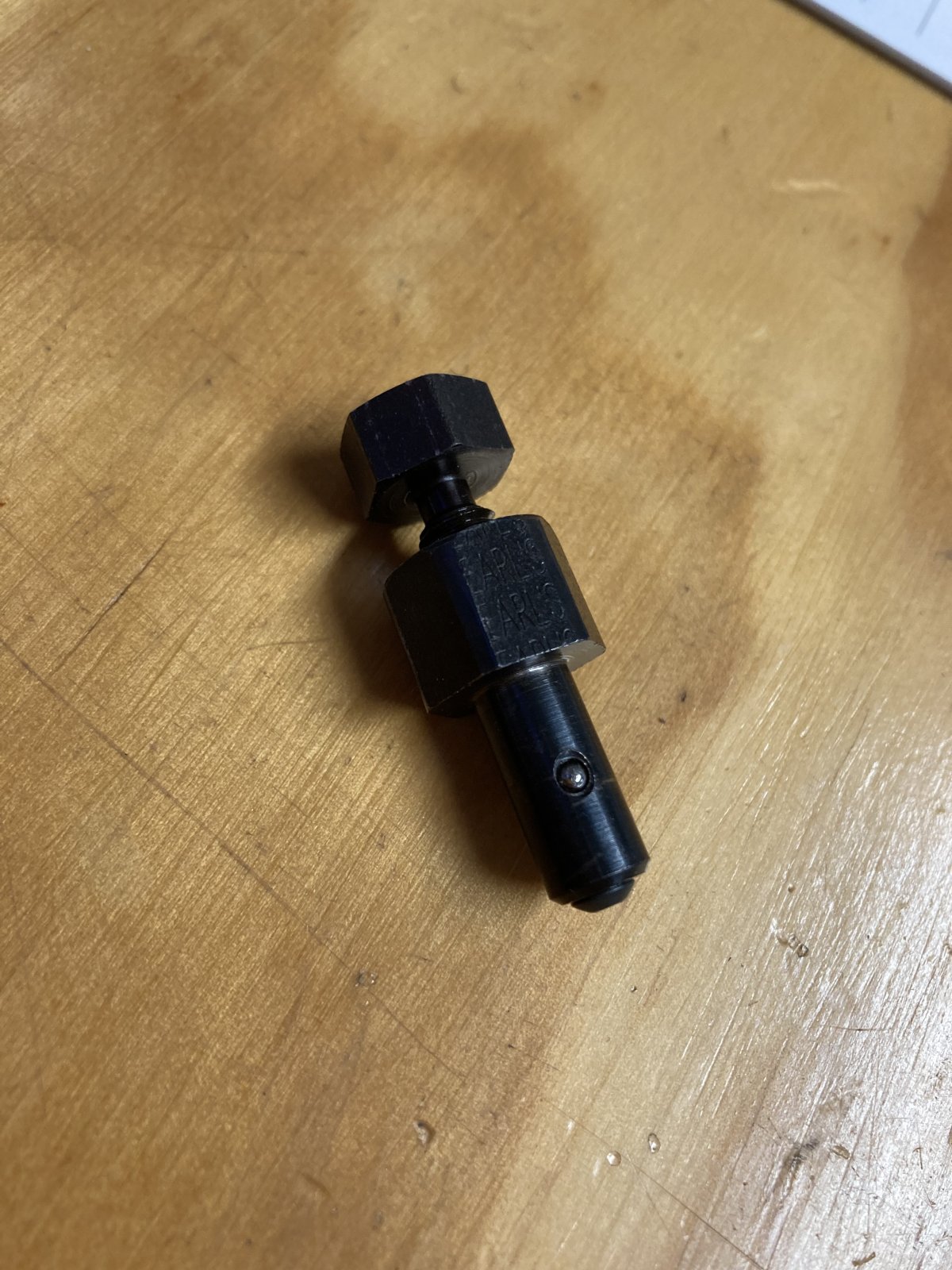

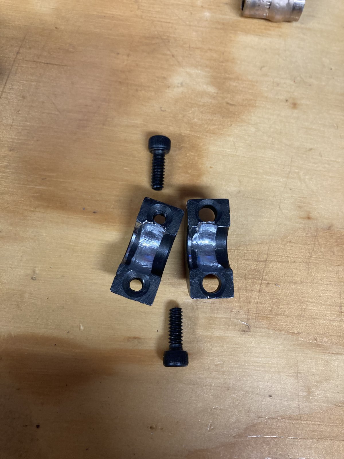

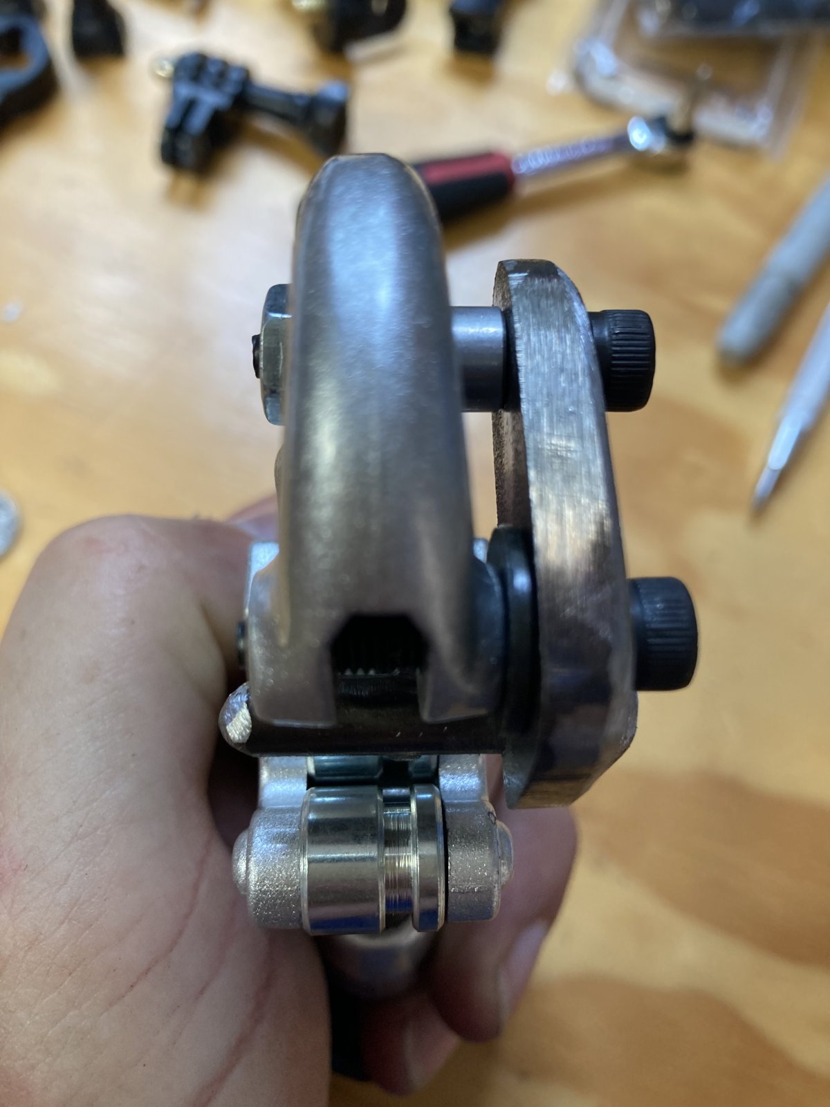

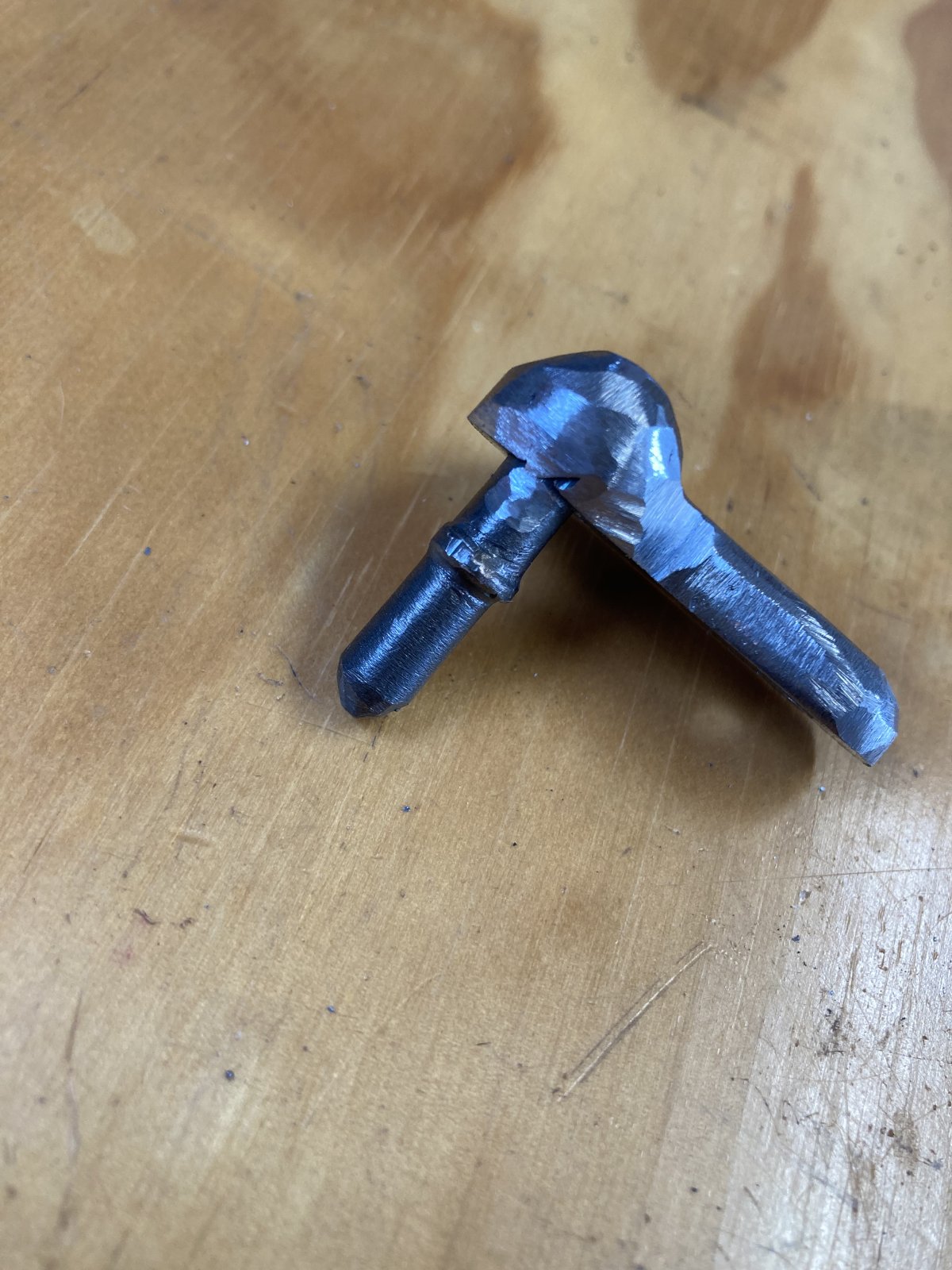

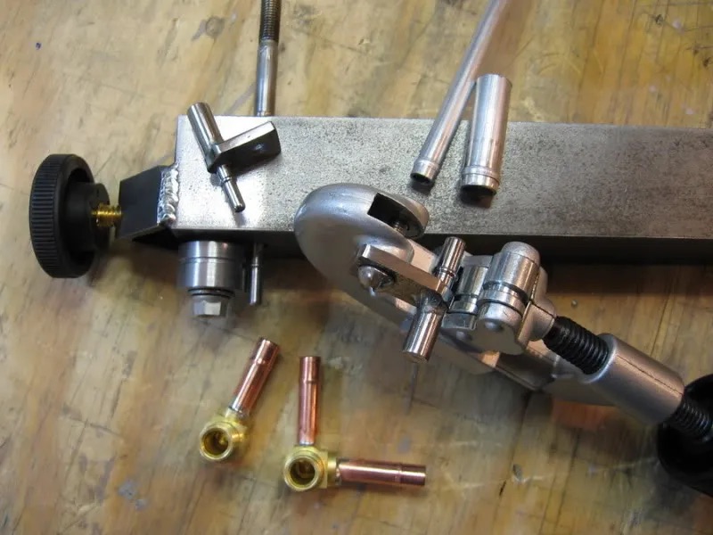

    I’ve been puttering around with ways to make a bead on 3/8” tubing to replace the gas line on my 37. The best tool for the job is really expensive, so trying for a less expensive alternative.
    These are the WWII vintage aircraft tubing beaders from Graham (Parker).
    https://www.kitplanes.com/to-bead-or-not-to-bead/
    $500+, if you can find a set. They’re back in production, but that hasn’t made them less expensive. So, trying other methods that are more garage budget friendly.
    First was modified dikes.
    This made a large bead, but it’s kinda bumpy and rough.
    Probably this would work ok, but I’m not happy with it.
    Next, this mini bead tool from Earls.
    A nicer looking bead, but not very big.
    Thinking that the balls pushing out the bead are also pushing out the tube around it, I ground a channel in a split collar.
    Best result so far. A bit larger and better defined bead.

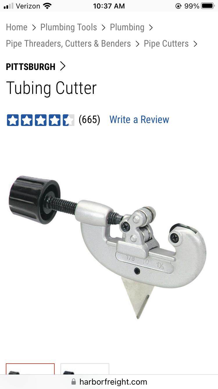

    Still not really happy, so I bought a $7 HF tubing cutter
    and used some s****s of steel, source unknown. I had some small pieces of 1/4” plate and a length of 1/4” rod.
    Using this for inspiration
    but not having a lathe, I welded a bead on the 1/4” rod, then shaped it down to fit inside the 3/8” tube, with the sort of profile I wanted on it. Air cutoff wheel, air belt file, and a few files and sandpaper were used.
    Once it looked like it would work, I cut the 1/4” plate and drilled some holes in it. Welded the Rod to the plate, and shaped the resulting ***embly on the belt grinder. The result
    The HF tubing cutter was modified to bolt the anvil in place of the cutting wheel.
    The inspiration picture only shows one screw. I tried that first, and found the anvil moved around too easily. The second screw was added, along with a cut down aluminum spacer, to eliminate any movement of the anvil.
    Put a test bead on a tube
    It‘s about 0.04” high, which is about (mil spec) what I was aiming for. So, I think I‘m happy and calling this a success. I’ll probably hit it with some paint later.
    $7 is much better than $500+ when I’ll probably only ever make four or six of these beads, ever.

  13. GearheadsQCE
    Joined: Mar 23, 2011
    Posts: 3,670
    GearheadsQCE
    Alliance Vendor
    Wow David!
    You're my hero. :)
    What an ingenious solution to the problem. You could probably sell them and retire.:)
    borntoloze and David Gersic like this.

  15. mohr hp
    Joined: Nov 18, 2009
    Posts: 1,599
    mohr hp
    from Georgia
    Oh man! I love it! Great innovation. Been trying to figure out something like this forever, good job!

    Now that is thinking out of the box. What a great solution, and yes you should patent it.

    I just solder a wire ring on tubing. Quick and pretty much free.

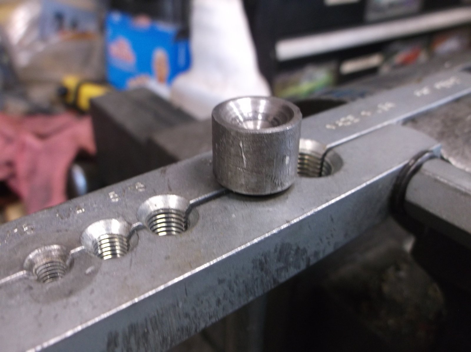

    You can also just use a flaring tool. Put the line in it, use the first die and crush till you get the bead you like. Fast, easy, cheap. DSC00512.JPG

    I’ve seen that. Also bubble flares. Didn’t like either one, wanted a proper bead on the line.

    ^^^^^^^^^^^^^^Sorry to disagree but I dont see a big difference between mine and a factory fuel filter or line bead. Should we tell Ford this is not " proper " s-l1600.jpg

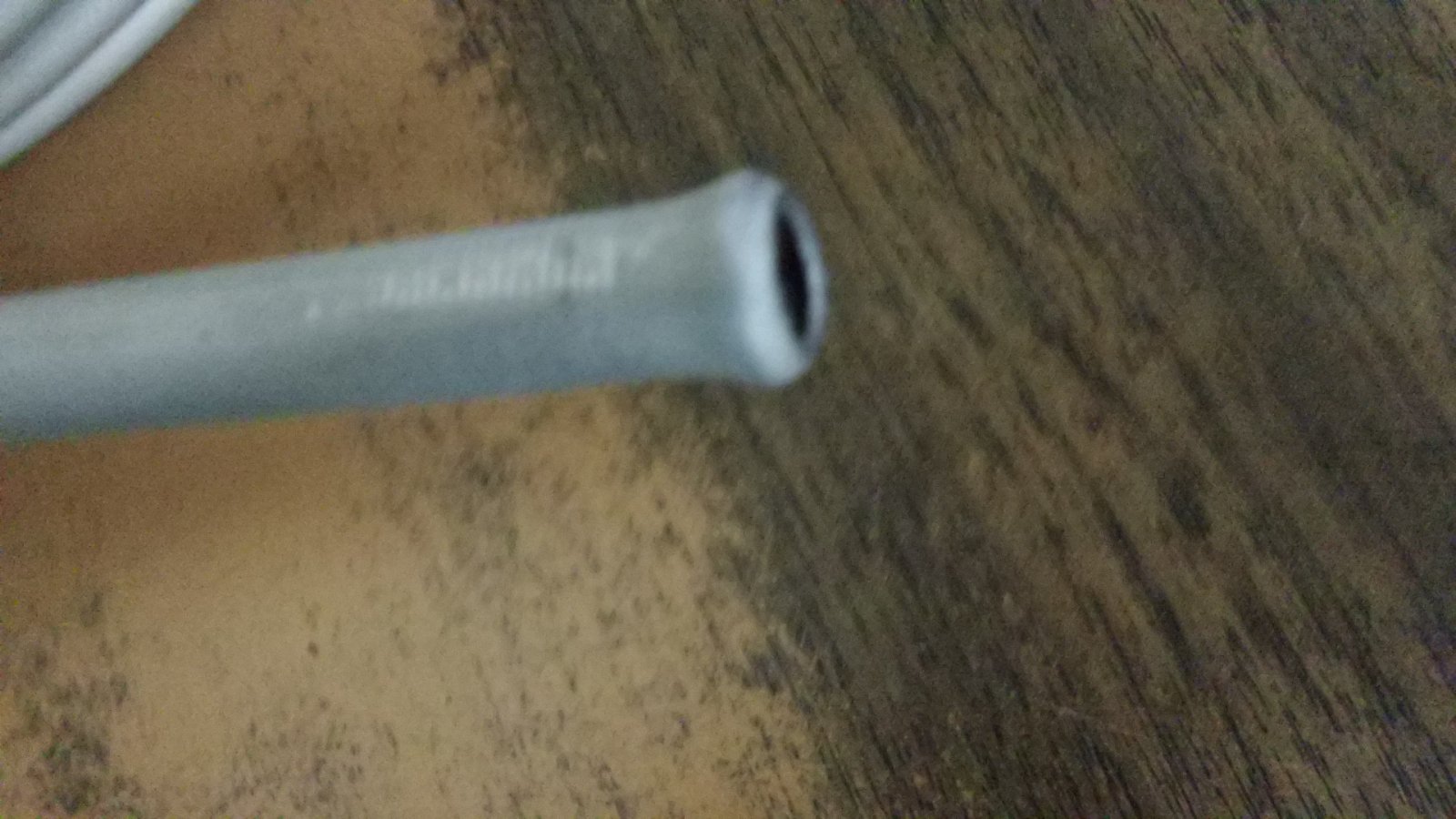

    DSCN5583.JPG I think David did a great job solving a problem by using some ingenuity and some cheap items. Nothing wrong with wanting something to be a certain way and keeping at it until its that way. There is a small tubing bead roll that can be purchased if someone doesn't want to make one. Also, there are some tubing flaring sets that make the "push on" type of "bead?" for late model fuel injection fittings. They can make a decent bead if you don't form them all the way.
    Didn't have a good picture of the bead formed for a late model injector line, but here is one with some piece I scrounged from a junk car. If you look at the silver/shiny ring encapsulated in the black plastic on the left, you can see the factory bead. If anyone has a flaring tool set with that bead attachment, they can just not push the tube all the way and the ring will be less pronounced.
    Anyway, Kudos to David for using the ole noggin to get the job done.

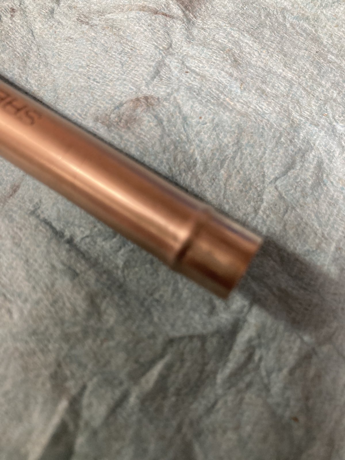

  23. blue 49
    Joined: Dec 24, 2006
    Posts: 2,139
    blue 49
    from Iowa
    A friend of mine has that aviation set of bead formers, but he is some distance away, so I came up with my own way. The die I made has a flat bottom hole the size of the tubing I'm using and a chamfer about the same size as the one on my Lisle flaring tool clamp. The other side has a large countersink for the taper of the flaring tool. I the tube up with about a 1/16" gap between the tube clamp and the adapter and run it down with the flaring tool. I clean up the clamp marks with a wire wheel and it works good.
    Gary

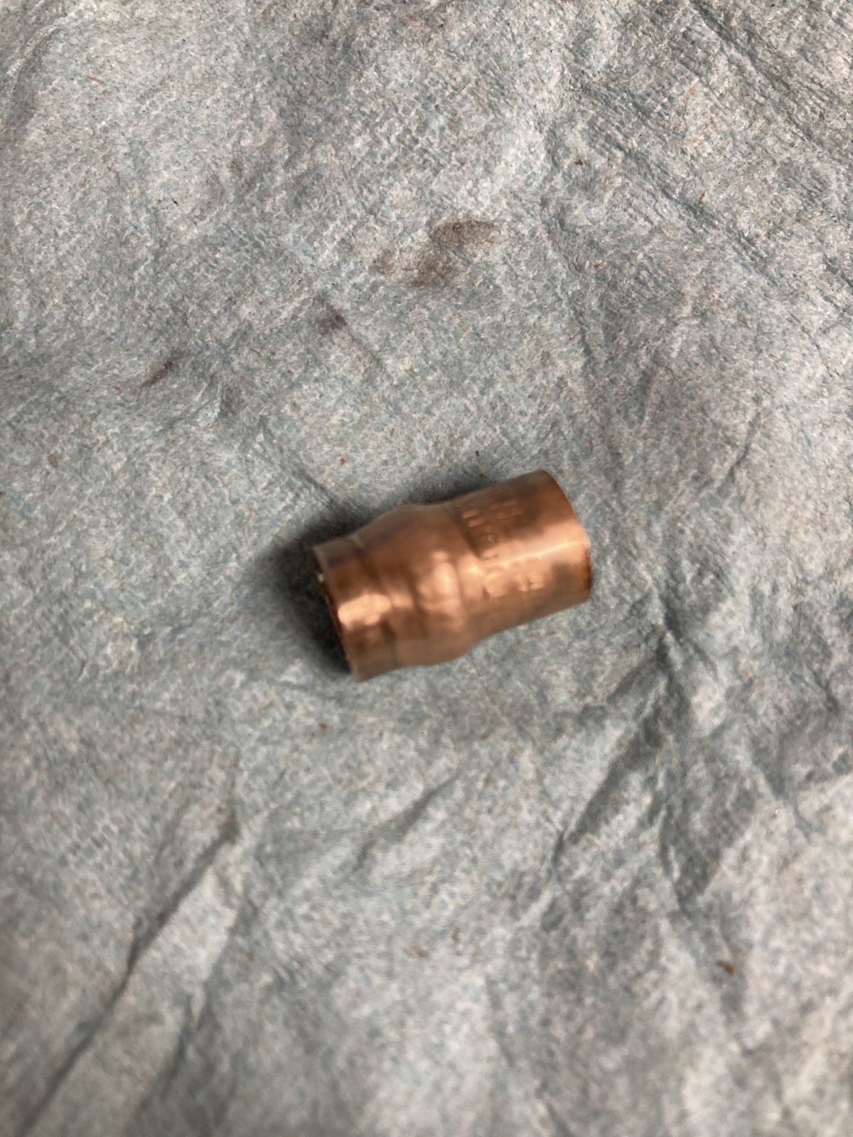

  24. blue 49
    Posts: 2,139
    blue 49
    from Iowa
    For bigger tubes, like this radiator hose splice, I made some dies welded to a pair of locking pliers. Mark the tube with a guide line and set the pliers to dimple the tube just a bit. Go round and round adjusting the pliers tighter each round until you get the ridge you want. This is a piece of chromed br*** sink drain pipe but I've also done beads on steel exhaust tubing with it. Really gives your hand a workout.
